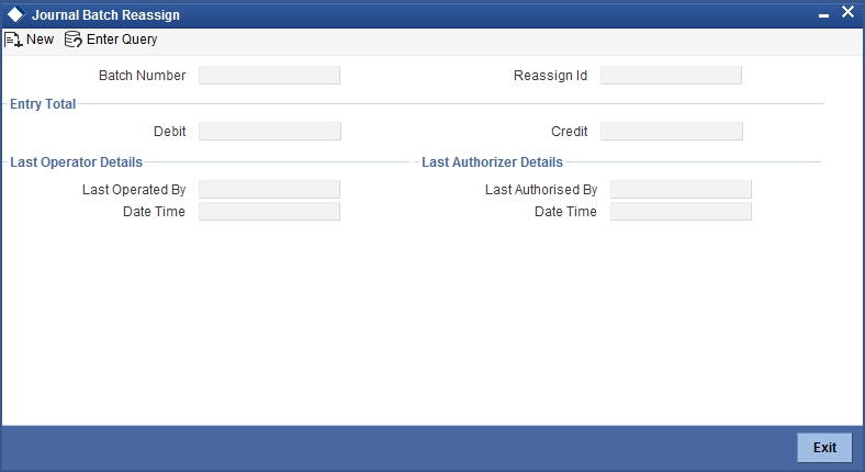

8.2.1 Reassigning Batch
To ‘reassign’ a batch is to allow a teller who did not originally open a batch to use it. The Data Entry Supervisor has the rights to reassign a batch to a teller who did not originally open a batch. However, only unauthorized batches can be reassigned.
You can invoke the ‘Journal Batch Reassign’ screen by typing ‘DEDBATRE’ in the field at the top right corner of the Application tool bar and clicking the adjoining arrow button.
To reassign a batch to a different user click on Jrnl/Teller Batch Op in the Application Browser. Choose Reassign Batch displayed under it. The ‘Batch Reassign’ screen will be displayed.
Batch Number
The adjoining option list displays a list of unauthorized batches that are opened for the day. Choose the batch that you want reassign in the batch number field.
Reassign Identification
Choose the User Id of the teller to whom you want reassign the batch in the Reassign ID field.
The system ensures that the batch is not currently in use. If you choose to reassign the batch to yourself, the system will seek an override.
Entry Total
Total Entries indicates the total amount debited and credited for a particular batch.
Click ‘Ok’ button to confirm the reassign operation. If you do not want to continue with the reassign operation, choose ‘Exit’ or ‘Cancel’ button to exit the function.

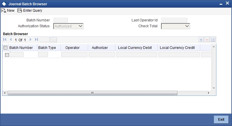

8.3.2 Viewing Journal Batches
You can search and view all journal batches using ‘Journal Batch Browser’ screen. To invoke the screen, type ‘DEDBTTOT’ in the field at the top right corner of the Application Browser and click the adjoining arrow button.
Batch Number
Specify the batch number. Alternatively, you can select the batch number from the option list. The list displays all valid batch numbers maintained in the system.
Authorization Status
Select the authorization status from the drop-down list. The list displays the following values:
Last Operator ID
Specify the ID of the last operator. Alternatively, you can select the last operator ID from the option list. The list displays all valid IDs maintained in the system.
Check Total
Select the query criteria for the batches from the Check Total drop-down list. The list displays the following values:
This screen displays all the batches that have been created in the current branch.
You can delete or authorize the batches based on your requirement. Select the record / records that you wish to delete or authorize by checking the adjoining box. Further click the delete button or authorize button for respective actions.

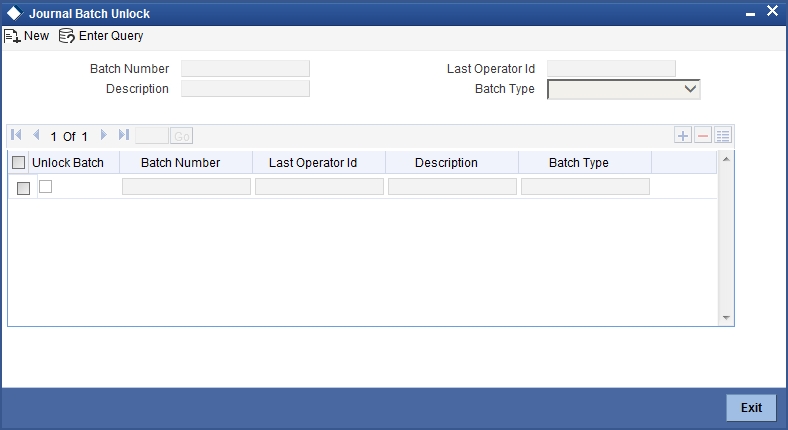

8.3.3 Unlocking Journal Batches
While entering a transaction through Journal Single and Multi Offset entries, if you have not checked the option ‘Batch Close’, the system locks the batches in. You can unlock such locked journal batches using Journal Batch Unlock screen. To invoke the screen, type ‘DEDBATUK’ in the field at the top right corner of the Application Browser and click the adjoining arrow button.
You can search for the records based on batch number and / or operator. The system fetches the records based on the search criteria. Select the batches that you wish to unlock and click ‘Batch Unlock’ button. The system unlocks the selected batches.

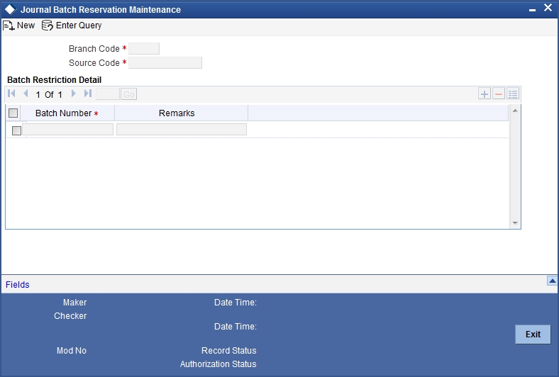

8.3.4 Reserving Journal Batches
You can reserve journal batches for DE Macro upload purpose (excel upload) for a specific branch and source combination.
To invoke Journal Batch Reservation screen, type ‘DEDBARES’ in the field at the top right corner of the Application Browser and click the adjoining arrow button:
Here, you can capture the following details:
Branch Code
Specify the branch code for which you wish to apply the restriction.
Source Code
Specify the source code. The system will apply this restriction to the branch-source combination maintained here.
Batch Number
This is the batch identification number.
Remarks
This field captures the remarks about the branch.
You can add more rows to the restriction list by clicking add button. Once you save the maintenance, the system considers these batches as reserved. You cannot input transactions through Single or Multi Offset Entry. These batches can be used for DE Excel Upload transactions only.

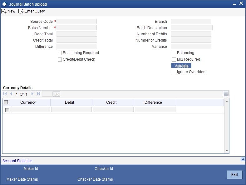

8.3.5 Maintaining Journal Batch Upload
You can upload journal batches into Oracle FLEXCUBE using 'Journal Batch Upload' screen. To invoke the screen, type 'DEDUPONL' in the field at the top right corner of the application toolbar and click the adjoining arrow button.
You can capture the following details on this screen:
Source Code
Select the source code from the adjoining option list.
Branch
Specify the branch code.
Batch Number
Batch Description
Provide description for the batch code specified.
Debit Total
Specify the debit total.
Number of Debits
Specify the number of debits.
Credit Total
Specify the credit total.
Number of Credits
Specify the number of credits.
Difference
Specify the difference.
Variance
Specify the variance.
Positioning Required
Check this box if positioning is required.
Credit/Debit Check
Check this box to check debit/credit.
Balancing
You can indicate whether the entries being uploaded should be balance at the branch level. If you have enabled this option and if the batch does not balance, a message is displayed at the end of the upload session.
MIS Required
Check this box if MIS is required.
Ignore Overrides
Check this box to ignore override.
Currency Details
Currency
Specify the currency.
Debit
Specify the debit amount.
Credit
Specify the credit amount.
Difference
Specify the difference amount in local currency.
Oracle FLEXCUBE supports batch upload of DE save operations. For this, you need to first maintain a job ‘GIUPLOAD’ using ‘Job Maintenance’ screen.
You can schedule your batch upload in ‘Journal Batch Upload’ screen. The system will consider the records for upload based on the value of the parameter ‘IS_UPLOAD_SCHEDULED’. If the value is ‘Y’, then the system will consider the record for upload as part of the job.
The parameter ‘IS_UPLOAD_SCHEDULED’ determines whether an upload is scheduled or not. If the value of the parameter is set to ‘Y’, then it indicates that an upload is scheduled.
As part of the job, the system will pick up all records that are scheduled for upload and start the process.

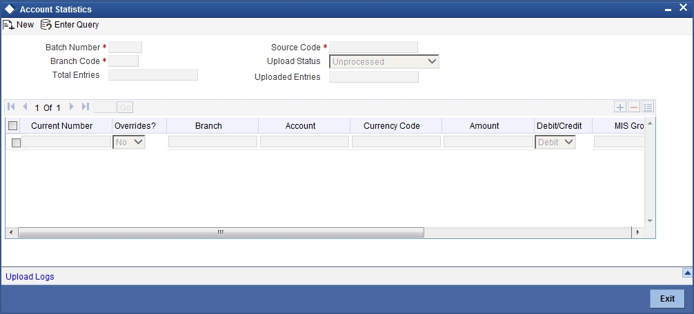

8.3.6 Account Statistics Button
You can view the status of each record in ‘Journal Batch Upload Account Statistics’ screen. Click ‘Account Statistics’ button on ‘Journal Batch Upload’ screen to view this screen. You can also invoke this screen by typing ‘DEDACSTA’ in the field at the top right corner of the application toolbar and clicking the adjoining arrow button.
This screen shows the status of all the records uploaded for a specific batch, branch and source combination.
You can search for the details based on the following parameters:
Once you have specified the search parameters, click ‘Execute Query’ button. The system displays the following details:

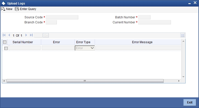

8.3.7 Upload Logs Button
To view the upload logs for a selected entry, click ‘Upload Logs’ button. You can also invoke this screen by typing ‘DEDUPLOG’ in the field at the top right corner of the application toolbar and by clicking the adjoining arrow button.
In this screen, the system displays the upload logs for the selected record.
You can search for the journal batch upload logs based on the following parameters:
Once you have specified the search criteria, click ‘Execute Query’ button. The system displays the following details in the log.

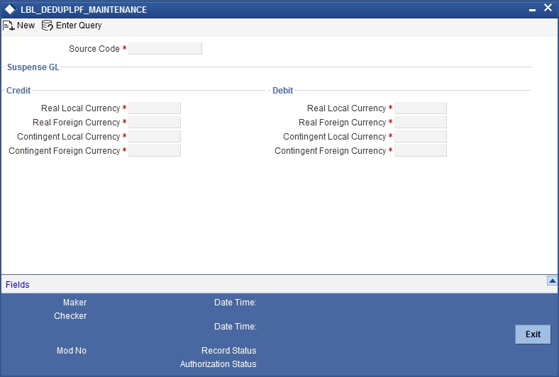

8.3.8 Maintaining Journal Upload Preferences
You can set your preferences specific to journal upload using ‘Journal Upload Preferences Maintenance’ screen.
To invoke the screen, type ‘DEDUPLPF’ in the field at the top right corner of the Application Browser and click the adjoining arrow button.
You can maintain Suspense GLs where entries have to be posted for each external system in the event of failure of account validation during DE Upload.
Source Code
Specify the source code for upload.
Real Local Currency
Specify the suspense GL for real local currency on credit as well as debit transactions.
Real Foreign Currency
Specify the suspense GL for real foreign currency on credit as well as debit transactions.
Contingent Local Currency
Specify the suspense GL for contingent local currency on credit as well as debit transactions.
Contingent Foreign Currency
Specify the suspense GL for contingent foreign currency on credit as well as debit transactions.
Once you have captured all the details, save the maintenance. If an invalid account is specified in the upload process, the respective Suspense GLs maintained for that external system will be debited or credited based on the nature of the transaction.
