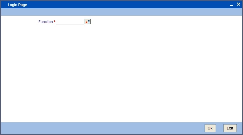

Invoke the ‘Instrument Definition’ screen by typing ‘ENDUINST’ in the field at the top right corner of the Application tool bar and clicking on the adjoining arrow button.

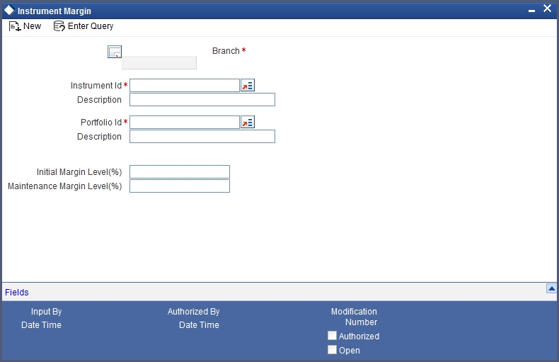

In certain exchanges it is mandatory that you deposit as collateral (Initial Margin), a fixed percentage of the Contract Value. You need to specify the percentage of initial margin for every open contract held by the investor. The percentage that you specify can change on a day-to-day basis. Similarly the percentage per Open Short Contract may differ from the percentage per Open Long Contract
Since the ETD module does not calculate the Initial Margin Requirements, the value that you specify in this field represents an approximate percentage that will be required as Initial Margin. The percentage of the contract amount that you enter in these fields will not be considered for processing.

Initial and maintenance margins are maintained at the instrument level for a combination of instrument ID and portfolio. The ‘Instrument Margin’ screen can be used to capture details regarding percentage of initial and maintenance margins for each open contract.
Invoke the ‘Instrument Margin’ screen by typing ‘ENDINMRG’ in the field at the top right corner of the Application tool bar and clicking on the adjoining arrow button.
Branch
The current logged-in branch is displayed here.
Instrument Identification
Select the instrument ID from the adjoining list of values provided.
Portfolio Identification
Select the portfolio ID from the adjoining list of values provided.
Initial Margin Level (%)
Indicate the initial margin percentage per open contract for a combination of instrument ID and Portfolio.
Maint Margin Level (%)
Indicate the maintenance margin percentage per open contract for a combination of instrument ID and Portfolio.
Use the ‘Intra Day Batch Start’ screen to upload the following details into Oracle FLEXCUBE from an external system:
To start the upload, specify the respective Function Id in the ‘Intra Day Batch Start’ screen and click ‘Ok’ button.
The system processes records with the details one by one and uploads all the valid records into the system and rejects ones with errors. The system also checks for duplicate records and if they exist, then they are amended.
