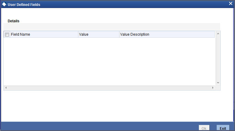

3.2.3 Specifying UDF Values
You can associate values to all the User Defined fields created and attached to the ‘Foreign Exchange Branch Parameters’ screen. You can view the list of User Defined fields associated to this screen by clicking ‘Fields’ button on the ‘Foreign Exchange Branch Parameters’ screen.
You can enter the value for the UDFs listed here in the ‘Value’ column.

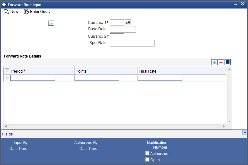

3.3 Forward Rates
3.3.1 Maintaining Forward Rates
When you revalue a forward FX contract, using the rebate (NPV) method of revaluation, you will use an exchange rate (for the currencies involved) referred to as a ‘Forward rate’. The forward rate for a currency (for a specific period) is based on the spot rate and the prevailing interest rate.
The forward exchange rates for a currency are maintained in the ‘Forward Rate Input’ screen.
You can invoke the ‘Forward Rate Input’ screen by typing CYDFWRAE in the field at the top right corner of the Application tool bar and clicking on the adjoining arrow button.
3.3.2 Maintaining forward Rates for Currency Pairs
When the ‘Forward Rates Maintenance’ screen is displayed, select ‘New’ icon in the Application tool bar or click new icon.
In this screen, you can:
Currency pair
In this screen, you must first indicate the currency pair for which you are maintaining the forward rate.
In the Currency 1 field you can invoke a list of the currencies that are maintained in your bank. Double click on a currency to choose it. This would be the first currency of the pair. In the Currency 2 field, choose the other currency that constitutes the pair.
The forward rates that you specify subsequently would apply to this currency pair.
Base Date
The forward rates which you maintain subsequently will apply to all forward FX contracts from the base date.
The current system date will be displayed in this field.
Spot rate
The spot rate for the day − for the currency pair − is displayed in this field. The forward rate would be computed using the spot rate displayed in this field.
To compute the forward rate, the premium or discount points for the currency pair (specified subsequently) would be added to or deducted from the spot rate displayed.
Period Code
You can maintain forward rates for specific tenors (in days). These tenors are referred to as ‘Periods’. For example, 30 days, 60 days, 90 days etc.
For each currency pair, you can maintain forward rates for different periods. In the Period Code column, you can enter the period codes for which you want to define forward rates.
Points
The forward rates for a currency pair should be maintained in the form of premium or discount points vis-à-vis the spot rate for the currency pair.
In the ‘Points’ column, you must specify the forward rate for the period that you specified in the previous column (for the currency pair).
The variance you specify will be applied on the Spot Rate to arrive at the Forward Rate, depending on the quotation method for the currency. The following table summarizes the method of application:
Direct quotation Indirect quotation
Premium Add to the Spot Rate Subtract from the Spot Rate
Discount Subtract from the Spot Rate Add to the Spot Rate

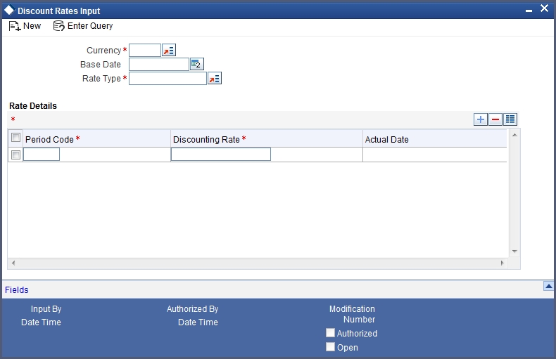

3.4 Discounting Rates
3.4.1 Maintaining Discounting Rates
Discount rates are the interest rates (for a currency) that you use to compute the Net Present Value (NPV) of an outstanding FX contract.
The discounting rate for a Currency and Rate Type is maintained in the ‘FX Discounting Rate Maintenance’ screen. These discounting rates will be used when contracts in different currencies are revalued using the NPV method of Revaluation.
You can maintain discounting rates for a currency for different tenors in the ‘Discount Rates Input’ screen. You can invoke the ‘Discount Rates Input’ screen by typing ‘FXDDIRAT’ in the field at the top right corner of the Application tool bar and clicking on the adjoining arrow button.
The discount rates that you maintain are for a Currency and Rate Type combination. After you select this combination, you can proceed to set up tenors and the rates applicable to each tenor.
Currency
Select the Currency from the option list available.
Base Date
The discounting rates that you maintain subsequently will apply to FX contracts from the base date that is displayed here.
The current system date will be displayed in this field. You can change the default value. However, you can only enter a date that is the same as or later than the current system date.
Rate Type
The discount rates that you maintain are for a Currency-Rate Type combination. Select the rate type for which you are defining discounts.
Period Code
You can maintain discounting rates for the Currency – Rate Type combination for specific tenors (in days). These tenors are referred to as ‘Periods’ in Oracle FLEXCUBE.
A Period commences on the Base Date applicable to the Currency and Rate Code that you selected and ends on the date that is displayed in the Actual Date field.
For contracts involving currencies, for which you have not maintained discount rates, the rates of the discount currency specified in the Bank Parameters will be used.
You must specify the discounting rate for a period before you enter the next period.
Discounting rate
The discounting rates for different periods for a Currency and Rate Type should be maintained in the form of discount points (a percentage). The rate that you enter against each period will apply to contracts whose transaction date is between the Base Date and the Actual Date.
In the ‘Discounting Rates’ column, you must specify the discounting rate for the period code that you specified in the previous column (for a currency).
Actual Date
The system displays the actual date on which the period that you specified ends.
3.4.2 Specifying UDF Values
You can associate values to all the User Defined fields created and attached to the ‘Discounting Rate Maintenance’ screen. You can view the list of User Defined fields associated to this screen by clicking ‘Fields’ button in the ‘Discounting Rate Maintenance’ screen.
For more details on how to create user Defined fields, refer chapter ‘Creating custom fields in Oracle FLEXCUBE’ in the User Defined Fields User Manual under Modularity.

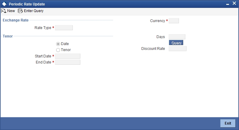

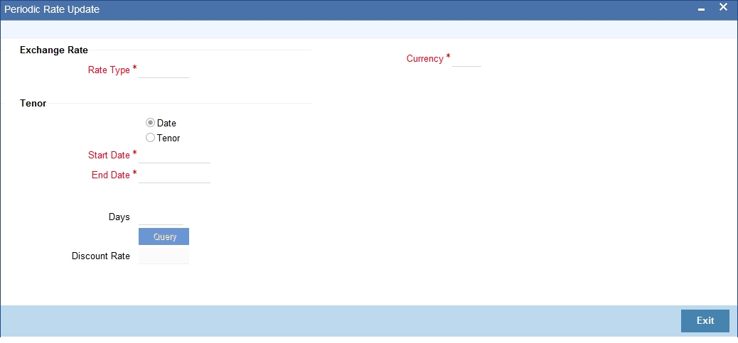

3.4.3 Querying Discount Rates
While processing a contract that involves discount rates, you can query the discount rates applicable to a Currency and Rate Type combination for a specific period using the ‘Discount Rates Query’ screen. You can invoke the ‘Discount Rates Query’ screen by typing ‘FXDQIRAT’ in the field at the top right corner of the Application tool bar and clicking on the adjoining arrow button.
Rate Type
You can query the discount rate for a Currency and Rate Type combination. Here you need to select the Rate Type for which you are querying discount rates.
Currency
Select the currency for which you are querying the discount rates.
You can query discount rates for a Currency-Rate Type combination based on either of these:
3.4.3.1 Querying Based on Dates
Start Date
Select the start date for which you want to query discounted rates.
End Date
Select the end date for which you want to query discounted rates.
3.4.4 Querying Based on Tenor
Tenor
Select this option if you want to query rates for a specific tenor.
Days
Specify the number of days for which you want details. If you indicate 10 in this field, the query will calculate the discount rates for the Currency - Rate Type combination ten days from the query date.
To execute the query, click ‘Query’ button. The discount rate for the Currency-Rate Type combination and period that you queried is displayed in the Discount Rate field.
Discount Rate
The discount rate for the currency- rate combination is displayed here.

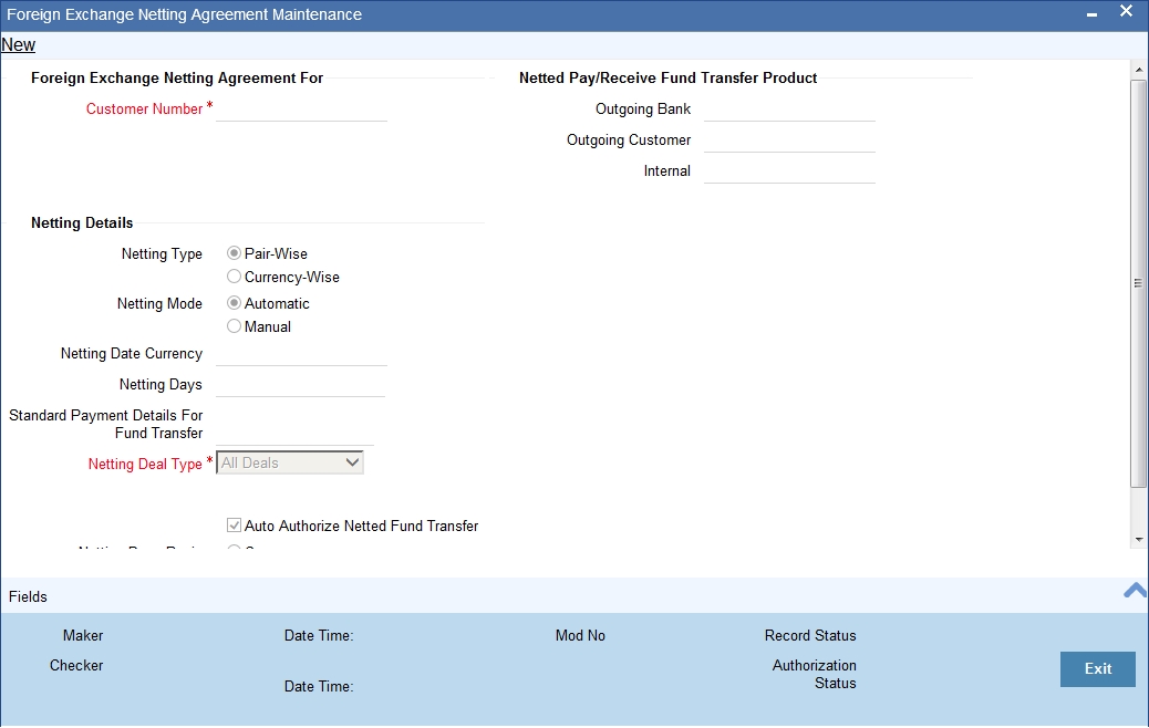

3.5 Netting
3.5.1 Netting Details
Netting is the process of offsetting the receivables with the payables for a counterparty to generate a single accounting entry in the counterparty’s account. Oracle FLEXCUBE allows you to net contracts that satisfy certain conditions. The Netting facility is useful at the time of contract settlement. You can opt to net two or more contracts at the time of settlement if the contracts are:
3.5.2 Maintaining Netting Details
To net foreign exchange deals, you must enter into a netting agreement with the counterparty concerned using the ‘Foreign Exchange Netting Agreement Maintenance’ screen..
You can invoke the ‘Foreign Exchange Netting Agreement Maintenance’ screen by typing ‘FXDNETMA’ in the field at the top right corner of the Application tool bar and clicking on the adjoining arrow button.
These details will be used to net the FX contracts that you enter into with the counterparty.
Customer Number
You must indicate the customer for whom you are maintaining netting details. The adjoining option list displays a list of all the customers maintained in the system. You can choose the appropriate one.
When you choose to net contracts at the beginning of the day, all contracts specified for netting will be netted for every customer for whom you have maintained netting details.
Netting Type
The status of a contract that has been specified for currency-wise netting can be any of the following:
When the netting process is run, only contracts that have not already been netted will be netted. That is, only those contracts that do not belong to the status “both bought and sold netted” will be netted. The bought and the sold legs (bought currency and sold currency) of the contract will be netted individually. The system ensures that the leg to be netted is not already netted.
At the time of contract processing, the netting type that you specify for the customer will apply to all contracts involving the customer. You cannot change the limit netting type during Contract Booking.
Netting Mode
While specifying netting details for a customer, you should indicate how you wish to initiate the process of netting. You can choose between the following two options as the mode of netting:
Netting Deal Type
Select netting deal type from the drop-down list. The list displays the following values:
When NDF contracts are netted, the system considers only those contracts for which fixing deals are already booked. The system considers both NDF forward deals and fixing spot deals while netting.
Netting Date Currency
For every currency, you can maintain a list of holidays. This list is maintained in the Core Entities module. The holiday list for a currency is used to compute the netting date for contracts. The holiday list of the currency that you specify in this field will be used to compute the netting date for contracts involving the customer.
In the Currency field you can invoke a list of the currencies that you have maintained in your bank. Double click on the currency that you want to indicate as the Netting Date Currency.
Netting Days
When you specify the netting details for a customer, you can also indicate the day on which the contracts involving the customer are to be netted. This day could be a certain number of working days before the settlement date of the contracts.
3.5.2.1 Specifying the Payment Method
Netted contracts are settled in Oracle FLEXCUBE by generating a Funds Transfer. This is achieved by the interface with the FT module of Oracle FLEXCUBE.
Broadly, there are three types of funds transfers that you can choose from:
Outgoing Bank
If the beneficiary is a bank you can choose this option. You can invoke a list of Outgoing Bank transfer products maintained in the FT module.
Outgoing Customer
If the beneficiary is an individual, you should choose an appropriate FT product, from a list of FT Products for Individuals that you have maintained in your bank.
Internal
If the beneficiary is a customer of your bank you can specify an appropriate FT product that you have maintained in your bank.
Auto Authorize Netted Fund Transfer
You can specify whether the netted FT should be automatically authorized for certain selected counterparties against the transaction settled on a particular day.
Netted payment contract will be uploaded as an authorized contract if it is checked. Otherwise the contract will be uploaded as unauthorized. In such a case, you have to manually change the details of the contract, if required, and on authorization the payment message will be generated.
Note
Only details pertaining to settlement accounts will be allowed to be modified. Contract de­tails pertaining to counter party or amounts cannot be modified.
Netting Days Basis
You can specify whether Netting date should be based on netting days maintained for the Currency or the netting days maintained in the Netting Agreement for the customer. You have to choose between:
Standard Payment Details
You can enter the text of the payment details that you would like to generate along with the outgoing FT in this field.

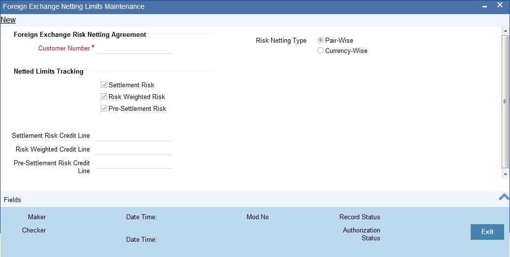

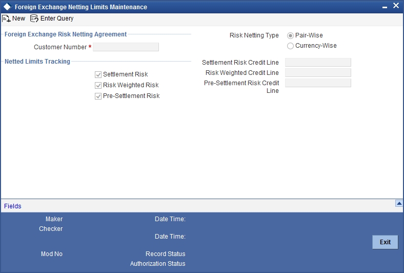

3.5.4 Maintaining FX Risk Netting Details
For FX transactions covered by netting agreement, the limit tracking should be carried out for the netted amount for the following risks:
You can do this using the ‘Foreign Exchange Netting Limits Maintenance’ screen. You can invoke the ‘Foreign Exchange Netting Limits Maintenance’ screen by typing ‘FXDLMNET’ in the field at the top right corner of the Application tool bar and clicking on the adjoining arrow button.
Customer Number
Specify the Customer or FX Netting group customer for which you are specifying the risk netting details. The adjoining option list displays all open and authorized CIF from Customer maintenance. You can choose the appropriate one.
Risk Netting Type
You can specify the type of risk netting to be followed for the selection of contracts. Risk netting can be one of the following:
In the Netting Type field, indicate if you would like to net contracts Currency-wise or Pair-wise. If you would like to net contracts Pair-wise, click on the button against Pair-wise. If you would like to net contracts Currency-wise choose the button against Currency-wise.
At the time of contract processing, the netting type that you specify for the customer will apply to all contracts involving the customer. You cannot override the limit netting type during contract booking.
By default, the Risk Netting Type is Currency-wise.
Settlement Risk
Select this option to specify that limit tracking is required on the netted amount for all FX being netted on the Customer. This option is unchecked by default. System considers this field as financial amendment, once amendment is done to this field.
Settlement Risk Credit Line
Select the credit line that should be used for netted settlement risk tracking from the option list provided. The list will display all valid credit lines for the counterparty.
Risk Weighted Risk
Select this option to specify that risk weighted limit tracking is required on the netted amount for all FX being netted on the Customer. This option is unchecked by default. System considers this field as financial amendment, once amendment is done to this field.
Risk Weighted Credit Line
Select the credit line that should be used for netted risk weighted limit tracking from the option list provided. The list will display all valid credit lines for the counterparty.
Pre-settlement Risk
Select this option to specify that pre-settlement limit tracking is required on the netted amount for all FX being netted on the Customer. This option is unchecked by default. System considers this field as financial amendment, once amendment is done to this field.
Pre-settlement Risk Credit Line
Select the credit line that should be used for netted pre-settlement limit tracking from the option list provided. The list will display all valid credit lines for the counterparty.
Oracle FLEXCUBE will ensure that credit lines maintained for the customer are not same. The system will support all maintenance actions like New, Unlock, Copy, Delete, Re-open and Close for this function.
Note
3.5.5 Specifying UDF Values
You can associate values to all the User Defined fields created and attached to the ‘Foreign Exchange Risk Netting Agreement’ screen. You can view the list of User Defined fields associated to this screen by clicking ‘Fields’ button in the ‘Foreign Exchange Netting Limits Maintenance’ screen.
3.5.5.1 Defaulting of Credit Lines

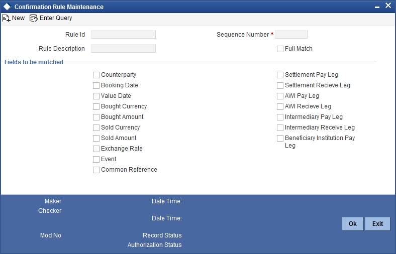

3.6 Confirmation Rule Maintenance
3.6.1 Invoking Confirmation Rule Maintenance Screen
Incoming FX confirmation messages can be matched automatically based on confirmation rules maintained. You can maintain confirmation rules using ‘Confirmation Rule Maintenance’ screen. You can invoke this screen by typing ‘FXDCNFMT’ in the field at the top right corner of the Application tool bar and clicking on the adjoining arrow button.
You can specify the following details:
Rule ID
Specify the unique ID for a rule.
Rule Description
Specify the description for the specified rule ID.
Sequence Number
The system displays the sequence number. You can modify this.
If there are multiple Rules, the processing for auto matching the messages will happen based on the sequence number in an ascending order.
Full Match
Check this box if the confirmation rule maintained is a Full Match Rule.
It will be mandatory to check all the above fields except the below mentioned fields if rule is to be maintained as ‘Full Match’:
You can maintain more than one rule as full match.
The system verifies the message details with the contract details based on the confirmation rules maintained. If single contract details are matched with message details for a ‘Full match’ rule then message is marked as completely matched and contract is marked as confirmed.
Fields to be matched
You can enable the following fields to match the details of an incoming SWIFT confirmation message MT300 with an existing deal in Oracle FLEXCUBE:
If ‘Full Match’ is checked, then the following fields are mandatory:\
If the outcome of a Full Match rule is satisfied with a single deal, then the system will mark the message as ‘Completely Matched’ and the deal as ‘Confirmed’.
If multiple contracts are matched with a ‘Full match’ rule, then the system will mark the message as ‘Partially Matched’.
Even if message and deal details are matched based on the listed fields in a rule which is not marked for Full Match, the system will mark the messages as ‘Partially Matched’. You should manually match the partially matched messages.

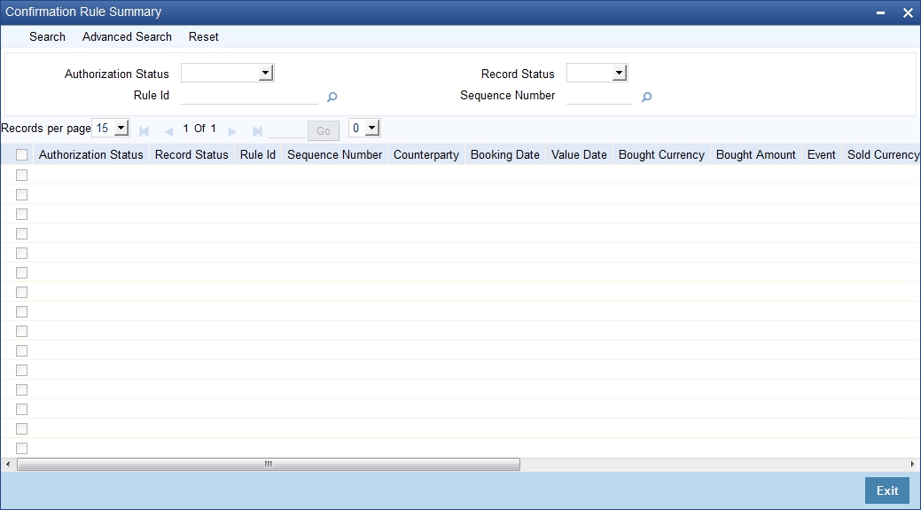

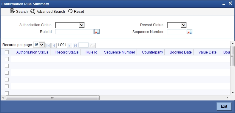

3.6.2 Viewing Confirmation Rule Maintenance Details
You can view FX confirmation rule details in ‘Confirmation Rule Maintenance Summary’ screen. You can invoke this screen by typing ‘FXSCNFMT’ in the field at the top right corner of the Application tool bar and clicking the adjoining arrow button.
In the above screen, you can base your queries on any or all of the following parameters and fetch records:
Select any or all of the above parameters for a query and click ‘Search’ button. The following records are displayed.:

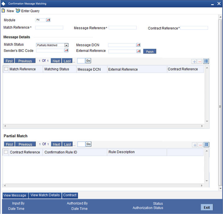

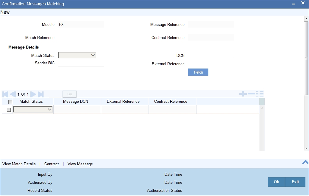

3.7 Confirmation Message Matching
3.7.1 Invoking Confirmation Message Matching Screen
You can query matched/partial matched/unmatched message details using ‘Confirmation Message Matching’ screen. All the Partially matched/unmatched SWIFT confirmation messages received in the system can be fetched in this screen based on the query options for further processing. You can link an unconfirmed and unmatched FX deal with a confirmation message and initiate the confirmation process. Since this is a Branch level operation, the system will display only the respective branch records. You can invoke this screen by typing ‘FXDMATCH’ in the field at the top right corner of the Application tool bar and clicking on the adjoining arrow button.
Module
Specify the module. Alternatively, you can select module details from the option list. The list displays all valid module ID maintained in the system.
Match Reference
Specify the match reference number.
Message Reference
Specify the message reference number.
Contract Reference
Specify the contract reference number.
Message Details
Match Status
Select the match status from the drop-down list. Following are the options available:
Message DCN
Specify DCN of MT300 messages in In-Browser which are Partially matched/unmatched.
Sender’s BIC Code
Specify Sender’s BIC of MT300 messages in In-Browser which are Partially matched/unmatched.
External Reference
Specify reference of MT300 messages in In-Browser which are Partially matched/unmatched.
Clicking on ‘Fetch’ button, the system will display the following details:\
The system will also display the following partial match records:
If a partially matched message is selected in the partial match block, then the corresponding contract reference number will get defaulted in the ‘Contract Reference’ field.
3.7.2 View Message Button
Click ‘View Message’ button in ‘Confirmation Message Matching’ screen to view the details of the message:

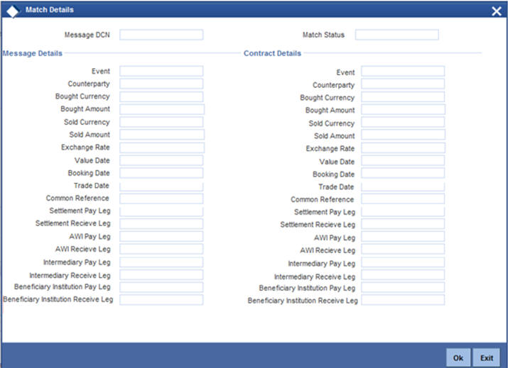

3.7.3 View Match Details Button
Click ‘View Match Details’ button in ‘Confirmation Message Matching’ screen to view match details based on the message and contract reference numbers, the following window is displayed:

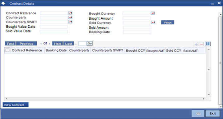

3.7.4 Contract Button
Click ‘Contract’ button in ‘Confirmation Message Matching’ screen to view the contract details.
3.7.5 View Message Button
Click ‘View Message’ button to view the details of a selected message.
