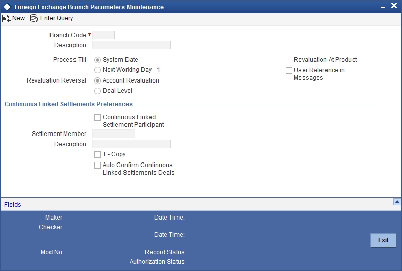

You can specify the CLS preferences as part of maintaining the generic processing guidelines for FX deals entered into at your branch. You can invoke the ‘Foreign Exchange Branch Parameters Maintenance’ screen by typing ‘FXDBRMNT’ in the field at the top right corner of the Application tool bar and clicking on the adjoining arrow button.
The branch code, along with the name of the branch for which the preferences are being maintained, will be defaulted to the screen.
Branch Code
Branch Description
Process Till
Select the date up to which FX deals should be processed in the branch.
The options are:
Revaluation Reversal
Revaluation entries can be reversed in either of two ways, according to your specification:
Revaluation At Product
By checking this box, you enable the passing of a consolidated revaluation entry at the product level for all forward FX contracts under that product.
User Reference Number in Messages
Based on the specification you make here, the system assigns the Tag 20 (Sender’s reference number) of an SWIFT message to either user reference number or contract reference number.
Check this box if you want the system to apply the user reference number for sender’s reference Tag 20 of the SWIFT messages sent.
If you leave the box unchecked, the system applies the custom reference number according to the format (or logic) defined for the product that the contract uses.
Note
This feature is applicable only for SWIFT messages sent out by Foreign Exchange module.
CLS participant
You have to select this option to identify the branch as a CLS participant. This will enable you to process the FX deals entered into at your branch via the CLS bank.
Only after you mark the branch as a CLS participant, you will be allowed to maintain the following CLS preferences:
Settlement Member
Here, you have to select the BIC Code of the customer who will be the intermediary /settlement member through whom the FX deals of your branch will be routed to the CLS bank. The Messaging System of Oracle FLEXCUBE will identify this customer as the receiver of the MT 304 (Confirmation Message/ Advice of a Third Party deal).
T- Copy
This is applicable if the counterparty is a SWIFT member. If you specify that ‘T-Copy’ is required, the SWIFT media will send the CLS Confirmation Message (MT300) to the counterparty of the deal with a copy to your settlement member. If multiple addresses are maintained, MT300 will be sent to the location, which is marked as the counterparty’s primary address.
If the third party does not subscribe to T-copy or if the counterparty is not a SWIFT member, Oracle FLEXCUBE will automatically generate the MT304 message and identify the BIC of the Settlement Member (where your branch is the Third Party participant) as the receiver of the message. In such a case, MT300 will be a normal confirmation, which will be sent to your counterparty if it is a SWIFT subscriber.
If you check T - Copy, the system will include the TPS identifier in MT300 message for CLS NDF deals. However, the system will not generate MT304 message for the message type FS_FMCONF.
Auto-Confirm CLS Deals
You may select this option to enable the system to automatically confirm the CLS deals processed at your branch. In this case, the system will ignore the MT300 received from the counterparty and mark the confirmation status as ‘Confirmed’.

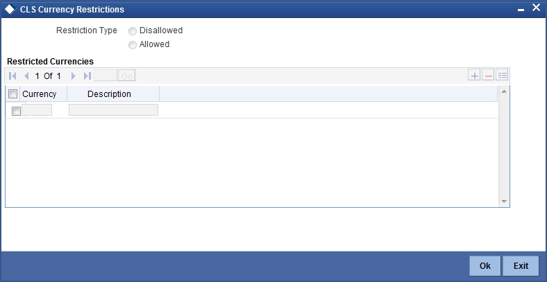

When setting up currency details in the ‘Currency Definition’ screen, you can allow a currency to be CLS compliant by selecting the ‘CLS Currency’ option. FX deals in the CLS currency only will be eligible to be routed through the CLS bank.
Further, from the available list of CLS currencies, you can maintain a list of ‘allowed’ or ‘disallowed’ currencies for a specific customer. This is explained in the following section.
Refer the Core Services User Manual for more information on maintaining currency details in Oracle FLEXCUBE.
At the time of maintaining the details of a customer in the ‘Customer Information Maintenance’ screen, you can mark the customer as a ‘CLS Participant’. To invoke this screen, click on Customer Maintenance in the Application Browser, select Customers and click on Detailed under it. You can also invoke this screen by typing ‘STDCIF’ in the field at the top right corner of the Application tool bar and clicking on the adjoining arrow button.
You will be allowed to capture currency restrictions only for customers who are CLS participants. You can maintain a list of allowed or disallowed currencies for CLS trading, in the ‘CLS Currency Restriction’ screen. Click on the ‘CLS Restrictions’ button in the ‘Customer Information Maintenance’ screen to invoke it.
However, you have to ensure that the branch at which the customer operates is also qualified to process CLS deals i.e. the branch should also be marked as a CLS Participant (refer the section titled ‘Maintaining CLS Preferences for the branch’ in this chapter) before allowing the same for the customer.
All the currencies that are allowed for CLS trading will be listed as available currencies. You may define a list of allowed or disallowed CLS currencies for a specific customer. By default, every customer who is a ‘CLS Participant’ will be allowed to trade in all the available CLS currencies unless specifically mentioned. Only if the customer is allowed to transact in a CLS currency, the particular deal will be eligible for CLS trading.

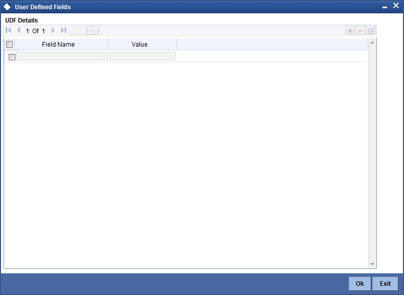

You can associate values to all the User Defined fields created and attached to the ‘CLS Currency Details’ screen.
You can view the list of User Defined fields associated to this screen by clicking ‘Fields’ button on the ‘CLS Currency Details’ screen.
You can enter the value for the UDFs listed here in the ‘Value’ column.
For more details on how to create user Defined fields, refer chapter ‘Creating custom fields in Oracle FLEXCUBE’ in the User Defined Fields User Manual under Modularity.

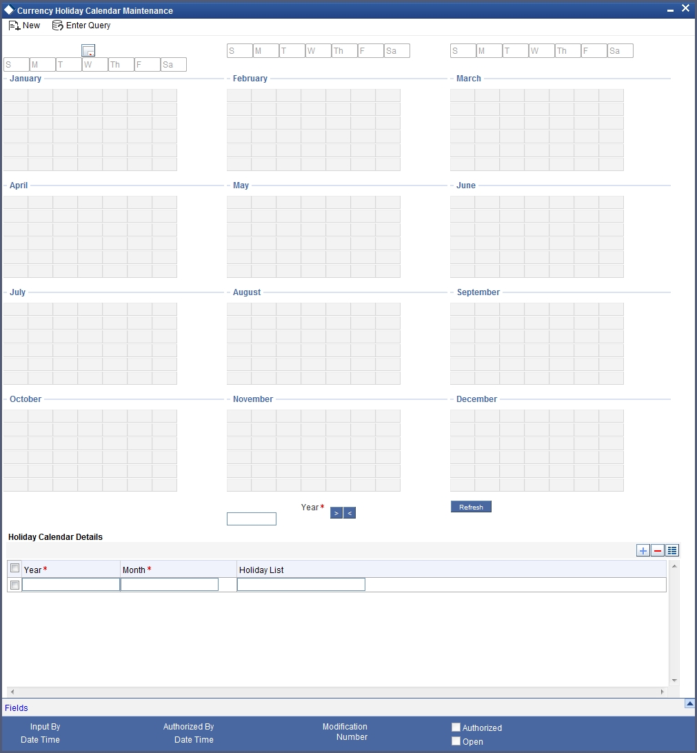

You can maintain a holiday calendar for the CLS Bank through the ‘CLS Holiday Calendar Maintenance’ screen.
You can invoke the ‘CLS Holiday Calendar Maintenance’ screen by typing ‘FSDLCHOL’ in the field at the top right corner of the Application tool bar and clicking on the adjoining arrow button.
At the time of booking a CLS deal, the system will use the CLS Bank holiday calendar to check if the value date of the contract falls on a holiday. If the value date falls on a holiday, the deal will not be saved as a CLS deal. The system will process it as a normal FX transaction.

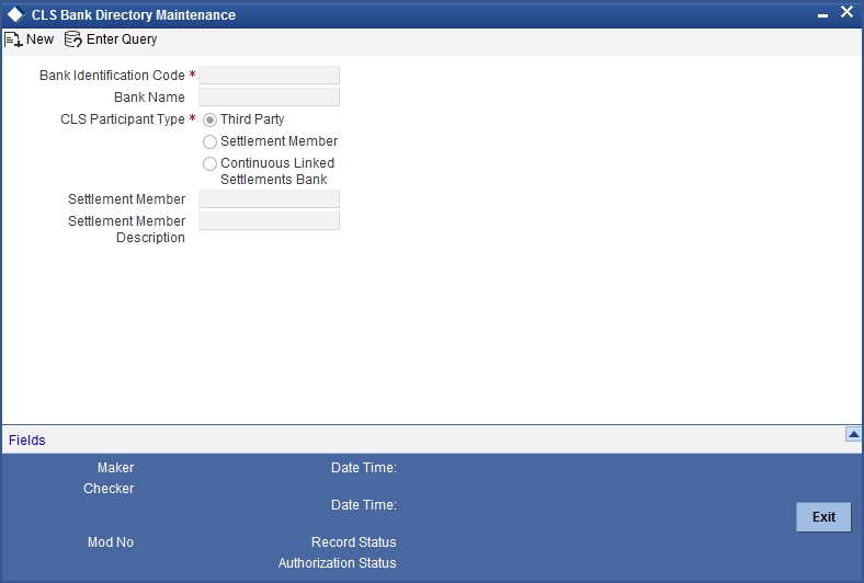

After you identify a customer to be a CLS participant, you have to specify the type of relationship the customers/financial institutions have with the CLS bank. This can be done through the ‘CLS Directory’ available in the Application Browser.
You can invoke the ‘Continuous Linked Settlement Bank Directory Maintenance’ screen by typing ‘FSDBICDI’ in the field at the top right corner of the Application tool bar and clicking on the adjoining arrow button.
Specify the following details.
Bank Identification Code
You have to select the BIC of the CLS party to determine the participant type. On selection of the BIC, the name of the customer is displayed alongside.
CLS Participant Type
You can identify a CLS party as a ‘Direct’ or an ‘Indirect’ participant. The system will use the participant type as a criterion to determine the CLS eligibility of an FX deal. The participant type can be one of the following:
Settlement Member
As stated above, if the participant type is defined as ‘Third Party’, the CLS deals will be processed via a settlement member. You have to select the BIC of the Settlement Member in this field. The name of the member will be displayed alongside.

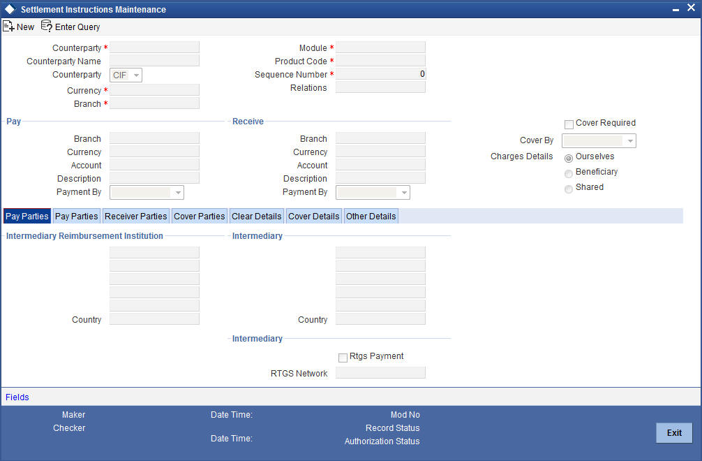

You can maintain the settlement preferences for a customer in the ‘Settlement Instructions Maintenance’ screen. You c
an invoke the ‘Settlement Instructions Maintenance’ screen by typing ‘ISDINSTN’ in the field at the top right corner of the Application tool bar and clicking on the adjoining arrow button.
You have to maintain the settlement instructions exclusively for CLS deals. For this, you have to select the module ‘FS’ (FX Settlements) which will indicate that the instructions are applicable to CLS deals alone.
For the ‘FS’ module, the system will perform the following validations:
Counterparty Type
The counterparty is of the ‘CIF’ type.
Counterparty
The counterparty is a specific customer who is identified as a ‘CLS Participant’ (in the ‘Customer Information Maintenance’ screen). You cannot select the counterparty ‘ALL’ in this case.
Currency
The currency is a specific currency, which is eligible to participate in CLS deals (this is defined in the ‘Currency Definition’ screen). In addition, the currency should be allowed for the counterparty and the CLS participant branch. The CLS Currency Restrictions maintained for the customer will be used to verify the same.
Product Code
If you have selected a specific product, it should necessarily be an ‘FX’ product. Otherwise, the product should be ‘ALL’.
Branch
The branch that you select is identified as a ‘CLS Participant’ (in the ‘FX Branch Parameters – CLS Preferences’ screen). This validation will not be applicable if you select the branch code as ‘ALL’.
Parties
The different parties involved are maintained in the ‘CLS Directory’.
The debit and credit accounts maintained for the module ‘FS’ and ‘CLS Currency’ combination will be referred to as the ‘Control Accounts’ and will be debited/credited on liquidation of a CLS FX deal. Entries will be posted to the Control Accounts at the individual deal level. On receipt of pay-out/pay-in advice from the settlement member, you can pass a net entry to the Control Account and post the other leg to the Real CLS Nostro account.
Refer the Settlements User Manual for more information on maintaining settlement instructions for customers.

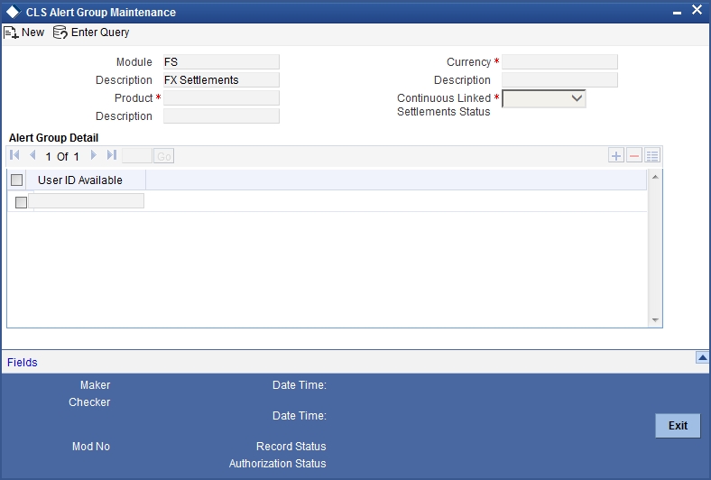

You can maintain an alert group for a specific CLS Status. The alert will be generated for the selected group of users alone. The ‘CLS Alert Group’ screen is used for this purpose.
You can invoke the ‘CLS Alert Group Maintenance’ screen by typing ‘FSDALRTG’ in the field at the top right corner of the Application tool bar and clicking on the adjoining arrow button.
The alert group is defined for a combination of Branch, Module, Product, Currency, and CLS Status. The values of the fields should be as follows:
Module
This defaults to ‘FS’ (Foreign Exchange Settlements).
Product
Select a specific product or else ‘ALL’.
Currency
Select a specific currency or ‘ALL’
CLS Status
The CLS Status for which you require the alert. If the status of a CLS deal or an alleged trade is updated to the CLS status maintained in CLS Alert ZGroup Maintenance, the system generates an alert to the specific users.
User Id Available
From the available list of user ids (the list will contain only those user ids, for which the CLS participant branch is the home branch), you have to select the users who have to receive the alert for any deal that is with the above status. You can select the users whose home branch is the CLS participating branch itself. The selected users will receive alerts for deals with the CLS status maintained.
The product and currency combination should be as follows:
| Product | Currency | ||
| Specific | Specific Bought/Sold | ||
| Specific | ALL | ||
| ALL | ALL | ||
| ALL | Specific Bought/Sold |

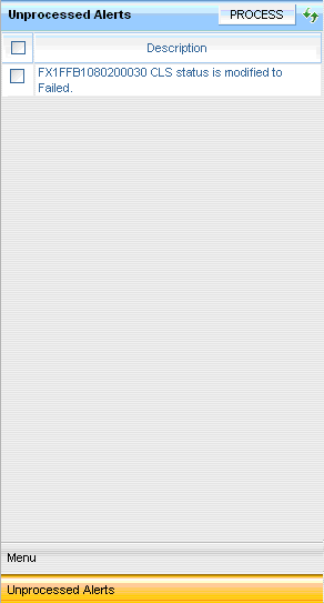

You can retrieve the alerts from ‘Unprocessed Alert Browser’ on Oracle FLEXCUBE.
From this browser, you can manually select an alert and process it. Use the checkbox adjoining an alert and click ‘Process’ button. Processed records will not be displayed on the browser anymore.
