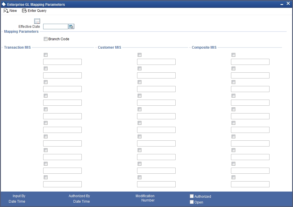

You can map different combinations like the GL code and currency in Oracle FLEXCUBE to a GL in the Enterprise GL system. These parameters can be maintained for a given effective date and any modification made will be effective from corresponding business date. Change in the mapping will not have any effect on the historical information that has been already extracted or handed off.
You can invoke the ‘Enterprise GL Mapping Parameters’ screen by typing ‘EGDMAPRM’ in the field at the top right corner of the Application tool bar and clicking the adjoining arrow button.
Mapping parameters can be chosen as any of the following fields:
Effective Date
The date from which mapping is effective is displayed here. This field is always defaulted to the application date and you can not change it.
Branch Code
Check this option if you wish to include branch as on of the mapping parameters
Transaction MIS
The system displays all the transaction MIS classes defined in Oracle FLEXCUBE. However only the ones that have been defined as ‘mandatory’ in the MIS Class Maintenance screen will be enabled. Choose the class that you want to include in the mapping parameters.
Customer MIS
The system displays all the customer MIS classes defined in Oracle FLEXCUBE. However only the ones that have been defined as ‘mandatory’ in the MIS Class Maintenance screen will be enabled. Choose the class that you want to include in the mapping parameters
Composite MIS
The system displays all the composite MIS classes defined in Oracle FLEXCUBE. However only the ones that have been defined as ‘mandatory’ in the MIS Class Maintenance screen will be enabled. Choose the class that you want to include in the mapping parameters
