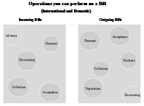

In Oracle FLEXCUBE, all types of bills are classified in to two categories.
They are:
- Import Bills
- Export Bills
All types of incoming bills (international and domestic) financed
by your bank are termed Import bills. Similarly, all outgoing bills (international
and domestic) financed by your bank are termed Export bills.
The operations that you can perform on an Islamic bill have been diagrammatically
represented below:
The system
allows you to effect a change of operation for the following operation
types:
- Acceptance to Advance (automatic facility provided)
- Acceptance to Discount
- Collection to Purchase
For instance, while processing an acceptance bill, which needs to
be discounted, you need not enter a new bill to discount the bill. You
need to just amend the operation type from acceptance to discount.
