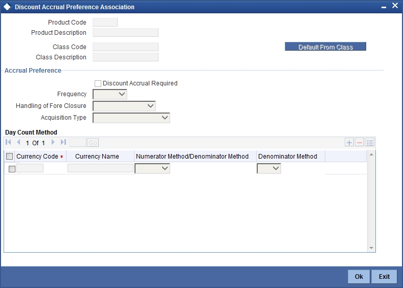

Refer to the chapter titled ‘Defining Discount Accrual Fee Classes’ for more information on discount accruals.
While processing a bill involving the product, you need to book a bill under Discount. If you change the Operation to Collection, the accounting entries defined for BCOL will be passed. When the bill is liquidated, the accounting entries defined for LCOL will be passed.
This operation type is treated as a foreclosure and outstanding discount accruals are completed unconditionally when the operation is carried out before the maturity date of a BC contract linked to the product.
You can refer to the chapter titled ‘Defining Discount Accrual Fee Classes’ for more information on discount accruals.

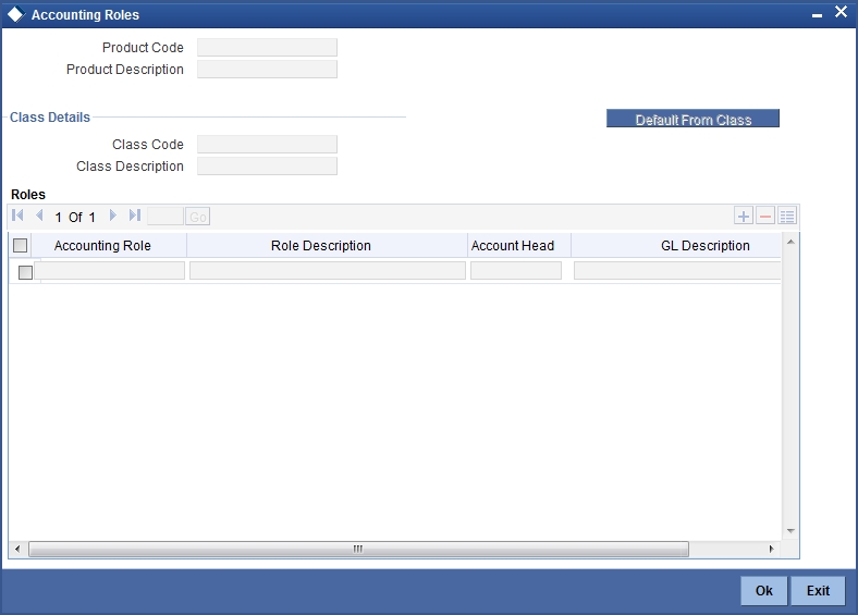

Click the ‘Accounting Roles’ button to define Accounting Roles for the product you are creating.
In the screen that corresponds to this icon you can map Accounting Roles to Accounting Heads.
For more information on specifying Accounting Roles, refer ‘Products’ User Manual under ‘Modularity’.

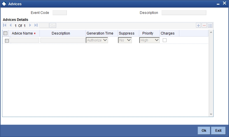

Click the ‘Events’ button to invoke the ‘Bills - Product Events’’ screen. Through this screen, you can specify the details of the Accounting Entries and Advices that have to be generated for the events that take place during the life cycle of a bill.
For more information on specifying Event Details, refer ‘Product Definition’ User Manual under ‘Modularity’.

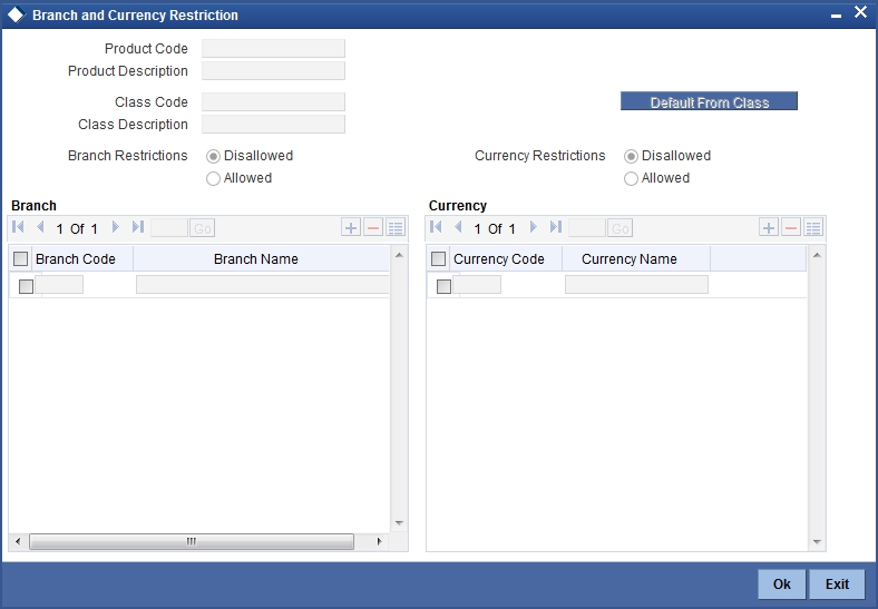

Click the ‘Branches & Currency’ button to invoke the ‘Branch/Currency Restriction’ screen. In this screen you have the option of allowing all the branches of your bank to use the product or restricting its use to only some branches. By default when a new product is created no branches will be disallowed.
You can also specify the currencies allowed or restricted for the product. This currency corresponds to the Bill currency. By default when a new product is created no currencies will be disallowed.
For more information on specifying Branch Details, refer ‘Products’ User Manual under ‘Modularity’.

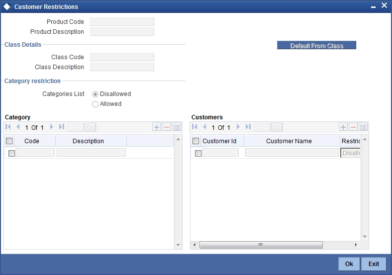

Click the ‘Customer’ button to invoke the ‘Customer Restrictions’ screen.
In this screen you can specify the categories of customers or the customers themselves with whom you can enter into bills involving the product.
For more information on specifying Customer Details, refer ‘Products’ User Manual under ‘Modularity’.

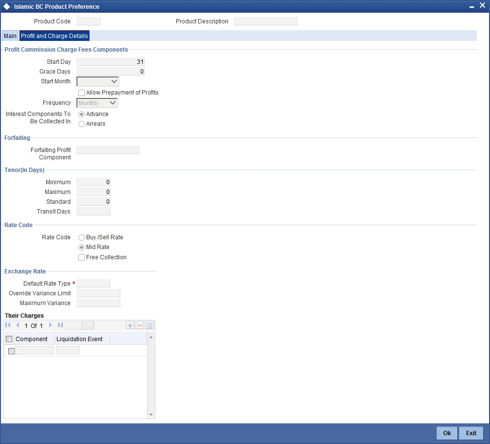

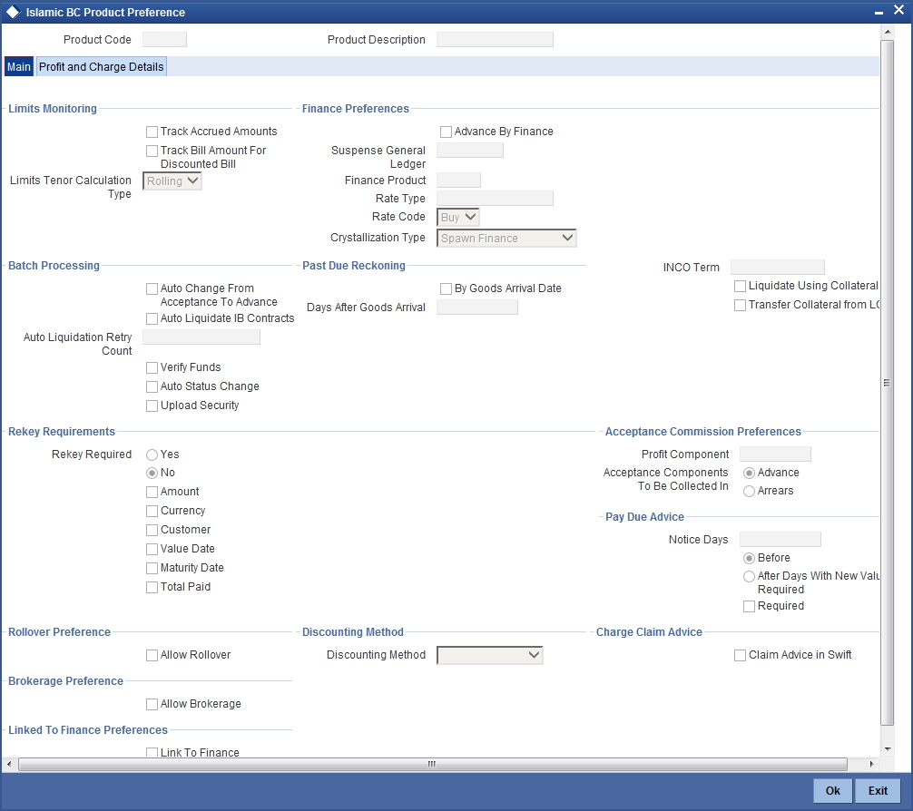

Preferences are the options available to you for defining attributes that will help distinguish a product. The preferences that you state will ultimately shape the product.
By default, a bill involving a product inherits all the attributes defined for the product. However the attributes defined as the product’s preferences can be changed for a bill. Click the ‘Preferences’ button to invoke the ‘Islamic BC Product Preference’ screen.
Through this screen you can define preferences for the product you are creating.
This section contains the following topics
The Preferences that you define for a product will be made applicable to all Bills involving the product. The preferences that you can define for a product are discussed below.
You can capture the following details regarding Limits Monitoring.
Track Accrued Amounts
You have to specify whether the accrued profit of bills that have not yet been paid should also be considered as the utilized amount for the purpose of credit administration. You can make more than one profit type of component applicable to a bill product. In such a case, one type is designated as the main profit. The following example illustrates how this concept works.
Track Bill Amount for Discounted Bill
Under a discounted bill, the profit that is calculated for the bill is deducted at the time of initiating the bill.
For the purpose of limits tracking, you should indicate whether the actual bill amount or the discounted amount should be tracked, against the limit assigned to the customer under a Credit Line.
Check against this field, to indicate that the actual bill amount should be considered for the purpose, of limits tracking. Leave it unchecked to indicate that the discounted amount should be considered.
Limits Tenor Calculation Type
For tenor-based bills, you can indicate the type or manner in which the bill needs to be tracked. The tenor calculation type can be either of the following:
If you indicate fixed for a tenor-based bill, through out its tenor, it will be tracked against the relevant credit line.
In this section specify the following details:
Advance by Financing
Checking this option allows you to book finance. Finance booking is allowed only during final liquidation and is not allowed during partial liquidation of bill. Once you have opted for this option, you need to specify the finance product and the bridge GL in the consecutive fields.
Note
You are allowed to create finance only for import bills that are of Acceptance type.
Suspense General Ledger
To create finance, you need to transfer the principal from Bills to Finances. For this purpose, a Bridge GL has to be specified in this field. Select the GL from the option list.
The Suspense GL selected as a part of the crystallization preferences is used as a bridge for transfer of the charges in bill contract transferred from the LC.
Note
The system displays only GL’s in the option list and will not display any customer accounts.
Financing Product
After opting to book finance, you need a finance product to create finance. Choose the finance product from the option list. The finance will be created using this product at the time of liquidating the bills.
Note
Only Finance products will be displayed in the option list.
Rate Type
Select the appropriate rate type in case the charge / commission components transferred onto the finance are in different from the finance currency, from the option list. This exchange rate will also be used in the case of the finance currency is different from the bill currency to arrive at the finance amount.
Rate Code
Select the appropriate rate code in case the charge / commission components transferred onto the finance are in different from the finance currency, from the option list. This exchange rate will also be used in the case of the finance currency is different from the bill currency to arrive at the finance amount.
Crystallization Type
Select the type of bill crystallization from the drop down list. The two values allowed here are Spawn Finance and Linked Contracts.
Note
If the crystallization type parameter is set to – linked finance, the Auto liquidate Flag in the BC contract would be set to ‘Y’ and the user shall not be allowed to modify the same.
In case of linked contracts, the finances amount is computed at the time of booking of the finances contract.
If the charges and commission in the bill, carried forward from the LC are to be a part of the crystallized finance and are defined in a currency different from the finance currency, the system uses the rate type and rate code maintained as a part of the bills crystallization product preference.
Since the actual crystallization event which performs the accounting for the charges occurs at a later date (on the initiation date of the finance or the maturity date of the bill), the exchange rate, if a re pickup is done, can be different from the one used to arrive at the finance amount. In order to overcome this discrepancy, the system internally stores the exchange rate used in the computation of the finance amount as a part of new charges and commission transfer.

The Past Due Status preferences that you define for a product default to the bills processed under it.
By Goods Arrival Date
In the ‘Islamic BC Product Preferences’ screen, you can indicate if the past due status (of bill contracts entered under the product) should be determined with respect to the Goods Arrival Date.
Days after Goods Arrivals
If you opt to determine the past due status with respect to the Goods Arrival Date, you can enter the number of days vis-à-vis the Goods Arrival Date that should determine the past due status. The following example illustrates what this implies.
You can specify the following preferences related to Batch Processing:
Auto Change From Acceptance to Advance
A product to cater to the acceptance type of bills is being created. You can indicate whether the bills linked to this product, should be automatically converted into a payment type of bill, on its liquidation date.
Auto Liquidate BC Contracts
Components of a bill can be liquidated automatically or manually. In the Product Preferences screen, you can indicate whether the mode of liquidation is to be automatic or manual.
If the automatic mode of liquidation is specified, a bill will be automatically liquidated on the day it falls due, by the Contract Auto Liquidation function run as part of the BOD processing. If a bill for which you have specified auto liquidation matures on a holiday, the bill will be processed based on your holiday handling specifications in the Branch Parameters table.
If you do not specify auto liquidation, you have to give specific instructions for liquidation through the Manual Liquidation screen on the day you want to liquidate the bill.
Verify Funds
Check this option to check the available balance in settlement account of a bills contract during its auto liquidation. If you check this option, the system verifies the balance only to cover the bill amount. Charges associated with the bill liquidation will not be considered.
If the account has insufficient funds during manual liquidation of a bills contract, the system does not generate advices to issuing bank and claiming bank. An error message is displayed in such instances.
Auto Status Change
A status change is one in which the status of a bill changes from one to the next.
If you specify that status changes have to be carried out automatically, the status of the bill will be changed after the specified number of days. If not, you have to change the status of a bill, through the bill processing function. In the Bills - User Defined Status Maintenance screen, you can specify whether the status change should be in the forward or reverse direction. Other details related to the status change can also be specified here.
Even if automatic status change has been specified for a product and therefore a bill involving it, you can manually change the status of a bill, before the automatic change is due. It can be done through, the Contract On-line Details screen.
If a product has been specified with manual status change, you cannot specify automatic status change, for a bill involving the product.
Note
You will be allowed to specify whether automatic status change should be in the forward or reverse direction in the status maintenance screen only if you specify that automatic status change is allowed for the product.
Upload Security
This needs to be checked if the Bills contract is to be considered as Banker’s Acceptance and uploaded as an instrument into the Securities module. The value date of the Bill would be the issue date of the Security and maturity date will be mapped to the redemption date of the security. The Bill amount will be uploaded as the initial and current Face Value of the security.
Liquidate Using Collateral
Check this box to indicate that the bill should be liquidated using the collateral account instead of customer account if the collateral account has sufficient funds.
Transfer Collateral from LI
Check this box to indicate that the collateral amount obtained during LI creation should be transferred to the Bill availed under LI proportionately. This flag is defaulted from product level and can be modified at contract level after which it cannot be changed.

For handling Rollover, you will have to maintain two events and associate the relevant accounting roles and amount tags while defining the Bills Product. The two events are:
The system posts the following accounting entries when rollover is initiated manually on the bills contract:
| Event | Dr./Cr. Indicator | Accounting Role | Amount Tag | ||||
| ROLL | DR | ROLL_BRIDGE_GL | PRINCIPAL_ROLL | ||||
| ROLL | CR | ADV UNDER LCS | PRINCIPAL_ROLL | ||||
| INIT | DR | ADV UNDER LCS | PRINCIPAL_ROIN | ||||
| INIT | CR | ROLL_BRIDGE_GL | PRINCIPAL_ROIN |

Click the ‘Profit and Charge Details’ tab to specify the profit and charged details.
Start Day
In the case of monthly, quarterly, half yearly or yearly accruals, you should specify the date on which the accruals have to be done during the month. For example, if you specify the date as 30, accruals will be carried out on that day of the month, depending on the frequency.
If you want to fix the accrual date for the last working day of the month, you should specify the date as 31 and indicate the frequency. If you indicate the frequency as monthly, the accruals will be done at the end of every month. That is, on 31st for months with 31 days, on 30th for months with 30 days and on 28th or 29th, as the case may be, for February.
If you specify the frequency as quarterly and fix the accrual date as 31, the accruals will be done on the last day of the month at the end of every quarter. It works in a similar manner for half-yearly and yearly accrual frequency.
Grace Days
The grace period specifies the period after the repayment date, within which the compensation profit (if one has been defined for the product) will not be applied, even if the repayment is made after the due date. This period is defined as a specific number of days and will begin from the date the repayment becomes due.
Compensation profit will be applied, on a repayment made after the grace period. The compensation profit will be calculated for the entire period it has been outstanding (that is, from the date the payment was due).
Start Month
If you set the accrual frequency as quarterly, half yearly or yearly, you have to specify the month in which the first accrual has to begin along with the date.
Frequency
Apart from the bill amount, a bill can have other components, such as profit, charges or fees. They can be accrued over the tenor of the bill. The frequency, at which these components should be accrued, can be specified as a Product Preference.
The attributes of the other components are defined in the ICCF sub-system of Oracle FLEXCUBE. However the frequency with which the components should be accrued is specified in this screen.
The system carries out automatic accruals at the frequency specified by you, as part of the End of Cycle processing. However, if the accrual date falls on a holiday, the accruals are done as per your holiday handling specifications in the Branch Parameters screen:
The frequency can be one of the following:
Profit Collection Type
After choosing the profit component, you need to specify the mode in which the Profit is to be collected. Indicate this by choosing either:
Forfeit Profit Component
For bills that can be forfeited, you need to specify the profit component at the product preference level. The adjoining option list displays all the profit components (except the main profit component) attached to the product. You can select the appropriate one.
You can set the Standard, Minimum and the Maximum limits for tenor based bills. The tenor details that you specify for a bill product, is always expressed in days.
Minimum
You can fix the minimum tenor of a product. The tenor of the bills that involve the product should be greater than or equal to the Minimum tenor that you specify.
Maximum
You can fix the maximum tenor of a product. The tenor of the bills that involve the product should be less than or equal to the Maximum tenor that you specify.
Standard
The standard tenor is the tenor that is normally associated with a bill, involving a product. The standard tenor of a bill is always expressed in days and is applicable to all bills involving the product. If you do not specify any specific tenor while processing a bill, the standard tenor will be applicable to it. However, the standard tenor applied on a bill can be changed during bill processing.
Note
You can create a product with the standard tenor as zero. While processing a bill involving such a product, you will need to specify the maturity and the expiry date of the bill.
If you attempt to save the bill without entering the expiry or maturity date you will be prompted for an override.
Transit Days
The transit days is used to compute the maturity date of the bill. Enter the transit days for the bill. The system does not allow you to save the record in case the transit day exceeds the standard tenor.
Buy/ Sell Rate
Select this option if you want to specify Buy/Sell rate for exchange.
Mid Rate
If it is a cross currency bill the exchange rate that has to be used for conversion can be mentioned as MID/BUY/SELL rate. Select this option if you want to specify the exchange rate as Mid rate.
Free Collection
Check this option if you wish to use the product for free collection.
You can capture the details regarding the exchange rate here.
Default Rate Type
You can specify the exchange rates that are to be picked up and used for, liquidating the Bill Amount, Profit and Charge components of a bill. You can indicate that the standard rate prevailing, as of the issue date of the bill should be used. You can also specify an exchange rate of your choice.
The possible values for the rate pickup are:
If you specify ‘As input’ in the contract, then the system computes the components of the bill, based on your input in the Exchange rate field, in the Bills Contract Main screen.
If you choose ‘As per standard rate’ the system computes the applicable components, by picking up the exchange rates as of the transaction date, from the Currency table maintained in the Core Services module of Oracle FLEXCUBE.
For a Bills product, you can specify the exchange rate type to be used to process the bill amount, the profit, charge or fee components of the bill. At the time of entering a contract involving a product, you have the option of, changing the exchange rate defaulted from the product and specifying an exchange rate, of your choice.
The exchange rate variance is applicable only if you have decided to change the standard rate defaulted from the currency table and if the contracts linked to the product involves a foreign currency.
You can specify the minimum and maximum limit by which, the exchange rate entered for contracts involving this product can exceed the standard exchange rate.
In the ‘Override Variance Limit’ field, specify the minimum percentage over which you can exceed the normal exchange rates.
Maximum Variance
In the Maximum Variance field specify the maximum percentage up to which you can exceed the normal exchange rate.

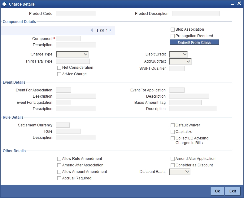

Their Charges
Here you can define the charge component for the charges that are due to the counterparty bank.
Click the ‘Charges’ button to invoke the ‘Charge Details’ screen. In this screen, you can define the charge component for the charges that are due to the counterparty bank.
The steps involved in processing charges for a contract, i.e. defining charge rules, defining charge classes, associating charge classes with a product, and amending charge details to suit a contract are explained in the Building Charge Components User Manual.

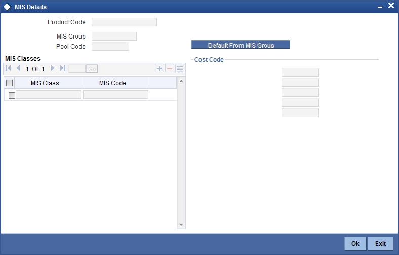

Click the ‘MIS’ button to define Management Information Details (MIS) details for the product you are defining.
For more information on specifying MIS Details, refer ‘Products’ User Manual under ‘Modularity’.

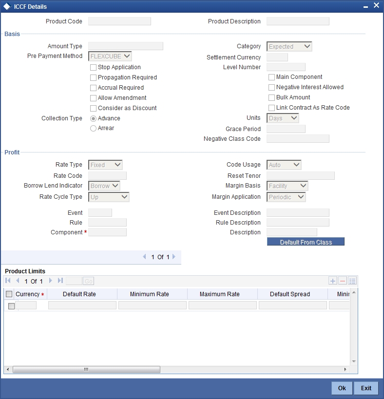

Click the ‘Profit’ button to define the Profit that is to be collected for Bills involving this product.
For more information on specifying ICCF Details, refer ‘Interest’ User Manual under ‘Modularity’.
Click ‘Discount Accrual’ button to invoke the ‘Discount Accrual Preference Association’ screen. Refer to the Discount Accrual chapter in the same user manual for more details.
For more information on discount accruals, you can refer to the chapter titled ‘Defining Discount Accrual Fee Classes’ in this manual.

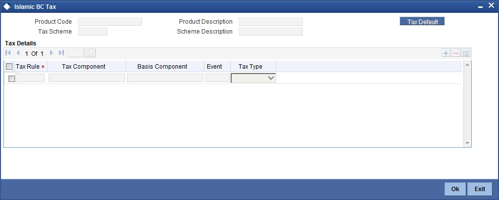

Click the ‘Tax’ button to indicate the tax schemes that are applicable to the product you are creating.
For more information on specifying Tax details, refer ‘Tax’ User Manual under ‘Modularity’.

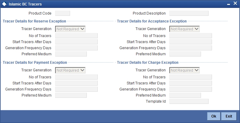

Tracers are reminders, sent to various parties involved in a bill indicating that an exception that has occurred, while processing the bill.
In this screen you can capture tracer details for the following exception events:
Reserve Exception – sent by negotiating bank (for bills under LC), if discrepancies are noted and negotiation is done under reserve (right of recourse). The tracers are for reminding resolution of the discrepancies and get stopped when the respective discrepancy is marked as resolved.
The details specified for the product involved in the bill will be defaulted to the contract. You can change the defaults to suit the requirements of the bill you are processing. Click the ‘Tracers’ button to invoke the ‘Islamic BC Traders’ screen.
You can specify the following details here:
Tracer Generation
You can indicate whether the exception tracer is applicable to the bill you are processing. You can select one of the following options:
Number of Tracers
If you have indicated that the tracer is applicable, to the bill you are processing, you should also specify the maximum number of tracers that should be generated, for each of the exception events.
By default, the first tracer for all authorized bills linked to this product, will be sent after the number of days that you prescribe, for the product.
Start Tracer after Days
Exception tracers can be generated, only after the maturity date of the bill. While creating a product, you have also indicated the number of days that should elapse after the Bill matures on which the first tracer should be generated.
Generation Frequency Days
You can specify the frequency (in days), with which the tracer should be sent to the concerned parties, involved in the bills linked to this product.
Preferred Medium
For each of the exception tracers that you specify, indicate the preferred medium through which the tracer should be generated to the concerned party.
For a bill involving the product, you can change the medium that is defaulted. The medium you specify here is only the preferred medium, for the exception tracer.
Template ID
Specify the template related to MT799 or MT499 message types. The adjoining option list displays all the templates related to MT799 (if it is under LI) or MT499 (if it is not under LI) message types defined in the ‘Swift FFT Template Screen Maintenance’ screen. You can choose the appropriate one.
This field is mandatory if the ‘Tracer Generation’ is indicated as ‘Required’ and ‘Preferred Medium’ as ‘SWIFT’. This Template id is used while generating Charge and Commission Tracer (CHG_COM_TRACER) in MT799/MT499 swift format as part of LQ EOD Batch if the ‘Preferred Medium’ is ‘SWIFT’.
For further details on Swift FFT Template Screen Maintenance screen, refer the section ‘Maintaining SWIFT FFT Template’ in the ‘Defining Free Format Messages‘ chapter in the ‘Messaging System’ User Manual.

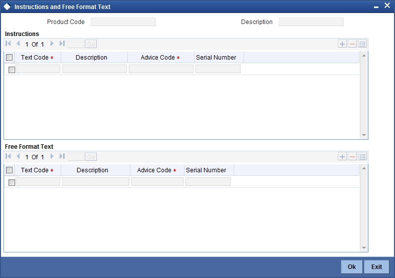

Free Format Texts (FFTs), Instructions and Document codes applicable to the product you are creating can be defined here. These FFTs and Instructions can appear along with the advices that are generated, during the lifecycle of the Bills linked to this product.
Click the ‘Free Format Text’ button to invoke the ‘Bills and Collections Product – Instructions and Free Format Text’ screen.
In this screen specify the FFTs that are applicable, to the bills product you are creating. A list of the standard FFTs that can accompany a bill is maintained in the ‘Free Format Text Maintenance’ screen. You can select an FFT code from the pre-defined list of FFTs. The description associated with the FFT code you have selected will be displayed.
More than one of the predefined FFTs can be specified for the product you are creating. The FFTs, including the other details that you define for it will be defaulted to all bills involving this product.
While entering a bill contract involving this product, you can however, add to or delete from the defaulted list of FFTs.
You have an option to specify whether the FFT or instruction is for the internal reference of the bank or should it appear on the advices generated, for the bills linked to the product.
If you do not specify an advice code for an FFT or instruction it is assumed that it is for the internal reference of the bank. If the FFT is to appear on the advices, you can specify the advice on which, the FFT or Instruction should be printed. Select an advice code from the list of the advices that you specified for the product, in the Advices screen.
After you have specified details for an FFT, click add icon to add it to the list of FFTs, for the product. Click delete icon to delete an FFT from the screen.
Oracle FLEXCUBE provides you with the facility to automatically debit customers of the charges you incur in sending them advices over different media types. When creating a product, you can set up these charges. However, when processing a contract, you can opt to waive these charges.
At the time of saving a contract, the system displays the ‘Product Event Advices Maintenance’ screen wherein you will be allowed to:
If you indicate that the customer is the receiver of charges, the system automatically locates the relevant Receiver, Media and Country combination from the available Charge Maintenance Details records, and deducts the charge amount associated with the particular combination. The Charge amount is deducted from the customer account in the specified currency.
Note
If you have not maintained a Charge Maintenance Details record for the particular customer, the system uses the wildcard entry type record to deduct the charge amount.
Through this screen, you can specify the instructions that are applicable to the Bills product you are creating. A list of the standard instructions that can accompany the bill is maintained in the ‘Instructions Codes Maintenance’ screen. Select an Instruction code from the list of instructions maintained earlier.
More than one of the predefined Instructions can be made applicable to the product you are creating. The instructions, including the other details that you define for it, will be defaulted to all bill contracts, involving this product.
However, while entering a bill involving this product, you can add to or delete from the defaulted list of instructions.
You have the option to specify whether the instruction is for the internal reference of your bank or should it appear on the advices generated for the bills linked to the product.
If you do not specify an advice code for an instruction it is treated as an internal instruction. If the Instruction is to appear on the advices, you can specify the advice on which, the Instruction should be printed. You can select an advice code from the list of the advices in the Advices screen.
After you have specified details, of the Instructions applicable to a product, click add icon to add it to the list of instructions, for the product. Click delete icon to delete an instruction from the screen.

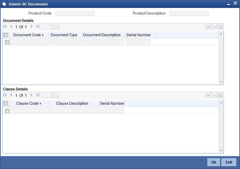

In addition to the Instructions and FFTs that you specify for a product, you can also specify the documents and clauses. Click the ‘Document' button to invoke the Islamic BC Document’ screen to specify the documents and clauses applicable to the product you are creating.
The documents that can be associated with a bill are broadly classified into:
There are certain standard documents that are required, under a documentary bill. You can specify the documents that are applicable to the bills that are linked to the product.
A list of the standard shipping documents that can accompany the bill is maintained in the Documents Maintenance screen. Along with these documents, you will also be provided with a pre-defined list of documents.
Select a document code from the list of documents maintained earlier. The description and the document type associated, with the code you have selected will be displayed.
You can specify more than one of the predefined documents, for the product you are creating. All the documents that you define for the product will be defaulted to all the bills involving this product. However, while entering a bill you can add to or delete, from the defaulted list of documents.
After you have specified details of the document, click add icon to add it to the list of documents, applicable to the product. Click delete icon to delete a document from the product.
A clause is a statement that can accompany a document, sent under a bill. After indicating the documents applicable to a product, you can specify the related clauses that should accompany the document.
A list of the standard clauses that can accompany a document required under a bill is maintained in the ‘Clauses Maintenance’ screen.
From the pre-define list of clauses select the clauses applicable. You can attach more than one clause, to a document that you have specified, for a bills product.
By default, all the clauses including the number of copies that you specify for the product will be sent for all bills involving this product. However, while entering a bill, you can add to or delete, from the defaulted list of clauses.
After you have specified details of the clause, click add icon to add it to the list of clauses, for the document. Click delete icon to delete a clause from the screen.

You can specify whether an advice has to be generated to inform the customer about the status change of the bill. You can also specify the kind of advices, to be generated.
You can generate advices, to notify the customer of the forward status change and possibly urge him to take action, to make the payments for liquidating the outstanding components.
You can specify the advice or message that you want sent to the customer, when a bill moves automatically (forward) into the status you are defining. These messages or advices are maintained by the messaging sub-system of Oracle FLEXCUBE.

For each component, you should indicate the GL to which it has to be moved, when there is a status change. For principal, the GL will be changed, while for the other components, the receivable accounts will be moved to the new GL.
Specify the accounting role (asset, liability, contingent asset, etc), for the GL into which the bill has to be transferred, when its status changes.
Also specify the new GL (accounting head), under which the bill has to be reported. Select an option from the option list, which displays the description of the GL.

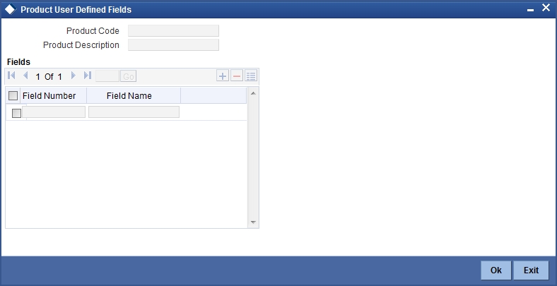

Click the ‘Fields’ button to invoke the ‘Product User Defined Fields’ screen.
In the ‘Product User Defined Fields’ screen, you can specify the Field Name. Select the Field Name from the option list provided.
