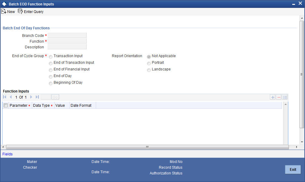

To run the Islamic Derivatives Daily Events program, it is necessary that you first maintain it as a Mandatory Program. For example, you need to maintain the function ‘IVBAUDLY’ to execute the End of Day batch. You can then invoke it by choosing ‘Start’ under the End of Day Batch in the Batch Operations menu and specifying the activity and the stage till which the system needs to run, for a particular Branch. You can check the progress of the activity in the ‘Monitor’ option available under End of Day Batch. You can invoke this screen by typing ‘BADEODFE’ in the field at the top right corner of the Application tool bar and clicking the adjoining arrow button.
