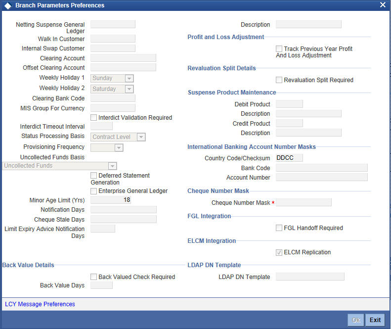

To enable data transfer between Oracle FLEXCUBE and Oracle FLEXCUBE General Ledger, you need to set certain options at bank parameter level. To invoke the screen, type ‘STDBRANC’ in the field at the top right corner of the application toolbar and click the adjoining arrow button. The system displays the ‘Branch Parameter Maintenance’ screen. Click ‘Preferences’ button on the screen.
FGL Handoff Required
Check this option to indicate that FGL handoff is required for the bank. The system will enable data transfer between Oracle FLEXCUBE and FGL only you check this option.

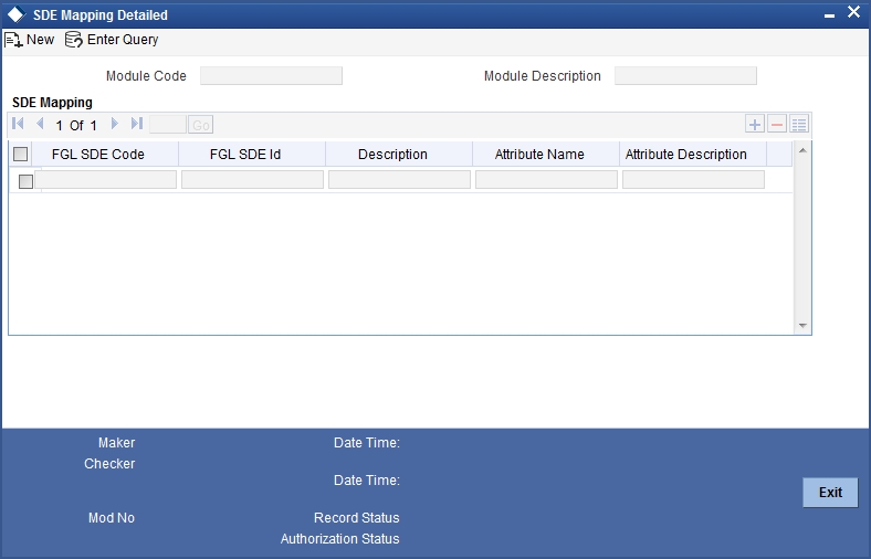

Transaction attributes extracted from Oracle FLEXCUBE needs to be mapped to a corresponding SDE in FGL. User defined fields at the contract level can also be mapped to SDEs. You can maintain this mapping using ‘SDE Mapping’ screen. To invoke the screen, type ‘IFDSDMAP’ in the field at the top right corner of the Application toolbar and click the adjoining arrow button.
I
You can capture the following details on this screen:
Module Code
Specify the module code. You can map the attributes of transactions entered in this module to corresponding SDE from this screen.
Module Description
The system displays the description of the module.
SDE Code
Specify the SDE code to be mapped to the transaction attribute.
Module Transaction Attributes
Specify the transaction attribute to be mapped to the selected SDE.
Depending on the SDE definition and mapping, the transaction attributes handed off from Oracle FLEXCUBE will be mapped to the corresponding attribute in FGL.
