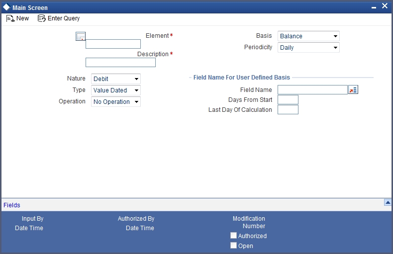

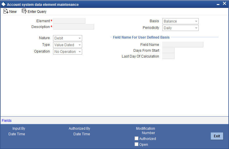

Element
Specify a unique ID for the System Data Element that you are maintaining.
Description
Specify a description of the SDE that you are maintaining in this field.
Basis
Select the Basis for the calculation of Profit from the adjoining drop-down list. This list displays the following values:
If you want to apply profit on an account based on the balance in the account, you have to first specify whether you would want to consider booking dated or value dated balances. Subsequently, you have to specify other characteristics for the balance.
When you are setting up the SDE, you can use normal balance or the balance due to the IP transactions. The basis for such SDEs is IP balance.
If the basis of an SDE is IP balance, then by rule, the nature of the SDE will be Net, the type of the SDE will always be the value dated balance and no further operations will be allowed on the SDE.

Periodicity
Select period over which a balance or a turnover should be considered for profit application, from the adjoining drop-down list. This list displays the following values:
When a balance or turnover has to be picked up for profit application, it will be picked up for this period.
An example for a balance with daily periodicity could be the daily net balance in the account. Similarly, the monthly minimum credit balance, monthly maximum debit balance, etc. are examples of a balance with monthly periodicity. Similarly, you could consider the minimum credit balance over a quarter for profit application.

Nature
Select the nature of the balance or turnover, once you fix the ‘basis’ on which you want to apply profit for the specified SDE, from the adjoining drop-down list. This list displays the following values:
In the example discussed in the beginning of this section, we have seen various types of balances: on certain days there is a debit balance while on certain other days there is a credit balance in the account. These are referred to as debit balances and credit balances respectively.
Each balance in turn will have a periodicity and an aggregation operation attached to it.
Type
Select the date to be used for calculation, if you have indicated that the SDE is to be calculated on the turnover of an account, from the adjoining drop-down list. This list displays the following values:
Operation
Select the method in which a balance or turnover should be picked-up over its periodicity, from the adjoining drop-down list. This list displays the following values:

You can maintain the following parameters here:
Field Name
Specify a valid field name for user defined basis from the adjoining option list.
Days from Start
Specify day from when you want to compute profit for an account on the monthly minimum credit balance, the maximum monthly debit balance, or the average balance for a specific period.
The balance in the account, between the date that you specify here and the date that you specify in the ‘Last Day of Calculation’, will be used for calculation of profit.
The default value in this field is maintained as ‘1’. However, you can modify, if needed. For example, if you want to calculate profit from the 15th of a month enter ‘15’ here.
Specify day till when you want to compute profit for an account. You may have to consider the balances or turnovers, only during a specific period of the month.
For example, in some countries, credit profit for Savings Bank accounts is given for the minimum credit balance in the account during the month, between the 10 and 25 of the month. To define an SDE that returns the minimum balance between 10 and 25 of the month, you should define it as follows:

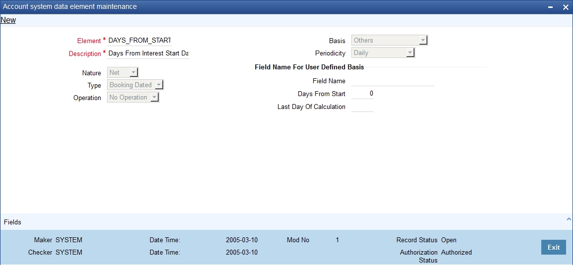

The following is a list of the SDEs already available in the system:
You need to maintain an SDE for profit calculation on daily average balance. This SDE gives the difference between the ‘PRINCIPAL_EXPECTED’ and the value dated balance of the CASA account.

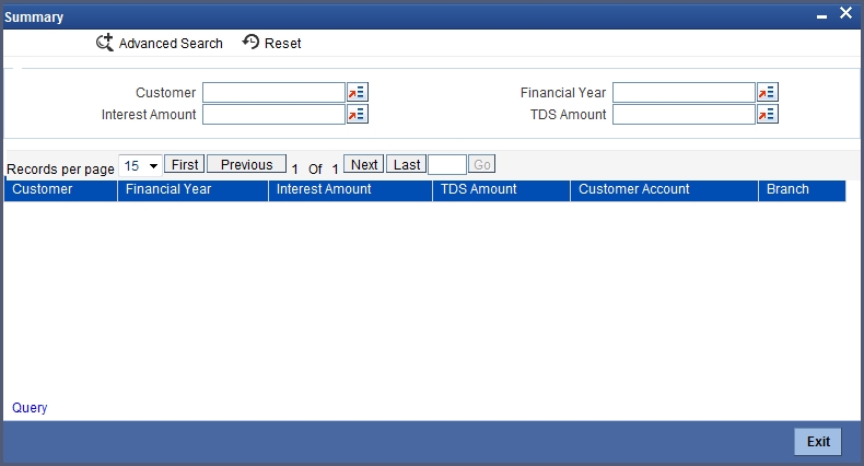

You can view the TDS details of the customer in the ‘Interest and Charges TDS Query’ screen. You can invoke the ‘Profit & Charges TDS Query’ screen by typing ‘TDSQUERY’ in the field at the top right corner of the Application tool bar and clicking the adjoining arrow button.
Customer
Specify a valid customer number based on which you wish to query, from the adjoining option list.
Financial Year
Specify a valid financial year based on which you wish to query, from the adjoining option list. The Financial year must be a past year.
Profit Amount
Specify a valid profit amount based on which you wish to query, from the adjoining option list.
TDS Amount
Specify a valid TDS amount based on which you wish to query, from the adjoining option list.
Branch
Select a valid branch code if you need to view records based on the branch code of the account.
Customer Account
Select a valid account number if you need to view records based on the customer account from the adjoining option list.
Click ‘Search’ button. The system identifies all records satisfying the specified criteria and displays the following details for each one of them:
