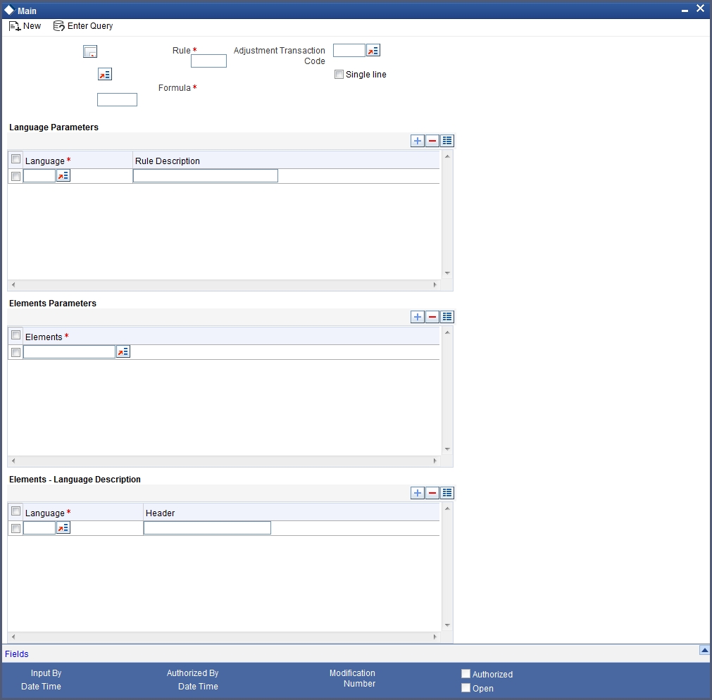

In Oracle FLEXCUBE, you can build profit statements to suit the requirements of your bank. You can define the details that you would like to include in profit statements in the ‘Profit Statement Maintenance’ screen.
Note
A profit statement will be printed for an account only if the statement details are maintained for it.
You can maintain Profit statements in the ‘Profit Statement Maintenance’ screen. You can invoke the ‘Profit Statement Maintenance’ screen by typing ‘IPDISFM’ in the field at the top right corner of the Application tool bar and clicking the adjoining arrow button.
Rule
Specify a valid profit rule applied on the account using which you want to calculate the Profit for an account using the formulae defined, from the adjoining option list. To recapitulate, depending on your definition, the result of formulae may be an amount that is to be:
A tax amount or an amount that is to be ‘booked’ would, usually, be posted to the customer account. The result of formulae that are posted to customer accounts will be reflected in the profit statement you provide your customer.
The codes that you have used while defining profit and charge rules, SDEs, and UDEs, will be printed per se in a profit statement, if you choose not to maintain the details for a profit statement. For example, when you defined a rule to calculate credit profit you may have assigned the code ‘CRIN’. This rule code will be printed on the profit statement if you do not maintain a specific description for it while maintaining the profit statement.
The purpose of maintaining a profit statement is to explain to an account holder each accounting entry with reference to the profit rule that was applied.
For example,
| Profit Rule | CRIN | ||
| Description | Credit Profit on the monthly maximum balance in your account | ||
| SDE | Max_Cr_Bal | ||
| UDE: | Rate 1 |
When an Profit Statement is generated for an account that is linked to CRIN:
If you specified, while defining the profit statement, that the SDE and the UDE of the profit rule CRIN should be printed in the profit statement, they will be printed along with their values.
Adjustment Transaction Code
Specify a valid transaction code against which you want to post manual profit adjustment entries, from the adjoining option list. All entries tracked against the particular transaction code will be reflected in the profit statement that is generated.
A list of transaction codes maintained at the ‘Transaction Codes Maintenance’ screen is displayed in the option list positioned next to this field. You can select the appropriate transaction code.
Formula
Formula maintained for the specified profit rule is defaulted here.
Single Line
Check this box if you want a single line profit statement.

In the Elements field, you can invoke a list of the SDEs that you identified for the rule, specified in the Rule field. Choose an SDE by double clicking on it. Now, for the SDE that you have chosen, you can enter a description in the Header field. You can describe the SDE in a language of your choice.
Similarly, enter a description for each of the UDEs that you have specified for the rule.

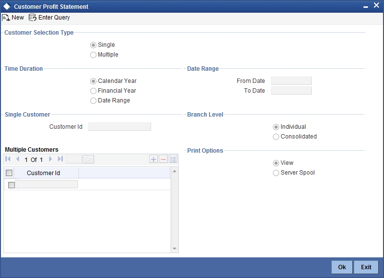

Oracle FLEXCUBE facilitates generation of profit statement for Mudharabah accounts using ‘Customer Profit Statement’ screen.
You can invoke the ‘Customer Profit Statement’ screen by typing ‘IPDOPTN’ in the field at the top right corner of the Application tool bar and clicking the adjoining arrow button.
You can maintain the following details here:
Customer Selection Type
Select a valid type of customer selection from the options. The following options are available for selection:
Time Duration
Select a valid type of time duration for which you want to generate profit statement from the options. The following options are available for selection:
You have to specify the following if you have maintained ‘Time Duration’ as ‘Date Range’:
From Date
Specify the date from when you want to generate the profit statement from the adjoining calendar.
To Date
Specify the date till when you want to generate the profit statement from the adjoining calendar.
You need to maintain the customer ID details, if you have maintained ‘Customer Selection Type’ as ‘Single’.
Customer ID
Specify the customer ID for which you want to generate a profit statement from the adjoining option list.
You need to maintain all the customer ID details, if you have maintained ‘Customer Selection Type’ as ‘Multiple’.
Customer ID
Branch Level
Select the level at which you want to generate profit statement from the options. The following options are available for selection:
Print Options
Select a print option to generate profit statement. The following options are available for selection:
