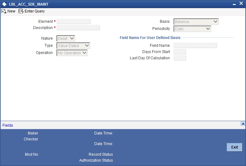

4.1 System Data Elements Maintenance
4.1.1 Invoking System Data Elements Maintenance
You will have different types of accounts in your bank, such as current accounts, savings accounts, etc. On each of these accounts you would want to apply interest differently. On a savings account, for example, you may want to apply credit interest on the basis of the minimum credit balance during the month. On a current account you may want to apply charges on the basis of the turnovers, or, levy debit interest on the basis of overdrafts. Similarly, there may be various criteria based on which you would want to apply interest on an account.
Each such criterion (which the system has to pick up) has to be defined as an SDE in the ‘Interest & Charges System Data Element Maintenance’ screen. You can invoke the ‘Interest & Charges System Data Element Maintenance’ screen by typing ‘ICDSDEMN’ in the field at the top right corner of the Application tool bar and clicking the adjoining arrow button.
SDEs should be combined with UDEs into formulae to arrive at a method in which interest or charge has to be calculated.
Follow the example below, which illustrate transactions that typically take place in a current account, to understand how SDEs are defined.

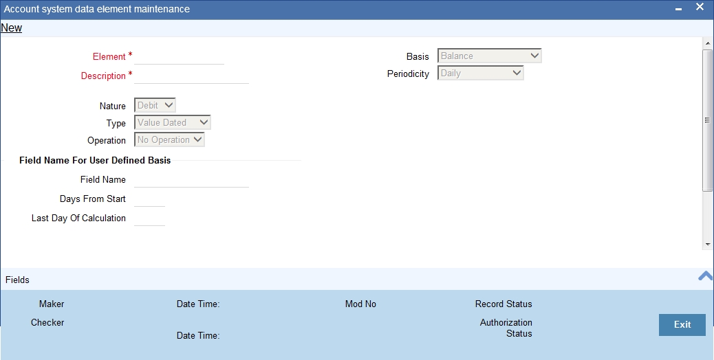

Element
Enter a unique ID for the System Data Element that you are maintaining.
Description
Enter a description of the SDE that you are maintaining in this field.
Nature
Once you fix the ‘basis’ on which you want to apply interest for the SDE that you are defining (either balances or turnovers which, in turn, could be as of the booking date or the value date), you have to specify the nature of the balance or turnover. The nature could be:
In the example discussed in the beginning of this section, we have seen various types of balances: on certain days there is a debit balance while on certain other days there is a credit balance in the account. These are referred to as debit balances and credit balances respectively.
Each balance in turn will have a periodicity and an aggregation operation attached to it. These two are explained subsequently.
Basis
Interest can be applied on this account differently, using different data as the basis. That is, you can apply interest on the basis of ‘item count’, the balance, or the turnover in the account. In Oracle FLEXCUBE, Balances and Turnovers are referred to as ‘Basis’. While balances will typically be used for interest application, turnovers could be considered for charges.
Note
A ‘turnover’ is any movement in an account.
Balances and turnovers, in turn, can be considered as of the ‘booking date’ or the ‘value date’ of a transaction.
The booking date is the date on which a transaction is captured in the system. However, the date on which a transaction takes effect (that is, the date as of which the accounting entries are passed and the balances updated) could either be the booking date itself, or a date in the past, or future. This date is called the value date of the transaction. The following are examples of value dates and booking dates:
The Basis could be one of the below:

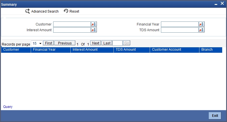

4.2 Customer TDS Details
4.2.1 Invoking Customer TDS Details Screen
You can view the TDS details of the customer in the ‘Interest & Charges TDS Query’ screen. You can invoke the ‘Interest & Charges TDS Query’ screen by typing ‘TDSQUERY’ in the field at the top right corner of the Application tool bar and clicking the adjoining arrow button.
In the above screen, you can base your queries on any or all of the following parameters and fetch records:
Select any or all of the above parameters for a query and click ‘Search’ button. The records meeting the selected criteria are displayed.
System displays the following details pertaining to the fetched records:
