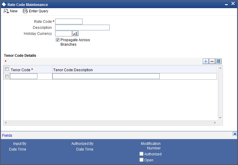

You can define rate codes using the ‘Rate Code Maintenance’ screen. You can invoke this screen by typing ‘CFDRTCD’ in the field at the top right corner of the Application tool bar and clicking the adjoining arrow button.
You can enter the following details:
Rate Code
Enter a code to identify the rate you are defining. You can associate several currencies to the rate code and specify rates for each currency. While processing a contract, you need to indicate this code to make the rate applicable to the contract. The code cannot exceed 10 characters.
Description
Enter a brief description to identify the rate code being defined.
Holiday Currency
Specify the holiday currency for this rate code. You can choose the appropriate one from the adjoining option list that displays all valid currency codes maintained in the system.
Floating rates prevalent in the market are recorded in the system as rate codes (E.g. LIBOR). The prevailing rates in the market are also recorded in the system. These rates are defined in a certain market (E.g. LIBOR rates comes from the London market). Hence the days on which that market is closed is determined by the holidays maintained for the related currency (GBP for LIBOR). This currency must be recorded as the ‘Holiday Currency’ for the Rate code.
Propagate Across Branches
Check this option to indicate that the rate code should be available across all branches.
Here you need to indicate the following:
Tenor Code
Specify a unique code to identify the tenor for which this rate code should be applicable.
Tenor Code Description
Enter a brief description for the tenor code.
You can add multiple tenor codes for the rate code by clicking add icon. Similarly, you can delete a tenor code by selecting the desired row and then clicking delete icon.
In order to process MT340, MT360 and MT361 you need to maintain the following rate codes:

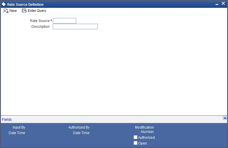

You can maintain the source from where the interest rates have to be picked up by Oracle FLEXCUBE like Reuters, Bloomberg, using the ‘Rate Source Definition’ screen. You can invoke this screen by typing ‘CFDRTSRC’ in the field at the top right corner of the Application tool bar and clicking the adjoining arrow button.
Here you can capture the following details:
Rate Source
Specify a unique code to identify the rate source you wish to maintain. The code cannot exceed 10 characters.
Description
Enter a brief description for the rate source.
In order to process MT340, MT 360 and MT361you need to maintain the following rate sources:

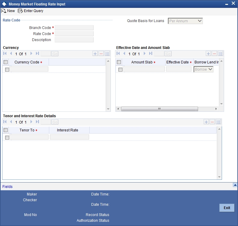

You can define Floating Interest Rates through the ‘LD MM Floating Rate Input’ screen. You can invoke this screen by typing ‘CFDFLTRI’ in the field at the top right corner of the Application tool bar and clicking the adjoining arrow button.
A Rate Code identifies a set of rates defined for a combination of Currency, Amount Limit (optional), Tenor and Effective Date.
Rate Code
Enter a code to identify the Floating Rate you are defining. You can associate several currencies to the rate code and specify rates for each currency. While processing a contract, you need to indicate this code to make the rate applicable to the contract.
Each Rate Code is associated with a currency. You can define rates for the same Rate Code in different currencies.
For example, you can have a Rate Code TERMDEP45 (with a description of Rates for a Term Deposit of 45 days). Thus, you can define a set of rates for contracts in U S Dollar and another set for contracts in Great British Pounds.
When you link a contract in US Dollars to the Rate Code TERMDEP45, the rates defined for this currency will be applied. Similarly, if the contract is in Great Britain Pounds, the rates defined for that currency will be applied.
Amount Slab
For a specific Rate Code and Currency combination, you can define an amount slab structure for application of interest rates. You should specify the upper limit of the slab to which a particular rate should be applied. A rate that has been defined for an Effective Date - Amount Slab combination will be applicable to an amount less than or equal to the specified amount. You can thus define interest rates for a slab structure.
Let us extend the example we discussed for Rates and Effective Dates to include amount limits.
| Amount (USD) | Effective Date | Interest Rate | |||
| 10,000 | 01 January ‘97 | 12.5% | |||
| 50,000 | 01 January ‘97 | 13.0% | |||
| 999.9 million | 01 January ‘97 | 14.0% |
If the rates have to be applied on 01 January ‘97, they will be picked up as follows:
Note
Notice that a huge amount (999.9 million) has been given as the last amount limit. This denotes that after 50,000 there is no upper limit in the slab. Further, if the component amount is greater than the highest slab, the appropriate rate for highest amount slab will be applied. Similarly, if the component amount is lesser than the lowest amount slab, the appropriate rate for lowest slab will be applied.

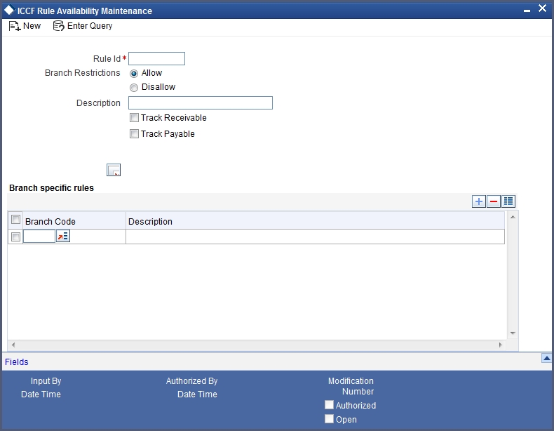

An interest rule is created in the same way that any Interest, Commission, Charge and Fee (ICCF) rule is created, as follows:
To recall, at the head office of your branch, you can create appropriate ICCF rules and make the rules available to the required branches.
In the ‘ICCF Rule Availability Maintenance’ screen, you can maintain ICCF rules, which you can make available to desired branches. You can invoke this screen by typing ‘CFDICCFR’ in the field at the top right corner of the Application tool bar and clicking the adjoining arrow button. You can do this by maintaining a list of branches for which the use of the rule is allowed, or disallowed.
In this screen, you must specify the following information:
Rule Identification and Description
You must specify a unique identification for the ICCF rule you are creating. If you are creating a charge rule, specify a unique identification for the interest rule. This is the code that will be used to identify the rule, in all subsequent references to it. You must also specify a unique description for the rule.
Note
After the rule has been created in the ICCF Rule Branch Availability screen, the attributes for the rule must be defined in the ICCF Rule Details screen.
Branch Restrictions
You can maintain a list of allowed branches (that is, the rule will be available for use in the allowed list of branches) or disallowed branches (the rule will not be available for use in the branches in the disallowed list).

Track for AP
Check this box if the rule is eligible for receivable tracking.
Track for AR
Check this box if the rule is eligible for payable tracking.

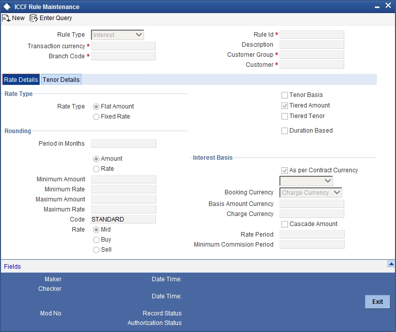

You can invoke this screen by typing ‘CFDRUMNE’ in the field at the top right corner of the Application tool bar and clicking the adjoining arrow button.
As you are defining an interest type of component, (that is, a tenor based component), you need to specify only the following details through the ICCF Rule Details screen:
Note
The values defaulted by the system in the fields under the Rate Details and Tenor Details tabs should not be altered. These will not have any effect on the Interest Rule which is being created.
All the other details of the component must be specified through the Interest Class Screen. The Interest Class screen allows you to specify details regarding different attributes such as the following:
Rule Type
The Rule Type identifies the type of ICCF component you are defining. In this case it is Interest. The attributes applicable for a component depends on its Rule Type.
For example, you can define any component that is tenor based − an annual fee, for example - as a component of Rule Type Interest. If INTEREST1 is your main interest, your annual fee can be defined as INTEREST2, as it is tenor based. Only on an Interest type of component can you have floating rates.
Rule ID
Each Interest Rule is defined by an alphanumeric code called the Rule ID. Attributes are defined for this Rule ID, which is then linked to a product. When a contract is processed, the interest attributes defined for the Rule ID linked to the product will be applied on the contract, some of which can be changed.

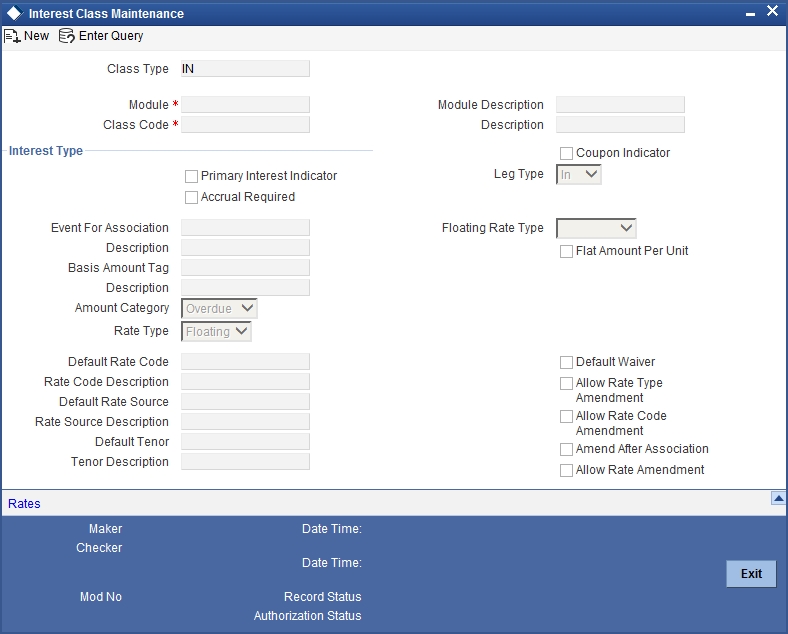

Once an Interest Rule has been defined, you must create an Interest Class for the Interest Rule. Creating an interest class for every Interest Rule is mandatory. The details specified for Interest Class is then defaulted to the product you define.
The definition of a product should ideally be preceded by the definition of all Interest Rules applicable to the product. If not, the product definition has to be put on hold, the Interest Rules defined, and then the product linked to the Interest Rules.

A class is a specific type of component that can be built with certain attributes. For instance, for a Security, you can build an interest class with the attributes of a specific type of coupon, the quarterly coupon paid on the current face value.
This chapter explains how interest classes are built and how attributes are defined. The building of interest classes is applicable to Securities and Derivatives products and contracts. You can use the information in this chapter to process interest components for Securities and Derivatives contracts.
When building an interest class, certain attributes, such as the following can be defined:
You can define the attributes of an interest class, in the ‘Interest Class Maintenance’ screen, invoked from the Application Browser. You can invoke the ‘Interest Class Maintenance’ screen by typing ‘CFDINTCE’ in the field at the top right corner of the Application tool bar and clicking the adjoining arrow button.
Before defining the attributes of an interest class, you should assign the class a unique identifier, called the Class Code and briefly describe the class. A description would help you easily identify a class.
Module
An interest class is built for use in a specific module. This is because; an interest component would be applied on different basis amounts, in different modules.
For example, in the Derivatives module, you would apply interest on the principal amount. In the Securities module, you can have coupons on the basis of the current face value. The basis on which the component is calculated is different in these two cases.
Note
The Basis Amount Tags available would depend on the module for which you build the class.
While building an Interest Class, you can define two kinds of interest:
For example, while building an Interest Class for the Securities module, you can only define Coupon details.
When building interest class for the Derivatives module, you can only define primary interest details. Subsequently you are also required to specify whether the interest type is applicable for the in leg or for the out leg of contracts linked to this class
Events and the Basis Amount
The term Event can be explained with reference to a deal. A deal goes through different stages in its life cycle, such as:
Each stage is referred to as an Event in Oracle FLEXCUBE.
The event at which you would like to associate the interest component, being defined, to a contract is referred to as the Association Event.
The basis on which an interest is calculated is referred to as the Basis Amount. For instance, a coupon can be on the basis of the current face value of a security. When building an interest class, you have to specify the tag associated with the Basis Amount.
The attributes defined for an interest class, will default to all products with which you associate the class. When maintaining interest details for a product, you can change these default attributes. Contracts maintained under a product will acquire the attributes defined for the securities product.
Accrual Required
You can choose to accrue the interests due on a contract. To accrue the interest payable on a contract, choose the ‘Accrual Required’ option.
The accrual details that you define for an interest class will default to all products with which you associate the class. When maintaining interest accrual details for a product, you can change these default details. Contracts maintained under a product will acquire the accrual details defined for the product. However, you can define unique accrual details for a contract.
Rate Type
The interests paid on contracts can be at a Fixed Rate, or on the basis of a Floating Rate. If you indicate that interests should be calculated on the basis of a Floating Rate, you must specify the ‘Periodic’ Floating Rate Type.
For all contracts maintained under products, associated with a class, the interest will be by default calculated using the specified Rate type.
Default Rate Code
Interest payable on contracts would be calculated at specific rates. When building an interest component, you have to specify the rate at which the interest should be computed. When associating a rate code (that you have maintained in the Rate Codes Maintenance screen) with the interest component that you are building, the rates corresponding to the code will be used to compute interest.
The details defined for an interest class will default to all products with which the class is associated. When maintaining interest details for a product, you can change this default information. Contracts maintained under a product will acquire the interest details defined for the contract product. However, you can define unique interest details specific to a contract.
When maintaining a contract, you can choose to waive the rate code altogether or amend the properties of the code to suit the security.
If you allow amendment of a rate code, you can specify if you would like to allow rate code amendment after the association event.
You can also allow the amendment of the rate value (corresponding to a rate code).
Default Tenor
Each rate code is associated with a tenor. For instance you have a Rate Code ‘LIBOR’. You can link any number of tenor codes to the same rate code.
| Tenor Code | Description | ||
| 1W | One week rate | ||
| 2W | Two week rate | ||
| 2M | Two months rate | ||
| 6M | Six months rate | ||
| 1Y | One year rate |
When building an interest component, you can specify a Tenor Code that you would like to associate, with the Floating Interest Rate Code. Interests for contracts (maintained under a product with which you associate the class) will be calculated using the rate corresponding to the Rate Code and the Tenor Code.

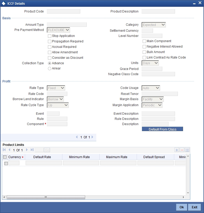

After you have defined an Interest Rule by allotting it a Rule ID and specifying the interest application factors, you can link it to a product. When a contract involving the product is processed, the interest attributes defined for the product will be applied on the contract. Some of these attributes can be changed during contract processing.
Click ‘Interest’ button in the ‘Product Definition’ screen to invoke the ‘Interest Details’ screen.
You can link more than one rule to a product. In the Product ICCF Details screen, in the Rule ID field, pick the rule you wish to link to the product. For an interest type of rule, all the interest-related details have to be specified in the Product ICCF Details screen.
For example, for a deposit, you can link a rule for the main interest and another interest type of rule for a commission you want to charge on the deposit. Besides this, you can have a rule for a charge. Thus, the product will have three rules linked to it. For the deposit, you can retain all these, or waive one or more, as per your requirement.
The interest details defined for a product will be automatically applied on a contract involving the product. However, you can change certain attributes of interest for a specific contract.

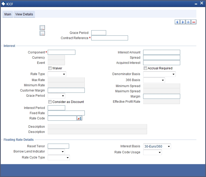

Event
An interest event indicates when the interest component whose attributes are being defined has to be applied.
The basis of the interest component being defined specifies the following two attributes:
Amount Type
If the interest rate type is Fixed or Floating, the Amount Type specifies the basis amount on which the interest rate has to be applied. For example, for the FT module, it could be the Transfer amount, for the LC module, it could be the LC Contract Amount and so on.

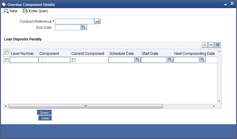

Grace Period and Level Number
You can apply interest at various levels:
For each interest component, starting from Level 1 and belonging to ‘Overdue’ category, you can also specify the number of grace days, beyond the main interest due date, after which that interest component becomes applicable. For each such component, the default value for the number of grace days is:
Number of grace days for the previous level + 30 days
You can change this value, provided that the number of grace days for a component (level) does not exceed the number of grace days for any successive level. At any point, an amendment of the number of grace days for any or more interest components at the Product ICCF level will only affect new contracts.
For interest components of Level 0 and ‘Expected’ category, the default value for grace days is 0 – this cannot be changed.
Settlement Currency
The Settlement Currency is the currency in which the interest amount will be calculated. The interest amount applicable for a contract will be calculated in this currency. The appropriate conversion rate (defined for the product as the applicable Rate Type) will be applied to carry out a conversion if the repayment account is in a different currency.
Category
If the interest rate type is Fixed or Floating, the Amount Basis Category specifies the type of balance that has to be considered for interest application. It could be any one of the following:
If the Basis Amount Category is Expected, the balance on which interest has to be applied will be the Expected balance (the balance assuming that all the scheduled repayments defined for the contract are made on time). An example of this category is the application of interest on the Bill amount.
If the Basis Amount Category is Overdue, the balance on which interest has to be applied will be the amount that is overdue, based on the repayment method defined for the contract. An example of this category is the application of penalty interest on the bill amount or interest, when a repayment has not been made, as per the date specified for the contract.
Prepayment Method
The prepayment method identifies the computation of the prepayment penalty for the contract.
The prepayment penalty for deposits is computed as depicted in the equation given below:
Here,
In addition to using the formula to calculate the Prepayment Penalty, the actual prepayment penalty amount being charged to the customer is also dependent on the Prepayment Method.
The options available are:
This option is used where pre-payment has to be applied on the deposit contract for contract elapsed days.
If the Prepayment Method is Custom, then the prepayment penalty in this case will be the minimum of prepayment penalty and Gross interest on the premature withdrawal amount. The system computes the interest amount to be liquidated due to prepayment of principal. You will not be allowed to specify the interest amount during the Payment input in such a case.
Note
Here, the system does not include the Acquired interest for processing.
Also, if you have chosen the prepayment method as Custom, you cannot prepay or manually liquidate either the interest or the principal component. This option is used where pre-payment has to be applied on the deposit contract for contract remaining days.

Default Spread
In the Default Spread field, you are allowed to specify both positive and negative spread as default for the product you are maintaining. The system validates this spread against the minimum and maximum spread you have specified for the currency. Subsequently, the spread will be defaulted to the contract.
Prepayment Spread or Prepayment Rate
This field is specific to Deposits. Based on the Pre Payment Method chosen at the product level, the penalty rate is derived. The derived penalty rate defaults in to the Payment Input screen and you can choose to change it there.
The prepayment rate will be treated as spread if you have chosen prepayment method as FLEXCUBE i.e. the prepayment rate is subtracted from the contract interest rate. The day count for which penalty needs to be calculated is the number of days the deposit has run.
In other case, if the prepayment method is CUSTOM, then the system calculates the prepayment penalty using this rate as the actual rate. . For CUSTOM method, the day count is the number of days remaining in the deposit after prepayment.
Note
The Amount Tag MAININT_ADJ should be picked up while you define the accounting entries for the Penalty Amount, at the product level

From the Contract On-line screens, click ‘ICCF’ button to access the Contract ‘ICCF’ screen.
It is possible to define more than one interest rule. You can have several interest rules, which you link to a product. The contract involving the product, in turn, will be linked to these interest rules.
For example, there can be one interest rule for the main interest (for example, 14%). You can have a tenor-based commission defined as an interest rule for the same product (for example, 3%). Both these will be applicable to the contract.
In the Contract ICCF Screen use the set of arrow buttons to go to the next or previous or the first or last rule that has been linked.
The contract ICCF screen, displays the interest details inherited, from the product to which it is linked. The defaulted fields that can be changed have been mentioned in the On-line help for the field. The following details are defaulted:
Contract Reference Number
The reference number of the contract you are processing.
Event
The event is to which the component should be applied together with its description.
Component
The component for which you are entering details together with its description.
Currency
The settlement currency which is defined in the Interest Class screen will be displayed in this field. This is a display only field.
Rate Type
The rate type applicable for the product, that the contract involves, is displayed here. It can be one of the following:
You can change the rate type from ‘Floating’ to ‘Fixed’ or vice-versa during the tenor of a contract. The schedules will be recalculated based on the new interest rate.
If you change the rate type from ‘Fixed’ to ‘Floating’ and the revision method is ‘Periodic’, the system will default the rate revision schedule from the product.
If the interest is a fixed amount and not a percentage of the principal amount, the rate type will be 'Special'. In this case you must specify the fixed amount for the contract in the ‘Interest Amount’ field.
Rate Code
If the Interest Rate Type (previous field) has been specified as Floating, indicate the Rate Code to which the product has to be linked. Similarly if a fixed rate contract has been linked to the deposit product, you will have to specify a fixed rate contract here. The fixed rate identified for the main component of the linked contract will apply to the deposit contract also.
The Rate Code corresponds to the rates, defined in the Floating Rates table, that have to be applied for the product. A Rate Code identifies a set of rates defined for a combination of Currency, Amount (if it is necessary) and an Effective Date.
Select from the option list of Rate Codes and choose the one applicable for the product you are defining. The Rate Code can be changed during contract processing.
Interest Basis
This field indicates how the system must consider the tenor basis upon which interest is computed over a schedule or interest period, in respect of the interest component being associated with the product. The specification made for the specified interest class is defaulted in this field. You can alter the default, if necessary, and select the required Interest Period Basis from the drop down list.
You can choose any of the following options:
Grace Period for an Interest Component
The grace days that you specify for any level of interest in the Product ICCF screen will default to contracts entered under that product. For interest components of Level 1 or above and of ‘Overdue’ category, you can change the grace days for a particular contract, subject to the condition that grace days for a particular level do not exceed that for any successive level. The number of grace days for interest components of Level 0 and ‘Expected’ category will always be 0.
You can change grace days and/or rate for an interest component from value date amendment screen by triggering the events VAMB / VAMI. For any interest component, a change in grace days or rate can be back valued only as far back as the date of the last payment received.
Minimum and Maximum Rates
This field is applicable only for contracts using a product with Fixed Interest Rate Type. It indicates the minimum interest rate that can be applied on the deal, and the value is defaulted from the specification made for the product used by the contract. If the interest rate specified for a deal is less than this minimum rate, this rate will be applied on the deal.
It indicates the maximum interest rate that can be applied on the deal, and the value is defaulted from the specification made for the product used by the contract. If the interest rate specified for a deal is more than this maximum rate, this rate will be applied on the deal.
By defining minimum and maximum rates for a fixed interest, you can ensure that your rates stay within the stipulated limits.
Fixed Rate
If the product involved in the contract has a fixed interest rate defined then at the contract the attributes defaults. The rate which gets defaulted from the product can be changed.
Acquired Interest
If the contract was already initiated when it was input, the interest amount that has been accrued should be entered here. The amount will be taken into account during the next liquidation cycle. You can make changes to the acquired interest through this screen.
Minimum Spread
This field is applicable only when the interest Rate Type is Floating. Specify the minimum spread that can be applied on a contract involving this Product and Component. If the spread specified during contract processing is less than the value in this field, this value will be picked up as the spread.
Maximum Spread
Specify the maximum spread that can be applied on a contract involving this Product and Component. If the spread specified during contract processing is greater than the value in this field, this value will be picked up as the spread.
Waiver
The attributes of an interest component that have been defined for a product will be applied on a contract involving the product. If, for some reason you do not want to apply the interest component for the contract you are processing, you can do so by checking this field. The interest will be calculated but it will not be applied on the contract.
To amend a contract, you have to invoke the Contract Interest, Charge and Fee screen of the ICCF module through the Value Dated Changes function.
Consider as Discount
While defining an interest class for the bills module, you can use this field to indicate whether the interest component is to be considered for discount accrual on a constant yield basis. Checking this box indicates that the interest component is to be considered for discount accrual on a constant yield basis.
If you select this option the interest received against the component is used in the computation of the constant yield and subsequently amortized over the tenor of the associated contract.
Checking this option also indicates that the interest components are to be considered for calculation of the Internal Rate of Return.
Denominator Basis
This is applicable to the interest methods which have their interest basis set to ACTUAL i.e. 30(EURO)/ACTUAL, 30(US)/ACTUAL and ACTUAL/ACTUAL. Denominator Basis is used to specify how the month of February is treated when the denominator is 'Actual'.
There are two types of denominator basis methods:
366 Basis
This is applicable only if the Denominator Basis is set to 'Per Annum'. You can select one of the following values here:
Note
In the ACT/ACT– ISMA Interest Method the Numerator would be Actual number of days between two interest dates. Denominator would be computed as the product of the number of times interest is to be received.
Interest Periods
This is applicable if the Denominator Basis is 'Per Interest Period'. Here you can specify the number of Interest periods (Schedules) in the financial year.
Note
In the Money Market and Corporate Deposit product interest screens, the following fields allow negative value input if negative interest is allowed for the component:
Reset Tenor
Enter the tenor for which the floating rate (when applied automatically) needs to be picked up from the floating rates table, for contracts using this product. This field is applicable to floating type of interest components and fixed type with rate code attached.
Rate Cycle Type
Specify the rate cycle type to be used for contracts using this product.
The rate cycle type is the manner in which the floating rate should be picked up for the contract. The preference that you specify here is used when the interest component does not fit into any direct parameter defined for the Rate Code. The options available are:
This field is applicable to floating type of interest components and fixed type with rate code attached. This specification cannot be changed when you enter a contract using this product.
Interest Basis
The interest basis indicates the method in which the tenor for interest has to be calculated, if their application is tenor based. It could be one of the following:
The Interest Basis defined for the product involved in the contract will be displayed. You can change it here to suit the bill you are processing.
Borrow Lend Indicator
You can use this field to indicate whether the borrowing rate, lending rate or mid rate must be picked up from the floating rate table, for the specified rate code. This specification cannot be changed when you enter a contract using this product.
Rate Code Usage
You can view details of the interest rules maintained in the ‘View Details’ tab. To view these details click ‘View Details’ tab in the Interest sub screen.
You can view the following details here:
Invoke the ‘Loans & Deposits Overdue Component Query’ screen by typing ‘LDDPENLT’ in the field at the top right corner of the Application tool bar and clicking the adjoining arrow button.
Enter the contract reference number and a valid date, which is less than or equal to the system date. The following details are shown for the current level of penalty interest components for each overdue schedule of the contract. Details are computed till the date you have entered or the next compounding date, whichever is earlier. Any level of overdue interest can be the current level. Also, details for the current level interest component are displayed as long as the component is either partially paid or unpaid:
You can also generate an advice to show all the above details.

While defining an interest class for either the bills module, you can indicate whether the interest component is to be considered for discount accrual on a constant yield basis.
The value for this field is defaulted from the Interest Definition and it can be changed here.

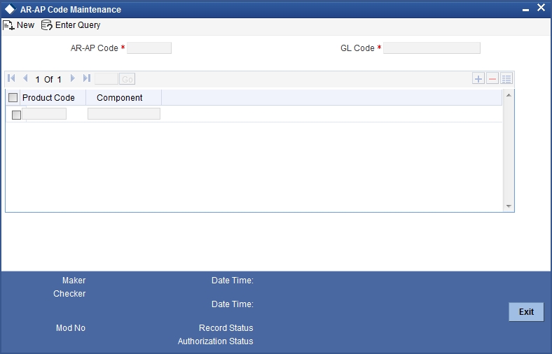

Oracle FLEXCUBE facilitates recording of ICCF details into a Receivable or Payable GL Account. The system records these details by mapping Product and Component to a combination of unique ARAP code and GL code, for LC, BC, FT, PC, and CL products. While processing a settlement, if the customer is eligible for account receivable or payable, then the system picks up the GL map for the Product and ICCF Component and replaces the Customer Account.
The system enables you to map unique ARAP and GL codes, using ‘AR-AP Code Input’ screen. You can invoke the ‘AR-AP Code Input’ screen by typing ‘CFDARAPM’ in the field at the top right corner of the Application tool bar and clicking on the adjoining arrow button.
You can maintain the following parameters here:
AR-AP Code
Specify AR-AP code you need to map to the GL.
GL Code
Specify GL code you need to map to the AR-AP code. The option list displays Asset or Liability Type Leaf GLs. Select the appropriate one.
Product Code
Product codes maintained at ‘Product Maintenance’ level are displayed here.
ICCF Component
ICCF components maintained at ‘Product Maintenance’ level are displayed here.

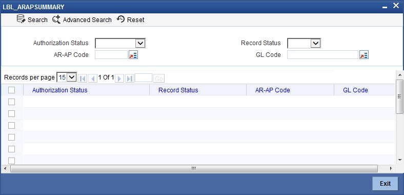

You can view maintained ARAP code details from the ‘ARAP Code Summary’ screen. You can invoke the ‘AR-AP Code Input’ screen by typing ‘CFSARAPM’ in the field at the top right corner of the Application tool bar and clicking on the adjoining arrow button.
You can query a record using the following options:
Authorization Status
Select authorization status of the ARAP code based on which you need to view record from the adjoining drop-down list. This list provides the following options:
Record Status
Select record status of the ARAP code based on which you need to view record from the adjoining drop-down list. This list provides the following options:
AR-AP Code
Specify AR-AP code for which you need to view the details. The option list displays valid AR-AP codes. Select the appropriate one.
GL Code
Specify GL code based for which you need to view the details. The option list displays valid GL codes. Select the appropriate one.
Click ‘Search’ button. The system identifies all records satisfying the specified criteria and displays the following details for each one of them:
