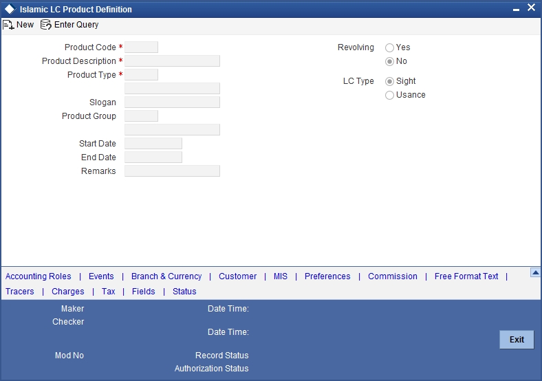

You can invoke ‘Islamic LC - Product Definition’ screen by typing ‘LIDPRMNT’ in the field at the top right corner of the Application tool bar and clicking the adjoining arrow button. Click ‘New’ icon on the tool bar. The ‘Islamic LC Product Definition’ screen will be displayed with no values in the fields.
You can define the attributes specific to a letters of credit product in the ‘Islamic LC Product Definition’ screen and the ‘Islamic LC Product Preferences’ screen. In these screens, you can specify the product type and set the product preferences respectively.

For any product you create in Oracle FLEXCUBE, you can define generic attributes, such as branch, currency, and customer restrictions, Profit details, tax details, etc., by clicking on the appropriate icon in the horizontal array of icons in this screen. For a letters of credit product, in addition to these generic attributes, you can specifically define other attributes. These attributes are discussed in detail in this chapter.
Product Code
The code you assign to a product will identify the product throughout the module. The code should contain four characters. You can follow your own convention for devising the code. However, at least one of the characters should be a letter of the English alphabet.
Since the code that you define is used to identify the product, it should be unique across the modules of Oracle FLEXCUBE. For instance, if you have assigned the code ‘Islamic LC01’ to a particular product in this module, you cannot use it as a code in any other module.
Product Description
You can enter a brief description of the product, which will be associated with the product for information retrieval purposes. Product Type
The product type identifies the basic nature of a product. An Islamic LC product that you create in Oracle FLEXCUBE can be of the following types:
The entries that are passed, the messages that are generated and the processing of contracts involving the product, is determined by your input to this field.
Slogan
You can specify a marketing punch-line to be associated with the product. This slogan will be printed on all the advices that are sent to the customer, for an Islamic LC involving this product.
Product Group
Each product is classified under a specific group. The different groups are defined in the Product Group Definition table.
Start Date and End Date
A product can be set up for use over a specific period, by defining a start and an end date. The Issue Date of an Islamic LC involving a product should be:
The start and end dates of a product come in handy when you are defining a product for a scheme, which is open for a specific period.
Remarks
You can enter information about the product, intended for the internal reference of your bank. The remarks are displayed when the details of the LC are displayed or printed. However, this information will not be printed on any correspondence with the customer.

Revolving
Islamic LC products can be revolving or non-revolving. If you indicate that the product is revolving, you can associate the product with only revolving Islamic LCs. While actually processing revolving you can indicate whether the Islamic LC should revolve in time or in value.
Similarly if you indicate that the product is non-revolving, you can associate the product to only non-revolving Islamic LCs.
Note
All Islamic LCs will be of irrevocable nature.
LC Type
LC products can be sight or usance. If you indicate that the LC type is sight, then you can select the credit mode as:
If you indicate that the LC type is Usance, then you can choose the credit mode as
The system displays an override message if the credit mode is not applicable for LC product.

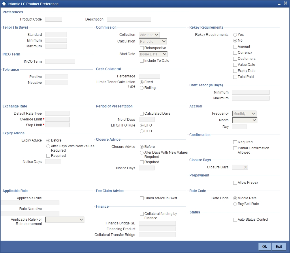

Preferences are the options available for defining the attributes of a product. The options you make here will ultimately shape the product.
Click on ’Preferences’ button to invoke the ‘Letters of Credit Product - Preferences’ screen. Through this screen you can define preferences for the product you are creating.
The preferences that you define for a product will be applied to all the Islamic LC contracts involving the product.
You can set the Standard, Minimum and the Maximum limits for tenor based Islamic LCs. The tenor details that you specify for an Islamic LC product is always expressed in days.
Standard
The standard tenor is the tenor that is normally associated with an Islamic LC involving a product. The standard tenor of an Islamic LC is expressed in days and will apply to all Islamic LCs involving the product. If you do not specify any specific tenor while processing an Islamic LC, the standard tenor will by default apply to it. The default standard tenor applied on an Islamic LC can be changed during Islamic LC processing.
An expiry date will be calculated based on the tenor, as follows:

In this section specify the following details:
Percentage
For a product, specify the percentage of the Islamic LC amount that should be taken as cash collateral. This percentage will be applied by default and can be changed when the Islamic LC is processed. In addition, the currency in which the collateral is to be collected can be specified in the Islamic LC Contract Collateral screen, while processing an Islamic LC.
Limits Tenor Calculation Type
Specify the calculation type for the limits tenor. You can select one of the following options.
Collateral transfer Bridge
Specify the GL/account to be used for transfer of collateral between Islamic LC and the Bill upon availment of the Bill against the Islamic LC. The GL/account specified here will be used as the bridge during the transfer accounting.
All operations on an Islamic LC (input, modification, reversal, etc.) have to be authorized by a user other than the one who carried out the operation. Authorization is a method of cross checking the inputs made by a user. All operations on an Islamic LC, except placing it on hold, should be authorized before beginning the End of Day operations.
You have the option to specify whether certain important details of an Islamic LC need to be rekeyed, at the time of authorization. If you indicate positively, you should also specify the fields that will have to be rekeyed at the time of contract authorization. You can specify any or all of the following as rekey fields:
When you invoke an Islamic LC for authorization; − as a cross-checking mechanism to ensure that you are calling the right Islamic LC, you can specify that the values of certain fields should be entered before the other details are displayed. The complete details of the Islamic LC will be displayed only after the values to these fields are entered. This is called the ‘rekey’ option. The fields for which the values have to be given are called the ‘rekey’ fields.
If no rekey fields have been defined, the details of the Islamic LC will be displayed immediately once the authorizer calls the Islamic LC for authorization. The rekey option also serves as a means of ensuring the accuracy of inputs.
Minimum
Specify the minimum draft tenor for an Islamic LC product.The value you enter must be non-decimal numeric value > = 0 and < Maximum Draft Tenor.
Maximum
Specify the maximum draft tenor for an Islamic LC product. The value you enter must be non-decimal numeric value > 0 and > = Minimum Draft Tenor.
If the LC Type of an LC product is selected as 'Sight':
If the LC Type of an LC product is selected as 'Usance':

Tolerance denotes the variance that has to be built around the Islamic LC amount, to arrive at the Maximum Islamic LC amount.
Positive
Specify the percentage that should be added to the LC amount to arrive at the Maximum Islamic LC amount. When an Islamic LC is issued or advised, the Maximum Islamic LC amount will be the outstanding Islamic LC amount. This will be the maximum amount available for availment.
Negative
Specify the percentage that should be subtracted from the Islamic LC amount. The minimum tolerance is captured for information purposes only.
Note
The tolerance percentage can be changed when an Islamic LC is processed under a product.
The positive and negative tolerance amounts will be a part of the Islamic LC instrument and the subsequent amendment instruments. You should use the positive tolerance to indicate the amount that is uncovered, in the Islamic LC amount. Instances could be of the freight or insurance not being paid.
Closure Days
Specify the number of days after which all Islamic LCs processed under the product being defined, will be closed. The number of days specified here and the expiry date of the Islamic LC is used to arrive at the closure date, as follows:
| Islamic LC Closure Date = Islamic LC Expiry Date + Closure Days |
By default, the system will display 30 days as the closure days. You are allowed to change this value.
At the time of capturing the details of an Islamic LC contract, the system will calculate the closure date, based on the closure days that you have maintained for the product involved in the contract. However, you can change the date to any other date after the expiry date.
Default Rate Type
You can specify the exchange rates to be picked up and used, when an Islamic LC in a foreign currency, is processed. You can indicate that the standard rate prevailing, as of the issue date of the LC should be used. You can also specify an exchange rate of your choice.
The possible values for the rate pickup are:
If you specify as input in the contract, then the system computes the components of the LC, based on your input in the Exchange rate field, in the ‘LC Contract Main ‘ screen.
If you choose ‘As per standard rate’ the system computes the applicable components, by picking up the exchange rates as of the transaction date, from the Currency table maintained in the Core Services module of Oracle FLEXCUBE.
Override Limit
If the variance between the rate defaulted and the rate input is a percentage that lies between the Rate Override Limit and the Rate Stop Limit, the Islamic LC can be saved by giving an override.
Stop Limit
If the variance between the rate defaulted and the rate input is a percentage value greater than or equal to the Rate Stop Limit, the Islamic LC cannot be saved.
As part of the preferences you define for a product, you can specify the manner in which the Period of Presentation should be calculated for the documents that accompany Islamic LCs processed under the product.
The period of presentation can be arrived at in two ways.
Firstly, you can specify it directly, in terms of days, in the Number of Days field. Typically, this would be 21 days. (However, you can change this to suit your need.) If you choose this option, the number of days specified will default to all Islamic LCs processed under the product. The value will default to the ‘Period For Presentation’ field in the Islamic LC Contract – Others screen.
Alternatively, you can opt to calculate the period of presentation as follows:
Expiry Date of the Islamic LC – Latest Shipment Date
(You would choose this option if the period of presentation varies for each Islamic LC processed under a product.) To specify this manner of calculating the period of presentation, choose the Calculated Days option in the Product Preferences screen.
The system uses the Expiry Date and the Last Shipment Date specified for the Islamic LC you are processing, and arrives at the period of presentation. The period of presentation defined for the product - or calculated for the Islamic LC, as the case may be - will be displayed in the ‘Period For Presentation’ field in the Islamic LC Contract - Others screen. You can change the default to suit the Islamic LC you are processing.
LIFO/FIFO Rule
Specify the order in which the availment under this contract should be processed. You can choose one of the following options:
If multiple amendments are made to the Islamic LC contract amount, then the system applies the FIFO/LIFO rule when utilization is made against the Islamic LC contract.
The system will calculate the commission accordingly.

Specify the finance details here.
Note
This is allowed only for Shipping Guarantee product.
Collateral Funding by Finance
Check this box to indicate that the guarantee needs to be funded by a finance.
Finance Bridge GL
Specify the bridge GL used for accounting between finance product and shipping guarantee. The adjoining option list displays a list of all GLs. Choose the appropriate one.
Financing Product
Specify the finance product used for the creation of finance account. The adjoining option list displays a list of finance products. Choose the appropriate one.
Collateral Transfer Bridge
Specify the bridge GL used for collateral transfer from Islamic LC to shipping guarantee and shipping guarantee to Bill. The adjoining option list displays a list of all GLs. Choose the appropriate one.
Specify the following status details:
Auto Status Control
Check this box to set automatic status control for the Islamic LC product. If you do not check this box, the system will not consider the Islamic LC contracts associated with this product for automatic status change.
The status of this check box is defaulted to the field ‘Auto Status Change’ of every Islamic LC contract associated with this product. However, you can modify this at the contract level.
Specify the following accrual details.
Frequency
Specify the frequency of accrual for commission, charge or fees. The frequency can be one of the following:
In case of monthly, quarterly, half yearly or yearly accruals, you should specify the date on which the accruals have to be done during the month. For example, if you specify the date as ‘30’, accruals will be carried out on the 30th of the month, depending on the frequency.
If you fix the accrual date for the last working day of the month, you should specify the date as ‘31’ and indicate the frequency. If you indicate the frequency as monthly, the accruals will be done at the end of every month -- that is, on 31st for months with 31 days, on 30th for months with 30 days and on 28th or 29th, as the case may be, for February.
If you specify the frequency as quarterly and fix the accrual date as the last day of the month, then the accruals will be done on the last day of the month at the end of every quarter. It works in a similar fashion for half-yearly accrual frequency.
If you set the accrual frequency as quarterly, half yearly or yearly, you have to specify the month in which the first accrual has to begin, besides the date.
Month
If you choose one of the following options for accrual frequency, specify the month in which the first accrual has to begin:
Day
If you choose one of the following options for accrual frequency, specify the date on which the accruals have to be done during the month:
Check the ‘Required’ option to indicate that confirmation message is required for all Islamic LCs under this product.
Check the ‘Allow Prepay’ option to indicate that prepayment should be allowed for commissions that are marked as ‘Arrears’.
Fee Claim SWIFT
Check this box to determine whether the Charge claim advice should be generated in SWIFT.
While creating an Islamic LC product, you can indicate whether a closure/expiry advice should be generated for Islamic LCs involving the product. These advices are generated based on the preferences that you specify for them.
Check against the appropriate option on the screen to indicate your preference. If you indicated that a closure/expiry advice should be generated, you need to indicate:
Islamic LC Expiry Processing
The Islamic LC cannot be marked as ‘Expired’ if any commission or charge is outstanding for the Islamic LC. The system logs an exception if the same is encountered.
Islamic LC Closure Processing
Upon Closure of the Islamic LC, The system checks to see if there are any outstanding receivable components in the Islamic LC (Commission and Charges to be collected from Bills availed against the Islamic LC). The system displays configurable error messages indicating the same.
Rate Code
When defining the settlement details for a product, you can specify the rate type (under the Rate Code option) that should be used in case of cross-currency settlements. Your specification for the product will default to all contracts involving the product. However, you can change the rate type defined for the product to suit a contract entered under the product.
The ‘Rate Type’ indicates the type of exchange rate that will be used. It can be the:
You can opt to track limits for all Islamic LCs processed under the product for which you are defining preferences. Choose the ‘Limit Tracking Required’ option to track limits for the Islamic LCs processed under the product.
Your specification here will default to all Islamic LCs processed under the product. You can modify the defaulted preference when processing an Islamic LC.
You can set specific criteria for status change of an Islamic LC product using ‘Islamic Letters of Credit Product – User Defined Status’ screen. To invoke the screen, click ‘Status’ button on ‘Islamic Letters of Credit Product Definition’ screen.
Specify the following details:
