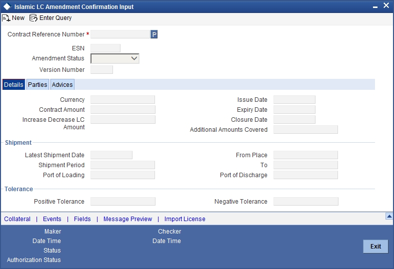

You can invoke this screen by typing ‘LIDAMEND’ in the field at the top right corner of the Application tool bar and clicking on the adjoining arrow button. The screen will be displayed without any details, as shown below:
Click new icon in the application toolbar of the screen.
Contract Reference Number
Select the reference number of the contract to be amended from the option list provided. This option list will display all contracts that are authorized.
Upon selection of the contract, the following details will be displayed in editable mode:
Make the necessary amendments. Save the changes. To save, click save icon in the toolbar of the screen.

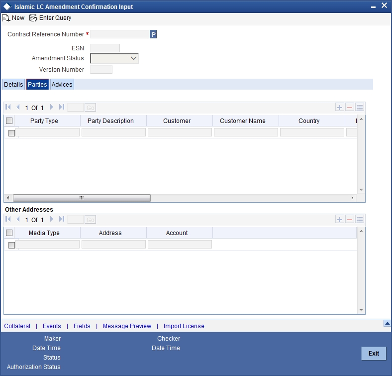

Click the ‘Parties’ tab to view and specify the following details:
Party Type
The system defaults the party type. The user can edit the party type using the adjoining option list that displays all the party types available for the Islamic LC..
Customer
The system defaults the customer number. However, you can modify it.
Customer Name
The system defaults the customer name. However, you can modify it.
Country
The system defaults the country of the customer. However, you can modify it.
Party Description
The system defaults the party description. However, you can modify it.
Dated
The system defaults the date on which the party joined. However, you can modify it.
Customer Reference
The system defaults the customer reference number. However, you can modify it.
Address 1 to 4
The system defaults the address of the party.
Language
The system defaults the language in which advices are sent to the customer.
Issuer Bank
The system defaults the name of the issuer bank.
Media Type
The system defaults the media type. You can select a different medium from the adjoining option list.
Address
The system defaults the other address of the party. However, you can edit this field.
Account
The system defaults the account number. However, you can edit this field.

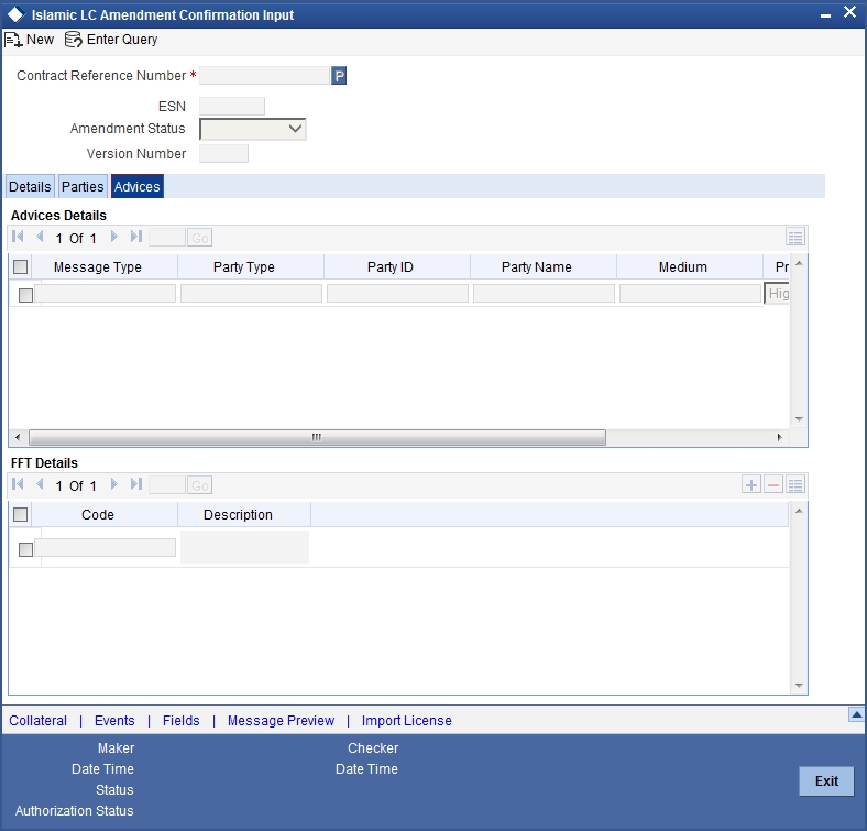

Click the ‘Advices’ tab to view and specify the following details:
Message type
Check the box to view the advice details.
Party type
The system displays the party type for which the advice is generated.
Party Id
The system displays the party id for which the advice is generated.
Party Name
The system displays the name of the party for which the advice is generated.
Medium
The system displays the medium through which the advice is sent. The user can select a different medium from the list. If the medium is modified, the user must provide the new address in the ‘Other Addresses’ section, in the ‘Parties’ tab.
Priority
The system displays the priority of sending the advice. However, you can change the priority.
Suppress
The system displays if the advice is suppressed or not. However, you can edit this field.
Charges
The system displays the charges involved. However, you can edit the charges.
The user can select a message from the ‘Advices Details’ section and associate a code and a description to it.
Code
The user can select the appropriate code from the adjoining option list.
Description
The system displays the description of the selected code. However, you can modify this description.

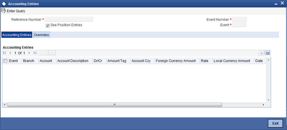

Click on ‘Accounting Entries’ button to view the accounting entries for the event that is highlighted. Click ‘Message’ button to view the messages applicable to the event. Click on ‘Exit’ button to go back to the ’Event Details’ screen.
From ‘Event Details’ screen, click ’Accounting Entries’ button to view the Accounting Entries for the event.The accounting entries that are passed depends on the type of Islamic LC contract that you are processing.
The following information is provided for each event:
Click ‘Exit’ button to go back to the screen from where you invoked the ‘Accounting Entries’ screen.

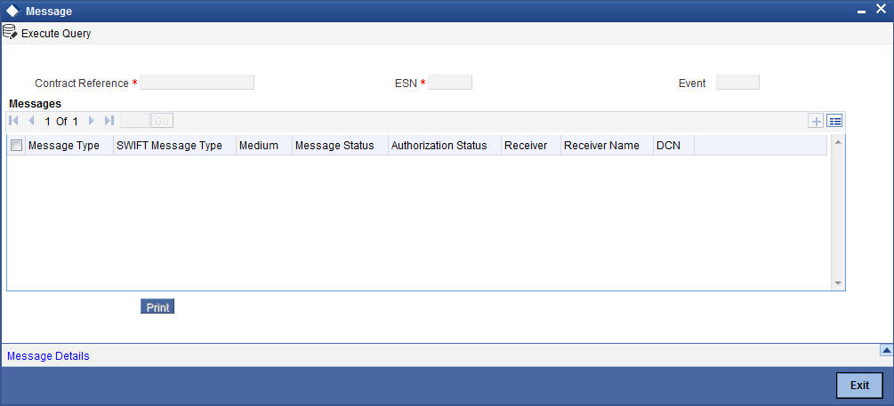

You can preview the messages or advices that will be generated for the contract using ‘Message Preview’ screen. To invoke this screen, click ‘Message Preview’ button.
For the contract, you can view the following details of the messages:
You cannot preview the message if the contract has been authorized. The ‘Message Preview’ button will be disabled in that case.
Select a message/ advice and click ‘View’ button to view the complete message/advice. The system will display the following details in a new window.
You can view the following details:
From the ‘Message Preview’ screen, you can print a message/advice using ‘Print’ button. Select the message/advice and click ‘Print’ button to print the message/advice.
