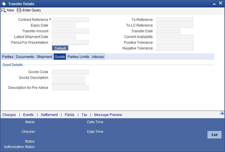

You can transfer funds from an Islamic LC using the ‘Islamic LC – Transfer Input’ screen. You can invoke this screen by typing ‘ LIDTRANF’ in the field at the top right corner of the Application tool bar and clicking the adjoining arrow button.
Indicate the Islamic LC from which you want to effect the transfer. Select a valid Islamic LC Reference from the option list. The manner in which Oracle FLEXCUBE handles a transfer is different for import and export Islamic LCs.
Refer to the title ‘A note on transfers made from Import and Export Islamic LCs’ for more details.
Transfer Amount
The transfer amount is the amount that should be transferred from the original Islamic LC. You can only transfer an amount that is less than or equal to the amount available under the original Islamic LC.
Expiry Date
The expiry date is the date upto which the transferred Islamic LC is valid. The expiry date of the original Islamic LC is defaulted. You can change the defaulted date. However, the expiry date cannot be earlier than the Islamic LC issue date or today's date.
Note
In the case of an export Islamic LC, the expiry date can be earlier than today's date to cater to the late receipt of the Islamic LC. However in this case you will be prompted for an override.
Latest Shipment Date
The shipment date is the latest date by which the shipment of the goods specified for the transferred Islamic LC should take place. The latest shipment date of the original Islamic LC is defaulted. You can change the defaulted date. However, the date you enter should not be earlier than the Issue Date of the Islamic LC and later than the expiry date.
If the latest shipping date that you specify for an Islamic LC falls on a holiday in the Islamic LC currency, you will be prompted for an override.
Note
It is mandatory for you to enter the ‘Shipment Date’ if you are processing an Import Islamic LC.
Period For Presentation
The period of presentation defined for the product - or calculated for the LC, as the case may be - will be displayed. You can change the default to suit the LC you are processing.
To Ref No
Specify the reference number to which the LC should be transferred.
To User Ref No
Specify the user reference number to which the LC should be transferred.
Transfer Date
Specify the date of transfer.
LC Available Amount
The amount available on the chosen LC is displayed here.

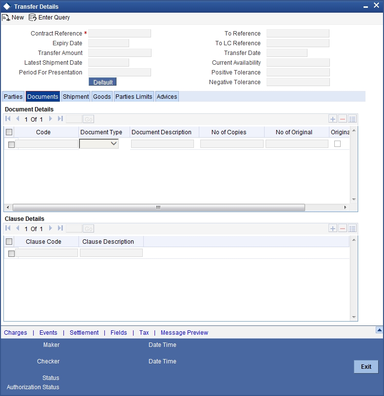

Click on the tab titled ‘Documents’ and specify the following details for a transferred Islamic LC:
There are some standard documents required under a documentary Islamic LC. In this screen you can specify the documents that are required under the Islamic LC being processed. These details will be a part of the Islamic LC instrument sent to the advising bank, the advice through bank or the beneficiary.
All the documents specified for the product to which the Islamic LC is linked will be defaulted to this screen. The details specified for these documents such as the document type, description, the number of copies required, the number of copies issued, the clauses specified for the document are also defaulted from the product. You can edit the description of the document that is defaulted to suit the Islamic LC you are processing.
You can add to or delete from the list of documents that are defaulted. To add a document for the Islamic LC, click add button. To delete a document that is not required for the Islamic LC, highlight the document code and click on the delete button.
The Clauses associated with the documents that you specified for the transfer are defaulted. When you highlight a document code, all the clauses defined for the document are displayed in the Clauses window. You can add to or delete from the list of clauses that are defaulted.
To add a clause to a document for the Islamic LC, click on the add button. To delete a clause that is not required for the Islamic LC, highlight the Clause code and click on the delete button.

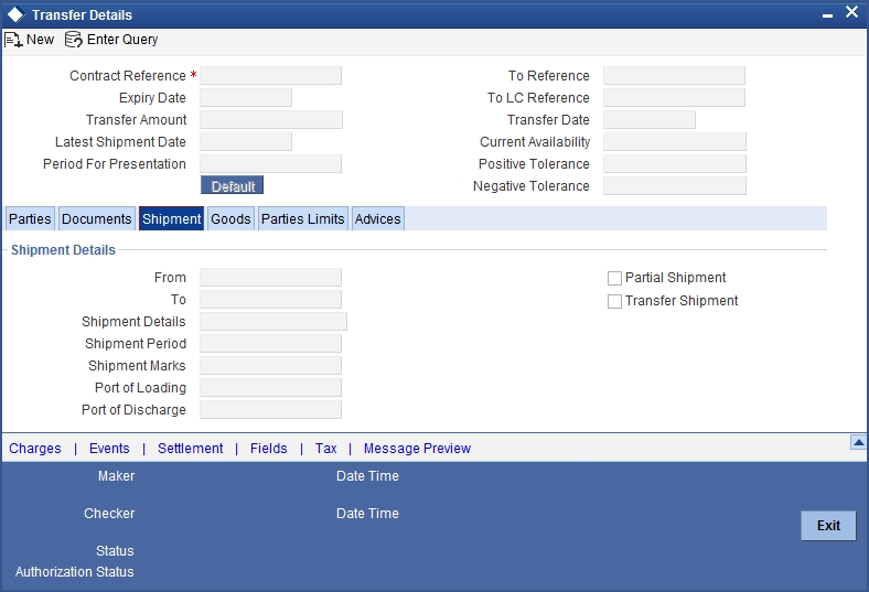

There are certain standard clauses and conditions, associated with the shipment of the merchandise traded under an Islamic LC.
From
Specify the location from whom the goods transacted under the Islamic LC should be shipped.
To
Specify the destination to which the goods transacted under the Islamic LC should be sent.
Port of Loading
Specify the name of the airport from where the goods transacted under the Islamic LC are loaded for shipping.
Port of Discharge
Specify the name of the destination port to which the goods transacted under Islamic LC should be sent.
Note
You can amend the value of ‘Port of Loading’ and ‘Port of Discharge’ after authorization.
Besides these details, you can also specify shipping preferences like:
Goods Code
You have maintained various codes that have been allotted, for commodities normally traded in your country. Select the applicable code for the Islamic LC you are processing.
Goods Description
Specify the description. The description of this code (which could be 6500 characters long), can be changed to suit the Islamic LC you are processing. You can also enter specifications such as the quality and quantity of the merchandise.

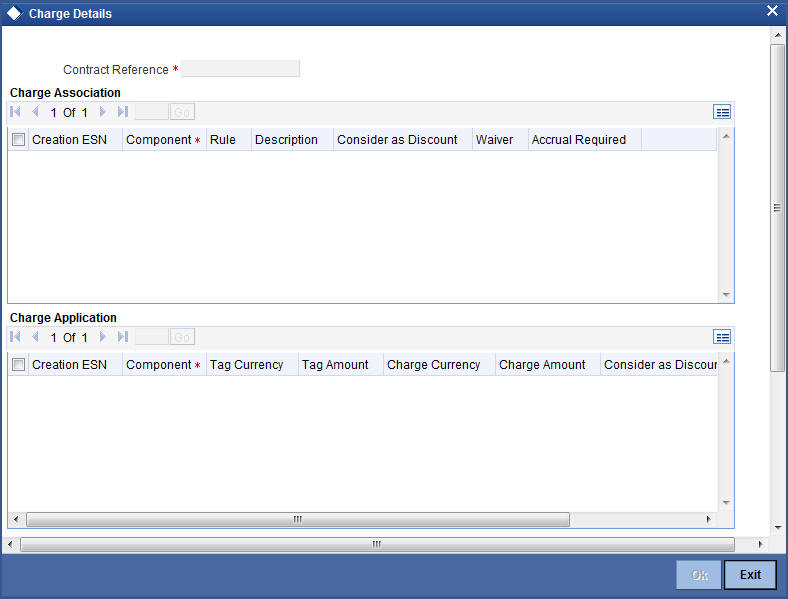

Click ‘Charges’ button to invoke the following screen
Refer the Charges and Fees User Manual under Modularity for further details about this screen.

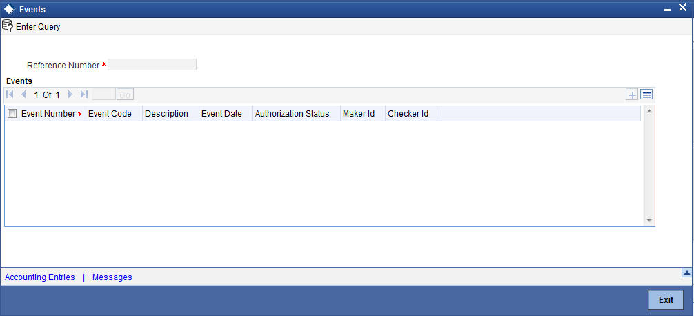

Click this button to view the details of the events and accounting entries that a contract involves.
Click ‘Accounting Entries’ to view the accounting entries for the event that is highlighted. Click ‘Message’ to view the messages applicable to the event. Click on ‘Exit’ or ‘Cancel’ to go back to the ‘Islamic LC Transfer Input’ screen.

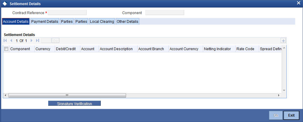

Click this button to invoke the Settlement screen. Based on the details that you enter in the settlement screens the Islamic LC will be settled.
The details of these screens have been discussed in the Settlements user manual.

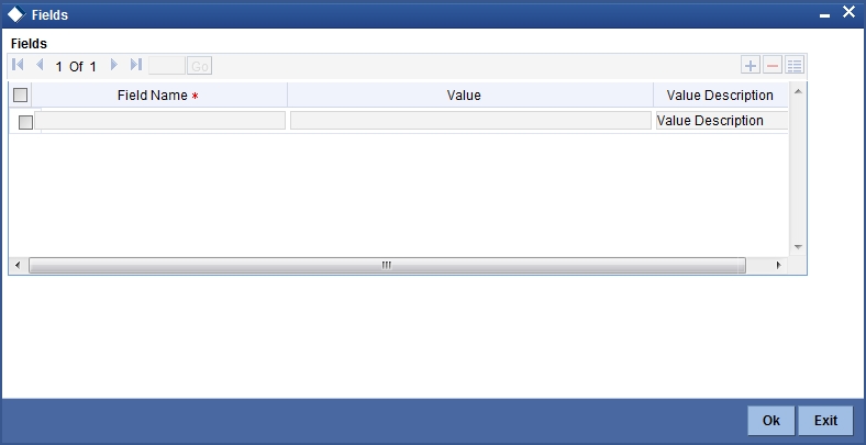

Click this button to specify values for the user defined fields (UDFs).
The User Defined Fields (UDFs) maintained for the linked function id are displayed here. You can specify values for them.
Refer the User Manual titled ‘User Defined Field’ for details about defining UDFs.

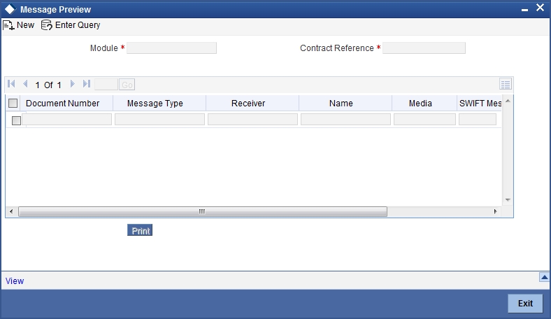

You can preview the messages or advices that will be generated for the contract using ‘Message Preview’ screen. To invoke this screen, click ‘Message Preview’ button.
For the contract, you can view the following details of the messages:
For further details on this screen, refer to the chapter ‘Processing an Islamic LC Contract’ in this user manual.

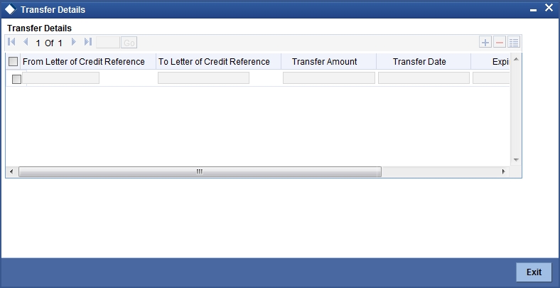

Click ‘Transfer Details’ button from the Islamic LC Contract screen to view details of the transfers that were made from the Islamic LC.
The following transfer details are displayed:
