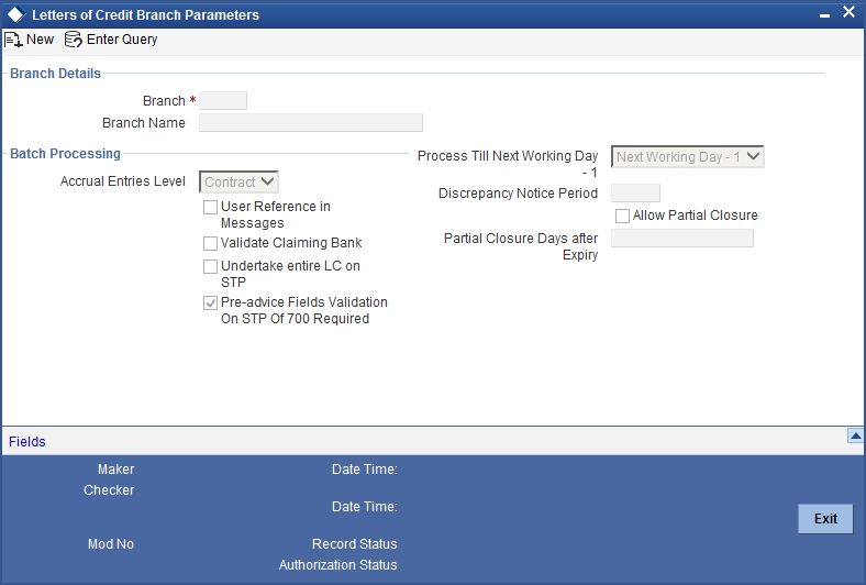

The set of rules that govern the Islamic LCs processed through the Islamic LC module, in a particular branch of your bank, is defined in the ‘Branch Parameters’ screen.
You can invoke ‘Letters of Credit Branch Parameters Maintenance screen by typing ‘LCDBRPRM’ in the field at the top right corner of the Application tool bar and clicking the adjoining arrow button.
In this section specify the following details:
Branch Code
Select the branch code from the option list provided. You can maintain branch parameters only from the respective branches. When you select branch code from the option list, the description of the same is defaulted in the field below.
Note
At the head office level you can alter branch parameters of other branches also.
The events, for which you had indicated automatic processing, are triggered off during the Batch Process. You can specify preferences for the automatic events that fall on a holiday, in the Branch Parameters screen. In addition, you can also specify the level at which accrual entries should be passed, for Islamic LCs in your branch.
You can capture the following preferences here:
Accrual Entries Level
At the time of creating a product, you have specified
An Islamic LC will inherit the accrual frequency defined for the product under which it is processed.
In the Branch Parameters screen, you indicate the level at which the accrual entries have to be passed. The level can be:
If you indicate that automatic accrual should be done at the product level, a single entry for all the Islamic LCs, for which commission was accrued automatically, will be passed. This helps reduce the time taken to pass individual entries.
If you indicate that the automatic commission accrual process should pass accrual entries at the contract level, accrual entries will be passed for each Islamic LC for which commission was accrued automatically.
Process Till Next Working Day – 1
If you indicate that the processing has to be done up to the Next Working Day - 1, all the automatic events falling due on the holiday will be processed by the batch process, as part of the EOD on the last working day, before the holiday.
You have the option to specify, that the Batch process should process automatic events falling due on a holiday.
The same can be processed on either of the following ways:
If you indicate that processing has to be done only upto the System Date, then only the events scheduled for today (the last working day before the holiday) will be processed. The events falling due on the holiday are processed by the batch process, as part of the BOD process, the first working day after the holiday.
User Reference Number in Messages
If you wish to display the user reference number in the advices that are generated for a contract, select the ‘User Reference Number in Messages’ option. All the advices generated at your branch will display the appropriate user reference number.
Note
You can specify a format for the generation of the User Reference Number in the ‘Sequence Generation’ screen available in the Application Browser. Refer to the Core Services User Manual for details on maintaining a sequence format.
Validate Claiming Bank
Check this box to indicate that the claiming bank needs to be validated.
Discrepancy Notice Period
Discrepancies are likely to be found while processing Incoming or Outgoing bills under Islamic LCs. You can specify a period within which the discrepancy details should be added to the bills. This period will be calculated from the date of presentation of the bills (which is typically the booking date of the bill) to the issuing bank/confirming bank.
The system will display an override if the discrepancies are added to the bills (in the ‘Bills – Contract Details’ screen) after the discrepancy notice period.
For details on processing a bills contract, refer the ‘Processing Bills’ chapter of the BC (Bills and Collections) User Manual.

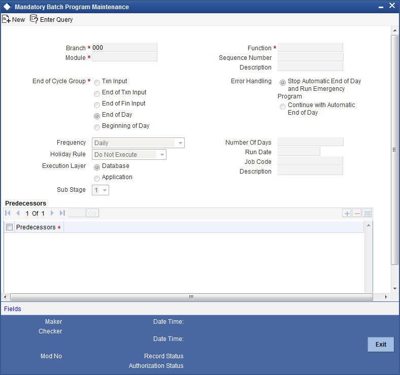

Batches are run automatically. In the mandatory programs, all batches whichever are required will be maintained in sequence and that is triggered automatically as based on the maintenance in the ‘Mandatory Batch Program Maintenance’ screen. You can invoke this screen by typing ‘EIDMANPE’ in the field at the top right corner of the Application tool bar and clicking the adjoining arrow button.
Module
Choose the module code from the adjoining option list.

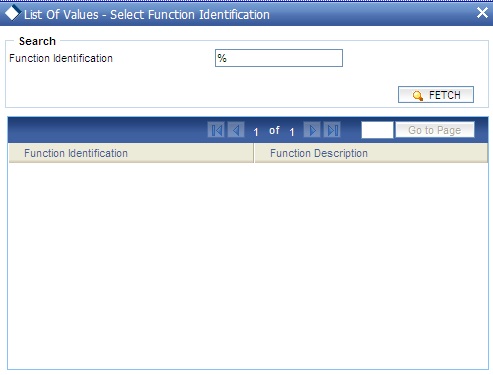

Function Identification
Choose the function ID of batch that you wish to run. The adjoining option list displays all batch processes available for the module.
Select the appropriate one.
You can configure the batch to be run at various stages of day like EOD, EOTI etc.
For further details about this screen, refer the chapter ‘Setting- up Mandatory Programs for EOD’ in the AEOD User Manual.
