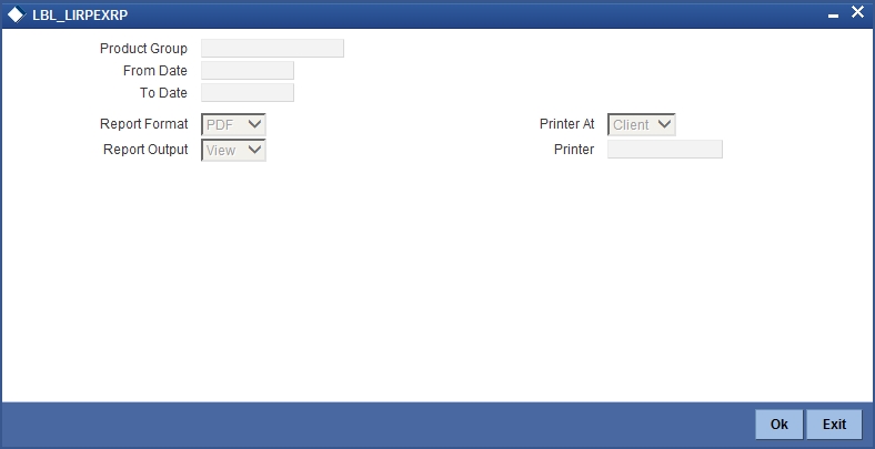

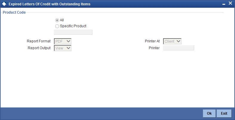

As the name suggests, this report lists all the expired LCs having still have some outstanding items. These outstanding items could be the liability amount, cash collateral and outstanding commission and charges. A commission or charge will be considered outstanding when they are debited from a receivable GL of the bank and not from a customer account.
This report is generated to check if there are outstanding items against an LC. This is done at the time of releasing the cash collateral or while inquiring whether an LC is to be extended, etc.
You have an option to close the LCs that has expired. Once an LC is closed, it will not be reported in this report even if it still has outstanding items. Instead these LCs will be reported in the Closed LC with Outstanding Items report.
You can invoke the screen by typing the code ‘LIRPEX’ in the field at the top right corner of the Application tool bar and click on the adjoining arrow button.
You can specify that the report should contain details of expired LCs associated with all LC products or a specific product. To generate the report for a specific product, select the appropriate Product Code from the option list.
The report options that you select while generating the report are printed at the beginning of the report. The contents of this report are discussed under the following heads:
Header
The Header carries the title of the report, information on the branch and branch date, user id, the date and time, the page number and module of the report.
Body of the report
This report contains details of:
| Fields | Description | |||
| Contract Reference Number | This is the reference number assigned to the LC by the system. | |||
| Event Sequence Number | This is the event sequence number | |||
| CIF ID | This is the customer identification number | |||
| Customer Name | While you are processing an LC, you would have given the CIF ID of one party, in the main screen of the LC Contract On-line function. Typically, it would be the applicant for an import LC while it would be the beneficiary or the issuing bank for an export LC. | The short name of this customer will be shown here. | ||
| Customer Type | This is the party type of the customer whose short name is reported. | |||
| Country | This is the country code. | |||
| Expiry Date | This is the date on which the LC expired. | |||
| Closure Date | This is the date on which the LC is due for closure. | |||
| Currency | This is the currency in which the LC was opened. | |||
| Contract Amount | This is the Maximum LC amount, when the LC was first input and authorized. This amount does not take into account the amendments that were made subsequently to the LC. | |||
| Outstanding Liability | This is the amount available for availment against the LC, as of the date on which the report is generated. | This amount is the outstanding amount after all the amendments made to the LC during its lifecycle. | ||
| Original Liability | This is the liability amount of the LC, when it was first input and authorized. This amount thus does not take into account the amendments that were made subsequently to the LC. | |||
| Current Availability | This is the liability amount due to the LC as of the date on which the report is generated. This amount is the outstanding amount after all the amendments made to the LC during its lifecycle. | |||
| OS Item | This is the outstanding item. It could be cash collateral, commission or a charge which has not been liquidated. | |||
| Currency | The description of the currency in which the outstanding item is represented. | |||
| Outstanding Amount | This is the amount for which the item is outstanding. |

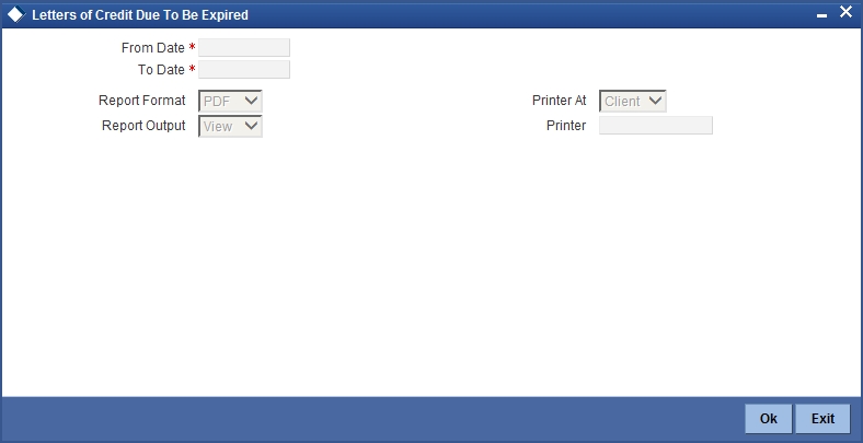

This report lists the details of the LCs that are due to expire for the period that you specify.
The report provides a kind of warning related to the LCs that is due to expire in the future, so that you can take the appropriate action extending the expiry date, if it is required.
You can invoke the screen by typing the code ‘LIRPDUE’ in the field at the top right corner of the Application tool bar and click on the adjoining arrow button.
You can configure this report to be triggered automatically as part of the batch processes run at EOD or you can generate the report at any time in the day from the Reports Browser.
If the report is generated as part of EOD, the report will by default list all the LCs that is due to expire, on the date the report is generated.
If you generate the report outside the EOD, you can specify preferences for the generation of the report. On selecting this report, indicate the period (from and to dates) during which LCs that is due to expire. The system will report all LCs due to expire whether they have outstanding items or not. The details are listed in the order of the expiry date of the LC.
The report options that you selected while generating the report are printed at the beginning of the report.
The contents of the report are discussed under the following heads:

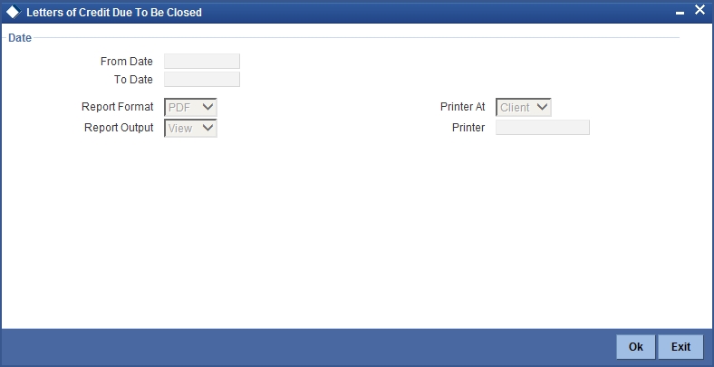

This report lists the details of the LCs that are due for closure, during the period that you indicate.
You can invoke the screen by typing the code ‘LIRPCOLC’ in the field at the top right corner of the Application tool bar and click on the adjoining arrow button.
You can configure this report to be triggered automatically as part of the batch processes run at EOD. You can also generate the report at any time in the day from the Reports menu.
If the report is generated as part of EOD, the report will by default, list all the LCs that is due to be closed, on the date the report is generated.
If you generate the report outside the EOD, specify the period for which the report has to be generated. On selecting this report, you can indicate the period (from and to dates) during which LCs that are due to be closed should be reported. The system will report all LCs due to be closed, whether they have outstanding items or not.
The report options that you selected while generating the report are printed at the beginning of the report. The details of the report are listed on the basis of the closure date of the LC. The contents of the report are discussed under the following heads:
Header
The Header carries the title of the report, information on the user who generated the report (User Id), the branch, branch date, the date and time, the page number and module of the report.
Body of the report
The report contains information on:
| Contract Reference Number | This is the reference number assigned to the LC that is due to be closed. | |||
| Customer Name | While you are processing an LC, you would have given the CIF ID of one party in the main screen of the LC Contract On-line function. Typically, it would be the applicant for an import LC while it would be the beneficiary or the issuing bank for an export LC. | The short name of this customer will be shown here. | ||
| Customer ID | This is the Customer Identification number or code. | |||
| Expiry date | This is the date on which the LC expired or is due to expire. | |||
| Collateral | This indicates the collateral | |||
| Currency | This is the currency in which the outstanding item is expressed. | |||
| Amount | This is the amount of the outstanding item. |

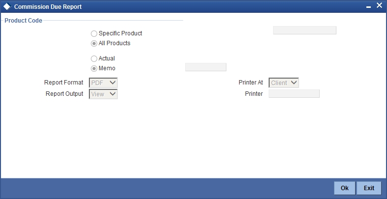

This report prints the details of the periodic commissions that are due to be collected, for a specific period in time.
You can invoke the screen by typing the code ‘LIRPCODU’ in the field at the top right corner of the Application tool bar and click on the adjoining arrow button.
You can specify that this report should contain details of the commission that is due to LCs for a specific period in the future or for all dates. The selection options that you can indicate for the generation of the report are:
The sequence in which the details will be reported is next collection date (from earliest to latest) and then LC reference.
On selecting this report, you can specify the period for which the periodic commissions due to LCs should be reported. For the purposes of reporting, the system takes the next calculation date as the date of collection for LCs. This is for the LCs which you specified that commission should be collected in arrears.
The report options that you indicate while generating the report are printed at the beginning of the report.

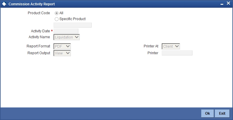

The Commission Activity report prints details of all the LCs for which commission was liquidated or calculated, as of the date the report was generated.
You can invoke the screen by typing the code ‘LIRPCAC’ in the field at the top right corner of the Application tool bar and click on the adjoining arrow button.
You can configure this report to be triggered automatically as part of the batch processes run at EOD, or you can generate the report at any time in the day from the Reports menu.
If the report is generated as part of EOD, it will byf default list all the LCs for which commission was liquidated or calculated as of the current date (the date on which the report was generated).
If you generate the report outside the EOD, you can indicate the date for which you want the activity reported. You also have the option to indicate the activity for which you want details.
You can specify the following options:
Header
The Header carries the title of the report, information on the user who generated the report (User Id), the branch, branch date, the date and time and the page number and module of the report.
Body of the report
The report contains the following details:
| Sequence Number | This is the sequence number | ||
| Component | This is the commission component for which there was an activity. | ||
| Event | This is the Code that identifies the event, during which the commission component is being reported. | ||
| Component Currency | This is the currency of the commission component that had an activity. | ||
| Component Amount | This is the commission amount that was involved in the activity.. | ||
| Start Date | This is the start date of the period for which the commission component is being reported. | ||
| End Date | This is the end date of the period for which the commission component is being reported. | ||
| Debit/Credit Indicator | This indicates whether the transaction was a debit or credit | ||
| Debit Branch | This is the branch to which the debit account belongs. | ||
| Debit Account | If the activity reported is collection, this is the account number or GL to which the commission amount is debited. |

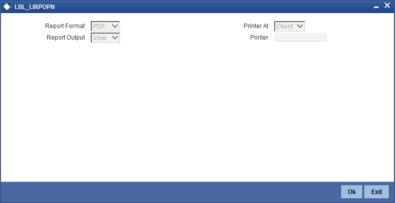

This report lists all the open ended Islamic LCs that has outstanding items. An open ended LC is one for which you have not defined an expiry date.
The details in the report are sorted by product. The sequence of the report is based on the LC issue date and the LC reference number.
You can invoke the screen by typing the code ‘LIRPOPN’ in the field at the top right corner of the Application tool bar and click on the adjoining arrow button.
Header
The header carries the title of the report, the branch, Branch Date, the User ID, the date and time, the module and the page number of the report.
Body of the Report
The details of the report include the following:
| Product Code | The code of the product that you have associated with the LC. | |||
| Issue Date | This is the date on which the LC was processed. It is the issue date for an import or clean LC and guarantee, and is the date of advise or pre-advise (whichever is earlier) for an export LC. | |||
| Customer Number | This is the Customer Identification number or code. | |||
| Country Code | This is the country code. | |||
| Os Liability | This is the outstanding liability amount as of the date the report was generated. | |||
| Current Availability | This is the current availability under the LC. | |||
| Contract CCY | This is the currency of the LC contract. | |||
| Outstanding Item | This is the description of the type of outstanding item to which, the currency and amount shown on the same line relate. It could be cash collateral, commission, or charges, which have not been liquidated. | |||
| Currency | This is the description of the currency in which the outstanding item is expressed. | |||

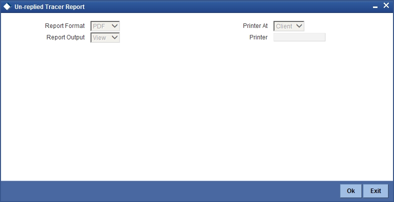

This report provides the details of LCs against which there are some tracers that are yet to be replied by the concerned party.
Items are listed on this report only after the three statutory tracers have been generated and there has been no response. It is listed ten days after the last tracer was sent. A tracer is taken to have been responded, to when you indicate that its generation should be stopped.
You can invoke the screen by typing the code ‘LIRPUNTR’ in the field at the top right corner of the Application tool bar and click on the adjoining arrow button.

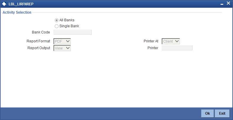

This report lists all the LC that has been confirmed.
You can invoke the screen by typing the code ‘LIRFNREP’ in the field at the top right corner of the Application tool bar and click on the adjoining arrow button.
You can configure this report to be triggered automatically, as part of the batch processes run as part of EOD or you can generate the report at any time, in the day from the Reports menu.
If the report is generated as part of EOD, the report will by default list details of the LCs that have the confirming bank, as a party.
If you generate the report outside the EOD process, you can specify preferences for the generation of the report. On selecting this report, you can indicate whether the report should contain details of all the banks that are involved as confirming banks or of a selected bank. You need to select the bank code from the adjoining option list.
Header
The Header carries the title of the report, information on the user who generated the report (the User Id), the branch, branch date, the date and time, the page number and module of the report.
Body of the report
| Name | This is the short name of the CIF. | ||
| Currency | This is the currency of the LC. | ||
| Product | This is the code of the product involved in the LC. | ||
| Contract Reference Number | This is the reference number assigned to the LC contract by the system. | ||
| Contract Status | This is the current status of the LC contract. | ||
| Contract Amount | This is the amount for which the LC was issued. | ||
| Maximum IL Amount | This is the LC amount plus the positive tolerance specified for the LC. | ||
| Current Availability | This is the current outstanding liability amount, as of the date the report was generated. | ||
| Totals | The total of contract amount, maximum IL amount and current availability | ||
| LCY Equivalent | The total of contract amount, maximum IL amount and current availability in terms of LCY |

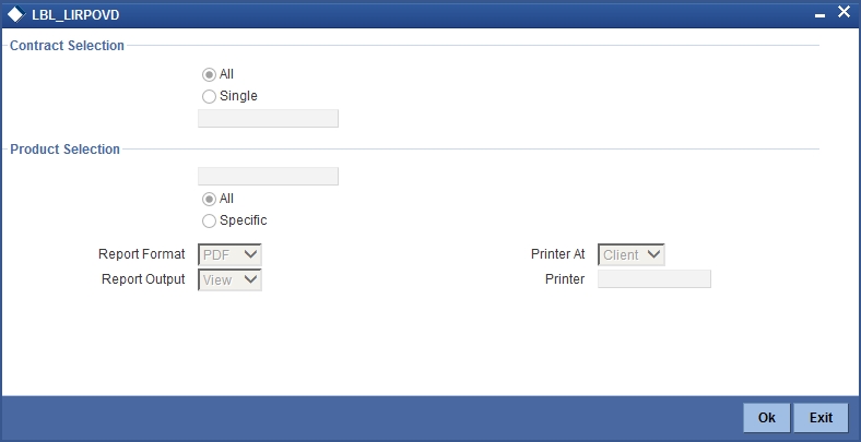

A contract can be saved, with certain exception conditions that were encountered, be given an override. This report lists the overrides that were encountered for contracts, on the date the report was generated.
You can invoke the screen by typing the code ‘LIRPOVD’ in the field at the top right corner of the Application tool bar and click on the adjoining arrow button.
You can generate this report to contain details of all the overrides that occurred during the day or to list the overrides that were encountered, while processing a single LC contract. If you indicate that the report should contain details of the overrides that were encountered in the processing of a single LC, you should also indicate the Reference number of the LC. Also, you need to indicate whether the override report should contain details of all product codes or for a specific product code.

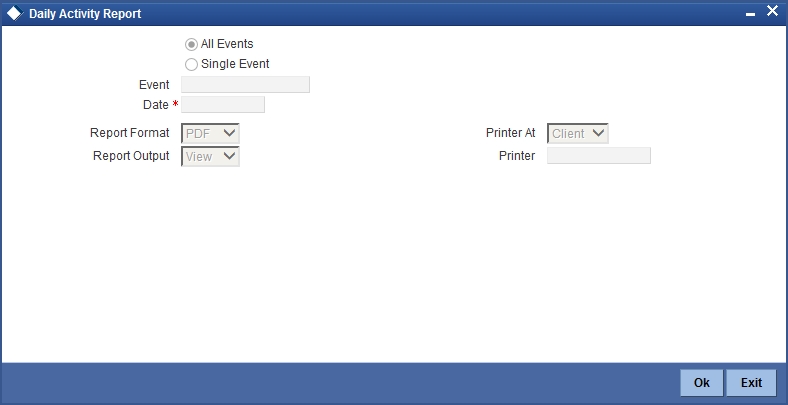

This report gives the details of LCs daily activity journal report. You can initiate the necessary follow up activities after generating this report.
You can invoke the screen by typing the code ‘LIRLYREP’ in the field at the top right corner of the Application tool bar and click on the adjoining arrow button.
On selecting this report, you can indicate whether the report should contain details of all the events or single event. If you indicate single event, then you need to select the event code from the option list. Also, you have to select the date on which the report should be generated.
Header
Body of the report
| Event Code | This is the code of the event | ||
| Description | This is the description of the event. | ||
| Product Code | This is the code of the product involved in the LC. | ||
| Description | This is the description of the product code involved in the LC. | ||
| Contract Currency | This is the currency in which the LC amount is expressed. | ||
| Contract Reference Number | This is the Contract Reference number of the LC. | ||
| Customer Name | The short name of the Customer maintained in LC will be displayed here. | ||
| Operation Code | This is the operation code of the LC. | ||
| Issue Date | The date on which the LC was issued. | ||
| Islamic LC Amount/ Availment Amount | This is the amount for which the LC was opened. | ||
| Total for currency | This is the sum of all the LC amount and currency involved in the LC. |

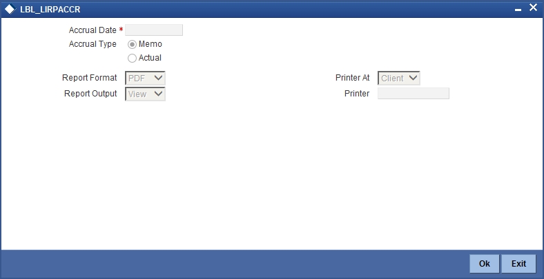

This report lists all the LCs that was accrued. Such LCs may require follow-up action. The information given by this report will be as of the day on which the report is generated.
You can invoke the screen by typing the code ‘LIRPACCR’ in the field at the top right corner of the Application tool bar and click on the adjoining arrow button.
You can specify the date of the accrual.
You need to specify the accrual type. You have the following options:
Header
Body of the report

This report prints the details of the periodic commission activity. The information given by this report will be as of the day on which the report is generated.
You can invoke the screen by typing the code ‘LIRPCACT’ in the field at the top right corner of the Application toolbar and click on the adjoining arrow button.

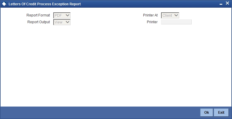

You can generate process exception report by using the ‘Letters of Credit Process Exception Report’ screen. This report lists the process exceptions that were encountered for contracts, on the date the report was generated.
You can invoke the screen by typing the code ‘LIRPEXP’ in the field at the top right corner of the Application tool bar and click on the adjoining arrow button.
Select the process ID from the option list.
You need to indicate whether the process exception report should contain details of all types of activities or a single activity.
Header
Body of the report
| Contract Reference Number | This is the reference number of the LC for which the process exception report is generated. | |||
| Customer | While you are processing an LC, you would have given the CIF ID of one party in the main screen of the LC Contract On-line function. Typically, it would be the applicant for an import LC while it would be the beneficiary or the issuing bank for an export LC. | The short name of this customer will be shown here. | ||
| Error Code | This is the error code for which the process exception report is generated. | |||
| Error Description | This is the description of the error that was encountered. | |||
| Event Code | This is the event code | |||
| Date Time | This is the date and time on which the exception has been raised |

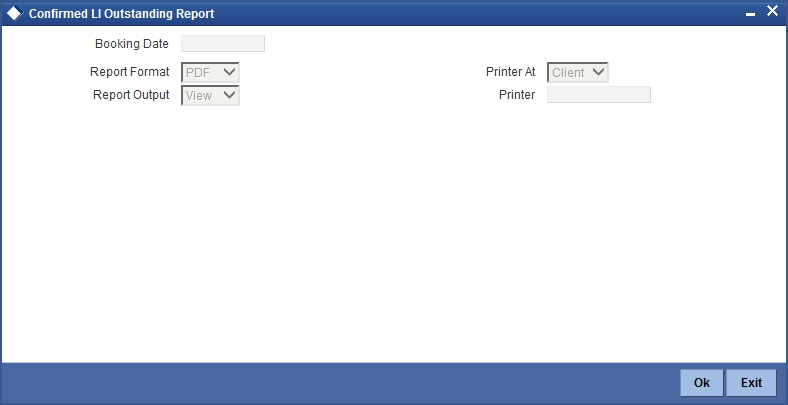

You can generate confirmed Islamic LC outstanding report by using the ‘Confirmed LI Outstanding’ screen. To invoke the screen, type ‘LIRPCNFR’ in the field at the top right corner of the Application tool bar and click the adjoining arrow button.
Booking Date
Specify the booking date of the Islamic LC. The system will generate the report for the records booked on the selected date.
The report options that you select while generating the report are printed at the beginning of the report. The contents of the report are discussed under the following heads:
Header
Body of the Report
| Contract Reference Number | This is the reference number of the LC | ||
| Booking Date | This is the contract booking date | ||
| Issuing bank ID and Name | The Bank code and the name of the issuing bank | ||
| Applicant Name | The name of the person who applied for the LC | ||
| Beneficiary Name | The name of the beneficiary | ||
| Currency | The currency of the LC | ||
| Amount | The amount of the LC | ||
| Tenor | The tenor of the LC | ||
| Issuing Bank Reference | The reference code at the issuing bank side | ||
| Issue Date | The issue date of the LC | ||
| Expiry Date | The expiry date of the LC | ||
| Line Code | The line code |
You can generate a report with the details of the expired Islamic LC outstanding report by using the ‘Expired Islamic Letters of Credit Report’ screen. To invoke the screen, type ‘LIRPEXRP’ in the field at the top right corner of the Application tool bar and click the adjoining arrow button.
Product Group
Select product group from the option list. The system will generate the report for the records that belong to the selected product group.
From Date
Specify the start date of the report date range.
To Date
Specify the end date of the report date range.
Header
Body of the report
| Expiry Date | The expiry date of the contract | ||
| Contract Reference | The LC contract reference number | ||
| Book Date | The date of booking of the LC | ||
| Issuing Bank ID | The ID of the issuing bank | ||
| Issuing bank Name | The name of the issuing bank | ||
| Customer ID | The ID of the customer | ||
| Customer Name | The name of the customer | ||
| Operation Code | The operation code |

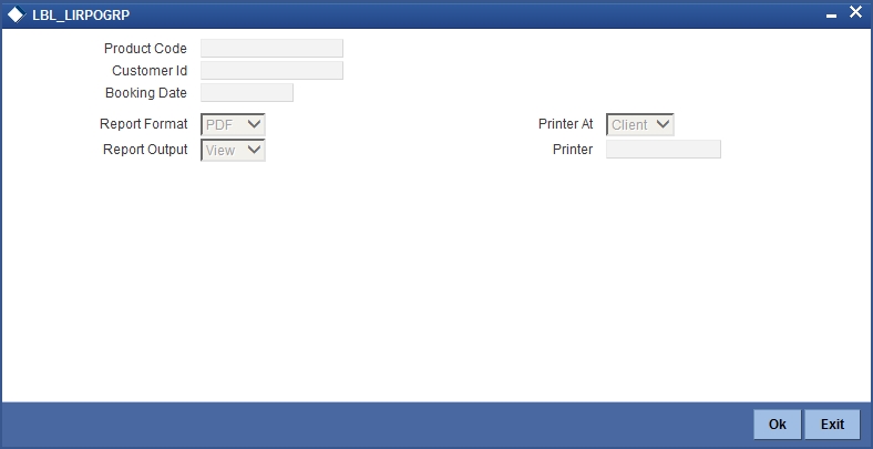

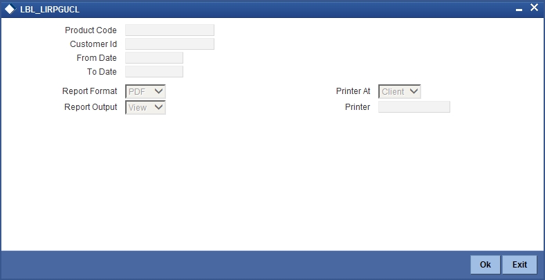

You can generate a report with the details of the guarantees that are due by using the ‘Guarantees Due for Closure Report’ screen. To invoke the screen, type ‘LIRPGUCL’ in the field at the top right corner of the Application tool bar and click the adjoining arrow button.
Product Code
Select product code from the option list. The system will generate the report for the records that are associated with the selected product code.
Customer ID
Select the customer ID from the option list. The system will generate the report with the details of the records of the selected customer.
From Date
To Date
Header
Body of the report
| Expiry Date | This is the expiry date | ||
| Contract Reference Number | The reference number of the contract | ||
| Branch Code | The branch code | ||
| Counterparty | The identification of the counter party | ||

You can generate a report with the details of the guarantees that are outstanding by using the ‘Outstanding Guarantees’ screen. To invoke the screen, type ‘LIRPOGRP’ in the field at the top right corner of the Application tool bar and click the adjoining arrow button.
Product Code
Customer ID
Booking Date
Select the booking date from the calendar. The system will generate the report with the details of the records booked on the selected date.
Header
Body of the report
| Book Date | The book date of the contract | ||
| Register Date | The register date | ||
| Currency | The currency of the contract | ||
| Amount | The amount | ||
| Tenor | The tenor | ||
| RM Code | The relationship manager code | ||
| Guarantee Type | The type of guarantee | ||

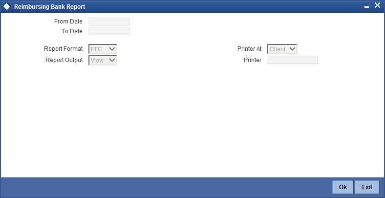

You can generate a reimbursing bank report. To invoke the screen, type ‘LIRPREBK’ in the field at the top right corner of the Application tool bar and click the adjoining arrow button.
From Date
To Date

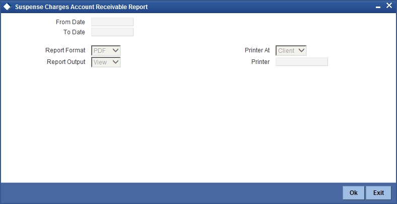

You can generate suspense charges account receivable report. To invoke the screen, type ‘LIRPSCCR’ in the field at the top right corner of the Application tool bar and click the adjoining arrow button.
From Date
To Date

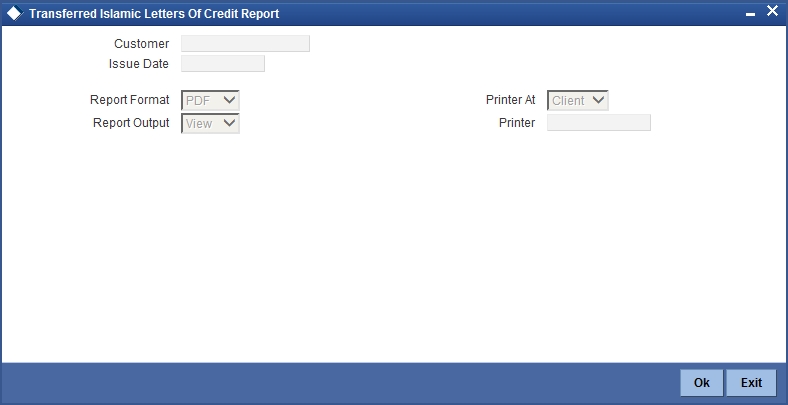

You can generate a customer-wise report of the Islamic letters of credits transferred. To invoke the screen, type ‘LIRPTRDT’ in the field at the top right corner of the Application tool bar and click the adjoining arrow button.
Customer
Select the customer ID from the option list. The system will generate the report for the selected customer ID.
Issue Date
Specify the issue date of the LC.
Header
Body of the report
| From Reference Details | |||
| Contract Reference | The contract reference number | ||
| Issue Date | The date of issue of the LC | ||
| Issuing Bank Reference Number | The reference number of the LC at the issuing bank | ||
| Issuing Bank ID And Name | The ID and name of the issuing bank | ||
| Beneficiary Name | The name of the beneficiary of the LC | ||
| Original Currency | The original currency of the LC | ||
| Original Amount | The original LC amount | ||
| To Reference Details | |||
| Contract Reference | The reference number of the contract | ||
| Transfer Date | The date of transfer | ||
| Transferee ID | The identification number of the person to whom the LC is transferred | ||
| Transferee Name | The name of the person to whom the LC is transferred | ||
| Transfer Currency | The transfer currency | ||
| Transfer Amount | The amount transferred | ||
| Outstanding Liability | Information on the outstanding liability | ||
