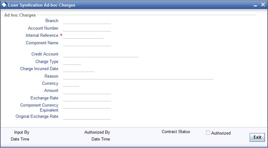

Ad-hoc charge can be collected for tranche or drawdown contract online using the ‘Loan Syndication Ad-hoc Charges’. You can invoke this screen by typing ‘LSDADCHG’ in the field at the top right corner of the Application tool bar and clicking on the adjoining arrow button
In this screen account number, amount, currency, etc. are captured. You will be able to collect the ad-hoc fee component attached to the selected account.
The following details are captured in this screen:
Branch
The current branch is defaulted here.
Account Number
Select the account number from the adjoining option list. The list displays all active accounts maintained in the current branch.
Internal Reference
A system generated internal reference number is displayed here.
Component Name
Select the component name from the adjoining option list.
Credit Account
Select the account to which the ad-hoc charge has to be credited.
Charge Type
Select the charge type.
Charge Incurred Date
Select the date on which the charge is incurred.
Reason
Specify the reason for collecting the ad-hoc charge.
Currency
Specify the currency in which the charge amount is collected.
Amount
Specify the amount to be collected as ad-hoc charge.
Exchange Rate
Specify the exchange rate of the currency.
Component Currency Equivalent
Specify the component currency equivalent of the charge.
Original Exchange Rate
Specify the original exchange rate of the currency.

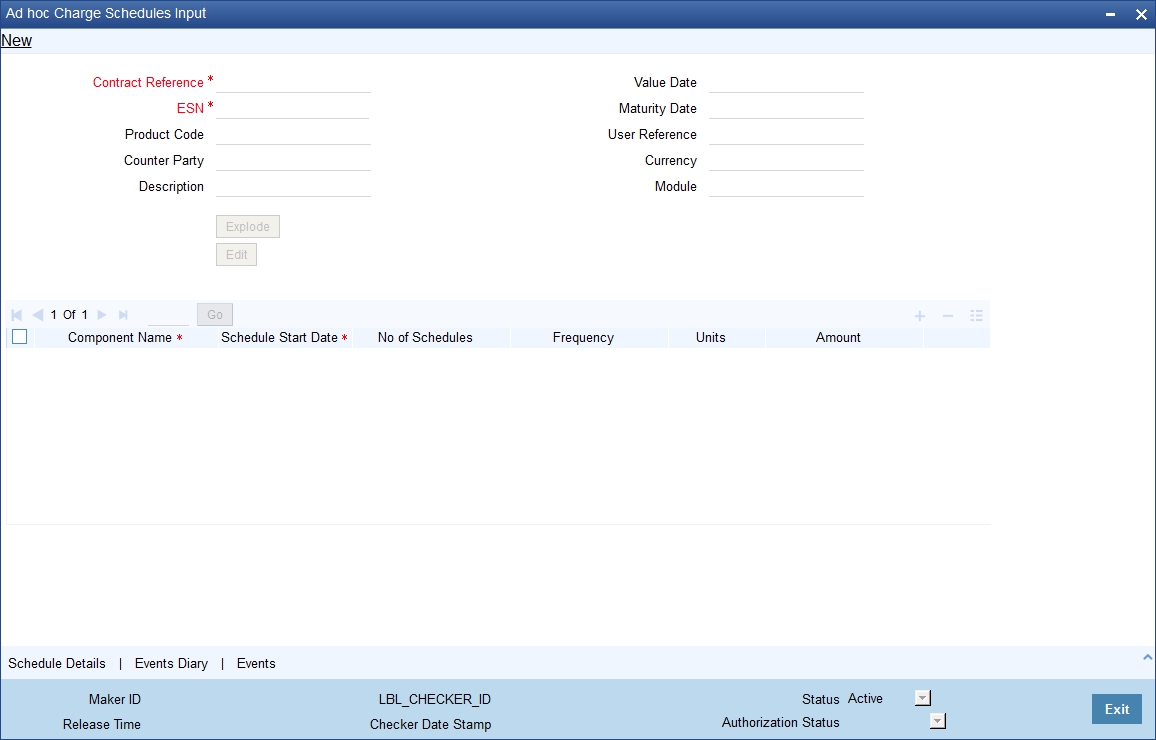

You can specify schedules for ad-hoc fee components in the ‘Ad hoc Charge Schedules Input’ screen. You can invoke this screen by typing ‘LSDADSCX’ in the field at the top right corner of the Application tool bar and clicking on the adjoining arrow button.
In this screen, you must first specify the reference number of the syndication facility or participant contract for which you want to specify the ad-hoc fee schedules. When you do so, the details of the contract, such as the product used by the contract, customer, value date and maturity date, and contract currency, are displayed.
The ad-hoc fee components that have been associated with the product used by the contract are also displayed. For each component, you can define a schedule with the following details:
The start date
This is the date on which the schedule for the ad-hoc fee component for the borrower or participant contract is to begin. The first schedule would fall due on this date.
Number of schedules
You must specify the number of schedules that are to be applicable for the ad-hoc fee component of the borrower or participant contract.
If you define a single schedule (i.e., the number of schedules is one) the system initiates one schedule on the start date mentioned, not taking into account the frequency and the frequency unit. If you define more than one schedule, the system initiates the first schedule on the start date mentioned, and subsequent schedules based on the frequency and the frequency unit specified.
Schedule Frequency
You must specify the frequency at which the schedules must be initiated, with the first schedule on the start date mentioned.
The options available are Daily, Monthly, Quarterly, Half-yearly and Yearly.
Unit
You can specify the units in which the specified frequency will be reckoned, that is, the factor by which the frequency must be multiplied to arrive at the final ad-hoc component frequency.
Currency
You must specify the currency in which the ad-hoc fee amount is reckoned, for the schedule defined for the ad-hoc fee component.
Schedule Amount
You must also specify the amount that is to be liquidated towards the ad-hoc fee component, on the schedule date.
You can view the following details with respect to the ad-hoc fee schedule defined for a contract, from the Adhoc Fee Schedule Input screen:
Click the ‘Payment Schedules’ button in the ‘Adhoc Charge Schedule Input’ screen to view the payment status for the schedules. The Payment Schedule Status screen is opened, with the payment details displayed.
Click ‘Events’ button in the ‘Adhoc Charge Schedule Input’ screen to view the events processed in respect of the ad-hoc fee schedules. The ‘Event Details’ screen is opened, displaying the list of events, with the relevant accounting entries (if any) that have been passed, as well as the overrides encountered.
