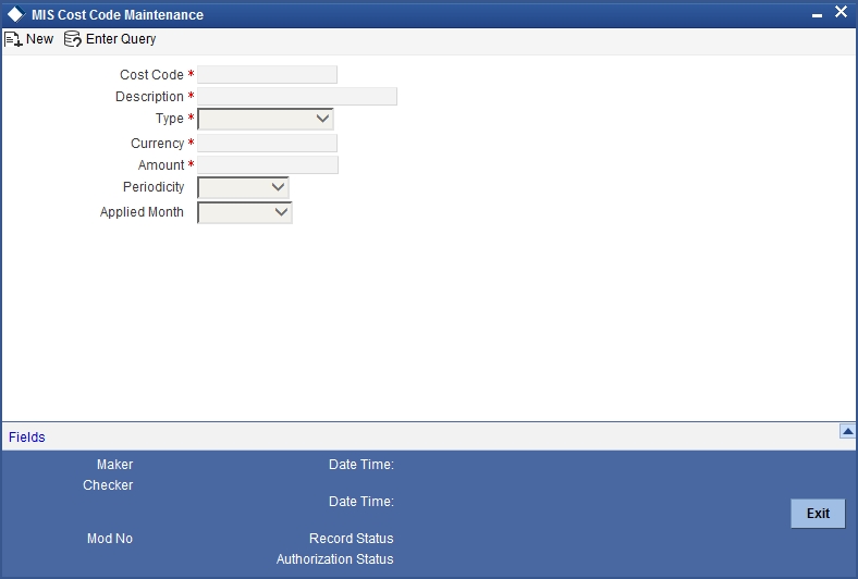

You can invoke this screen by typing ‘MIDXCODE’ in the field at the top right corner of the Application toolbar and clicking the adjoining arrow button.
If you are creating a new MIS Cost Code, select ‘New’ from the Actions Menu in the Application toolbar or click new icon. The ‘MIS Cost Code Maintenance’ screen is displayed without any details.
If you are calling an MIS Cost Code that has already been defined, double-click on an MIS Cost Code from the summary screen.

The notional cost, along with the currency in which it is expressed should be indicated for the cost code. The cost will be applied based on the Cost Code type, as follows:
Cost Code Type | Description | ||
Number of Transactions | The amount is taken as the cost per transaction | ||
Event | The amount is taken as the cost per event | ||
Duration | The amount is taken as the cost for the period defined as the periodicity, for the cost code |
If a currency conversion is involved during reporting, the prevailing conversion rate will be used.
This is the periodicity at which the costs defined have to be applied. In the profitability report, the notional cost reported would depend on the periodicity defined for the cost code.
For a quarterly, half-yearly or yearly periodicity, you should also indicate the first month of application. The subsequent application months would be computed based on this.
