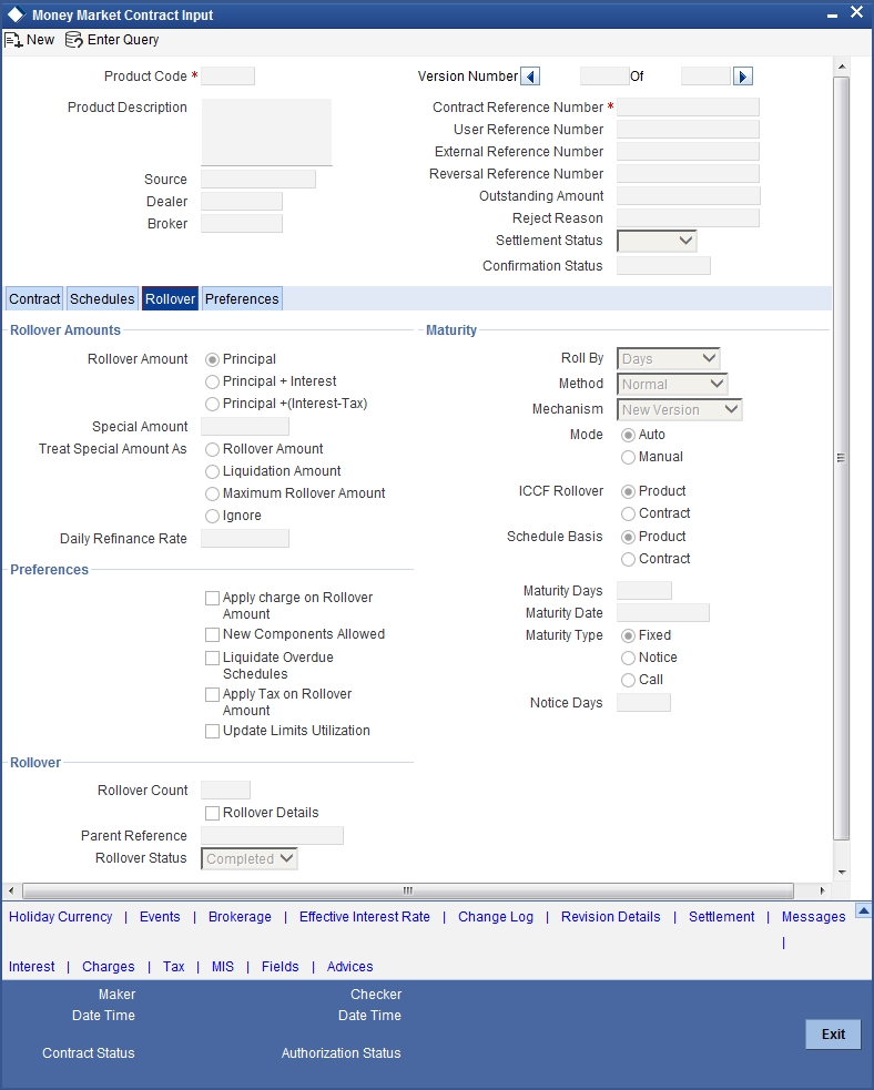

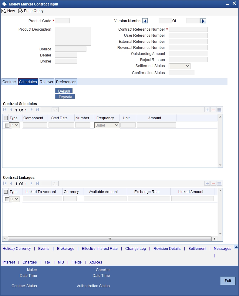

You can invoke the Contract Details screen from the Application Browser by typing ‘MMDTRONL’ in the field at the top right corner of the Application tool bar and clicking the adjoining arrow button.
Once in the Contract Details screen, you will see four other sections, each representing a screen:
Section Screen
Preferences Contract Preferences screen
Schedules Contract Schedule Definition screen
Rollover Contract Rollover screen

4.1.3 Schedules Tab
The contract inherits the schedule details from the associated product. However, you can change at the contract level. Click ‘Schedule’ to view/modify the details.
Click ‘Explode’ button in this screen to invoke ‘Payment Schedule Details’ screen. This screen provides the payment schedule break-up. You can view the following details:
Schedule Summary
Schedule Details
Amount Settled
Refer to the chapter the ‘Processing Repayment’ in this User Manual for details.
4.1.4 Rollover Tab
The rollover details are maintained at the product level. You can however modify them at the time of entering a deal. Click ‘Rollover’ to view/change the rollover details.
The process of rolling over of contracts is explained in detail in the ‘Rolling Over a Deal’ chapter.

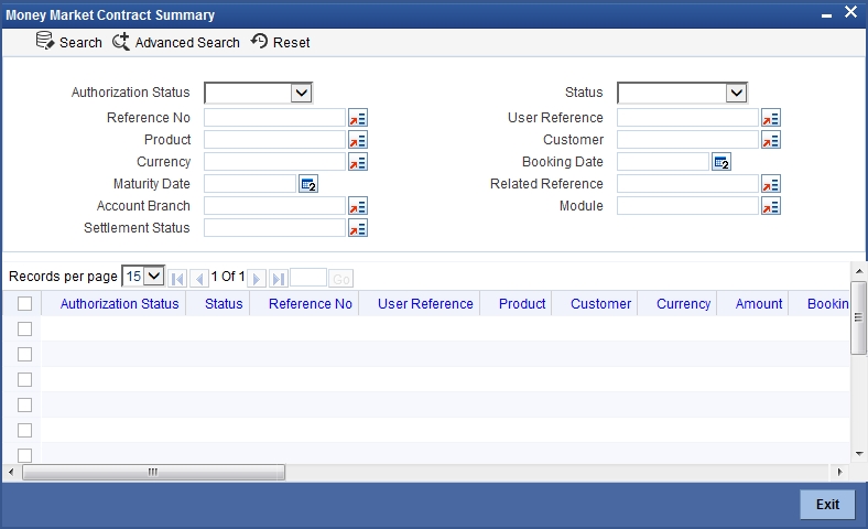

4.1.7 Viewing Money Market Contract Details
You can view the MM contract details maintained in the ‘Money Market Contract Details’ screen using the ‘Money Market Contract Summary’ screen. You can invoke this screen by typing ‘MMSTRONL’ in the field at the top right corner of the Application tool bar and clicking on the adjoining arrow button.
In the above screen, you can base your queries on any or all of the following parameters and fetch records:
Recommended Fields
Optional Fields
Select any or all of the above parameters for a query and click ‘Search’ button. The following records meeting the selected criteria are displayed.

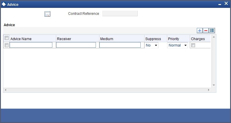

4.4 Advices for Deal Initiation
The advices that have to be generated for any event are specified for the product involved in the deal and are generated after the product is authorized at product level. For example, you may have specified the following advices for the product:
In the Advices screen you can make these changes.
Suppress
By default, all the advices that have been defined for a product will be generated for a deal. However, you can suppress the generation of an advice for a deal by specifying so in this screen.
Priority
Priority applies to payment messages that have to be sent over S.W.I.F.T. By default, such advices will be sent on a Normal priority. You can change it to Urgent.

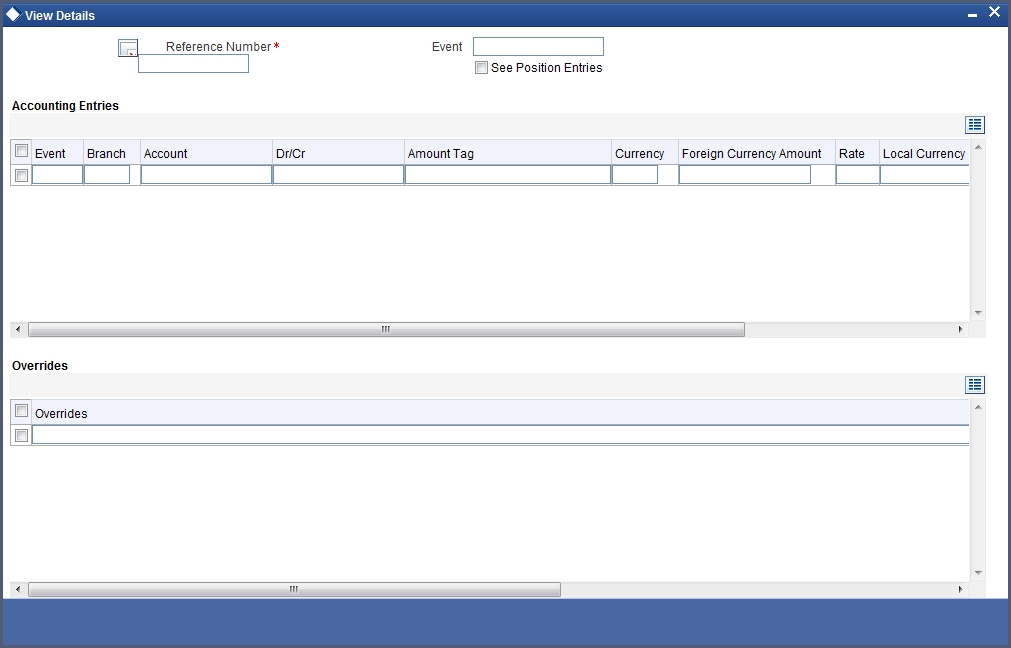

4.6 Viewing Accounting Entries for Deal Initiation
To view the accounting entries passed for a specific event, select the event and click ‘Accounting Entries’ button on the ‘Event Details’ screen. The accounting entries and overrides for that event will be displayed.

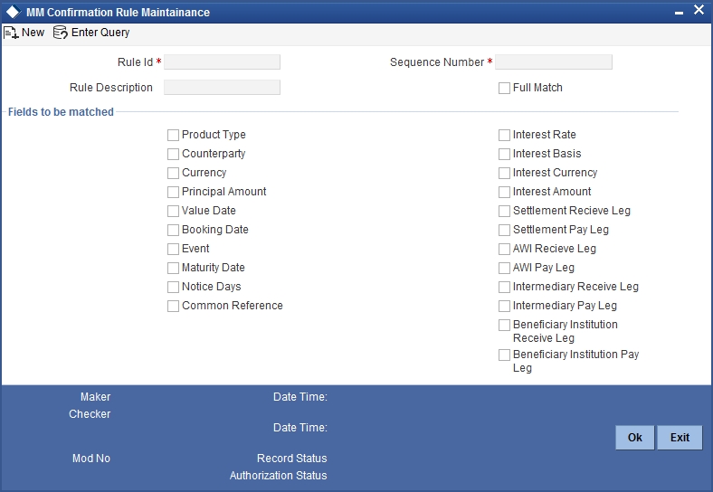

You can maintain confirmation rules for MM deals in ‘MM Confirmation Rule Maintenance’ screen. The auto matching of confirmation messages will be based on these confirmation rules maintained in this screen. To invoke this screen type ‘MMDCNFMT’ in the field at the top right corner of the Application tool bar and click the adjoining arrow button.
You can maintain the following details in this screen:
Rule ID
Specify a unique rule ID for the rule.
Rule Description
Specify a brief description of the rule ID.
Sequence Number
Specify the sequence number for the rule. If there are multiple rules, then auto matching of the messages will be processed based on the sequence number in an ascending order.
Full Match
Check this box to indicate that the confirmation rule maintained is a full match rule.
You have to check the following fields if the rule should be maintained as full match:
Note
You can maintain more than one rule as full match.
Fields to be Matched
You can enable the following fields to match the details of an incoming SWIFT confirmation message MT320/ MT330 with an existing deal in Oracle FLEXCUBE.
If the Full Match Rule is satisfied with a single deal, then the message will be marked as ‘Completely Matched’ and the deal will be marked as confirmed.
If multiple contracts are matched then the message is marked as ‘Partially Matched’.

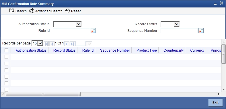

You can view MM confirmation rule details in ‘MM Confirmation Rule Maintenance Summary’ screen. You can invoke this screen by typing ‘MMSCNFMT’ in the field at the top right corner of the Application tool bar and clicking the adjoining arrow button.
Select any or all of the above parameters for a query and click ‘Search’ button. The following records are displayed.:

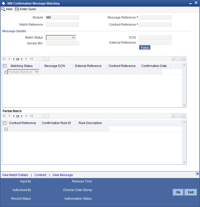

4.10 MM Confirmation Message Matching
4.10.1 Invoking MM Confirmation Message Matching Screen
All the partially matched and unmatched SWIFT confirmation messages can be fetched in ‘Confirmation Message Matching’ screen. You can link an unconfirmed MM deal with a confirmation message which is not yet matched and initiate the confirmation process in this screen. You can invoke this screen by typing ‘MMDMATCH’ in the field at the top right corner of the Application tool bar and clicking the adjoining arrow button.
You can specify the following in this screen:
Module
The system displays the name of the module.
Message Reference
Specify the message reference number. The system displays the Message DCN as the message reference number based on the message details maintained.
Match Reference
The system displays the match reference number.
Contract Reference
Specify the contract reference number. The system displays the MM contract number based on the contract chosen from contract details screen.
Message Details
You can fetch all the message details based on the following message detail criteria selected:
Match Status
Select the match status from the drop-down list. Following are the options available:
DCN
Specify the message DCN. Alternatively, you can select the ‘DCN’ from the option list.
Sender BIC
The system displays the sender BIC.
External Reference
Specify the external reference number. Alternatively, you can select the external reference number from the option list.
Matching Status
The system displays the matching status of the message.
Message DCN
The system displays the message DCN.
External Reference
The system displays the external reference number.
Contract Reference
Specify the contract reference number. Alternatively, you can select the contract reference number from the option list.
Confirmation Date
The system displays the confirmation date.
If a message is selected from the message detail block, then the message DCN will be defaulted in the ‘Message Reference’ field.
Partial Match
You can view the following partially matched message details:
Contract Reference
The system displays the contract reference number of the partially matched messages.
Confirmation Rule ID
The system displays the confirmation rule ID.
Rule Description
The system displays the description maintained for the rule.
If a partially matched message is selected in the partial match block, then the corresponding contract reference number will get defaulted in the ‘Contract Reference’ field.
The manual match of the messages will be done based on the Message Reference and Contract Reference displayed in this screen.

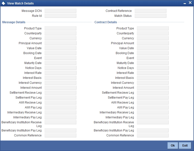

4.10.2 View Match Details Button
Click ‘View Match Details’ button in MM Confirmation Message Matching screen to view message match details based on the message and contract reference numbers.

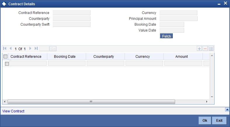

Click ‘Contract’ button in MM Confirmation Message Matching screen to view the contract details.

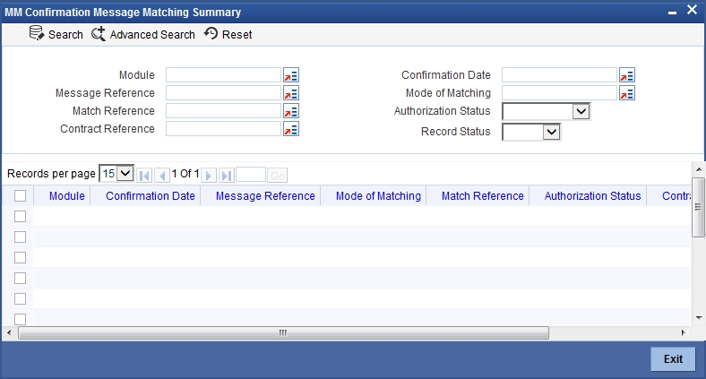

4.10.5 Viewing MM Confirmation Message Matching Details
You can view MM confirmation message matching details in ‘Confirmation Message Matching Summary’ screen. You can invoke this screen by typing ‘ MMSMATCH’ in the field at the top right corner of the Application tool bar and clicking the adjoining arrow button.

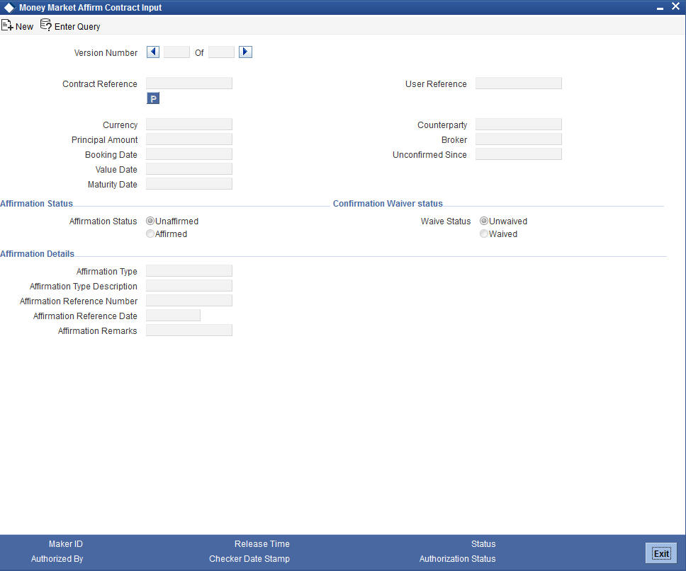

4.11 MM Affirmation Input
This section contains the following topic:
4.11.1 Invoking MM Affirmation Input Screen
You can affirm or un-affirm, waive or un-waive a deal from ‘MM Affirmation Input’ screen. You can invoke this screen by typing ‘ MMDAFFRM’ in the field at the top right corner of the Application tool bar and clicking the adjoining arrow button.
You can maintain only one MM contract record in ‘MM Affirmation Input’ screen.The system displays the following fields in this screen:
Affirmation Status
Select the affirmation status of the MM deal. The options available are as follows:
If the affirmation status is changed from unaffirmed to affirmed and the affirmation type or affirmation reference number is not specified then the system displays an error message.
Confirmation Waiver Status
Select the MM deal confirmation waiver status. The options available are as follows:
You can modify either ‘Affirmation Status’ or ‘Confirmation Waiver Status’ at a time.
Affirmation Details
Affirmation Type
Specify the affirmation type. Alternatively, you can select the affirmation type from the option list.
Affirmation Type Description
Give a brief description on the affirmation type.
Affirmation Reference Number
Specify the affirmation reference number.
Affirmation Reference Date
Select the affirmation reference date from the adjoining calendar.
Remarks
Specify remarks, if any.

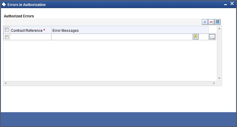

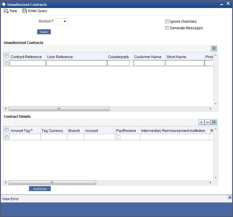

4.14 Authorizing Bulk MM contracts
Money market deals must be authorized in the respective Contract Online screens. This method of authorizing the deals can be quite cumbersome, especially if the volume of transactions is large. In view of that, Oracle FLEXCUBE allows bulk authorization of all unauthorized money market deals from the ‘Unauthorized Contracts’ screen. Invoke this screen from the Application Browser.
In the ‘Unauthorized Contracts’ screen, you can indicate the following parameters:
For example, if the maturity date of a contract is 30th December 2001 and is a holiday for your bank, system will display an override:
“30-DEC-2001 is a holiday”.
However, you can opt to ignore such overrides by checking against ‘Ignore Overrides’.
On authorization of a contract, the messages associated with the deal will be generated. To generate the messages, check against ‘Generate Messages’.

4.14.1 Authorizing the Deals
You can either opt to authorize all the deal that are displayed or choose only certain contracts for authorization.
After selecting the deals, click ‘Authorize’ to authorize the deals.
4.14.2 Viewing the Errors
If the system encounters any errors during the authorization of a particular deal, it will record the error and move on to the next contract.
Among the deals selected for authorization, there may be certain deals, which are created by the user who is authorizing. As the maker and checker cannot be same, system will record an error, as it cannot authorize the deal.
Click ‘View Error’ to view the details of the errors recorded. In this screen, system will display the reference number of the deals, which could not be authorized and the reason for the failure of deal authorization.

4.14.4 Viewing the Details of the Deal
The details of the unauthorized deals can be viewed by double clicking on the deal reference number in this screen.
In case of money market deals, the screen that is displayed on double clicking a deal depends on the stage of the deal that is unauthorized.

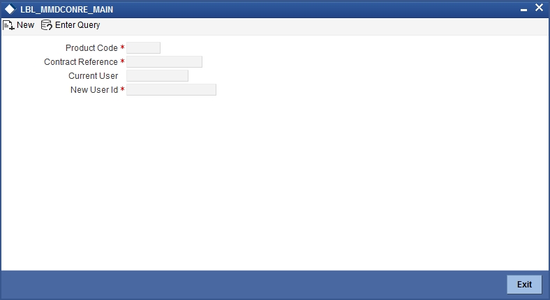

4.15 Reassigning a Contract to Another User
Normally, an unauthorized contract can be deleted only by the user who has created it. If a contract has to be deleted and the user who has created it is not around to do it, then you may reassign the contract to another user. The newly assigned user can delete the contract. Typically, this situation may arise during End of Day operations when an unauthorized contract has to be deleted and the user who created it has left the office for the day. You can reassign a contract only if you have sufficient access rights to do it.
You can reassign a contract through the 'Reassign User Prior to Authorization' screen. You can invoke this screen by typing 'MMDCONRE' in the field at the top right corner of the Application tool bar and clicking the adjoining arrow button. The screen is displayed below.
Specify the following details:
Product Code
Specify the product code associated with the contract that you want to reassign to a different user. Select the product code from the adjoining option list.
Contract Reference Number
Specify the reference number of the contract that you need to reassign. Select the appropriate one from the adjoining option list.
Current User
The user ID of the person who has created the contract is displayed in this field.
New User Id
Specify the user ID of the person to whom you need to reassign the contract.
Click 'Ok' button to save the details you entered. The system will reassign the contract to the new user. Click 'Exit' button if you do not want to save the details.

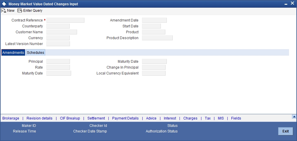

4.16 Amending Money Market Transactions
Once a MM contract is authorized, changes to this can be done through the ‘Money Market Value Dated Changes Input’ screen. You can invoke this screen by typing ‘MMDVAMIN’ in the field at the top right corner of the Application tool bar and clicking on the adjoining arrow button.
For more details on the field explanation of each tab, refer section ‘Features of the Contract Details screen’ section of this User Manual.
4.16.1 Authorizing Money Market Contracts
You cannot authorise a contract from the ‘Money Market Contract Input’ screen in the following cases:

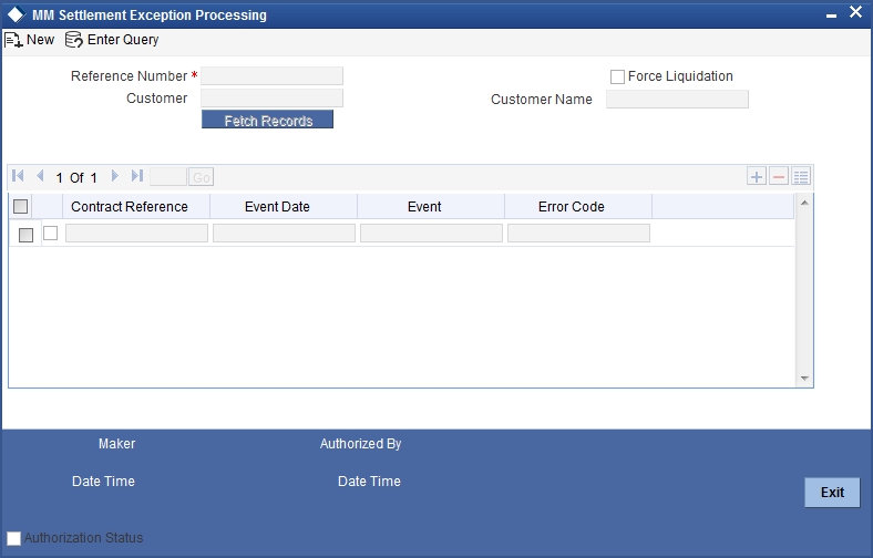

4.17 MM Settlement Exception
4.17.1 Processing MM Settlement Exception
You can view and process MM placement deals for which the settlement status is pending. If the fund in the settlement account is less than the due amount, then the system updates the contract settlement status as pending. These pending transactions can be viewed and processed through ‘MM Settlement Exception Processing’ screen. You can invoke this screen by typing ‘MMDEXCEP’ in the field at the top right corner of the Application tool bar and clicking on the adjoining arrow button. You are allowed to Create, Save, Authorize, Delete and Enter Query in this screen.
In this screen you can query all MM deals pending for settlement.
Reference Number
The system displays the reference number.
Customer
Specify the customer number. Alternatively, you can select the customer number from the option list. The list displays all valid customer numbers.
Force Liquidate
Check this box if the customer account should be force debited.
Click ‘Fetch Records’. The system displays the following information:
