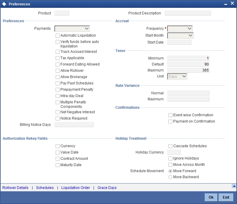

You should define the attributes of the schedules for a product through the Preferences screen.
Components of a deal can be liquidated automatically or manually. In the Product Preferences screen you should indicate whether the mode of liquidation of repayment schedules is to be automatic.
Specify Auto liquidation if you want the components of a deal (involving a product) to be liquidated automatically. If you so specify, a schedule will be automatically liquidated on the day it falls due, during beginning of day processing (by the Automatic Contract Update function.)

You have to specify whether the payment method for the main interest is to be bearing, discounted, or true discounted. This cannot be changed at the time of processing a deal.
Bearing
The interest is liquidated on schedule payment date(s).
Discounted
In this interest payment method, the interest is deducted at the time of initiating the deal.
True discounted
In this interest payment method, the interest is calculated on the principal in a manner differing slightly from the ‘Discounted’ method. The interest rate is applied on the Principal instead of the Nominal, as it is done in the ‘Discounted’ method.

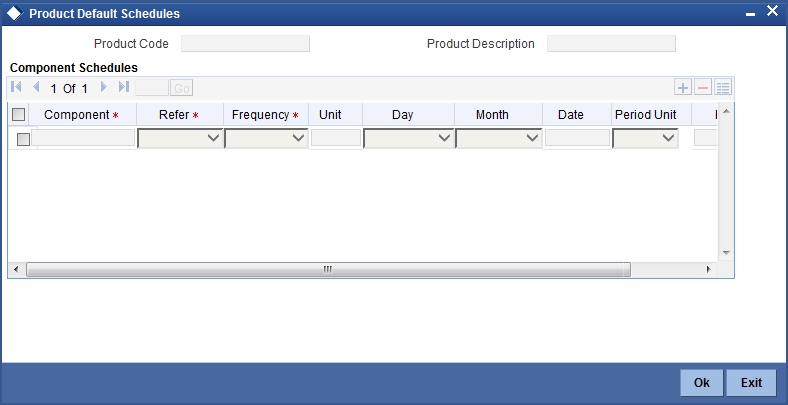

To go to the Product Default Schedules screen, click on the Schedules button in the Product Preferences screen.
You can define schedules for each component for the product through the Product Default Schedules screen. This involves specifying the reference date, the frequency, the month and date for each component.
When creating a product (in the Product Default Schedules screen), you can define schedules for all deal components. This involves specifying the reference date, the month and the date for each component etc. All deals, involving the product, will acquire these attributes.
Component
You can define different repayment schedules for the different components according to your needs. First of all, you should specify the component for which you want to define the schedule. All components − the principal and any other component depending upon your ICCF definition for the deal − are available in the adjoining option list. You will have to define schedules for each of them.
When defining repayment schedules for specific deals, the amounts for components like interest, commission, and fee will be calculated by the system automatically, depending on the repayment date and amount of the principal. However, for deals with special interest, you will also have to provide the interest amount.
Refer
Indicate whether the dates of repayment schedules should be calculated based on the Value Date (date of initiation of the deal) of the deal involving the product, or a Calendar Date. If you specify that the Reference is the Value Date (date of initiation of the money market deal), the dates for schedule repayments will be based on this date and the Frequency.
If the Reference is specified as the Calendar Date, the dates for schedule repayments will be based on the Start Date (specified by you), the Month and the Frequency. The following example illustrates this concept.
If Reference is set to Value Date (deal initiation date), you need to specify only the Frequency (monthly, quarterly etc.) and the unit of frequency (if you specify the frequency as weekly and the unit as 1, it means once a week). The system will set the schedule according to the Frequency and Unit of Frequency you have specified, beginning on the Value Date.
Frequency
For a periodic schedule, you can indicate the frequency of repayment for each component. This could be:
By default, the frequency will be Bullet, meaning all the repayments will be made on maturity. If the frequency is defined as Bullet, you cannot enter a value into the subsequent fields.
Unit
You can specify the number of units for the frequency you have set for a particular component.
For example, if you want a payment every 15 days, you will have to specify
For payments every three weeks, you will have to define
Day
If you have set the Reference as Calendar Date and the frequency as weekly, quarterly, half-yearly or annual indicate the day on which the first schedule falls due. Based on this, the subsequent schedule dates will be calculated.
Month
If you have set the Reference as Calendar Date and the frequency as weekly, quarterly, half-yearly or annual indicate the month in which the first schedule falls due. Based on this, the subsequent schedule dates will be calculated.
Date
If you have set the Reference as Calendar Date, you should indicate the date on which the schedule should fall due. Specify 31 to indicate that the schedule should fall due on the last day of the month (that is, 31 for months with 31 days, 30 for months with 30 days and 28 or 29, for February).
The schedule repayment dates will be computed using the Frequency, (Start) Month and the (Start) Date.
A schedule date:
Period Unit
You need to specify the unit for the interest period. The available options are as follows:

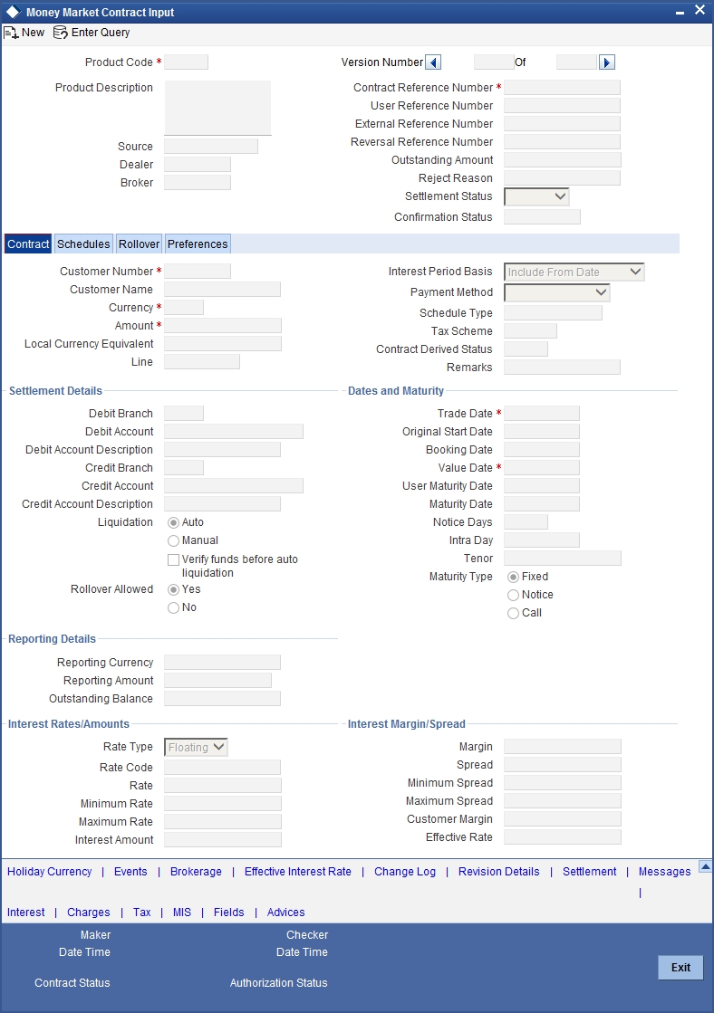

The attributes of the schedules inherited from the product can be changed for a deal through the Contract Preferences screen.
Schedule preferences are the attributes of the repayment schedules defined for the deal. The attributes that have been defined for the product are inherited by all deals involving the product. Some of these attributes can be changed. They are:
Click ‘Preferences’ to specify an additional set of schedule-related attributes.

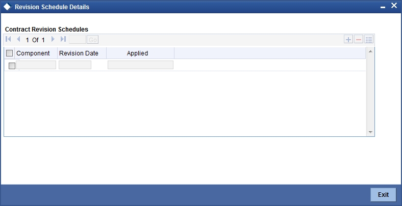

When you click on the Revision Details sub screen you will see the ‘Revision Schedule Details’ screen. Here you can view the details of the revision schedules for a particular deal.
In this screen you can see the following details for the component:

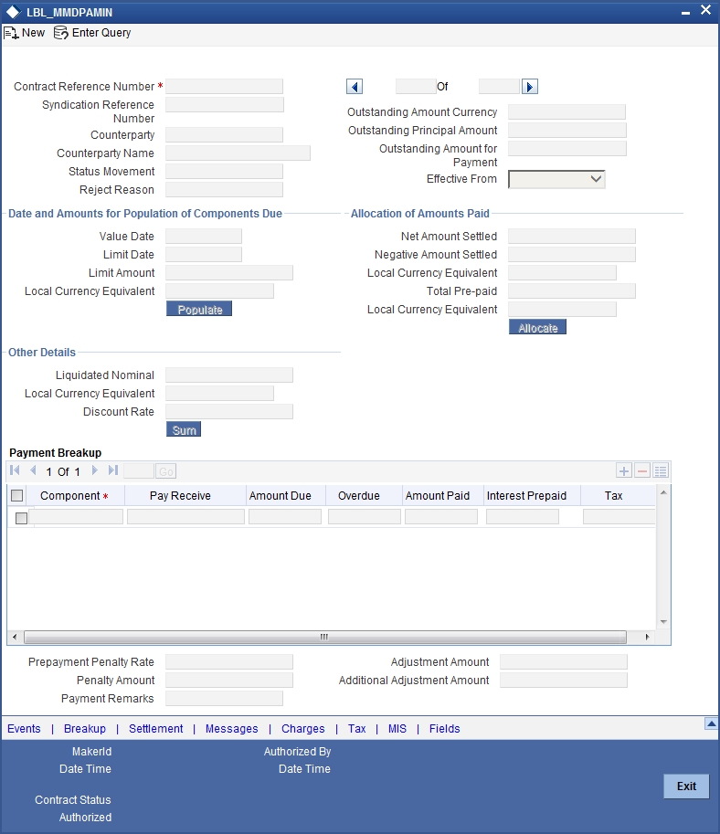

You can invoke the ‘Money Market Payment Input’ screen from the Application Browser by typing ‘MMDPAMIN’ in the field at the top right corner of the Application tool bar and clicking the adjoining arrow button.
You can do the following operations the manual payments function:
The manual payments made through this function can be:
The value date you have entered will be used for all the entries generated by the system.
Once you enter the deal reference number in the Contract Schedule Payments you will see the following details displayed on the screen:
The Value Date here, is the date on which the liquidation entries will be passed. When you enter a Value Date in this screen, if there are any payments due on that date, they will be displayed and you can liquidate them.
If there are no schedules due on that date, the schedule becomes a prepayment. But this is only if the Value Date is not a back valued date. You can have a back valued date but it cannot be earlier than the last schedule that was due. (You can also liquidate back valued schedules by entering a Limit amount).
If the Value Date is today or a date in the future, the prepayment is processed.
The Payment Limit Date or Amount of the payment should be given at the time of payment. If you have given a payment limit date, the system shows all the components, which are due till the limit date. If you have given the amount limit in the Amount field, it shows all the schedules for the limit amount.
Note
While the Prepayment Limit Date is used to pick up the schedules pending as of that date, the Value Date is taken into account by the system for passing accounting entries.
Alternatively, the system picks up a schedule according to the amount being paid. You will see the next schedule, which is due, within the limit of this amount. If the amount being paid is more than the total amount payable for the next schedule, the next schedule will be considered. The total amount due for these schedules is displayed.
You have to enter the actual amount being paid in the Net Amount Settled field. If there are both positive and negative amount to be settled, then the net amount should be specified here. This amount can either be allocated to the various components manually, by entering the break up of the amount against the various components, or automatically by clicking the Allocate button. The total negative amount that should be settled is displayed in Negative Amount Settled field. Partial payment of negative amount is restricted. Back dated payment of interest amount is allowed till last payment date or amendment date, whichever date occurs later.

In the Contract Schedule payment screen, you have a set of icons using which you can navigate to the following screens:
‘Settlements’ - Click to go to the Settlement Message Details screen
‘Tax’ - Click to see the Tax details screen
‘Advices’ - Click to see the Advices screen. You can suppress advices using this screen.
‘Breakup’ - Click to view the Schedule Breakup screen.
‘Events’ - Click to view the Events screen.

In this screen,
Settlement messages, defined for components that fall due, will be generated automatically when you execute the Settlement Generation function at the end of day. You can suppress the generation of the settlement message, defined for a component, by clearing the check-box in the ‘Gen Message’ field in the ‘Contract Settlement Message Details’ screen.
In the Schedule Payments screen, you will see a row of icons. Click ‘Breakup’ to view the Schedule Breakup screen .
You will see the following in this screen:
Component
In this screen you can see the schedules being paid on account of this particular payment for which you are doing manual liquidation. The component getting paid is displayed.
Due Date
The due date of the component being liquidated is displayed.
Amount Due
The amount outstanding for the component being liquidated is displayed here.
Amount Paid
You can see here the amount paid for the component as of the value date (the current system date).
