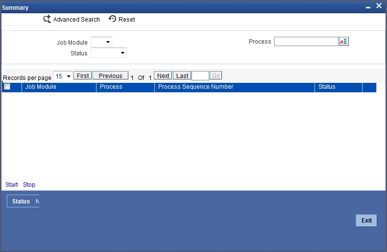

Oracle FLEXCUBE allows you to match deal confirmation. To do this, you need to invoke the ‘Jobs Browser’ screen by typing ‘CSSJOBBR’ in the field at the top right corner of the Application Browser and clicking the adjoining arrow button.
Specify the following details.
Job Module
Select ‘MS’ from the adjoining drop-down list.
Process
Specify ‘PR_AUTO_MT100_FT_MAN’ as the process.
Click ‘Start’ to run the job.
After running the Job, system will process the incoming message and match the following details with those of the existing deals in the system:
Incoming messages MT320 and MT330 will be available in the system. If the details of an incoming message match with an existing deal in the system, then confirmation will happen. The system will trigger the ‘CONF’ event for the respective deals.
