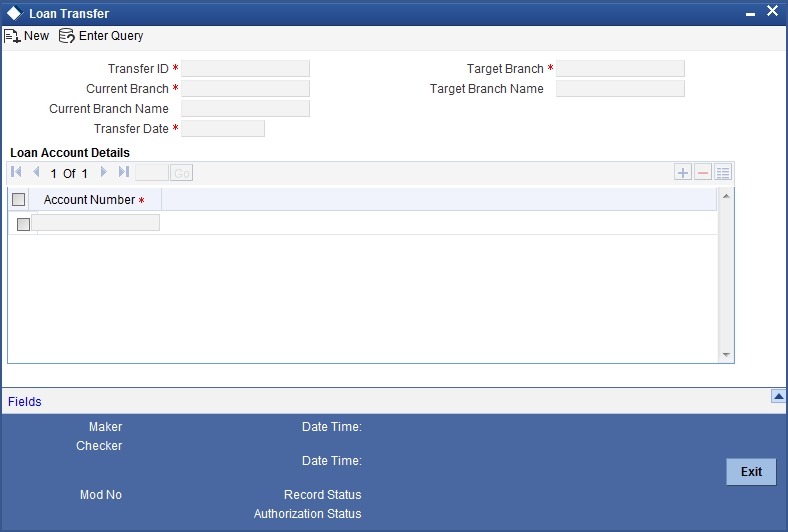

Oracle FLEXCUBE supports transfer of mortgages and commitment from one branch to another. This will be either customer initiated transfer or branch initiated transfer. Customer initiated transfer is single mortgages transfer and branch initiated transfers are multiple mortgages transfer.
You can capture the mortgages, the branch to which it is transferred and the date the mortgage has to be transferred from Mortgage Transfer screen. You can invoke this screen by typing ‘MODACCTR’ in the field at the top right corner of the Application tool bar and clicking on the adjoining arrow button.
You can specify the following details in the Mortgage Transfer screen:
Transfer ID
System displays the unique number to identify the transfer on clicking ‘New’.
Current Branch
System displays the Current Branch of the mortgage.
Current Branch Name
System displays the Name of the current branch of the mortgage.
Transfer Date
Select the Date on which mortgage account has to be transferred.
The transfer date for MO contract should be greater than the current system date.
Target Branch
Select the target branch to which mortgage is to be transferred from the adjoining option list.
Target Branch Name
System displays the Name of the target branch of the mortgage.
Account Number
Select the Account or Commitment number from the adjoining option list.
Note
If a Commitment is linked with the MO contract, then both the entity (MO contract and Commitment) needs to be maintained in the Transfer record maintenance screen.

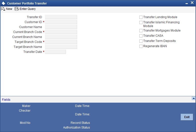

You can transfer mortgages or commitments for all the records with transfer date greater than the current system date from the source branch to a new target branch. This is transferred in the beginning of the day after authorization. ‘Customer Portfolio Transfer’ transfers all the mortgage contracts under the maintained customer ID. You can invoke this screen by typing ‘STDCUSTR’ in the field at the top right corner of the Application tool bar and clicking on the adjoining arrow button.
Specify the following details in the Customer Portfolio Transfer screen:
Transfer ID
System displays the transfer id on clicking ‘New’.
Customer No
Select the customer id from the adjoining option list.
Customer Name
System displays the customer name.
Current Branch Code
System displays the current branch code.
Current Branch Name
System displays the name of the current branch.
Target Branch Code
Specify the Target Branch to which the Customer Portfolio is to be transferred.
Target Branch Name
System displays the name of the target branch of the Customer Portfolio.
Transfer Date
Specify the date on which the Customer Portfolio should be transferred.
Transfer Lending Module
Check Transfer lending Module to specify if Mortgages or commitments should be transferred as part of customer portfolio transfer.
Transfer Islamic Financing Module
Check Transfer Islamic Financing Module to specify if Islamic Mortgages or commitments should be transferred as part of customer portfolio transfer.
Transfer Mortgages Module
Check Transfer Mortgages Module to specify if Mortgage or commitments (MO) should be transferred as part of customer portfolio transfer
Transfer CASA
Check Transfer CASA to specify if Customer Accounts (CASA) should be transferred as part of customer portfolio transfer.
Transfer Term Deposits
Check Transfer Term Deposits to specify if Term Deposits (TD) should be transferred as part of customer portfolio transfer.
Regenerate IBAN
Check this box to regenerate IBAN upon branch transfer. You can check this box only if 'Transfer CASA' is checked.
If you select the ‘Regenerate IBAN’ check box, the system performs the following actions:
If you do not select the ‘Regenerate IBAN’ check box, the system performs the following actions:
Note
By default, system selects all the check boxes. The system displays an error message if at least one of the check boxes is not selected.

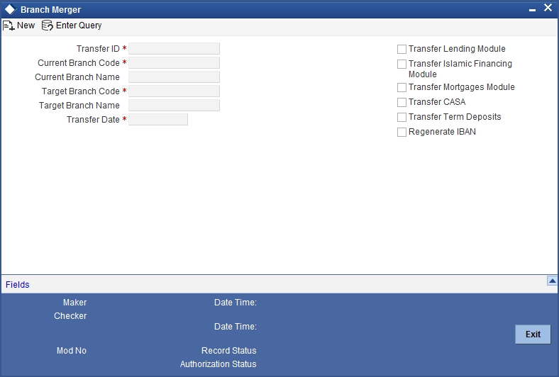

You can transfer Mortgage Mortgages or commitments by merging the branch in the Branch Merger screen. You can transfer Mortgage mortgages or commitments for all the records with transfer date greater the current date from the source branch to a target branch. You can invoke this screen by typing ‘STDBRNTR’ in the field at the top right corner of the Application tool bar and clicking on the adjoining arrow button.
You can specify the following in the branch merger screen:
Transfer Id
System displays Transfer ID on clicking ‘New’.
Current Branch Code
Current Branch Name
Target Branch Code
Specify the Target Branch with which the current branch is to be merged.
Target Branch Name
System displays the name of the target branch.
Transfer Date
Specify the date on which the Branch should be merged with Target branch.
Transfer CASA
Regenerate IBAN
Note
During branch merger and product transfer Holiday Maintenance and UDE Float rates are same for both the branches. If both the branches have different Holiday Maintenance and UDE Float rates, then during subsequent events like VAMI in the mortgage account, for Product transfer accounts and branch merger records, schedule gets recomputed based on the target branch’s holiday or float rates..

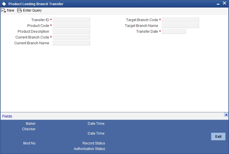

You can transfer mortgage belonging to a product in Product Mortgage Branch transfer screen. You can transfer mortgages or commitments for all the records with transfer date greater the current date from the source branch to a target branch. You can invoke this screen by typing ‘MODPRDTR’ in the field at the top right corner of the Application tool bar and clicking on the adjoining arrow button.
You can specify the following in this screen:
Transfer Id
System displays the transfer ID on clicking ‘New’.
Target Branch Code
Target Branch Name
System displays the name of the target branch of the mortgage.
Product Code
System displays the product code for which the mortgage accounts are transferred.
Product Description
Specify the description of the product for which the mortgage accounts are transferred.
Transfer Date
Specify the date on which the mortgage should be transferred.
Current Branch Code
Current Branch Name
System displays the name of the current branch of the mortgage.
Note
During branch merger and product transfer Holiday Maintenance and UDE Float rates should be same for both the branches. If both the branches has different Holiday Maintenance and UDE Float rates, then during subsequent events like VAMI in the mortgage account, for Product transfer accounts and branch merger records, schedule gets recomputed based on the target branch’s holiday or float rates.

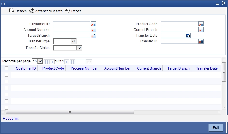

If the single mortgage, customer portfolio, branch merger and product transfers fails, then the status of the transfer is updated as ‘error’ along with the failure reasons. The Mortgage Transfer Log screen allows viewing and re-submitting such failed transfers. You can also view successful transfer records in this screen. You can invoke this screen by typing ‘MOSTRLOG’ in the field at the top right corner of the Application tool bar and clicking on the adjoining arrow button.
You can View or Re-submit failed transfer in this screen.
Account Number
Select the Mortgage Account Number from the adjoining option list.
Source Branch
Select the current branch from the adjoining option list.
Transfer Date
Select the date of transfer for the Mortgage account.
Target Branch
Select the target branch of the mortgage account from the adjoining option list.
Customer No
Select the customer number of the mortgage account from the adjoining option list.
Status
Choose the status of the transfer record from the drop down list. The options available are:
Product Code
Select the product code of the mortgage account from the adjoining option list.
The following are displayed in this screen:
Resubmit
Clicking on the resubmit button marks all checked failed records for retry during the BOD batch.
View Error Details
Select a record to view the reason for failure of contracts in MODTRLOG screen, which failed to transfer.
