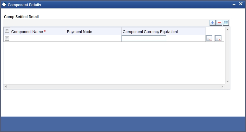

Each settlement is apportioned against a component due based on the Liquidation order. The order in which the settlements are picked is ordinal as entered in the screen. Click ‘Set Component’ button to view/change the component settlement details in the ‘Component Details’ screen.
For more details on the ‘Component Details’ screen refer section titled ‘Viewing Component Settlement Details’ in this chapter.

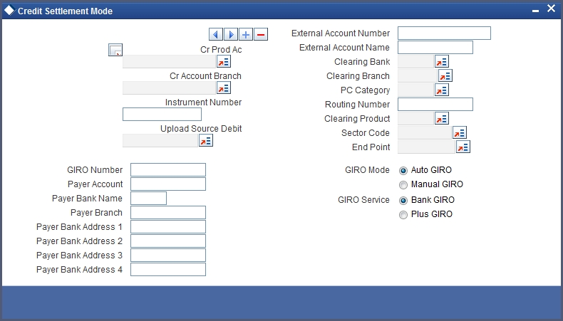

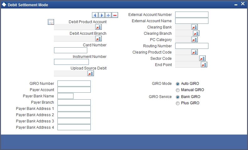

Depending upon the mode of payment the following settlement details are captured:
For ‘CASA’:
For ‘Credit Card’ and ‘Debit Card’
For ‘Clearing’
For ‘External Account’
For ‘Electronic Pay Order’
For ‘Internal Check’
For ‘Instrument’
For ‘Cash/Teller’

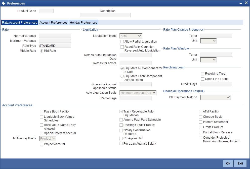

Partial payment is required to parameterize partial liquidation during auto liquidation process.
In the ‘Mortgage Product Preferences’ screen you can indicate whether partial liquidation is allowed during auto liquidation of the mortgage or not. This preference set at the product level gets defaulted at the account creation level also. But this option is allowed only if ‘Verify Funds’ option is selected. Auto Liquidation will check this option before carrying out partial liquidation viz. before liquidating to the extent of availability during Verify Funds check.
If selected, the function proceeds with liquidation, else it is marked as unpaid.
Refer the section titled ‘Specifying Product Preferences’ in the ‘Defining Product Categories and Products’ chapter of this User Manual for more details.

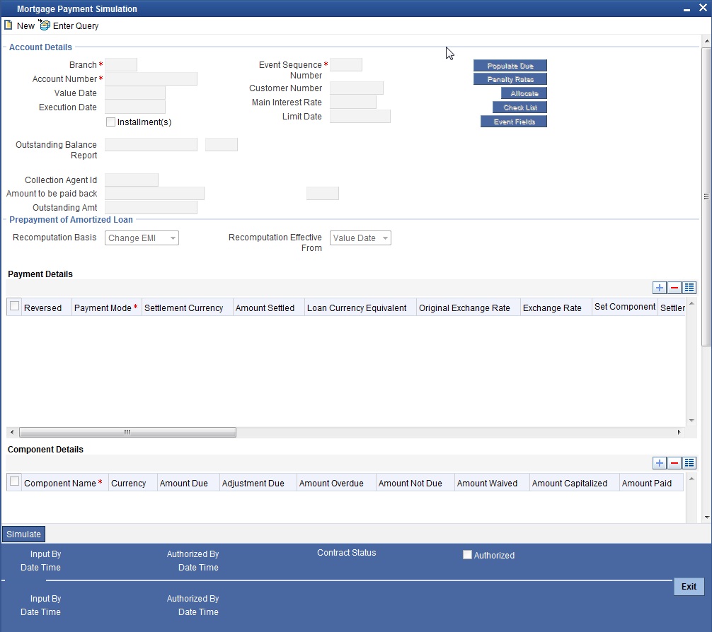

Mortgage payment simulation calculation function is used to arrive at an agreement with the client. The ‘Payment Simulation’ screen displays the effect of making payments across components across schedules. You can invoke this screen by typing ‘MODSIMPT’ in the field at the top right corner of the Application tool bar and clicking on the adjoining arrow button. The results are used to arrive at a negotiated amount that can be used to settle outstanding loss.
For more details on the field explanation refer section ‘Mortgage Payment’ in this chapter.
You can change specific UDE values to simulate the effect of changing prepayment penalty rates.
Payments can be saved from the simulator. Once the payment simulation is saved, if you enter simulation account number in the payments screen and click on the ‘Populate Due’ button then the system displays all the details entered in the payment simulation screen.
Note
Only users with rights to input payments are allowed to save payments from the simulator.
Click ‘Simulate’ button to view the account details after the current payment. An account screen is launched to view the updated account after the payment. You can also print an advice from the simulation screen.

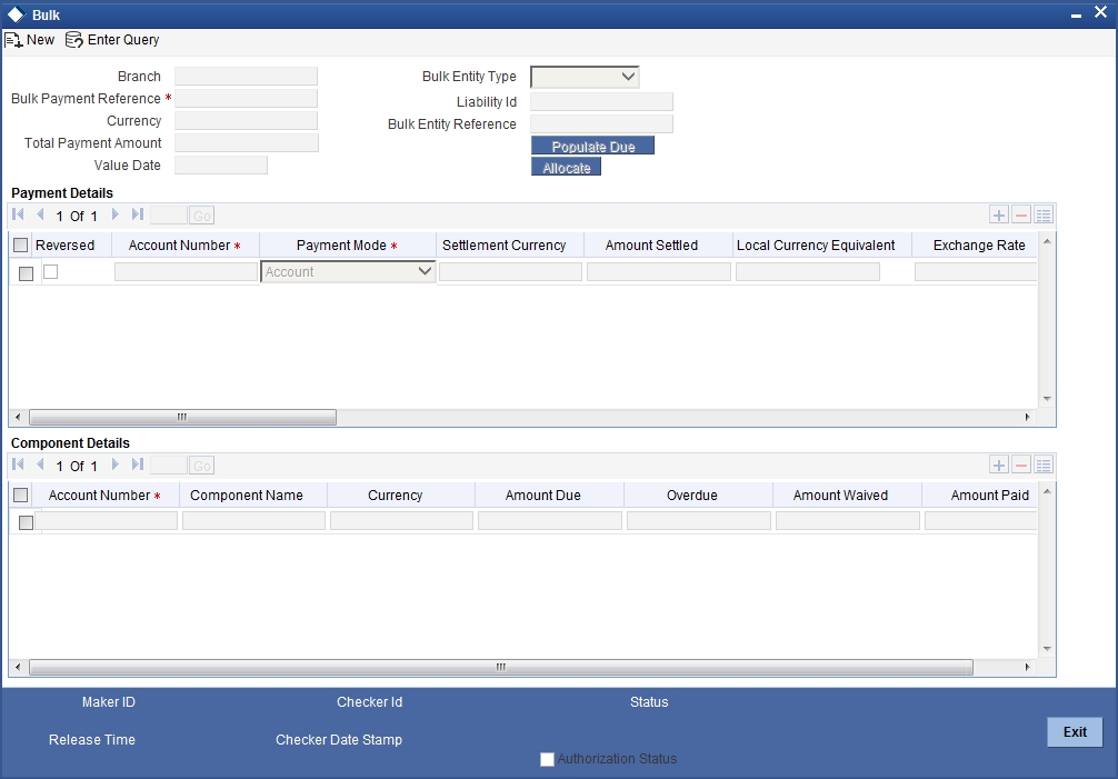

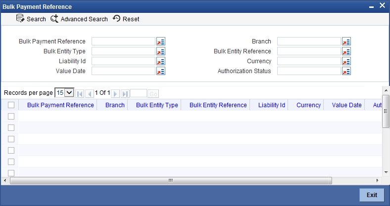

The ‘Bulk Payments’ screen is provided to create bulk payments against a limit or commitment for a mortgage account. The mortgage/commitment linked to the mortgage account for which the prioritization rules are maintained, is considered for bulk payment.
Bulk payment is done for the mortgage accounts linked to an L/C for which the bulk payment option is checked. The bulk payment is always done for the current branch. The Bulk payment is done only for the CL accounts belonging to the current branch from where bulk payments are made. Bulk payment amount is allocated to the accounts linked to a mortgage/commitment account. This allocation is done based on the Prioritization rules maintained for the L/C selected. If a specific rule is not available for L/C reference for the branch, the ALL option is considered. The payment is triggered based on the amount allocated per the prioritization rules.
To make the bulk payments for the accounts associated under an L/C allocated, invoke the ‘Bulk Payments’ screen by typing ‘CLDBLKPT’ in the field at the top right corner of the Application tool bar and clicking the adjoining arrow button.
The following details are specified for making the bulk payments under a mortgage/commitment account:
Branch Code
This displays a valid branch code for making bulk payments. All the accounts associated to a mortgage/commitment are marked for bulk payments in this branch.
Bulk Payment Reference
Specify the bulk payment reference number for the particular bulk payment made.
Total Payment Amount
Specify the total payment amount available to be allocated across the due components/accounts under a mortgage/commitment.
Currency
Specify a valid currency to be maintained as part of the bulk payment made. The adjoining option list displays all the valid currency maintained in the system. You can choose the appropriate one.
Limit Date
Specify the date the limit line is attached to the mortgage/commitment.
Bulk Entity Type
Select the Bulk Entity type from the adjoining drop-down list. This list displays the following values:
Specify the type of entity for which bulk payments are made. If the bulk entity type is chosen as limit line, you can then choose the credit line against which the payment needs to be made in the field Bulk Entity. The liability ID linked to this limit is defaulted. Only valid limit lines linked to the mortgage accounts in the current branch are displayed in the option list.
For the bulk entity type ‘Commitment’ the Commitment reference number is chosen from the option list for the “Bulk Entity”. The customer id of the commitment is populated as the liability ID, and the commitment branch is populated as the branch code. The bulk entity option list displays only the commitments defined under the current branch.
Liability ID
The liability ID is defaulted based on the limit type selected as bulk entity. The customer ID of a commitment is populated when the bulk entity type is selected as commitment.
Bulk Entity
Specify the bulk entity. If you have chosen the ‘Bulk Entity Type‘ as ‘Commitment’ the customer id of the commitment is populated as the liability ID.
After specifying the Bulk Entity details and limit date, click the ‘Populate Due’ button. Payment Details and Component Details options are enabled to list all active mortgage accounts (linked to the L/C selected) and the component wise amount due respectively.
After providing the bulk payment amount, click ‘Allocate’ button to display the payment details and component wise details with all the applicable accounts including the total amount due and total amount allocated against each as per the bulk payment preference maintenance.
Specify the following details:
Reversed
You can reverse a payment done for single account involved in bulk payment. Check this box to indicate that this payment should be reversed.
An override message gets displayed.
Account Number
Specify the account number.
Payment Mode
Select the payment mode from the drop-down list. This list displays the following values:
Settlement Currency
Specify a valid settlement currency in which payment is to be made. This adjoining options list contains all the valid settlement currencies maintained in the system. You can choose the appropriate one.
Amount Settled
Specify the amount settled.
Mortgage Currency Equivalent
Specify the mortgage currency equivalent.
Exchange Rate
Specify the exchange rate.
Check list
This contains a check list screen for the bulk payment made. You need to specify the description or any remarks if any.
Checked
Check this box to indicate if the check list details are to be maintained for the bulk payment made
Description
Specify a description of the check list item, which the bulk payment is checked against.
Remark 1
Specify remarks for the check list, if any.
Remark 2
Remark 3
Remark 4
Remark 5
Remark 6
Remark 7
Remark 8
Remark 9
Remark 10
Settlement Branch
Specify a valid settlement branch. The adjoining option list displays all the valid settlement branch maintained in the system. You can choose the appropriate one.
Settlement Account
Specify a valid settlement account. The adjoining option list displays all the valid settlement account maintained in the system. You can choose the appropriate one.
Settlement Product
Specify the settlement product.
Instrument Number
Specify the instrument number.
End Point
Specify a valid end point. This adjoining option list displays all the valid end point maintained in the system. You can choose appropriate one.
Card Number
Specify the card number
External Account Number
Specify the external account number.
External Account Name
Specify the external account name.
Clearing Bank
Specify a valid clearing bank. This adjoining option list displays all the valid clearing bank maintained in the system. You can choose the appropriate one.
Clearing Branch
Specify the clearing branch.
Upload Source
Specify a valid upload source. This adjoining option list displays all the upload source maintained in the system. You can choose the appropriate one.
Sector Code
Specify a valid sector code. This adjoining option list displays all the valid sector code maintained in the system. You can choose the appropriate one.
Routing Number
Specify the routing number.
Settlement Reference Number
Specify the settlement reference number.
Account Number
Component Name
Specify the name of the component.
Component Currency
Specify the component currency.
Amount Due
Specify the amount to be paid.
Amount Paid (Component Currency)
Specify the amount that is paid.
Amount Overdue
Specify the overdue amount.
Amount Waived
Specify the amount that is waived.
You can perform the following operations in this screen:

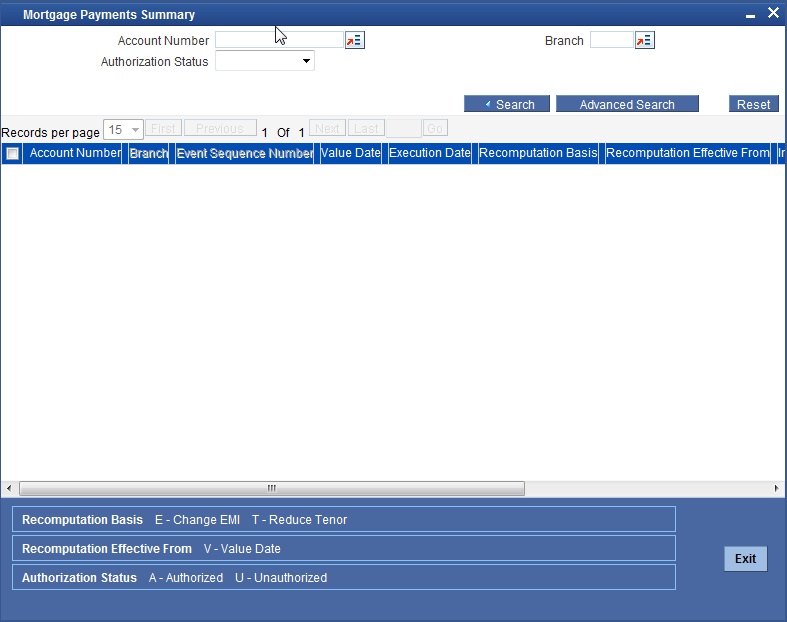

You can view a summary of all Mortgage Payments, through the ‘Mortgage Payments Summary’ screen. You can invoke this screen by typing ‘MOSPMNT’ in the field at the top right corner of the Application tool bar and clicking the adjoining arrow button.
You can query based on all or any of the following criteria:
Click ‘Search’ button. The system identifies all records satisfying the specified criteria and displays the following details for each one of them:

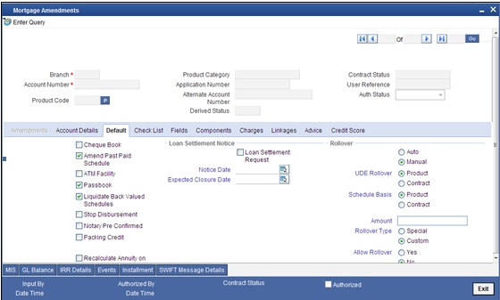

Once a Mortgage is entered and authorized, financial changes to the Mortgages can be done through the ‘Value Dated Amendments’ screen. These amendments are based on an effective date and hence are called Value Dated Amendments (VAM). You can invoke this screen by typing ‘MODSIMVD’ in the field at the top right corner of the Application tool bar and clicking on the adjoining arrow button.
Booking an amendment is called VAMB and Initiating is called VAMI. These are considered as events in the life cycle of the Mortgage.
Value Dated Amendments supports the following functions:
If there no change in the EMI or the tenor, then the ‘Balloon Payment’ option should be chosen.
If these changes are required to be effective on a particular date, not maintained previously, a fresh set of rates for that day is required to be maintained.
You can pick any active account from the Value Dated Amendments screen and apply the amendments for that account. You can also view or modify the amendments that are not yet applied for that account.
If the amendments result in a status change for the account, the system will update the current status for the account in the ‘Derived Status’ field. During end-of-day batch processing, it will update the ‘User Defined Status’ for the account with the worst status available for all accounts and mortgages for this CIF and post the required accounting entries for the change.
Lead ID
Select the lead ID from the adjoining option list if the principal increase is done to process an associated top up lead. The system displays all the lead IDs in which the ‘Top up Lead’ option is checked in the prospect details screen (ORLEADM).
For more details on the field explanation refer section ‘Creating a Mortgage Account’ in ‘Account Creation’ chapter of this User Manual.
The following detail is displayed here:
Effective Date
The effective date of the various amendments done to the Mortgage account is displayed here.
In order to view or modify existing amendments, query for the required account number.
Select the corresponding effective dates of the amendment and click the ‘View/Modify’ button. The Account Details tab is displayed where you can view/modify the existing amendments.
Specify the account number for which the amendment needs to be done and then ‘Unlock’ the record. In the New Amendment frame specify the Effective Date. Click the ‘Create New Amendment’ button in order to make new amendments to mortgages. The Account Details tab is displayed where you can create the new amendment.
From this screen, you can modify the amount financed, which specifies the increase in amount, Rate or Principal effective a value date, and also the maturity date. On saving the transaction after entering all the required details in the system, the system validates the value of the transaction amount against the following:
If the transaction currency and the limit currency are different, then the system converts the amount financed to limit currency and checks if the same is in excess of the product transaction limit and user input limit. If this holds true, the system indicates the same with below override/error messages:
Once you specify the amendments, the relative changes with regard to the same can be viewed in the other tabs of the Screen.
You can also select the re-computation basis for amendments from this screen. For example, if the re-computation basis is Change Installment, the amendments are applied by changing the Equated Monthly Installments keeping the tenor constant. If re-computation basis is Change Tenor, then the tenor is varied by keeping Installment constant.
Following are the amendments to the Value date effective mortgages accounts that you can perform through this screen:

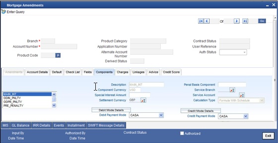

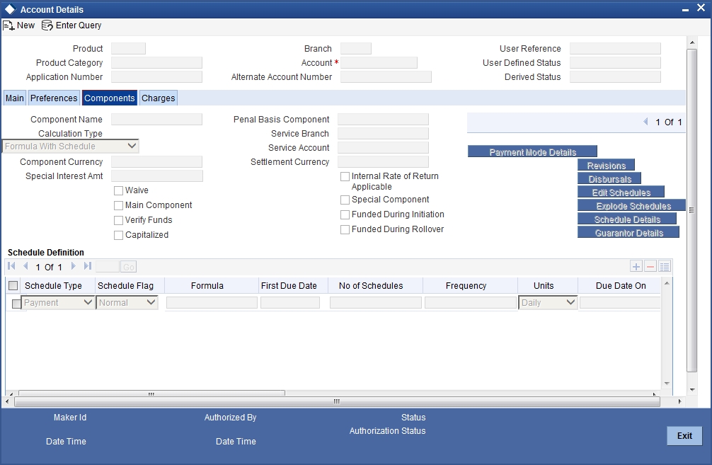

Components maintained for the account are displayed here.
In this tab you can modify the schedule preferences of your account. Select the components that you wish to modify from the list provided. You can amend the details of the selected component, after you click the ‘Edit’ button. The schedules are defaulted from Product maintenances at the time of account opening.
While making modification to schedule, follow the steps given below:
Click ‘Explode’ button once you finalize your changes on the schedule. System calculates the missing parameters based on Product preferences.
Note
You can modify future dated schedules only.

You can view and amend the payment mode details during value dated amendment of mortgage accounts. Click ‘Payment Mode Details’ button from the Components tab.
You can modify the credit settlement mode details as given below:
You can modify the following credit settlement mode details:
Exchange Rate
You can modify the exchange rate. For a customer availing any Relationship Pricing scheme, the customer specific exchange rate derived by adding the original exchange rate and the customer spread maintained for the relationship pricing scheme gets displayed here.
If Relationship Pricing is not applicable, Exchange Rate will be the same as the Original Exchange Rate.
Negotiated Cost Rate
You can modify the negotiated cost rate that should be used for foreign currency transactions between the treasury and the branch. You need to specify the rate only when the currencies involved in the transaction are different. Otherwise, it will be a normal transaction.
The system will display an override message if the negotiated rate is not within the exchange rate variance maintained at the product.
Negotiated Reference No
You can modify the reference number that should be used for negotiation of cost rate, in foreign currency transaction. If you have specified the negotiated cost rate, then you need to specify the negotiated reference number also.
You can view and modify the debit settlement mode details as given below:
You can modify the following debit settlement mode details:
For further details on these fields, refer to the details given above on credit settlement mode amendment.

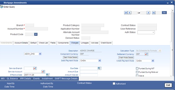

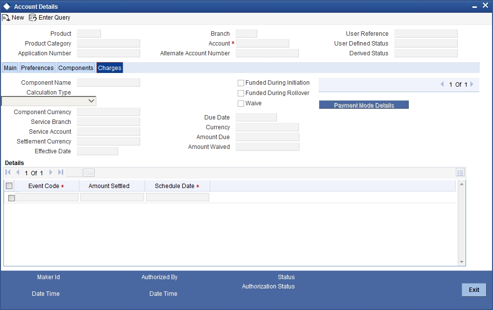

In order to calculate the charges that we would like to levy on an account, we have to specify the basis on which we would like to apply charges.
The Charges tab is displayed where you can view/modify the charges to be levied on the account.
You can capture the following details in this screen:
Amt. Waived:
The amount displayed here is the amount that needs to be waived as the discount offered to the customer.
For more details and the field explanation of each tab, refer to the section ‘Creating a Mortgage Account’ in ‘Account Creation’ chapter of this User Manual.

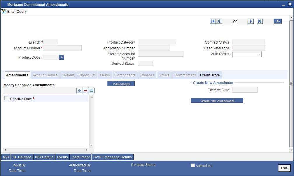

Once a Commitment is entered and authorized, changes to the Commitment account can be done through the ‘Commitment Amendments’ screen. These amendments are based on an effective date and hence are called Value Dated Amendments (VAM). You can invoke this screen by typing ‘MODCOMVD’ in the field at the top right corner of the Application tool bar and clicking on the adjoining arrow button.
On saving the amended transaction, the amount financed is validated against the product transaction limit and the user input limit maintained in the system. The system displays an appropriate override/error message if the amount exceeds the allowed input limit. It also indicates the level of authorisation required if the amount financed is in excess of the transaction limit maintained.
The system converts the amount financed using the standard mid rate to the transaction limit currency and check against the transaction limit amount maintained for the product if the transaction currency is different from the transaction limit currency.
The system updates this amended commitment as an unauthorised transaction. To authorize an account, click ‘Authorize’ icon on the Application toolbar.
Note
You cannot authorise a transaction from the ‘Mortagage Commitment Amendments’ in the following cases:
For more details on the field explanation of each tab refer section ‘Creating a Commitment Account’ in the ‘Account Creation’ chapter of this User Manual.

Value Dated Amendment simulation calculation function is used to get the details of the VAMI charge before applying the same. You can invoke this screen by typing ‘MODSIMVD’ in the field at the top right corner of the Application tool bar and clicking on the adjoining arrow button.
The Value Dated Amendment Simulation screen is similar to ‘Amendments’ screen.
For more details on the field explanation refer section ‘Creating a Mortgage Account’ in ‘Account Creation’ chapter of this User Manual. Also refer ‘Mortgage Amendments’ section in this chapter.

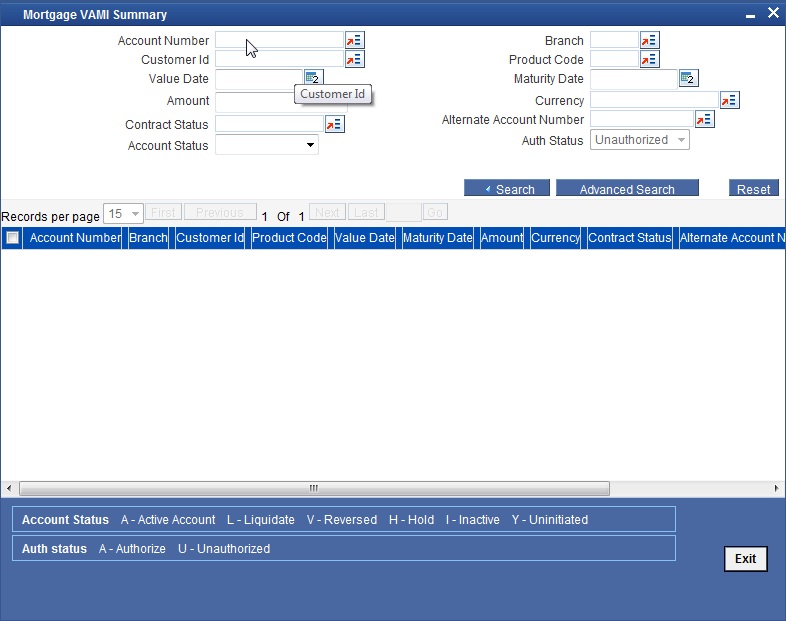

You can view a summary of all Mortgage VAMIs, through the ‘Mortgage VAMI Summary’ screen. You can invoke this screen by typing ‘MOSVDAMD’ in the field at the top right corner of the Application tool bar and clicking the adjoining arrow button.

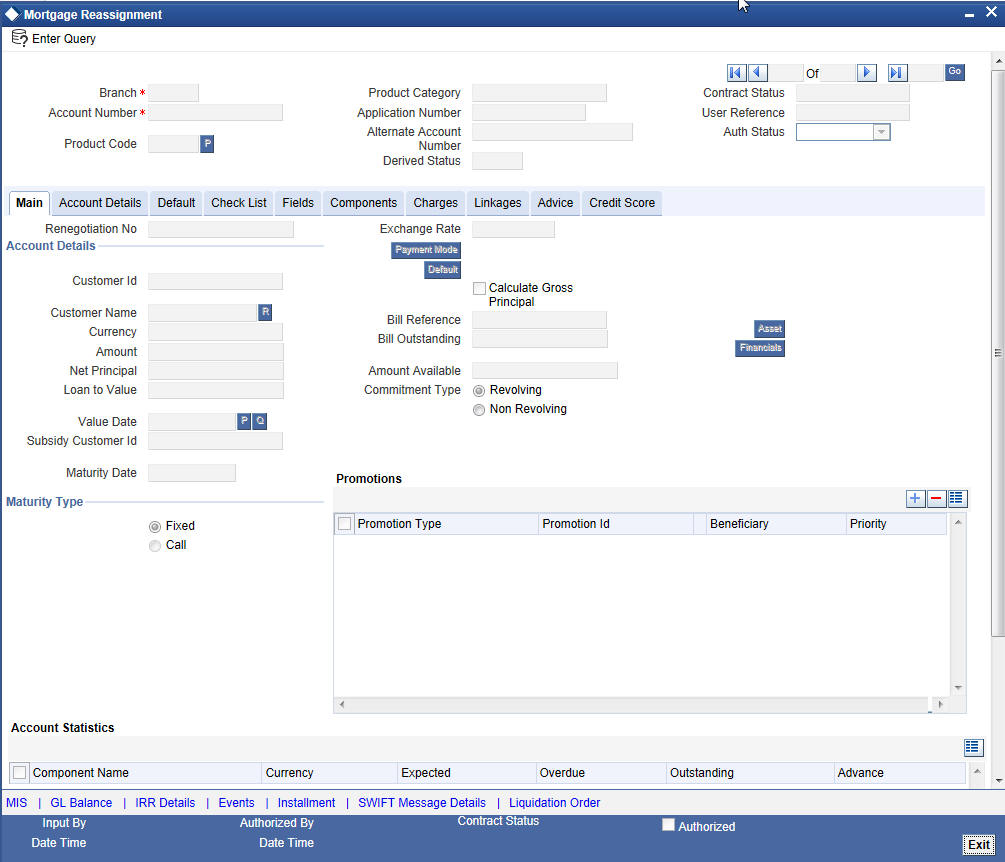

Oracle FLEXCUBE allows you to change the main debtor of a mortgage through the process of reassignment. You can achieve this through the ‘Reassignment’ screen. This screen is similar to the ‘Account Details’ screen. To invoke the screen, type ‘MODNOVDT’ in the field at the top right corner of the Application tool bar and click the adjoining arrow button.
In this screen, you need to clear all details by pressing F7. Then you can specify the account number and click on F8. The system displays all the account details of the chosen account. You can change the Customer Id of the primary applicant in the ‘Reassignment – Account Details’ screen.
Customer ID (Primary Applicant)
The CIF ID of the primary debtor of the mortgage account is displayed here. You can change it by selecting another CIF ID from the option list. This in effect means the debtor will be changed.
Customer ID (Other Applicants)
The CIF IDs of the co-applicants for the original mortgage are displayed here. You can change them by selecting other CIF IDs from the option list.
In the ‘Reassignment – Linkages’ screen, you can change the following details:
All these details get displayed in the corresponding fields. You can modify the same.
During Value Dated amendments, you can also change the following data:
However, you cannot change the Mortgage Account Number.
As a result of reassignment, limit utilizations against the old customer will be reduced and those towards the new customer will be increased by altering the utilizations.

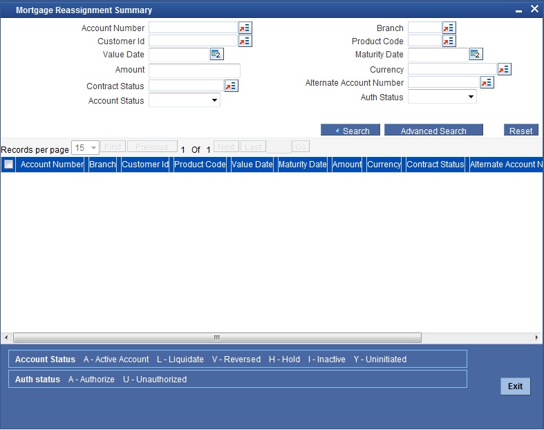

You can view a summary of all Mortgage Reassignments, through the ‘Mortgage Reassignment Summary’ screen. You can invoke this screen by typing ‘MOSNOVDT’ in the field at the top right corner of the Application tool bar and clicking the adjoining arrow button.

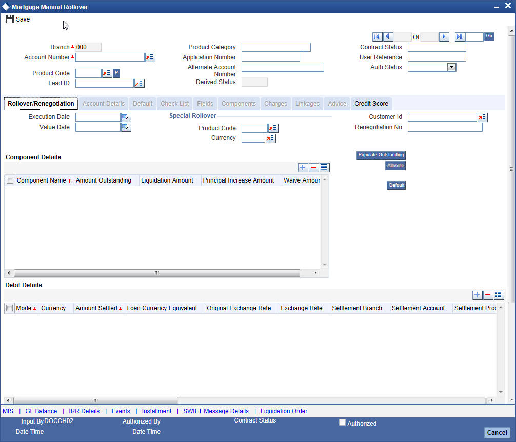

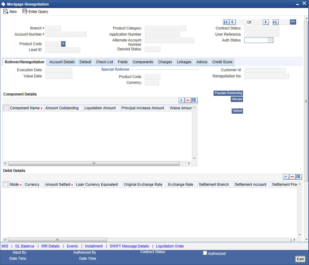

The customer can ask for re-negotiation of the written-off mortgage. Or when an account becomes delinquent, the bank may negotiate with the customer. Negotiation may result in any of the following:
In Oracle FLEXCUBE, renegotiation is treated as a separate manual operation. Whenever a mortgage is renegotiated, it results in the creation of a new version of the existing mortgage. The system then recalculates the schedules. If the customer makes any payment towards the written-off mortgage, they are also considered.
Once the mortgage gets transformed into a new mortgage, it is affected by maintaining Bridge GLs.
Renegotiation can result in just varying interest rates or maturity dates of the original mortgage along with capitalization of the outstanding interest.
You can perform mortgage renegotiation through the ‘Re-Negotiation’ screen. To invoke the screen, type ‘MODRENOG’ in the field at the top right corner of the Application tool bar and click the adjoining arrow button.
This screen is similar to the one used for manual rollover.
Lead ID
Renegotiation No
The system displays the number of renegotiations which have been already performed for the mortgage.
The system will validate for the maximum limit of renegotiation as follows, before saving the renegotiation:

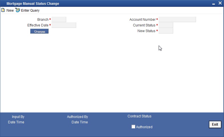

The status change can also be triggered manually. The status change can also be done with a value date which can even be in the past.
You can invoke the ‘Mortgage Manual Status Change’ screen by typing ‘MODMSTCH’ in the field at the top right corner of the Application tool bar and clicking on the adjoining arrow button.
The following details are captured here:
Branch Code
Enter the branch code of the account for which the status will be manually changed in this field.
Account Number
Select the account number of the account which needs a status change in this field by clicking the adjoining option list. A list of values is displayed. Double click on a value to select it.
Current Status
The system displays the current status of the Account in this field.
New Status
Select the new status of the account by clicking the adjoining option list. A list of values appears. Double click on a value to select it.
The valid values are active, dormant, closed and so on.
This is a mandatory input.
Effective Date
Enter the date of the new status for the account comes into effect in this field. This is a mandatory input.
Note
When a change in status is done manually for an account, the system will post the required accounting entries for the change immediately.

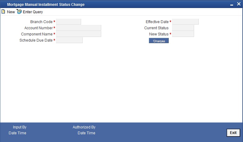

You can manually change the status of mortgage installments using ‘Mortgage Manual Installment Status Change’ screen. To invoke the screen, type ‘MODISTCH’ in the field at the top right corner of the Application tool bar and click the adjoining arrow button.
You can capture the following details on this screen:
Branch Code
The system displays the branch code to which you have logged in. You cannot modify this.
Account Number
Specify the mortgage account number which requires installment status change. The option list displays all valid account numbers applicable. Choose the appropriate one.
Component Name
Schedule Due Date
Specify the due date of the current schedule. Click the adjoining option list to choose one.
Effective Date
The system displays the effective date of the new status. However, you can modify this. Click the adjoining date button to choose the effective date from the calendar.
Current Status
The system displays the current installment status.
New Status
Specify the new installment status. The option list displays all valid statuses applicable. Choose the appropriate one.
Once you have captured the details, click ‘Change’ button. The system updates the status of the installment for the selected account.

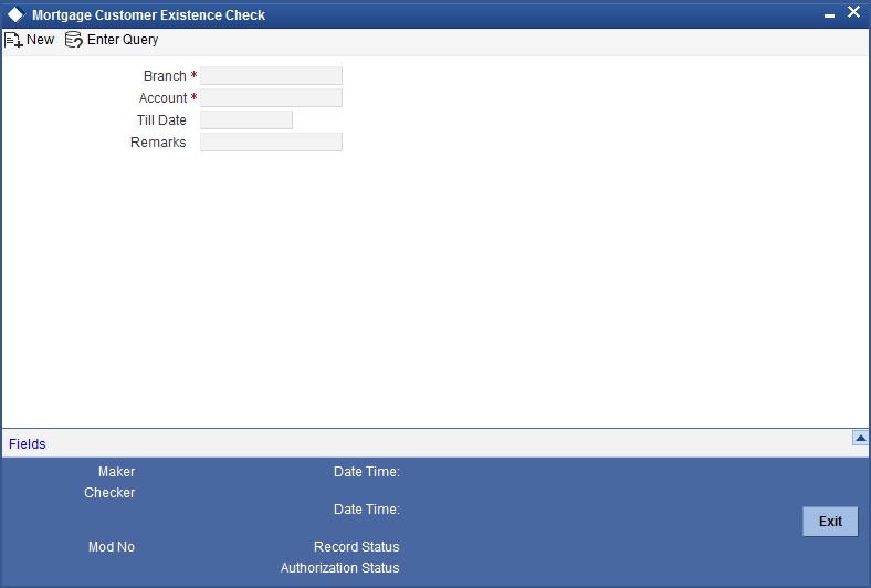

On authorizing a ‘Reverse Mortgage Loan’ creation, the details of the authorized contract will be displayed in the ‘Customer Existence Check’ screen. For an authorized contract, the Till Date will be same as the value date of the reverse mortgage loan. You can check the customer existence details of a mortgage in the ‘Mortgage Customer Existence Check’ screen. In this screen, you can verify whether the customer is alive or not before the disbursement. You can invoke this screen by typing ‘MODCUSCH’ in the field at the top right corner of the Application tool bar and clicking the adjoining arrow button.
You can specify the following details:
Branch Code
Specify the branch code of the bank.
Account
Specify the account for which the customer existence check has to be done.
Till Date
Specify the date till the disbursement should be allowed. Till date should be greater than the disbursement date.
Note
Last n annuities are not disbursed in a given reverse mortgage loan contract if the 'Stop Disbursement' option is checked or 'Till Date' is not updated due to lack of information or proof. And, if the ‘Stop Disbursement’ option is unchecked in Value dated amendment or 'Till Date' is changed to some future date, then the system will disburse all n annuities in the EOD or BOD.
Remarks
Specify the remarks about the customer verification.

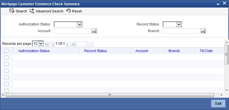

You can view a summary of all Mortgage Customer Existence Check Summary, through the ‘Mortgage Customer Existence Check Summary’ screen. You can invoke this screen by typing ‘MOSCUSCH’ in the field at the top right corner of the Application tool bar and clicking the adjoining arrow button.

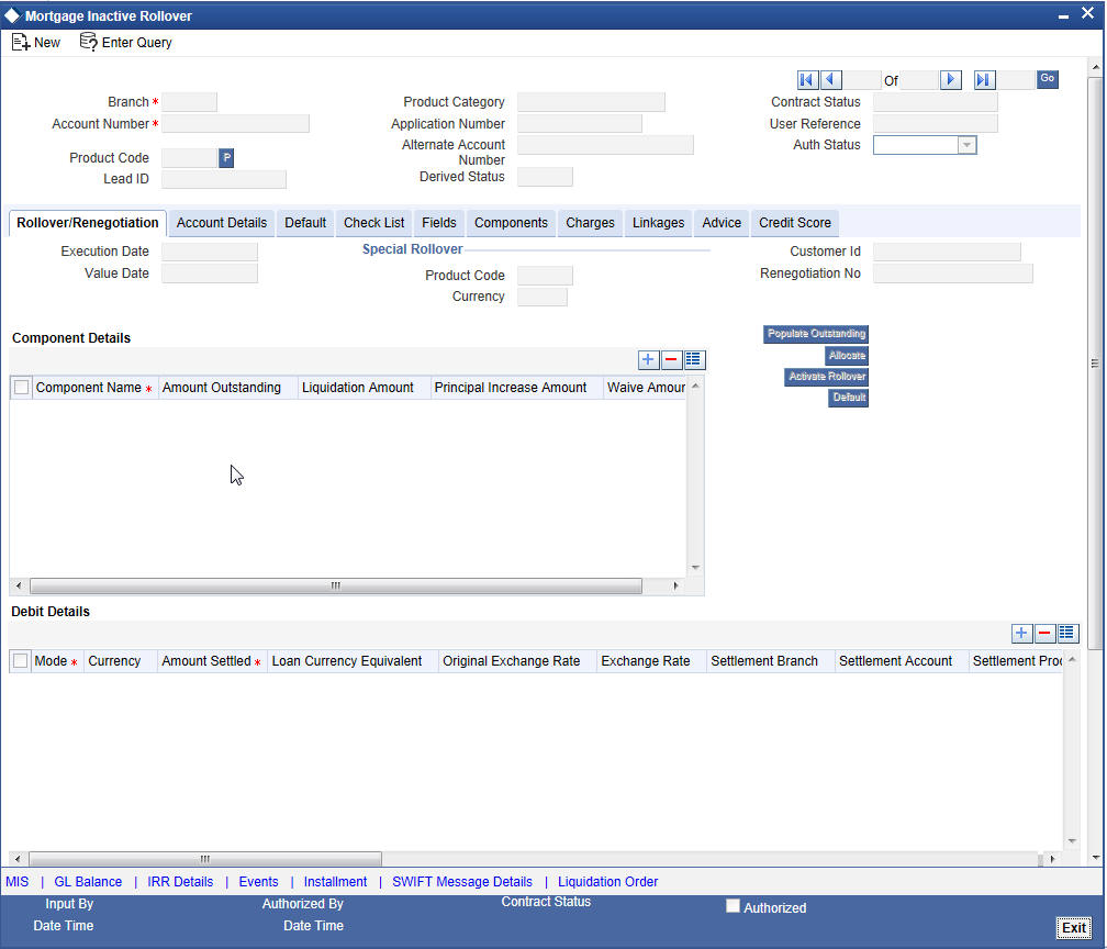

The rollover preferences and rollover type for a mortgage account are specified at the time of setting up a product. In the product screen, you have the option to rollover the account manually or instruct the system to do an automatic rollover. You can also specify the type of rollover; the options available are custom and special. When a mortgage is rolled over, a schedule is defaulted depending upon the UDE type and the schedule basis specified in the product screen.
Refer to the Products Chapter for more details on rollover specifications for mortgage accounts.
The rollover preferences specified at the product level are defaulted in the accounts screen at the time of mortgage account creation.
Refer to the Account Creation chapter for more details on rollover specifications for mortgage accounts.
CL module has a special operations screen to support manual Rollover of accounts. This screen provides facility to pay off dues on the mortgage and also options to rollover the unpaid amounts for a new tenor with new mortgage terms.
If the Rollover is a simple maturity extension with or without components (Outstanding Principal, Interest etc) capitalized, then the ROLL event is fired. However, if the Rollover is a result of Renegotiation and Restructuring of the mortgage then the respective events are fired.
Special Rollovers involve a change in the Mortgage currency, reassignment of the Mortgage customer, creation of a new mortgage with same reference number as the original mortgage and waiver of outstanding mortgage. These are supported by events that fire the respective accounting entries.
The special Rollover Event is SROL and Renegotiation of a mortgage is RNOG. The event entries to be maintained are displayed in the product defaulting.
You can invoke the ‘Manual Rollover’ screen by typing ‘MODMROLL’ in the field at the top right corner of the Application tool bar and clicking on the adjoining arrow button.
Query for the account number that needs to be rolled over and then click New icon in the toolbar. Select the lead ID from the adjoining option list if the principal increase is done to process an associated top up lead. The system displays all the lead IDs in which the ‘Top up Lead’ option is checked in the prospect details screen (ORLEADM).Then, click on the ‘Populate Outstanding’ button. The system will display the outstanding against each component for the account. You can then specify the rollover details such as ‘Liquidation Amount’, ‘Settlement Details’ etc. Then, click ‘Allocate’ button to actually allocate the settlements against the components involved.
You can specify the following details in the Manual Rollover screen:
Exec Date
Select the transaction date of the rollover in this field.
Value Date
Select the value date of the rollover in this field.
Product code
Select the new product of the account due to Special Rollover, from the adjoining option list. Double click on a value to select it.
Currency
Select the new currency of the account due to Special Rollover from the adjoining option list. Double click on a value to select it.
Customer ID
Select the customer Id from the list of values provided. Double click on a value to select it.
Renegotiation No
The system displays the renegotiation count. This is the number of renegotiations that are already performed on the account.
Component Name
The system displays the name of the component that is being rolled over / paid in this field.
Amount Outstanding
The system displays the outstanding portion of the component in this field.
Liquidation Amount
Enter the amount that is paid as part of the Rollover in this field.
Principal Increase Amount
Enter the amount that is rolled over for the component in this field.
Waive Amount
Enter the amount that is waived for the component as part of the rollover in this field.
Mode
Select the mode in which the settlement should be done from the adjoining drop-down list. The list displays the following values:
Settlement Mode Ccy
Select the currency in which a particular settlement is to be made from the adjoining option list. Double click on a value to select it.
The options include list of currencies allowed for the product, branch and category.
Amount Settled
Enter the amount to be disbursed in this mode as a part of the disbursement.
Note
The amount should be less than the difference between Disbursement amount and the amount settled through other modes. The amount should be in terms of the mode currency.
Mortgage Ccy Equiv
The system displays the amount in terms of the mortgage currency in this field.
The base or actual exchange rate between the account currency and settlement currency gets displayed here.
Exchange Rate
You can change the defaulted rate provided the change is within the variance level maintained for the underlying product.
For more details on customer specific exchange rates, refer the section titled ‘Specifying Pricing Benefit Details’ in Relationship Pricing user manual.
For Dr Settlement, the following details can be captured depending on the settlement mode:
For ‘CASA’
For ‘Clearing’
For ‘Instrument’
For ‘Cash/Teller’
For Cr Settlement, the following details can be captured depending on the settlement mode:
For ‘CASA’
For ‘Clearing’
For ‘Instrument’
For ‘Cash/Teller’
Specify the negotiated cost rate that should be used for foreign currency transactions between the treasury and the branch. You need to specify the rate only when the currencies involved in the transaction are different. Otherwise, it will be a normal transaction.
Negotiated Reference Number
Specify the reference number that should be used for negotiation of cost rate, in foreign currency transaction. If you have specified the negotiated cost rate, then you need to specify the negotiated reference number also.
Note
Oracle FLEXCUBE books the online revaluation entries based on the difference in exchange rate between the negotiated cost rate and transaction rate.

The same field is available on the Account screen and the values are defaulted from product. The defaulted values can be amended.
During rollover of an auto-disbursed mortgage, swift message is sent if the Principal increase through credit settlement happens. If the credit settlement mode is chosen as CASA, the settlement account, currency and branch along with the Swift message details are defaulted from the account.
In case you change the customer, currency or the product during rollover, system picks up the settlement details again from Settlement Instruction maintenance corresponding to the new parameters. The swift message, if applicable, is generated during authorization similar to manual disbursement.
This function is provided to save Inactive rollover instructions. Click on the ‘Activate’ button on the Inactive Rollover screen to activate the inactive rollover instructions.
When an Inactive instruction is saved, no events are processed. And when activated, all the applicable events are fired.
This screen captures payment details such as Value date of the payment, Amount Settled, Payment Mode, Related Payment Products and Settlement Account. The payment is against any of the mortgage components such as principal, interest etc.
You can invoke this screen by typing ‘MODIMROL’ in the field at the top right corner of the Application tool bar and clicking on the adjoining arrow button.
The procedure to create an Inactive Rollover is similar to the Manual Rollover process. However, you have the additional facility to activate the rollover by clicking on the ‘Activate Rollover’ button.
The ‘Inactive Rollover’ screen is identical to the ‘Manual Rollover’ screen.
For more details on the field explanations refer section ‘Capturing Manual Rollover Details ‘in this chapter.

You can specify the preferences details in the ‘Preference’ tab in the ‘Equated Monthly Installment’ screen.
Here you can specify the following details:
Cheque Book Facility
Check this box to indicate that the cheque book facility should be allowed to loan account.
Passbook Facility
Check this box to indicate that the pass book facility should be allowed to loan account.
ATM/Debit Card
Check this box to indicate that the ATM/Debit card should be provided to the account holder.
Liquidate Back Valued Schedules
Check this box to indicate that the back valued schedules should be liquidated.
Allow Bulk Payment
Check this box to indicate that the bulk payment should be allowed.
Amend Past Paid Schedules
Check this box to indicate that the past paid schedules should be amended.
Stop Disbursement
Check this box to indicate that the disbursement should be stopped.
Recalc Annuity On Disbursement
Check this box to indicate that the annuity on disbursement should be recalculated.
Use Guarantor for Repayment
Check this box to indicate that the repayment should be done by the guarantor.
Loan Statement Required
Check this box to indicate that the loan statement should be generated.
You can specify the liquidation details in the following fields:
Auto Liquidation
Check this box to indicate that the liquidation should be automated.
Reset Retry Count For Reversed Auto Liquidation
Check this box to indicate that the retry count for reversed auto liquidation should be reset.
Partial Liquidation
Check this box to indicate that the partial liquidation should be allowed.
Retries Auto Liquidation Days
Check this box to indicate that the auto liquidation days should be retried.
You can specify the intermediate details in the following fields:
Intermediary Initiated
Check this box to indicate that the intermediary should be initiated.
Intermediary Code
Specify the unique code of intermediary. The adjoining option list displays all valid codes maintained in the system. You can choose the appropriate one.
You can specify the track receivable details in the following fields:
Auto Liquidation
Manual Liquidation
Check this box to indicate that the liquidation should be done manually.
You can specify the bill details in the following fields:
Bill Reference Number
Specify the reference number of the bill. The adjoining option list displays all valid reference numbers maintained in the system. You can choose the appropriate one.
Bill Due Amount
Specify the due amount of the bill.
Amount Available
Specify the available amount.
You can specify the holiday periods detail in the following field:
Period
Specify the period of the holiday. The adjoining option list displays all valid periods maintained in the system. You can choose the appropriate one.
You can specify the UDE rate plan details in the following fields:
Start Date
Select the start date from the adjoining calendar.
End Date
Select the end date from the adjoining calendar.
You can specify the component details in the ‘Components’ tab in the Equated Monthly Installment’ screen.
Component Name
Calculation Type
The system displays the calculation type based on the component maintenance at the product level.
Component Currency
Specify the currency in which the component should be maintained.
Special Interest Amt
Specify the special interest amount for the component.
Waive
Check this box to indicate that the interest amount should be waived.
Main Component
Check this box to indicate that the specified component should be main component.
Verify Fund
Check this box to indicate that the fund should be verified.
Capitalized
Check this box to indicate that the component should be capitalized.
Penal Basis Component
Specify the penal basis component.
Service Branch
Specify the service branch of the component. The adjoining option list displays all valid service branches maintained in the system. You can choose the appropriate one.
Service Account
Specify the service account for the component. The adjoining option list displays all valid accounts maintained in the system. You can choose the appropriate one.
Settlement Currency
Specify the code of the currency that should be used for settlements. The adjoining option list displays all valid currencies maintained in the system. You can choose the appropriate one.
Internal Rate of Return Applicable
Check this box to indicate that the internal rate of return should be applicable for the component.
Special Component
Check this box to indicate that the component should be considered as special component.
Funded During Initiation
Check this box to indicate that the funding should be done during the initiation.
Funded During Rollover
Check this box to indicate that the funding should be done during the rollover.

You can specify the charge details in the ‘Charges’ tab in the Equated Monthly Installment’ screen.
Component Name
Calculation Type
Component Currency
Service Branch
Specify the service branch.
Service Account
Specify the service account.
Settlement Currency
Specify the currency in which the settlement should be done.
Effective Date
Specify the effective date.
Check this box to indicate that the funding should be done during initiation.
Check this box to indicate that the funding should be done during rollover.
Waive
Check this box to indicate that the charges should be waived.
Due Date
Specify the due date.
Amount Due
Specify the due amount.
Amount Waived
Specify the amount that should be waived.
Event Code
The system displays the event code.
Amount Settled
The system displays the settled amount.
Schedule Date
The system displays the schedule date.
