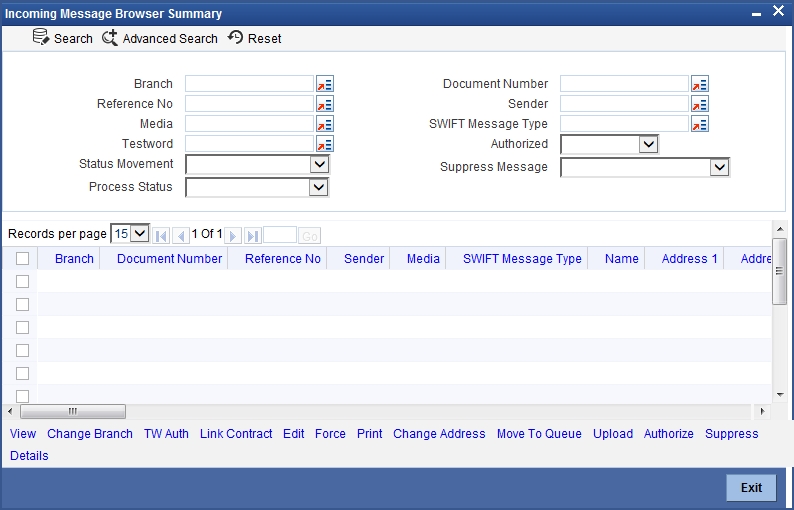

From the ‘Incoming Message Browser’ screen, you can receive messages that have come in through the MCS connected to the node in which the database of your branch is installed. You can invoke the ‘Incoming Message Browser’ screen by typing ‘MSSINBRW’ in the field at the top right corner of the Application tool bar and clicking on the adjoining arrow button.
From the Incoming Message Browser you can:
You can query for the records based on any or all of the following:
The following details of an incoming message will be displayed:
You can set some of the above parameters to make a query. Specify the details in the respective fields and click ‘Search’ button to view the details.

| Action | Operation | |||||||||||
| View Delete | Viewing and deleting the contents of a message | |||||||||||
| Printing a message | You can choose to print the details of an incoming message. To print the details of an incoming message, | When you select the print option, you will be prompted to indicate whether you want to spool or directly print the message. You can also view the SWIFT tag description | ||||||||||
| Change Branch | Changing the Branch of the message | The details of the message will be displayed with only the Branch field enabled. Choose the new branch from the list of values provided and save the message. | ||||||||||
| TW Auth | Authorizing a Testword | A telex message for which you entered a testword should be authorized before it can be routed to a user queue (if you have specified so in the Branch Preferences screen). | To authorize a test word that was entered for a telex message, click the ‘TW Auth’ button from the Browser on this screen. | During the authorization of a testword the authorizer will be required to re-enter the testword. | ||||||||
| Move To Queue | Routing a message to a queue | After you have made the checks that are necessary for the media through which a message is transmitted you can route the message to a user queue. To change the queue in which an incoming message should be stored: | The message will be automatically moved to the queue that you specify. The final destination of an incoming message is the end-user queue. These queues represent departments or printers responsible for acting on the received messages. Once a message is lodged into an end user queue, it can be viewed on-screen or printed by the users who have access to the queue. | You can move messages from one end user queue to another as well. | For a message that was transmitted through Telex, you should enter the testword and have it authorized before you can route it to the relevant end user queue. | |||||||
| Link Contract | Linking the message to a contract | In the browser, select the message with which you want to associate a contract and click on the ‘Link Contract’ button. The Reference Number option-list is enabled for the selected message. You can select the appropriate contract from the list. The message will be subsequently associated with the contract selected here. | ||||||||||
| Upload | Uploading incoming messages | If the background process for incoming messages is not running you will have to upload the messages that have come into your bank from the incoming directory on the node to which your branch is connected. | To upload messages from the incoming directory (specified in the MCS maintenance screen) click the ‘Upload’ button. All messages that were stored in the Incoming Directory will be uploaded to Oracle FLEXCUBE and displayed in the Incoming Message Browser. | |||||||||
| Edit | Editing the Incoming Message | Click ’Edit Message’ button if you wish to make changes to the SWIFT message, especially the messages marked for repair. This is explained in the next Section. | ||||||||||
| Authorize | Authorizing the Incoming Message | Use ‘Authorize’ button to authorize the message. All the amendments made to a SWIFT payment message have to be authorized by a user with appropriate authorization rights. At the time of authorizing, Oracle FLEXCUBE will display the earlier version of the SWIFT payment message along with the amended version, in the same window. | A list of all the errors due to which the message was marked for repair is also displayed. The authorizer can view all the errors and also verify the changes that were made to correct them. After verification, if all the details are found to be appropriate, the message is authorized. | Oracle FLEXCUBE maintains a detailed audit log of all amended SWIFT Payment Messages. The following details are captured for each authorized message: | At any point during the verification and authorization process, the authorizer can choose to cancel the entire operation without changing the status of the message. | |||||||
| Force | Force Releasing Messages | Use ‘Force Release’ button to forcibly release all Payment Message Transactions with ‘Funding Exception’ status and insufficient funds. In other words, the system will post the required accounting entries for such transactions regardless of insufficient funds in the accounts. However, an override will be displayed. The system will also maintain a detailed audit trail for such transactions. A user with appropriate rights can perform this function. | ||||||||||
| Supress | Suppressing the Incoming Message | To suppress a message, click ‘Suppress’ button in the Incoming Browser and invoke the ‘Suppress Message’ screen. The following options are available to suppress a Payment Message: | Specifying the ‘Suppress Message Generation’ option | If you select this option, Oracle FLEXCUBE will stop the generation of the Payment Message. However, the system will post the necessary accounting entries for the messages being suppressed. | Indicating the ‘Suppress Full’ option | If you select the full suppress option for a message, the system will not post the related accounting entries. Advice generation will also be stopped. In other words, the system will not pick up the Payment Message for any further processing. | Specifying the ‘No Suppress’ option | A message marked with the ‘No Suppress’ option will be processed like any other normal Incoming SWIFT Payment Message. | Specifying the remarks for a suppressed message | You can specify the reason for suppressing a Payment Message in the ‘Remarks’ field. |

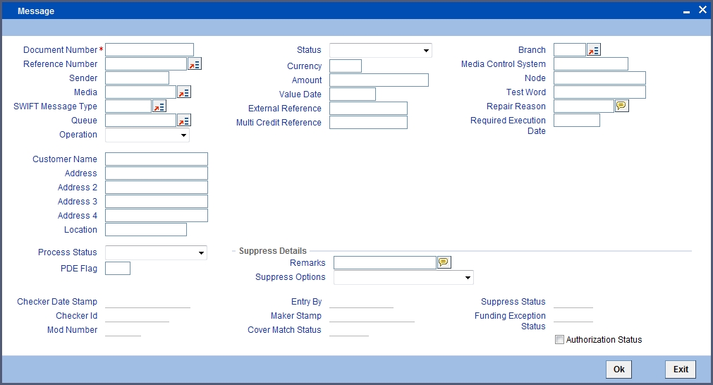

You can view an incoming message in the Incoming Message Summary screen by selecting the message and clicking ‘Details’ button.
The following details regarding the incoming message are displayed in the above screen:

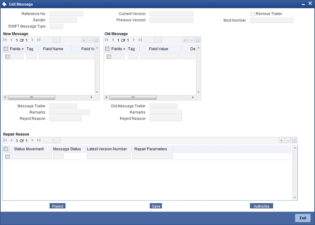

An incoming message can be edited by invoking the ‘Edit‘ function in the Incoming Messages Browser. On pressing the ‘Edit Message’ button, the message is displayed in edit mode. Only a user with requisite rights for editing can edit an incoming message.
The screen is as shown below:
If editing is possible for the user, the message is displayed and is available for amendment. The list of fields, which can be modified are maintained through back-end database tables appropriately during implementation of Oracle FLEXCUBE. Most typically, fields like amount, currency would be maintained as non-modifiable whereas fields such as value date could be maintained as modifiable. Based on the maintenance in these tables, the appropriate fields are enabled for amendment.
On saving the amendment of the message, a new version is created and must be authorized. The screen shown above displays two versions of an incoming message. If the verifier needs to reject the change for any reason the same can be mentioned in the ‘Reject Reason’ field.
Note
In the case of incoming messages with a PDE trailer, the ‘PDE Flag’ check box in the ‘Incoming Message Browser’ screen will be checked. In the ‘Edit Message’ screen, check ‘Remove Trailer’ option to remove the PDE trailer (message contains the text {‘PDE:’}) and save the message.

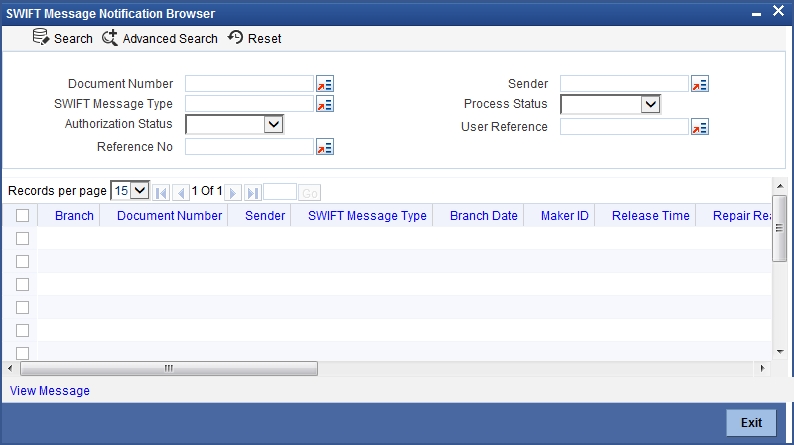

SWIFT provides the following two types of notification messages to Oracle FLEXCUBE:
You can access these notifications messages using ‘SWIFT Message Notification Browser’ screen. You can invoke this screen by screen by typing ‘MSSNOTIB’ in the field at the top right corner of the Application tool bar and clicking on the adjoining arrow button. The screen is as shown below:
In the above screen, you can base your queries on any or all of the following parameters and fetch records:
Select any or all of the above parameters for a query and click ‘Search’ button. The records meeting the selected criteria are displayed.
System displays the following details pertaining to the fetched records:
A back-ground job running on this browser updates the outgoing browser with the ACK/NAK and the delivery status of the message. The sender MUR from SWIFT is used to match the corresponding outgoing browser record.

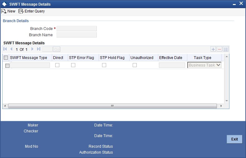

Using the ‘STP Message Maintenance Details’ screen, you can maintain the basis for creation of MT tasks for SWIFT message. You can invoke this screen by typing ‘MSDSTPSC’ in the field at the top right corner of the Application tool bar and clicking the adjoining arrow button.
In this screen, you can specify the following details:
Branch Code
Specify the branch code for which the task creation has to be made. This adjoining option list displays all valid branches maintained in the system. You can choose the appropriate one.
Branch Name
On selecting the branch code, the system defaults the branch name of the bank.
SWIFT Msg Type
Specify the type of the SWIFT Message here. This adjoining option list displays all the SWIFT messages that are maintained in the system. You can choose the appropriate one.
Direct
Check this option to indicate that a MT task/business task should be created for the SWIFT message without subjecting it to the STP process. This is applicable for STP messages.
If this option is checked for Non-STP messages, then a MT task will be created for the Non-STP messages.
STP Error Flag
Check this option to indicate that a MT task/business task should be created when the STP process fails. This is applicable only for the STP Messages.
STP Hold Flag
Check this box to indicate that a MT task/business task should be created for a contract that is put on hold during successful STP processing.
This option is applicable only for the STP messages.
UnAuthorized
Check this box to indicate that a MT task/business task should be created for a contract that is unauthorised during successful STP processing.
Effective Date
Specify the date from which the STP message maintenance becomes effective. Effective date should be equal to or greater than the application date.
Task Type
Select the task type from the adjoining drop-down list. This list displays the following values:
