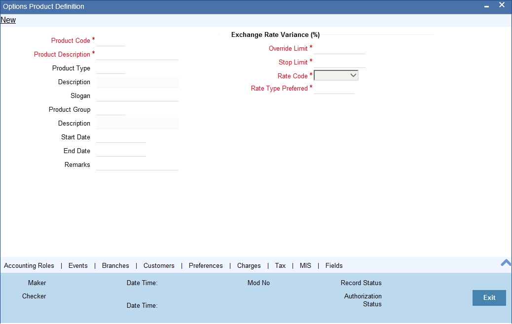

You can create OTC Options products in the ‘OTC Product Definition’ screen, invoked from the Application Browser. In this screen, you can enter basic information relating to a product such as the Product Code, the Description, etc.
You can invoke the ‘Options Product Definition’ screen by typing ‘OTDPRMNT’ in the field at the top right corner of the Application tool bar and clicking the adjoining arrow button.
The first attribute you define for a product is its Type. Once you have made this basic classification you can tailor the product to suit your requirements. Therefore, before you begin specifying the attributes of a product you have to indicate whether the product is an Interest Rate option product or whether it is a Currency option product.
Since you define products for convenience, all OTC deals involving the product inherit the attributes defined for the product. Yet, you have room for flexibility. You can change the inherited attributes of a specific option to suit your requirement at the time of processing it.
For any product you create in Oracle FLEXCUBE, you can define generic attributes, such as branch, currency, and customer restrictions, interest details, tax details, etc., by clicking on the appropriate icon in the horizontal array of icons in this screen. For an OTC product, in addition to these generic attributes, you can specifically define other attributes. These attributes are discussed in detail in this chapter.

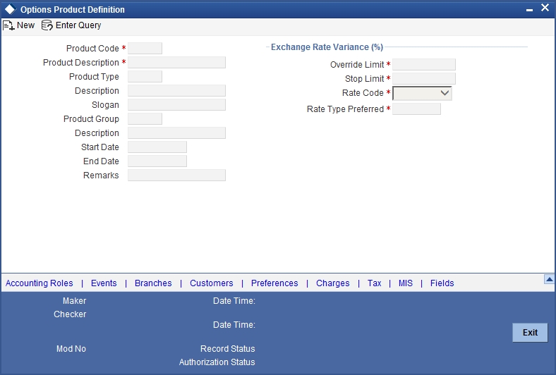

You can define the attributes specific to an OTC product in the ‘OTC Product Definition Main’ screen and the ‘OTC Product Preferences’ screen. In these screens, you can specify the product type and set the product preferences respectively.
Product Type
The product type identifies the basic nature of a product. An options product that you create can either be an Interest Rate option or a Currency option. You will need to specify the product preferences depending on the product type.
4.1.2 Indicating Exchange Rate Variance
For a special customer, or in special cases, you may want to use an exchange rate (a special rate) that is greater than the exchange rate maintained for a currency pair. The variance is referred to as the Exchange Rate Variance.
When creating a product, you can express an Exchange Rate Variance Limit in terms of a percentage. This variance limit would apply to all contracts associated with the derivatives product.
The Override Limit: If the variance between the default rate and the rate input varies by a percentage that is between the Override Limit and the Rate Stop Limit, you can save the deal (involving the product) by providing an override.
The Rate Stop Limit: If the variance between the default rate and the rate input varies by a percentage greater than or equal to the Rate Stop Limit, you cannot save the deal.
Rate Code: While settling charges for cross currency settlements, you can choose to debit the customer by applying the mid rate or by using the buy/sell spread over the mid-rate.
Rate Type: In addition to specifying the Rate Code you have to indicate the Rate Type which should be picked up for exchange rate conversions involving settlement of charges for cross currency deals. You can maintain any one of the following as the Rate Type:
For further information on the generic attributes that you can define for a product, please refer the following Oracle FLEXCUBE User Manuals under Modularity:

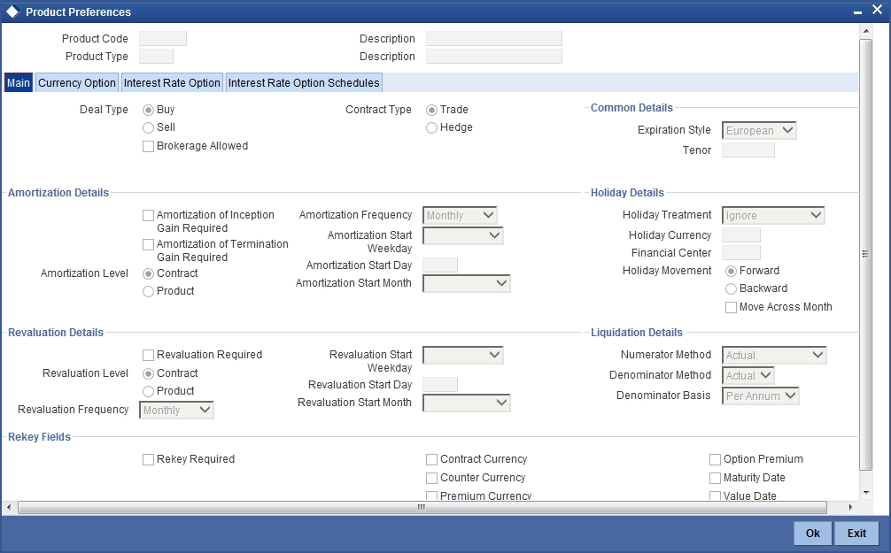

4.1.3 Specifying OTC Product Preferences
Preferences are the options available, for defining the attributes of a product. The instruments categorized under a product will inherit the preferences that are defined for it.
Click ‘Preferences’ button to invoke the ‘OTC Product Preferences’ screen. Through this screen you can define preferences for the product you are creating.
You will notice that the preferences screen gets displayed based on the product type. In case of an Interest rate Option product, the screen is classified into three sections:
However, in case of a currency option product, the screen has only two tabs:
Currency Option - wherein you can specify the attributes specific to the currency options.
Each of the preferences has been documented in detail in the subsequent sections.
4.1.4 Specifying Main Details
The common features or attributes of the product that you need to capture in this tab are as follows:
Deal Type
Indicate whether the product caters to options wherein your bank is buying or selling options. You will be allowed to change this preference for a particular option.
Contract Type
Indicate whether the product is meant for Trade deals (Speculation on interest rate or spot rate movement) or Hedge deals (Protection against risk due to interest rate or spot rate movement). You will be allowed to change this preference while processing a specific deal.
Brokerage Allowed
Enabling this preference indicates that option deals involving this product can involve brokerage.

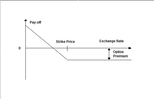

Indicate whether the currency option you are defining is a Call option or a Put option.
Currency Options, thus, protect the buyer against adverse exchange rate movements, while giving the buyer the benefit of favorable exchange rate movements.
The buyer’s pay-off for a call option can be graphed as follows:

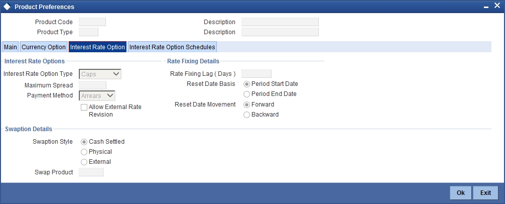

4.1.7 Specifying Interest Rate Option Preferences
Interest Rate preferences are specific to interest rate options. You will be able to access the Interest Rate tab only if you are defining interest rate products.
The preferences specific to Interest Rate options are as follows:

Swaptions
A swaption is an option on a swap. It gives the buyer, on payment of an advance fee, the right, but not the obligation, to enter into an interest rate swap at a specified future date, at a particular fixed rate and for a specified term.
Refer to the Derivatives manual for details on Interest Rate Swaps (IRS).
The terms of a swaption that the buyer and the seller agree on are:
Maximum Spread
Indicates the maximum spread over and above the Reference Rate. You can specify the spread in terms of a percentage.
Payment Method
The payment method can either be in Advance or in Arrears. If you select Advance, payment will have to be made at the beginning of a schedule. If you select Arrears, settlement will be done at the maturity of a schedule.
Allow External Rate Revision
Check this box to indicate that for the contracts linked to this product, you can allow rate revision based on the rates uploaded from an external system.
4.1.9 Specifying Rate Fixing Details
Here, you can capture the following details:
Rate Fixing Lag (Days)
Indicate the number of days before or after the schedule maturity or schedule start date for the reference rate reset to be done.
Reset Date Basis
Indicate whether the reference reset lag is with reference to the Period Start Date (schedule begin date) or the Period End Date (schedule maturity date).
Reset Date Movement
The reset lag for the reference rate can be fixed before (Backward) or after the period start or begin date (Forward).
4.1.10 Specifying Swaption Details
Swaption Style
Indicate whether the product you are defining is meant for actual interest rate swaps (Physical) or for cash settled swaps or for external swaps (if this product is to be used for uploaded contracts).
For physically settled Swaptions, there will be an underlying derivatives swap deal which will get initiated once the Swaption contract is exercised.
For cash settled Swaptions, the swap value of the contract needs to be calculated outside the system and the same needs to be entered during manual exercise of the Swaption deal.
Swap Product
Specify the swap product. This is applicable in case of actual interest rate swaps. You will have to identify the swap product which will be used to default the details of the Derivatives contract.
Processing Impact
The processing impacts are given below.

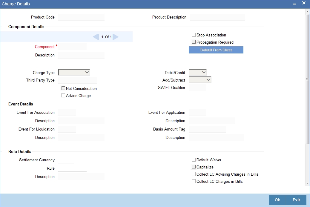

4.1.12 Defining Charge Components for a Product
A charge ‘class’ is a specific type of component that you can build with certain attributes. You can build a charge class, for instance, with the attributes of a specific type of charge component, such as ‘Charge for Manual Exercise’.
You can specify the different charge components for a product, in the ‘Product Charge Definition’ screen, by associating the product with the different charge classes you have built.
Click ‘Charges’ button to invoke the ‘OTC Product Charges’ screen.
In this screen, you can define the charges for the product that you are creating.
To associate a charge class to a product that you are defining, choose the ‘Default From Class’ button. A list of the classes that you have defined specifically for the OTC Interest Rate/Currency options module will be displayed. Choose the class (or classes) that you would like to associate with the product.
Charges for the portfolios maintained under the product will be calculated on the basis of the associated charge classes.

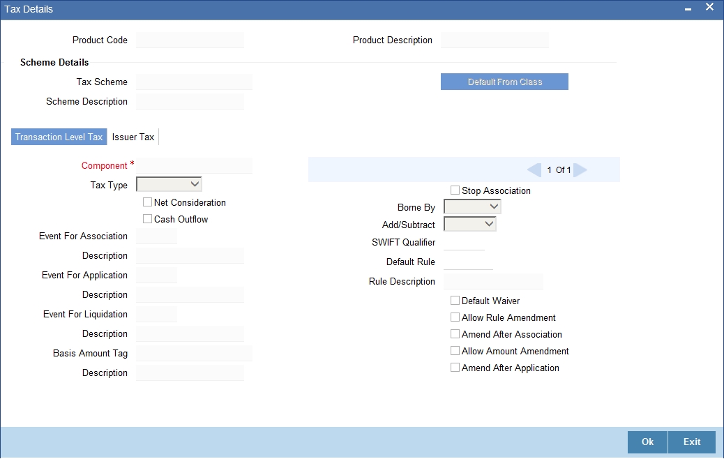

4.1.13 Defining Taxes for Product
A tax ‘class’ is a specific type of component that you can build with certain attributes. You can build a tax class, for instance, with the attributes of a specific type of tax, such as ‘Options tax’. You can group several tax classes into a Tax Scheme Class.
You can specify the taxes for a product, in the ‘Product Tax Definition’ screen, by associating the product with a tax scheme class you have built. (Please note that you cannot define a tax component specific to a product.)
To associate a tax scheme class with a product that you are defining, choose the ‘Default From Class’ button. A list of the tax scheme classes that you have defined specifically for OTC Interest Rate/Currency options module will be displayed. Choose the class that you would like to associate with the product.
Taxes for the portfolios maintained under the product will be calculated on the basis of the associated tax scheme classes.
