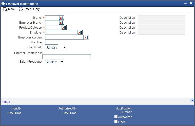

To offer salary processing facilities to a corporate customer using Oracle FLEXCUBE, You can maintain this information in the ‘Employer Maintenance’ screen invoked by typing ‘SLDEMPLR’ in the field at the top right corner of the Application tool bar and clicking the adjoining arrow button.
For an employer, you have to specify the following information:

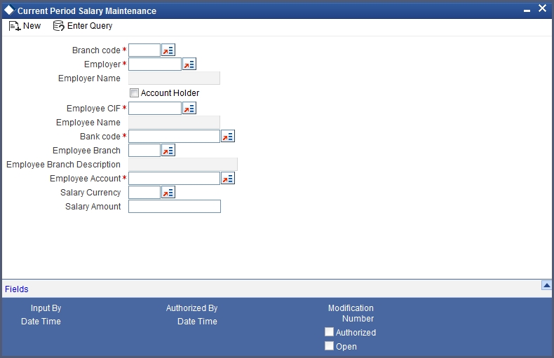

In the ‘Employee Details Maintenance’ screen, the default salary that is to be paid to an employee is specified. This is the salary that will be credited to the employee’s account, by default, on every salary payment date. On occasion, however, the salary that is payable to an employee may be more or less than the default amount specified. In the Salary Details for ‘Current Period’ screen, for a due date, you can indicate the salary amount that should actually be credited to an employee only for that period. After the current period, the default salary maintenance in the employee screen will be considered. This screen is invoked by typing ‘SLDSALCP’ in the field at the top right corner of the Application tool bar and clicking the adjoining arrow button.
To specify the salary amount for the current period that should be paid to an employee, you have to capture the following information:
Once you have captured this information, enter the salary amount that should be credited to the employee’s account on the current payment due date. When you execute the salary process for the current period, the amount you specify here will be credited to the employee’s salary account.

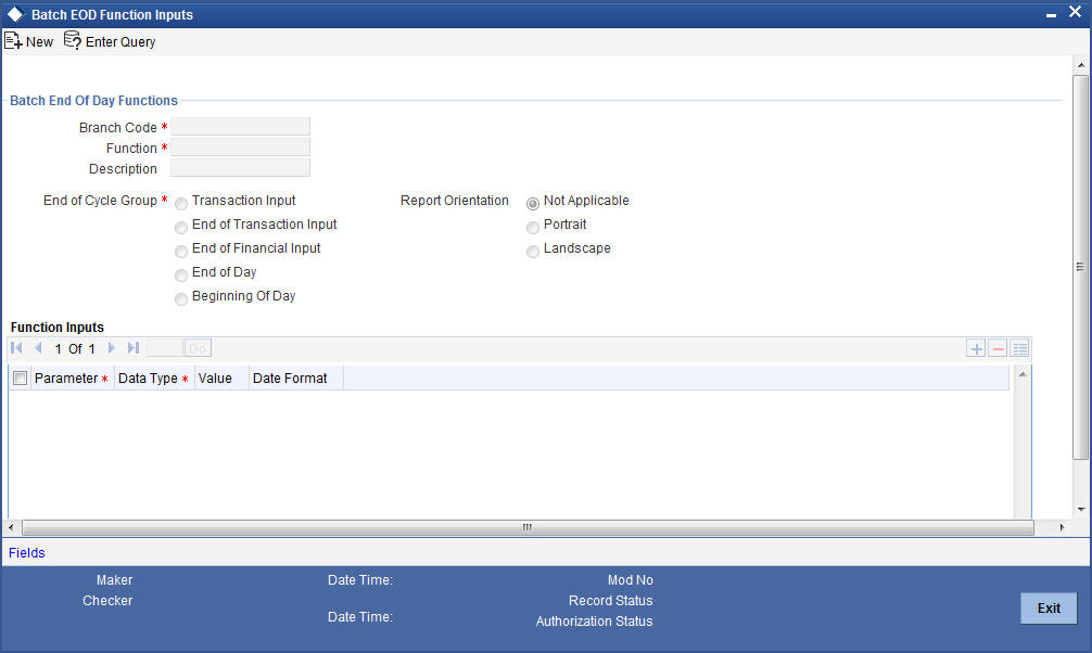

Based on the salary details that you have maintained for your clients, salary is processed either at the beginning of day (BOD) or during end of day (EOD) marking. This maintenance is done from the Mandatory Batch Program Maintenance screen invoked by typing ‘EIDMANPE’ in the field at the top right corner of the Application tool bar and clicking the adjoining arrow button.
The Salary Batch process posts the debit and credit entries to the respective accounts.
You can opt to execute the Salary Batch Process:
This maintenance is done from the BATCH EOD Function Input screen, this screen is invoked by typing ‘BADEODFE’ in the field at the top right corner of the Application tool bar and clicking the adjoining arrow button.
If you execute the salary process at EOD, you can opt to process salaries that are due upto the next working day. This is achieved by choosing the Next Working Day-1 option. This option is enabled only if the salary process is marked for EOD.
