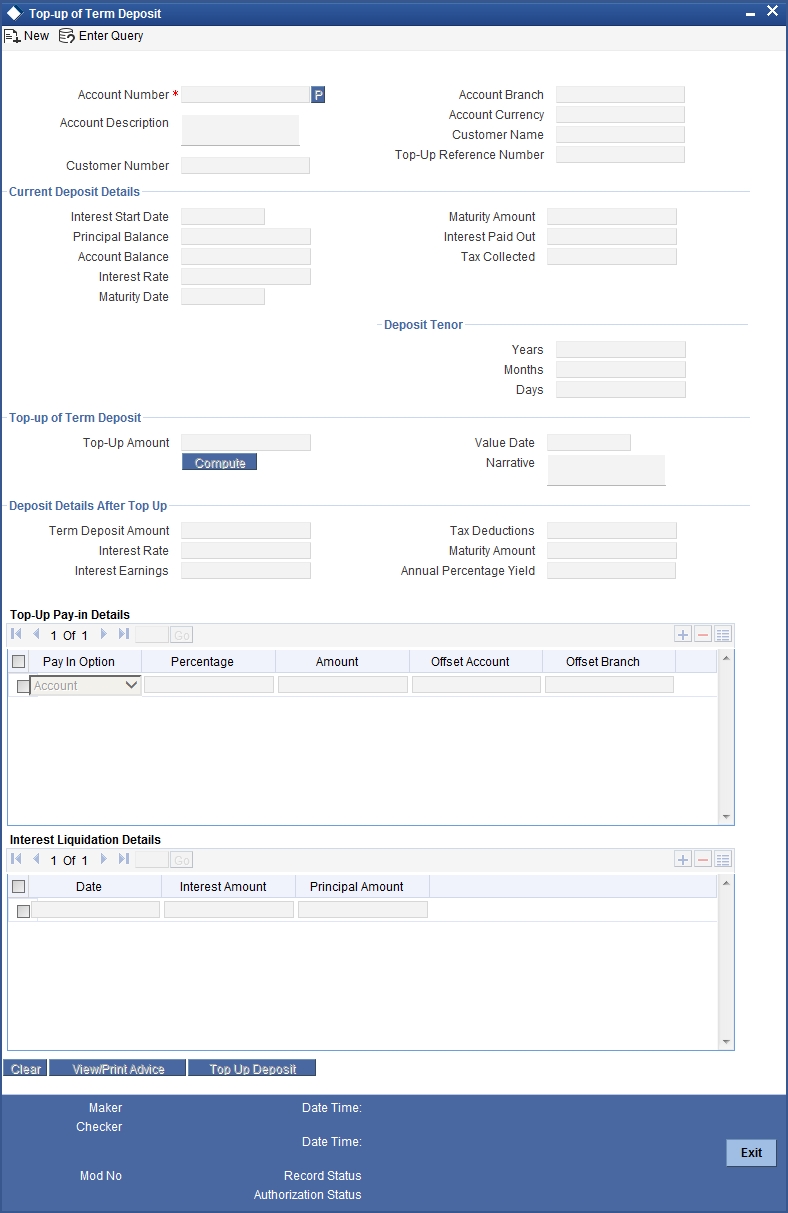

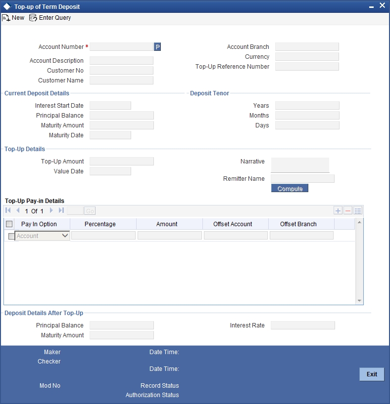

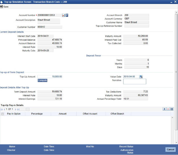

You can top-up a TD using the ‘Top-up of Term Deposit’ screen. You can invoke this screen by typing ‘STDTDTOP’ in the field at the top right corner of the Application tool bar and clicking the adjoining arrow button.
The following details are captured here:
Account Number
Select the account number from the adjoining option list.
On the click of ‘P’ button the following details related to the selected account is populated in the screen.
To view the joint holder’s details of an account and the mode of operation maintained at the account level, place the cursor on the Account Number field and press Ctrl+J. The system displays the ‘Joint Holder’ screen.
For more information on the ‘Joint Holder’ screen refer to the section ‘Joint Holder Maintenance’ in the Core User Manual.
Account Description
The description of the selected TD account is displayed here. You cannot modify this.
Account Branch
The branch code where the selected TD account is available is displayed here. You cannot modify this.
Currency
The currency of the selected TD account is displayed here. You cannot modify this.
Customer Name
The name of the customer holding the TD account is displayed here.
Customer No
The code of the customer holding the TD account is displayed here.
Top-up Reference Number
A system generated reference number for the top-up transaction is displayed here.
Interest Start Date
The date from which the interest on the TD account should be calculated is displayed here. You cannot modify this.
Principal Balance
The principal balance amount of the term deposit is displayed here. You cannot modify this.
In case a partial redemption is made to the TD account, the principal balance is arrived at by subtracting the partially redeemed amount from TD amount. Any interest liquidated to TD account during partial redemption will not be considered in principal balance.
Maturity Amount
The amount available on the maturity of the TD account is displayed here.
In case of partial redemption of the TD account, the maturity amount displayed will not include the liquidated interest on partial redemption.
Maturity Date
The maturity date of the TD account is displayed here.You cannot modify this.
The deposit tenor details of the TD are displayed here.
Years
The tenor of the TD account in years is displayed here.You cannot modify this.The tenor of the TD account in years is displayed here.You cannot modify this.
Months
The tenor of the TD account in months is displayed here.You cannot modify this.
Days
The tenor of the TD account in days is displayed here.You cannot modify this.
The top-up details of the TD are captured here.
Top-up Amount
Specify the top-up amount for the TD.
Value Date
Select the date on which the top-up on the TD has to be effective.The top-up value date can be a back-dated or current date. Future dated top-up is not allowed.
Note
Narrative
Enter remarks about the top-up transaction, if any.
Remitter Name
Specify the name of the remitter in this field.
The pay-in details for the TD top-up is captured here.
Pay-in Option
Select the funding option from the adjoining drop-down list. The following options are available for selection in the drop-down list:
Percentage
Specify the percentage of top-up amount that has to be funded through the selected funding option.
Amount
Specify the top-up amount that has to be funded through the selected funding option.
Note
In case of multiple pay in modes, the sum of amounts in multiple payins should match the top up amount entered.
Offset Account
Select the offset account for passing the accounting entries.
Offset Branch
The branch where the selected offset account is available is displayed here.
After entering above details click’ Compute’ button.The system will compute the deposit details after top-up and display it.
Note
The top-up payin account number and the customer numbers should use different CASA account numbers. The following override message is displayed to ensure that the account numbers are different:
“Do Top-up with different pay-in A/C number”
Principal Balance
The principal balance amount of the term deposit after top-up is displayed here. You cannot modify this.
Interest Rate
The new interest rate to be applied on the top-up deposit, which is maintained at the account class level, is displayed here.
Maturity Amount
The amount that you will get on maturity of the top-up deposit is displayed here.

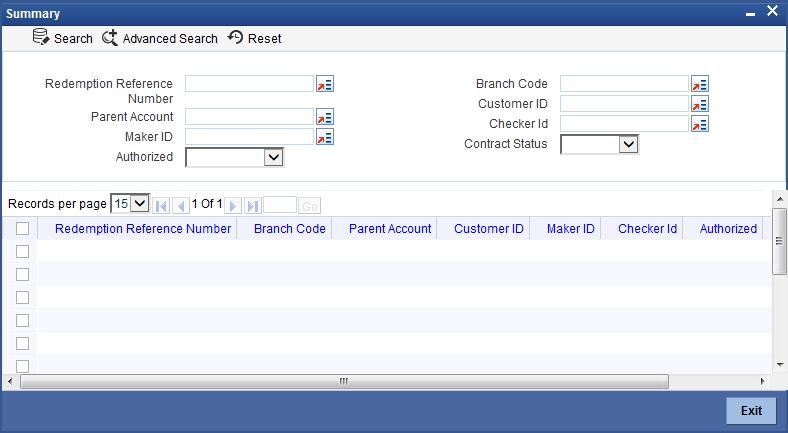

You can view the details of top-up TDs using the ‘Top-up of Term Deposit Summary’ screen.
To invoke this screen, type ‘STSTDTOP’ in the field at the top right corner of the Application tool bar and click the adjoining arrow button.
You can search records based on the following parameters:
Click ‘Execute Query’ button. System fetches and displays all records matching with the entered query parameters. The following details pertaining to each record are displayed:

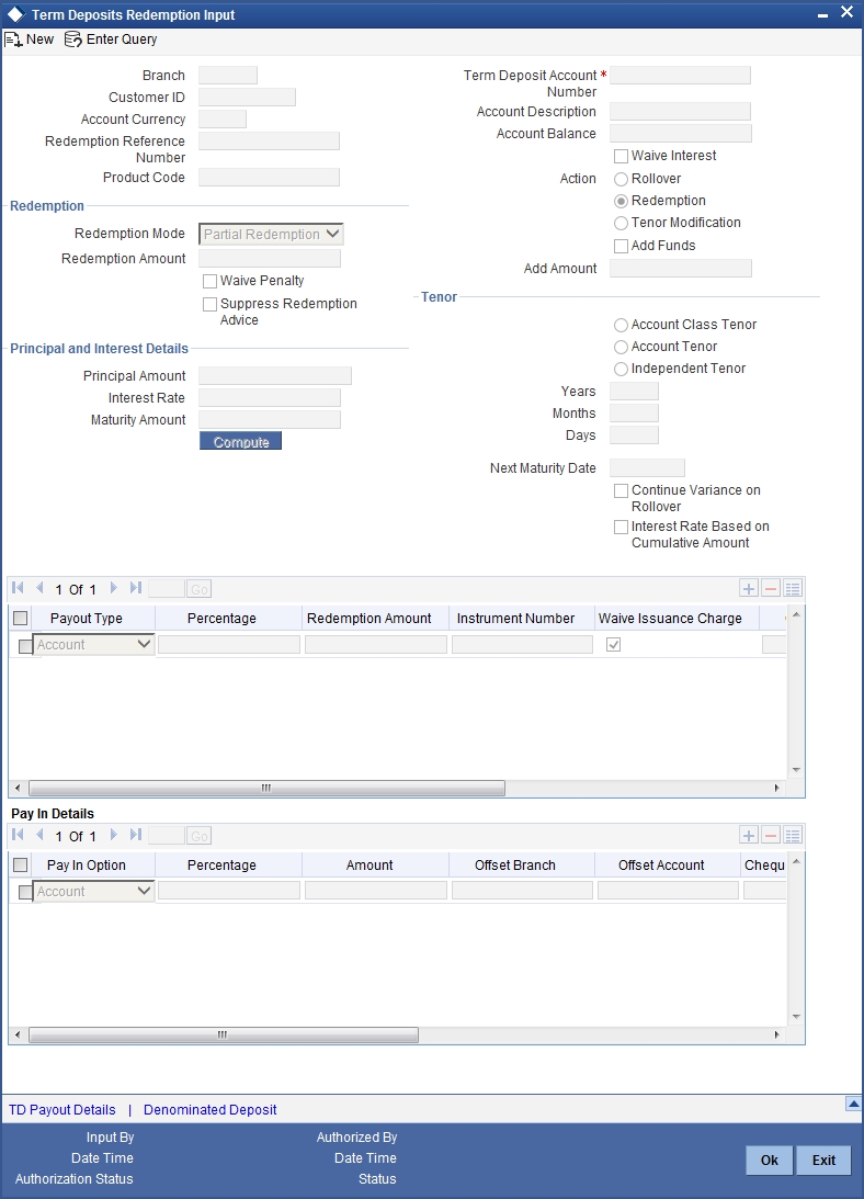

The ‘Term Deposits Redemption Input’ screen enables you to redeem a term deposit. Using this screen, you can do a premature redemption, either in full or in part, ahead of maturity of the deposit and also after maturity date when the TD is in grace days..
This screen also allows you to renew the TD manually. However, renewal of the TD is allowed only on the following scenarios:
In case of ‘Close on Maturity’ or ‘Auto rollover’, the maturity instruction will be executed on the BOD of maturity date, and thus, Grace Days are not applicable. You can invoke the ‘Term Deposit Redemption Input’ screen by typing ‘ICDREDMN’ in the field at the top right corner of the Application tool bar and clicking the adjoining arrow button.
Click the new button on the Application toolbar.
You have to specify the following fields for redeeming the TD.
Redemption Reference Number
The system displays the reference number here.
This field will be enabled only for the query mode and not for the new transaction.
Product Code
You can select an RT product from the adjoining option list.
Note
Branch
Specify the branch where the TD resides. The adjoining option list displays all valid branch codes maintained in the system. You can select the appropriate one.
Customer Identification
The customer identification (CIF) of the customer for whom TD needs to be renewed or redeemed is displayed based on the TD account number.
Term Deposit Account Number
Specify the TD Account Number. You can also choose the appropriate one from the option list. The option list displays the deposit type of accounts maintained in the system.
Note
Redemption can be done from a different customer account number. The following override message is displayed:
“Payout account belongs to different CIF”
The option list also lists auto deposit type of accounts., but on save, error will be displayed as below:
“Redemption is not allowed for auto deposit.”
To view the joint holder’s details of an account and the mode of operation maintained at the account level, place the cursor on the TD Account Number field and press Ctrl+J. The system displays the ‘Joint Holder’ screen.
Account Currency
The TD currency is displayed here based on the TD account number.
Account Description
A description of the TD is displayed here based on the TD account number.
Account Balance
The account balance is displayed here based on the TD account number.
Waive Interest
Check this box to waive off the accrued interest amount that is to be paid to the customer during redemption. This flag is disabled if ‘Tenor Modification’ is selected.
Note
The interest accrued for the current period alone will be waived and already liquidated interest will not be waived.
Waive Penalty
Check this field to waive any penalty related to the deposit redemption.
Note
You can check the ‘Waive Interest’ and ‘Waive Penalty’ boxes only for full redemption and not for partial redemption.
Suppress Redemption Advice
By default the system will generate the redemption advice. However if you check this box, the redemption advice creation will be suppressed.
Rollover/Redemption/Tenor Modification
Choose ‘Rollover’ option to rollover the accounts that are within the grace period days. Grace period can be opted only for unclaimed TD’s and manual rollover is possible only during grace days. Choose ‘Redemption’ to redeem the term deposit. If, rollover is opted, the payout instructions are not applicable at redemption screen. On saving, the renewal days / months / years need to be specified and the next maturity date is defaulted based on the rollover tenor, on save. Select Tenor Modification if you wish to modify the tenor of the TD account.
Add Funds
Check this box to add additional funds for rollover.
Add Amount
Specify the additional amount to be considered for rollover in TD account currency.
Note
Indicate the following details if you have chosen ‘Redemption’. The fields under the heading Redemption will not be applicable when the ‘Tenor Modification’ is selected.
Redemption Mode
Select the mode of redemption from the following options.
During partial redemption, if amount blocks of type ‘discounted’ exist, the system throws an override stating “Amount Blocks exist for the Discounted Deposit Account”.
Note
Redemption Amount
Specify the redemption amount for the partial redemption. Ensure that that the redemption amount is less than the account balance. On partial redemption only the principal amount is withdrawn. The interest amount applicable for the partially redeemed principal is liquidated to the interest booking account specified at TD level.
The system will validate for the following:
During “Full Redemption” of the term deposit with “Goal Reference Number”, the system validates whether there is any open settlement instruction available for that particular TD. If an open settlement instruction is available then full redemption is not allowed and an error message “Full Redemption of TD is not Possible When Open SI’s are Available” will be displayed to the user.
The system displays the following principal and interest details:. The fields under the heading Principal and. Interest Details heading will not be applicable when the ‘Tenor Modification’ is selected.
Principal Amount
The system displays the amount paid at the time of term deposit booking, when you click on the ‘Compute’ button.
Interest Rate
The system displays the current interest rate applicable after partial/full redemption when you click on the ‘Compute’ button. On redemption, for rate chart allowed TD’s, the system picks the rate again, based on the amount slab and tenor
Maturity Amount
Revised maturity amount is displayed here based on the current redemption maintained, when you click ‘Compute’. Also, for partial redemption, the revised maturity amount is updated on the TD account automatically.
The maturity amount displayed is net of Principal, Interest less tax and penalty, if any.
Refer the chapter ‘Annexure B - IC Rule Set-up’ in this user manual for details on calculating principal and interest amount during term deposit redemption.

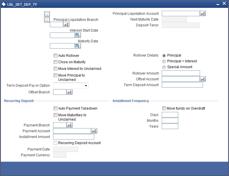

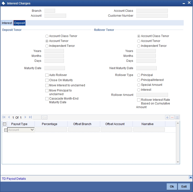

You can rollover a TD only during the grace period. You can select the TD account and define the tenor for which TD should be renewed.
During rollover, the interest is liquidated. The system changes the TD interest start date as the maturity date of the old TD. In the ‘Main’ tab of the ‘Deposit Accounts Booking’ screen, you can see the new maturity date based on the tenor defined here.
If ‘Rollover’ box is checked, then indicate the rollover tenor for the TD account. You can select one of the following options:
Note
System validates that the rollover tenor is within the minimum and maximum tenor allowed for the account class. If this validation fails, then system displays the error message, “Rollover tenor does not fall in the range of minimum and maximum tenor allowed”.
The next maturity date will be adjusted based on the holiday treatment at account class level. The tenor in ICDREDMN screen will remain the same after holiday adjustment. On query from STDCUSTD after rollover, Deposit tenor will be populated with the holiday adjusted tenor and original tenor with the actual tenor before holiday adjustment.
Days
Specify number of days for the rollover of term deposit.
Months
Specify number of months for the rollover of term deposit.
Years
Specify number of years for the rollover of the term deposit.
Note
On saving the rollover, the system displays the ‘Maturity Date’.
Next Maturity Date
The system displays the new maturity date based on the given renewal period.
Interest Rate Based on Cumulative Amount
Check this box to indicate that the system should arrive at the interest rate of a new deposit using the cumulative amount of other active deposits, under the same account class, customer, and currency.
The cumulation of the amount for arriving at the interest rate is done at the account level during the save of the below events:
Note
Refer the section ‘Calculating Interest Rate Based on Base Amount’ in this User Manual for details about arriving at interest rate based on cumulative amount.
Continue Variance on Rollover
The system defaults it based on the flag availability in the TD account level. However, you can modify this flag.
Check this box to enable continued variance on rollover. If you check this, then the system will default account variance as current value to the rollover deposit for the next cycle.
If you do not check this, then the account variance will not be carried forward to next rollover cycle.
If ‘Tenor Modification’ box is checked, then it indicates that the Tenor of the TD account can be modified. This flag is applicable only when ‘Tenor Modification’ is selected in ‘Deposits’ screen of the Account Class Maintenance (STDACCLS) screen. If this box is checked, then the following fields are disabled:
If this box is checked, then the Days, Months, Years and New Maturity fields are enabled. You can specify the modified tenor in years, months and days combination. Independent Tenor field is selected automatically. The tenor should be specified within the minimum and maximum tenor limits maintained at the account class level. If it is not within the minimum and maximum limit, then the system will display an error message. The independent tenor for ‘Tenor Modification’ should not be a null value.
Specify the following details if Tenor Modification is checked:
Days
Specify the new number of days in this field.
Months
Specify the new number of months .
Years
Specify number of years for the tenor modification of term deposit.
Next Maturity Date
The system displays the new maturity date based on the given tenor on ‘Save’ operation.
On ‘Save’ operation, the transaction system will also validate whether ‘Tenor Modification’ flag is selected in the ‘Account Class’ STDACCLS screen. In case, this flag is not selected in the STDACCLS screen, then an error message ‘Tenor Modification Facility Not available for this TD Account’ is displayed.
Specify the following details for TD payout.
Pay Out Type
Select the pay-out type from the drop-down list. The options available are:
Note
For Dual Currency Deposits you are allowed to select only ‘GL’ and ‘Savings Account’ options as the pay-out mode. You can either select GL or Savings Account but not both. Also, you can select only one GL or one Savings account and not multiple GLs or accounts in either case.
Percentage
Specify the amount of redemption in percentage. For redemption through multiple payment modes, the redemption amount that needs to be paid to each mode is computed based on the percentage of payout specified.
Redemption Amount
Specify the actual amount of redemption.
The percentage and redemption amount are conditionally mandatory. You should specify either the percentage or the redemption amount.
Instrument Number
Specify the instrument number to be issued, if payout mode is BC. If not, the system will default the least instrument no available in the branch on save.
Waive Issuance Charges
Check this box to indicate waive option for pay-out BC issuance charge
Offset Branch
Specify the branch code of the account for redemption.
Offset Account
Specify the account number/ GL for redemption through account, GL and loan. For redemption through PC, BC / DD, TD the offset account should not be given.
Narrative
Give a brief description for the redemption.
Note
You can query, modify and amend other branch transactions only through the summary screen.
Select the Payin Details for debiting the additonal amount for rollover from the drop down list. The list displays the following values:
Note
On manual renewal, new event MROL will be fired and the additional funds pay in account will be debited for additional amount. If the ‘pay in’ is selected as Cheque, then MROL will be fired debiting the clearing GL and crediting the TD account. The funds will be in uncollected till the cheque clearance date.
Percentage
Specify the percentage of payout for each payout option specified.
Amount
Specify the amount to be transferred to TD.
Offset Branch
The system displays the branch code of the account to which fund is transferred from TD account.
Offset Account
Specify the account number/ GL to which the fund is transferred to TD account on liquidation, maturity or rollover. This field will return the branch code if the account is selected and NULL will be returned if GL is selected. If pay-out mode is GL then the system displays only GLs in the option list.
Cheque Instrument No
Specify the cheque instrument number.
Clearing Type
Specify the clearing type for the transaction. Alternatively, you can select the clearing type from the option list. The list displays the list of outward clearing products maintained in the system. The cheque clearing happens based on the clearing product specified.
Cheque Date
Specify the date of issue of the cheque.
Drawee Account Number
Specify the drawee account number.
Routing No.
Specify the Routing number.Alternatively, you can select the routing number from the option list. The list displays all the routing number maintained in the system.
Note
If a TD is opened through cheque and is rejected or if a manual rollover transaction through a cheque is rejected, then the TD is updated during the IC batch. The maturity amount, initial principal amount and interest rate of this transaction will be updated only during the EOD batch. Hence, these details will not be available in the report or advice generated during the day.

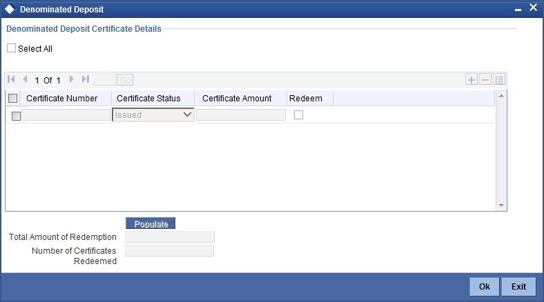

Click ‘Denominated Deposit’ button on the ‘Term Deposit Redemption Input’ screen and invoke the following screen.
Specify the following details for denominated deposit certificate:
Select All
Check this box to select all certificates for the account.
Certificate Number
Select the certificate number from the option list. The list displays all active certificates issued for the account.
Certificate Status
This indicates the current status of the certificate selected.
Certificate Amount
This indicates the amount of the certificate.
Redeem
Check this box to redeem a certificate.
After you enter the above details click ‘Populate’ button. The following details will be displayed:
Total Amount of Redemption
The total amount of redemption is displayed here.
Number of Certificate Redeemed
The number of certificates currently redeemed is displayed here.
During manual part redemptions, all the active certificates of the account are displayed in the ‘Denominated Deposit Certificate Details’ screen and available for redemption.
At the time of full redemption or automatic redemption (i.e. close on maturity), all the active certificates will be marked as ‘Redeemed’ provided there are no certificates with amount block. In case of part redemption of the TD, only the available certificates can be redeemed. A single certificate cannot be part redeemed. The interest amount for the certificates being redeemed prematurely will be paid along with the principal amount. Once a particular certificate has been redeemed, it will not be available for further redemption.

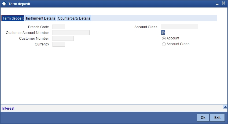

Click ‘Instrument Details’ tab on the ‘Term Deposit’ screen and invoke the following screen. Here you can capture details of the banker’s cheque by which the TD needs to be redeemed. You need to maintain these details, if you have selected ‘Payout Option’ as ‘Banker’s Cheque’ or ‘Demand Draft’.
You can capture the following details:
Specify the following cheque details.
Bank Code
Specify the bank code of the Bankers cheque.
Cheque Date
Specify the cheque date for the pay-out.
Payable Branch
Specify the payable branch for the cheque. The adjoining option list displays all branch codes linked to the specified bank code. You can select the appropriate one.
Indicate the following details.
Beneficiary Name
Specify the name of the beneficiary for the payout.
Other Details
Specify other details (if any) for the beneficiary.
Narrative
Give a brief description for the payout.
Country Code
Specify the country code for the payout address.
Address Line 1 to 3
Specify the address of the beneficiary for the payout.

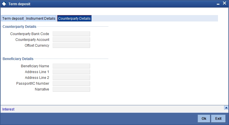

Click ‘Counter Party Details’ tab on the ‘Term Deposit’ screen and invoke the following screen. Here you can capture pay-out details for PC transfer to another bank account. You need to maintain these details, if you have selected ‘Payout Option’ as ‘Payments’.
Counter Party Bank Code
Specify the bank code of the counter party.
Counter Party Offset Account
Beneficiary Name
Specify the name of the beneficiary.
Address Line 1 to 2
Specify the address of the beneficiary.
Other Details
Narrative

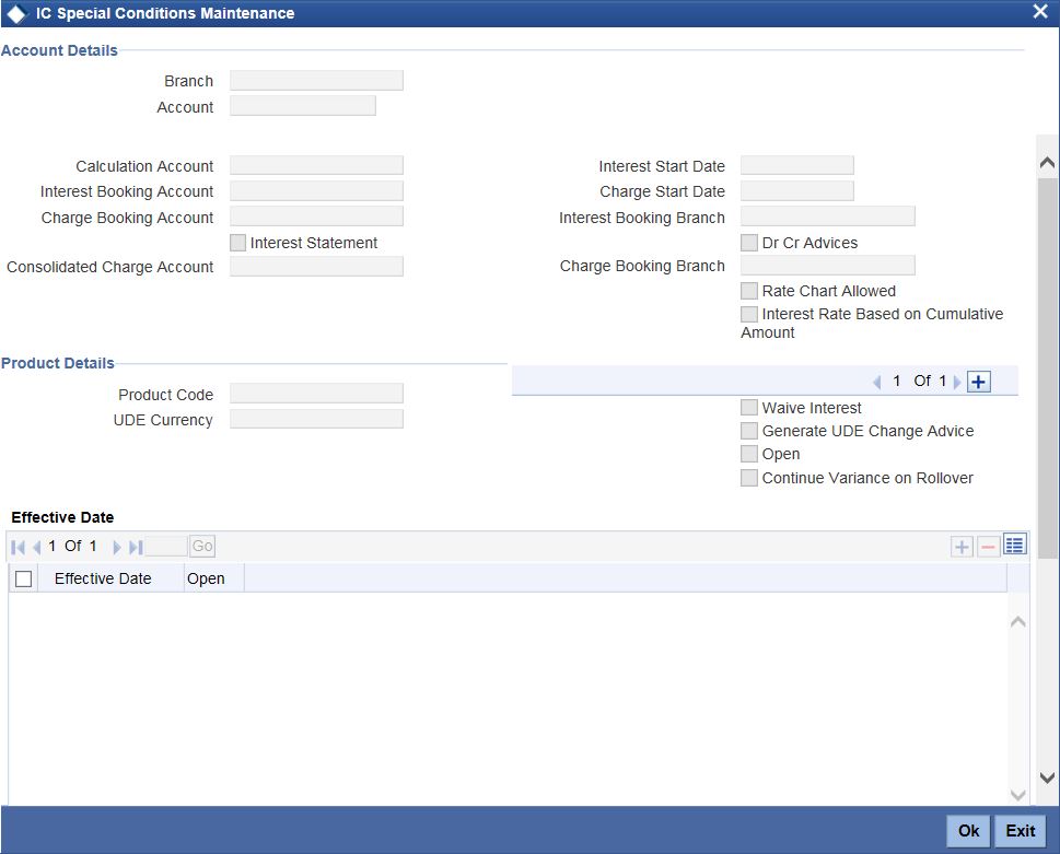

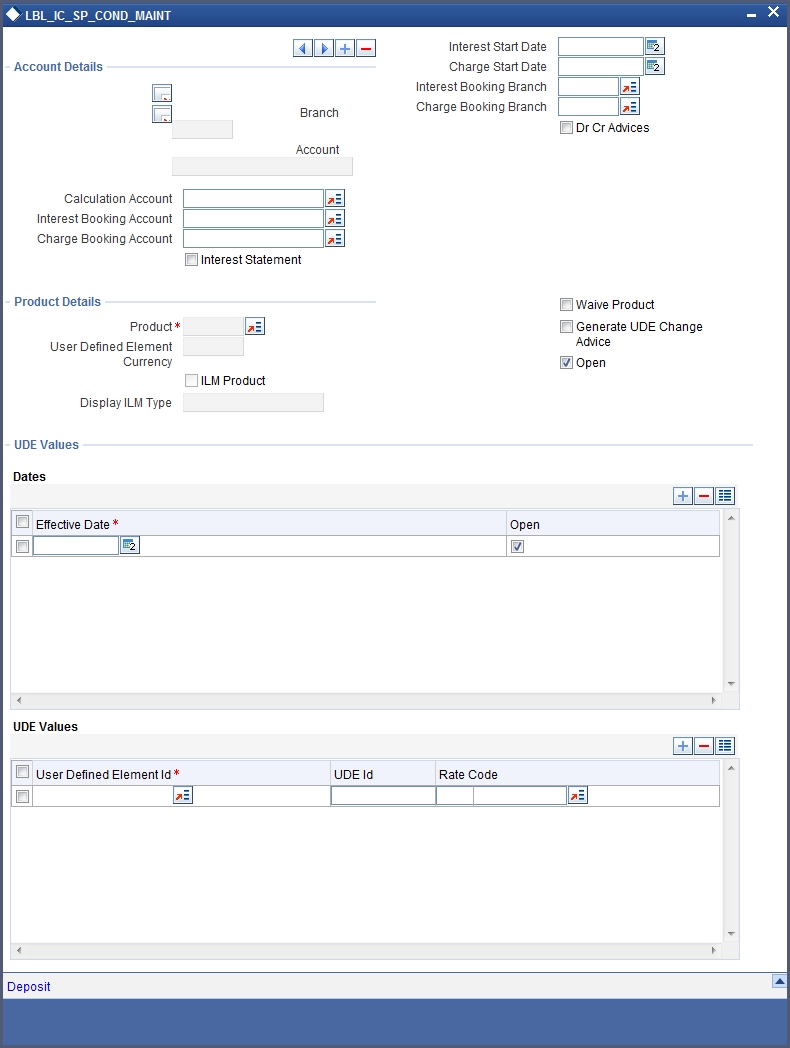

This tab is displayed by default. You can specify the following details:
Calculation Account
Specify the calculation amount of the child TD. The adjoining option list displays all accounts maintained in the respective branch. You can select the appropriate one.
Interest Start Date
Indicate the date from which interest calculation should start, using the adjoining calendar.
Interest Booking Account
Specify the account to which interest should be booked. You have an option of booking interest to a different account belonging to another branch. The accounts maintained in the selected booking branch are available in the option list provided. The system liquidates the interest into the selected account.
The interest booking account lists only CASA accounts and the TD account nos. which is to be created.
Interest Booking Branch
Specify the interest booking branch. The adjoining option list displays all valid branch codes available in the system. You can select the appropriate one.
Interest Statement
Check this box to generate an interest statement for the account. The interest statement will furnish the values of the SDEs and UDEs and the interest rule that applies on the account.
Dr Cr Advices
Check this box to generate payment advices when interest liquidation happens on an account. The advices are generated in the existing SWIFT or/and MAIL format. No advices will be generated if you leave this box unchecked.
Charge Booking Branch
Specify the charge booking branch. The adjoining option list displays all valid branch codes available in the system. You can select the appropriate one.
Charge Book Account
Specify the account to which charge should be booked. You have an option of booking charge to a different account belonging to another branch. The accounts maintained in the selected booking branch are available in the option list provided. The system liquidates the charge into the selected account.
Charge Start Date
Indicate the date from which charge calculation should start, using the adjoining calendar.
The system defaults it based on the Interest and Charges product. However, you can modify this. If this is modified, during the save, the system displays a prompt ‘Continue variance on Rollover Flag is modified’.
Product Code
Specify the interest/charge (IC) product code that should be linked to the account. The adjoining option list displays all valid IC products available in the system. You can select the appropriate one.
UDE Currency
Specify the UDE Currency defined for the product.
Waive
Check this box to waive off an interest or a charge that has been specified.
Generate UDE Change Advice
Check this box to generate the UDE change advice.
Open
Check this box to make the product applicable again. More than one product may be applicable on an account class at the same time. You can temporarily stop applying a product on an account class by ‘closing’ it. You can achieve this by un-checking the box ‘Open’. The product will cease to be applied on the account class.

Click ‘Deposit tab’ in the ‘Interest Charges’ screen to capture deposit details.
Next Maturity Date
On selecting the ‘Auto Rollover’ box, the system displays the next maturity date based on the previous tenor of the deposit.
Select the deposit tenor type. The following options are available.
Years
This indicates the number of years in the original tenor.
Months
This indicates the number of months in the original tenor.
Days
This indicates the number of days in the original tenor.
If the maturity date falls on the holiday, the system adjusts it,
Rollover Tenor
The deposit tenor has following options as below,
Years
This indicates the number of years in the rollover tenor.
Months
This indicates the number of months in the rollover tenor.
Days
This indicates the number of days in the rollover tenor.
The tenor should be specified within the minimum and maximum tenor limits maintained at the account class level. The tenor months cannot be greater than 11 months and if tenor months is specified, the tenor days cannot be greater than 30 days.
The tenor is represented in terms of years, months and days. For example, if the deposit tenor is 185 days, it should be represented as 0 years, 6 months and 5 days. You need to specify the values in the appropriate fields.
Maturity Date
The system picks up the maturity date from the default tenor from the linked account class and displays it here. However, you can modify this date.
Auto Rollover
Check this box to automatically rollover the deposit you are maintaining. You have to indicate ‘Rollover Type’ on selecting this option.
Close on Maturity
Check this box to close the term deposit account on maturity date and transfer the amount as per the pay-out details maintained for the TD.
Move Interest to Unclaimed
Check this field to move the interest amount to the unclaimed GL mapped at the IC product in the accounting role ‘INT_UNCLAIMED’ on grace period end date. If you select this option, you will need to check the box ‘Move Principal to Unclaimed’.
Check this box to move the principal amount to the unclaimed GL mapped at the IC product in the accounting role ‘PRN_UNCLAIMED’ and liquidate the interest amount to the interest booking account on grace period end date.
Rollover Type
Indicate the components that should be rolled over by choosing one of the following options:
Rollover Amount
If a special amount is to be rolled over, you have to specify the amount (less than the original deposit amount).
Specify the following details in order to allow automatic pay-out:
Pay Out Type
Select the pay-out mode from the drop down list. The options available are:
Note
Percentage
Offset Branch
Specify the branch code of the account for redemption. The adjoining option list displays all valid branch codes available in the system. You can select the appropriate one.
Offset Account
Specify the account number/ GL for redemption. The adjoining option list displays all valid accounts and GLs available in the offset branch. You can select the appropriate one.
Narrative

You can view the details of TDs redemption using the ‘Term Deposit Redemption Input - Summary’ screen.
To invoke this screen, type ‘ICSREDMN’ in the field at the top right corner of the Application tool bar and click the adjoining arrow button.
You can query on records based on any one or all of the following criteria:
Click ‘Search’ button. The system identifies all records satisfying the specified criteria and displays the following details for each one of them:

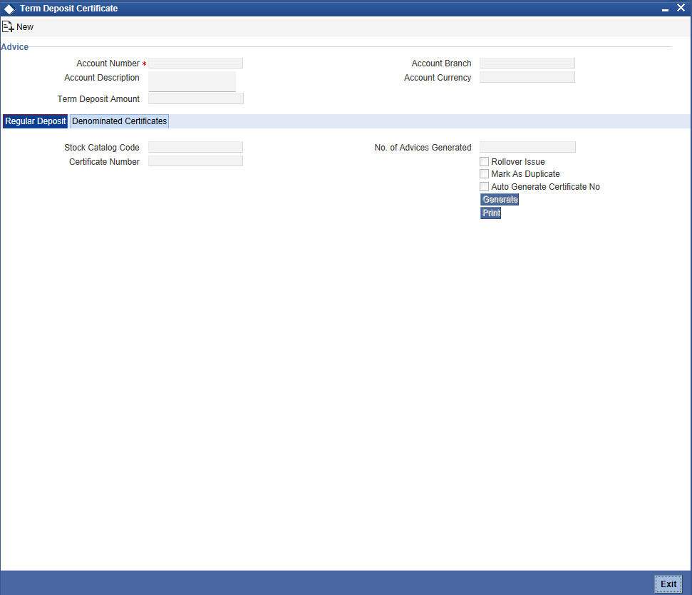

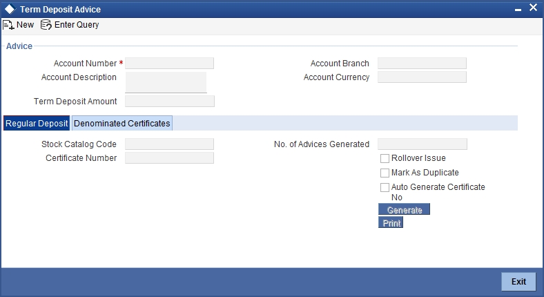

Once a denominated deposit is opened the certificates and duplicate deposit advice can be printed using the ‘Term Deposit Certificate’ screen You can also do a partial printing of denominated deposit certificates i.e. print few certificates at one point of time and the balance certificate later.
To invoke ‘Term Deposit Certificate’ screen, type ‘ICDBADHC’ in the field at the top right corner of the Application tool bar and click the adjoining arrow button.
You need to specify the following details.
Account Number
Specify the account for which you want to generate an advice. The adjoining option list displays all valid accounts maintained in the system. You can select the appropriate one.
Account Description
The description of the selected account number is defaulted here.
Term Deposit Amount
The deposit amount of the selected TD account is defaulted here.Branch Code
The system displays the branch code.
Account Currency
If the TD account selected is a regular deposit and not a denominated deposit then this tab is enabled. The following details are captured here:
Stock Catalog Code
Select the stock catalog code from the adjoining option list. The list displays active stock catalog codes for the TD Certificate instrument type.
Certificate Number
Specify the Certificate Number if the Auto Generate Certificate Number is not checked. System defaults the Certificate Number if Auto Generate Certificate Number is checked.
Note
If the Auto Generate Certificate Number is checked, then the existing Generate button will be used to fetch the next Certificate Number from the inventory maintenance based on the selected Stock Catalog Code for the TD Certificate instrument type.
If Auto Generate Certificate Number is not checked then you have to enter the certificate number. System validates whether the certificate number is valid or not based on the selected stock code. If the entered certificate number is already in use then the system displays an error message.
No. of Advice Generated
The system displays the advice number being generated automatically, when each certificate is generated. On rollover of Term deposit this field will be updated as zero.
Rollover Issue
Check this box if the certificate is generated for a rolled over term deposit.
Note
Mark as Duplicate
Select Mark as Duplicate to issue duplicate certificate, for TD account for which certificate is already issued. If it is not selected, then the system displays an error message while generating the certificate
Check this box to indicate whether system should automatically pickup the certificate number from inventory or the certificate number should be entered manually.

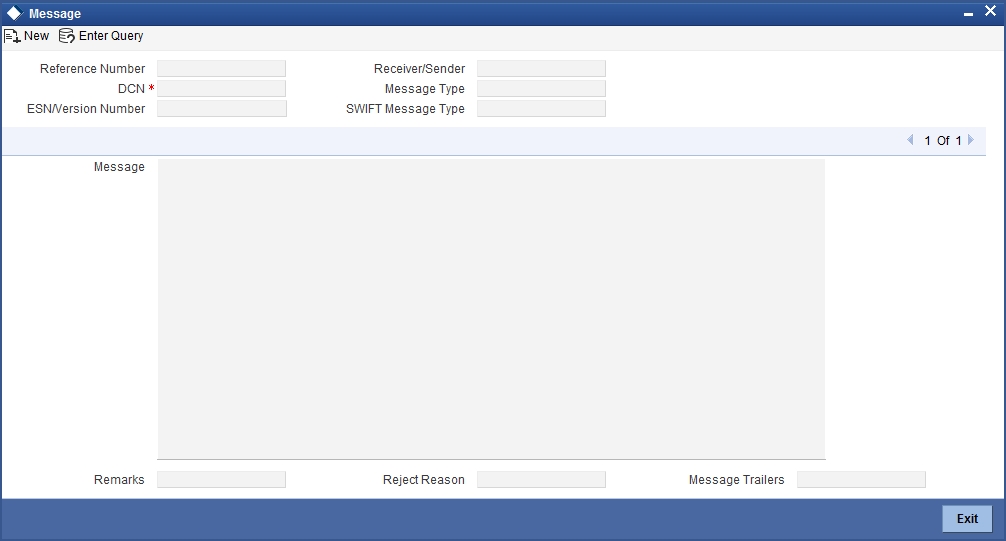

Click ‘Generate’ button. The system will generate the deposit advice. The advice can be viewed on clicking the ‘Print button.
You can view the advice using the ‘Outgoing Message Browser Summary’ screen (MSSOUBRS).

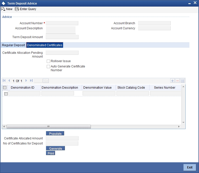

If the TD account selected is a denominated deposit then this tab is enabled.
Certificate Allocation Pending Amount
This indicates the amount for which the certificate is yet to be allocated. Certificate Allocation Pending Amount = Term Deposit Amount - Certificate Allocated Amount.
Rollover Issue
Note
This is applicable only if the deposit is rolled over.
Check this box to indicate that system should auto populate the certificate start number and end number.
Denomination ID
Select the denomination id from the adjoining option list. The list displays all denominations that are already allocated to the account in the ‘Deposit Account Booking’ screen and are not yet issued.
Denomination Description
The description of the selected denomination id is defaulted here.
Denomination Value
The denomination value of the selected denomination id is defaulted here.
Stock Catalog Code
Specify the stock catalog code here. Alternatively you can also select the code from the adjoining option list. The list displays all stock catalog codes defined at the inventory level.
Note
This is applicable only if Inventory module is used for certificate tracking
Series No.
This is the series number as defined at the inventory level.
Note
Availability
This indicates the number of certificates available in the inventory for the selected denomination id.
Note
Units
This is defaulted from the ‘Deposit Account Booking’ or ‘TD Account Opening by Multi Mode’ screen. However, you can modify this value.
You can modify the 'Units' field to a number less than the defaulted value, but it cannot be greater than the defaulted value. System validates the same on click of ‘Populate’ button by verifying whether the number of units for each denomination are less than or equal to the selected units during opening using STDCUSTD or TDMM screens.
Note
The number of units entered is validated with the ‘Availability’ field.
Total Amount
The system computes the denomination value by multiplying the denomination value with the number of units.
Certificate Start No
This indicates the certificate start number. This is auto-generated if the box ‘Auto Generate Certificate Number’ is checked.
If the 'Auto Generate Certificate Number ' is not checked then you have to key in the 'Certificate Start Number'
Certificate End No
This is auto generated if the box ‘Auto Generate Certificate Number’ is checked, else it gets defaulted based on the value provided at Certificate Start Number and Units field. Certificate End Number = Certificate Start Number + Units
Once the above specified details are entered, you have to click the ‘Populate’ button. On click of the ‘Populate’ button the 'Certificate Allocation Pending Amount', 'Certificate Allocated Amount' and 'Number of Certificates for the Deposit' fields are displayed.
This indicates the sum of ‘Total Amount’ field.
The total number of certificates for the term deposit is displayed here.Number of Certificates for the Deposit = Total of ‘Units’ field.
If you do not use the ‘Populate’ button these fields will get displayed on click of ‘Generate’ or ‘Print’ button, whichever is clicked first.
Click 'Generate' button to generate the certificates and click 'Print' button to print the certificates.
During the life cycle of a deposit, a customer can surrender some or all of the certificates to issue new certificates with new denominations.
You can unlock the existing account using the STDCUSTD screen. At the ‘Denominated Deposit’ sub-screen the ‘Certificate Status Query/Modification’ grid you can change the status of the existing certificate to ‘Modified’.
The status can be changed for a single certificate or for bulk certificates, by selecting the certificates required to change status and there by selecting the bulk status change field as 'Modified'.
On click of ‘Populate’ button the following actions will take place:
You can input the required denomination by adding new rows only if the existing certificate status is ‘Modified’. System validates whether the ‘Denomination allocation pending amount’ and the new denomination total amount are the same.Fresh certificates with the new denomination are issued using the ICDBADHC screen. The status of the new certificates will be ‘Re-denominated’.

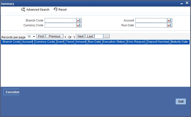

You can view the execution log of all TDs using the ‘Term Deposits Execution Log Summary’ screen. To invoke this screen, type ‘ICSEXELG’ in the field at the top right corner of the Application tool bar and click the adjoining arrow button.

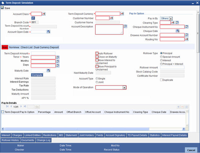

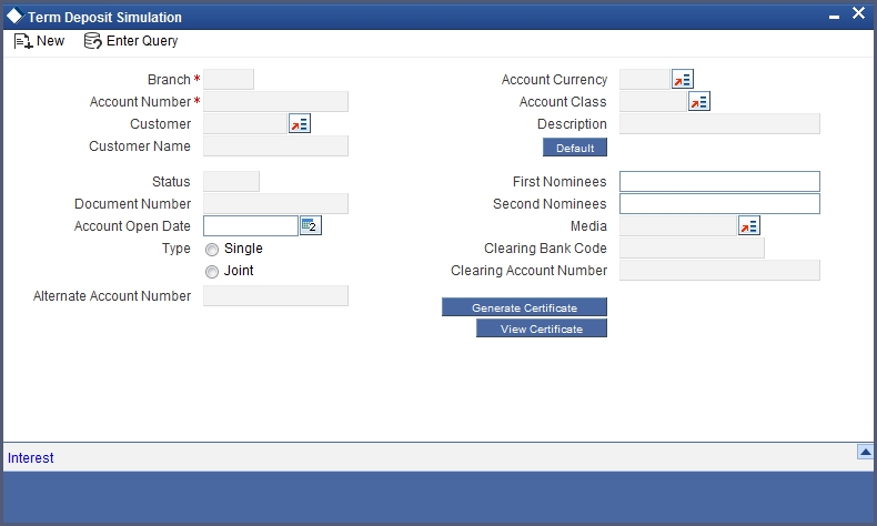

Oracle FLEXCUBE allows you to simulate a TD account in order to enhance sales and services to new and existing customers. You can also provide the customer a certificate with all the details of account. This certificate is generated with a pre-printed number.
You can simulate an account for a customer using the ‘Customer Accounts Simulation’ screen. The details of a account can be entered in this screen and a printed certificate of the account can be obtained by using this screen. To invoke this screen type ‘STDSCSAC’ in the field at the top right corner of the Application tool bar and click the adjoining arrow button.
In this screen you can input all the details of the deposit account. A term deposit account is simulated based on all the information you provide in the screen above. You can also view and generate the details of the term deposit account certificate of the account. Additionally you can view the details of interest, charges and amounts for the simulated TD account.
Branch
The branch where the deposit account is being simulated is displayed here on clicking new icon in the Application Toolbar.
Customer
Specify the customer for whom the account is being simulated. You can also select the customer from the option list provided.
Customer Name
The name of the customer for whom the account is simulated, is displayed here, based on the customer selected.
Account Currency
Specify the currency for the deposit account. You can also select the currency from the option list provided.
Account Class
Specify the ‘deposit’ type of account class under which the deposit should be simulated. You can also select the appropriate account class from the option list provided.
Description
Based on the account class specified, the system displays the corresponding description.
Click ‘Default’ button after specifying the customer, account class and currency.
Account Number
The account number of the customer for whom you need to simulate a deposit account is displayed here.
Status
The status of the simulated account is displayed here based on the customer selected
First Nominees
Specify the first person to hold the right to the simulated account balance after the customer’s expiration.
DCN
The Delivery Control Number used for uniquely identifying a message in Oracle FLEXCUBE is displayed here.
Second Nominees
Specify the secondary person to hold the rights to the simulated account balance after the customer’s expiration.
Account Open Date
The date on which the account has to be opened is defaulted based on the account class selected here. You can however change the value of the opening date of account.
Media
Select the media to communicate account related details to the customer, such as account maintenance related charges, fees, interest etc. from the option list. You can choose either of the following:
Type
The type of account is defaulted based on the account class selected. However, you can select the type of deposit account that you are maintaining a simulation for; you can select any one of the following options:
Clearing Bank Code
The code for the bank serving as clearing house for the simulated account is displayed here
Clearing Account Number
The account number for the clearing activity for the simulated account is displayed here
Alternate Account Number
Specify an alternate account for the simulated account
To generate the details of TD account in certificate format, click the ‘Generate Certificate’ button on the ‘Customer Accounts Simulation’ screen.
To view the details of the certificate generated for the simulated account, click the ‘View Certificate’ button on the ‘Customer Accounts Simulation’ screen. The following details are displayed:
To procure a hard copy of the certificate click ‘Print’. The generated certificates are also available through the Messaging browser. Messaging archival or purge action determines the storage or removal of these certificates from the Application Browser.
To specify the interest and charge related details of the term deposit account click the ‘Interest’ button. The screen is as shown below:
You can define the interest and charge related details associated with the customer’s deposit account.
For more information on specifying Interest details for TD refer to the section, ‘Specifying Interest Details’ in the chapter ‘TD Additional Details’ in this User Manual.
Click ‘Deposit’ button in the ‘IC Special Conditions Maintenance’ screen to specify preferences for the simulated account.
Specify the following details:
Principal Liquidation Branch
Specify the branch in which the liquidation account is maintained. The adjoining option list displays all valid branches maintained in the system. You can select the appropriate one.
Principal Liquidation Account
On maturity, the principal of a time deposit can be liquidated into an account you specify. This would typically be the customer’s account. When maintaining a deposit, indicate the account into which the principal should be liquidated. You should also
Interest Start Date
Specify the date from which the interest accruals of TD account begins.
Maturity Date
The system defaults the maturity date from the default tenor from the account class. However, you can modify this date. On this date the term deposit account gets liquidated.
Auto Rollover
Check this field to automatically rollover the deposit you are maintaining. You have to indicate ‘Rollover Type’ on selecting this option
Close on Maturity
Check this field to close the term deposit account on maturity date and transfer the amount to the principal liquidation account. If you select this option, the principal liquidation account should be an account other than the term deposit account.
Check this field to move the interest amount to the unclaimed GL mapped at the IC product in the accounting roles on grace period end date of the term deposit account.
Check this field to move the principal amount to the unclaimed GL mapped at the IC product in the accounting roles and liquidate the interest amount to the interest booking account on grace period end date of the term deposit account.
Term Deposit Amount
Specify the amount for which TD should be simulated.
Next Maturity Date
On selecting the rollover for the TD account, the system defaults the next maturity date from the previous tenor of the deposit.
Deposit Tenor
The system calculates the tenor of the deposit account to the difference between Interest start date and Maturity date and displays it. In case of change in maturity date, the system changes the value of this field.
Rollover Type
Rollover Amount
If a special amount is to be rolled over, you have to specify the amount (less than the original deposit amount) in this field.
Term Deposit Pay-in Option
Indicate the method for initial funding during account creation. Choose one of the following options:
Offset Account
Specify the account number/ GL from which the fund should transferred to TD account as part of simulation. This field returns the branch code if the account is selected and NULL is returned if GL is selected. If the pay-in mode is GL then the system will display only GLs and if the pay-in mode is account then only accounts will be displayed in the option list.
Auto Payment Take Down
Check this field to allow the recurring deposit account to debit the payment account for the payment amount as per the installment frequency.
Move Maturities to Unclaimed
Check this field to move all the funds, on the maturity date, to the unclaimed GL mapped to the accounting role in the IC product.
Payment Branch
Specify the details for the branch to which the payment account belongs.
Payment Account
Specify the Payment Account; this can be either savings account or the current account from which the installment for the Recurring Deposit is collected as per the installment frequency
Installment Amount
Specify the installment amount that has to be collected from the payment account as per the installment frequency. This installment amount should be greater than the minimum amount mentioned at the account class.
Recurring Deposit Account
Check this field to indicate recurring deposit account.
Payment Date
Specify the date on which the payment needs to be done for recurring deposit account.
Payment Currency
Specify currency of the payment amount.
Note
Move funds on Overdraft
Check this option to indicate whether the Recurring Deposit account funds should move to an unclaimed account if it is overdue
Days
Specify the installment frequency in terms of days.
Months
Specify the installment frequency in terms of months.
Years
Specify the installment frequency in terms of years.

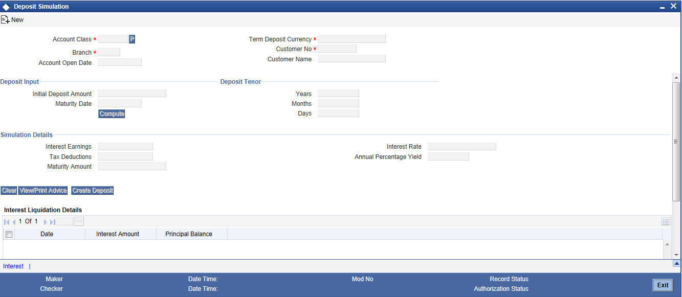

You can use this screen to initiate the deposit opening simulation for the existing customers as well as for the prospects using Conventional Term Deposit Simulation Input screen. To invoke this screen type ‘STDTDSIM’ in the field at the top right corner of the Application tool bar and click the adjoining arrow button.
You need to specify the following details:
Account Class
Specify the account class in which the customer wishes to open the TD. The adjoining option list displays the available TD account classes. You can select the appropriate one.
If an RD account class is selected, then on clicking the ‘Populate’ button the system displays an error message as “RD account class not allowed for simulation”.
Click the ‘P’ button adjoining to the account class. The system validates the account number and defaults the following fields:
Branch
Specify the branch code in which customer wants to open the account. By default, the system displays the current branch code; however, if you are multi branch operational user, then you can modify this by selecting it from the adjoining option list.
Account Open Date
System defaults the current date as account opening date; however, you can modify this date to a back date or future date.
If you have selected the future date for simulation; and you click on ‘Create Deposit’ button, then the system displays an error message as “Future Dated Deposit Opening not Allowed”.
Term Deposit Currency
Select the term deposit currency from the adjoining option list.
Customer No
Specify the customer’s/ prospect’s identification number.For prospects, walk in customer id of the branch has to be specified.
Note
Customer account number, pay in account number, and payout account number should have different CASA account numbers. The following override message is displayed:
“Book TD with Single or Joint, Provide the IB, Pay-in and Payout Account as different customer”.
Customer Name
Specify the customer’s/ prospect’s name. The system defaults this if you have specified the customer number.
Initial Deposit Amount
Specify the initial deposit amount you want to keep with the bank for a particular tenor. The system displays an error message if initial deposit amount is not specified.
Maturity Date
If tenor is provided system calculates and displays the maturity date automatically. If maturity date is provided then tenor is calculated automatically.
Click ‘Compute’ button to default the maturity details as an output of the deposit opening simulation.
Years
Specify the tenor of deposit in years.
Months
Specify the tenor of deposit in months.
Days
Specify the tenor of deposit in days.
Interest Earnings
System displays the gross amount of interest that will be earned during the tenor of deposit.
Interest Rate
System displays the interest rate applicable for the deposit based on the product/amount/tenor.
Tax Deductions
The system displays the amount of tax that will be deducted from the gross interest amount.
Maturity Amount
System displays the total maturity amount of the deposit, i.e. Principal + Interest earned after deducting tax.
Annual Percentage Yield
System displays the annual percentage yield for the applicable interest rate.
Note
For discounted TDs, Annual Percentage Yield will display the applicable interest rate.
You can view the following details here:
Date
System displays the date of interest liquidation.
Interest Amount
System displays the net interest amount that will be earned and liquidated for the compounding period.
Principal Balance
System displays the updated principal balance amount after adding net interest amount earned during the compounding period.
Note
The data can be modified after or before simulation.
Click ‘Clear’ button to clear the available data in simulation screen at any point of time.
Click on the ‘View/Print Advice’ button to view or print the simulation details.
Click ‘Create Deposit’ button to create the term deposit.
System enables the fields related to deposit opening. System defaults the fields maintained in the ‘TD Simulation’ screen.
You can modify the following details:
On clicking ‘Create deposit tenor’ the min and max tenor applicable for the account class are validated. Validations for deposit opening in this screen are same as in STDCUSTD screen.
Once the create deposit button is clicked and the deposit opening screen is visible, then you will not be able to navigate back to the simulation screen.
Note
If you try to create deposit for a walk-in customer from a TD simulation screen, system will throw an error “Term Deposit cannot be opened with walk-in customer Id".
Account number is created in the simulation screen itself, but displayed only post clicking of “Create Deposit” button. For existing customers new deposit can be created using the existing customer id.
The system displays the pay in options as ‘Others’. If the Pay in By option is changed to ‘Cheque’ then it is mandatory to specify all the details and click on ‘Default’ button. Once this button is clicked the pay in details provided will be defaulted in the ‘Pay in Details’ multi- grid.
For more information on specifying TD creation details, refer to the section ‘Creating a Deposit Account’ in the chapter ‘TD Account’.

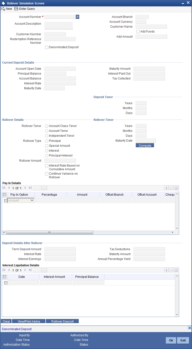

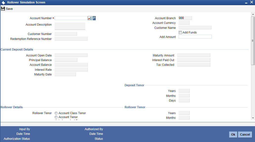

You can initiate to simulate the term deposit renewal for existing TD accounts using ‘Rollover Simulation’ screen. To invoke this screen type ‘ICDREDRN’ in the field at the top right corner of the Application tool bar and click the adjoining arrow button.
The rollover simulation can be done on any date before the maturity date of the deposit, but only the matured and unclaimed deposits which are in a grace period can be renewed using the Rollover Simulation screen. If the user instructs to renew the deposit before the maturity date from simulation screen, then the system displays an error message as “Only matured accounts can be renewed”.
Account Number
Specify the existing term deposit account number. The adjoining option list displays all the account numbers for which the top up is allowed at the account class level. Select the appropriate one.
Click the ‘P’ button. The system validates the account number and defaults the following fields:
Account Description
System displays the description of the account.
Account Branch
The system displays the branch code in which the account is maintained on click of ‘New’ button. By default the current branch code is displayed.
Custom Number
The system displays the customer number.
Customer Name
System displays the customer name based on the customer Id.
Account Currency
System displays the currency of term deposit account.
Add Funds
Add Amount
Account Open Date
The system displays the date on which the existing deposit is opened.
Principal Balance
The system displays the principal balance of deposit.The principal amount displayed here is the current principal amount of the deposit.
Account Balance
System displays the balance available in deposit account as on date.
Interest Rate
System displays the rate of interest of the current deposit.
Maturity Date
This indicates the maturity date of the existing deposit. This is only a display field and cannot be modified.
Maturity Amount
System displays the amount of maturity for the existing deposit.
Interest Paid Out
System displays the amount of interest liquidated till date from the date of account opening.
Tax Collected
The system displays the amount of tax collected till date from the date of account opening.
Years
The system displays the tenor of deposit in years.
Months
The system displays the tenor of deposit in months.
Days
The system displays the tenor of deposit in days.
Rollover Type
Select the rollover type from the following:
Rollover Amount
You need to specify the rollover amount only if you have selected ‘Special Amount’ as rollover type. Specify the amount taken for the rollover. System considers this amount in rollover calculation.
Years
System defaults the tenor of the existing deposit in years; however, you can modify this if required. Maturity date is updated when the tenor is modified.
Months
System defaults the tenor of the existing deposit in months; however, you can modify this if required. Maturity date is updated when the tenor is modified.
Days
System defaults the tenor of the existing deposit in days; however, you can modify this if required. Maturity date is updated when the tenor is modified.
Maturity Date
System calculates and displays the maturity date based on the tenor of existing deposit. You can modify the maturity date. The system updates the tenor based on the modification made on the maturity date. If the maturity date is modified, accordingly the tenor gets adjusted.
Interest rate Based on Cumulative Amount
Check box to confirm whether interest rate will be based on cumulative amount or not. System defaults this box based on the Account Class; however, you can modify this.
Check box to confirm whether variance on rollover will be continued or not. System defaults this box based on the Account Class; however, you can modify this.
Click ‘Compute’ button to calculate the ‘Deposit Details After Rollover’ and ‘Liquidation Details’.
Note
Percentage
Amount
Offset Branch
Offset Account
Clearing Type
Cheque Date
Routing No.
Note
View the following details:
Term Deposit Amount
System displays the term deposit amount based on the "Rollover Type" selected. This amount will be taken as the principal amount for rollover calculations.
Interest Rate
System displays the interest rate applicable for the deposit based on product/amount/tenor as on maturity date of the existing deposit.
Interest Earnings
System displays the total interest that will be earned by the deposit during the rollover tenor.
Tax Deductions
System displays the applicable percentage of tax that will be deducted from the total interest during the term of deposit mentioned for rollover.
Maturity Amount
System displays the maturity amount of the deposit after the rollover term, i.e. Rollover Principal + Interest earned after deducting tax.
System displays the annual percentage yield for the applicable interest rate for rollover.
You can view the following:
Date
Interest Amount
System displays the net interest amount that will be liquidated based on the compounding frequency.
Principal Balance
System displays the Principal balance of deposit after adding net interest amount earned during the compounding period, i.e. Principal Balance at the beginning of cycle + Net Interest liquidated for that compounding cycle.
Click ‘View/Print Advice’ button to view or print the simulation details.
Click ‘Rollover Deposit’ button to rollover term deposit.
System enables the fields related to deposit rollover. System defaults the fields maintained in the ‘Rollover Simulation’ screen. You can modify the following details:
You cannot navigate to the Rollover Simulation screen once you click on the ‘Renew Deposit’ button.
Note
While saving the transaction, if you had modified the interest rate at TD account level for TD booking or for creating Payout TD, the system displays configurable override messages.
These overrides are displayed during subsequent modifications of the interest rate. You can also configure overrides for Dual Authorization to be displayed at Contract and Maintenance level in the ‘Override Maintenance’ screen.
For more information about configuring overrides, refer to the section ‘Override Maintenance’ in the chapter ‘Configuring Overrides’ in the Core Services User Manual.
You can simulate the term deposit top up (additional investments) only for the existing customers having TD account with the bank using the ‘Top Up Simulation’ screen. To invoke this screen type ‘STDTPSIM’ in the field at the top right corner of the Application tool bar and click the adjoining arrow button.
Account Number
Account Branch
Account Description
The system displays the description of the account.
Account Currency
The system displays the currency of the term deposit account.
Customer Name
The system displays the customer name based on the account number selected.
Customer Name
The system displays the customer name based on the customer Id.
Principal Balance
The system displays the current principal amount of the deposit.
Interest Start Date
The system displays the date from which the interest is applicable for this deposit.
Maturity Date
The system displays the maturity date of the existing term deposit.
Maturity Amount
The system displays the maturity amount of the term deposit.
Account Balance
The system displays the current balance available in the deposit account.
Interest Rate
The system displays the rate of interest of the current deposit.
Interest Paid Out
The system displays the interest paid out till date in the term deposit account.
Tax Collected
The system displays the amount of tax collected till date in the term deposit account.
Years
The system displays the tenor of the existing deposit in years.
Months
The system displays the tenor of the existing deposit in months.
Days
The system displays the tenor of the existing deposit in days.
Value Date
Specify the date on which top up will be made.
Simulation is allowed for the back date or for future date; however, when ‘Top up’ button is clicked system will display an error that “Future Dated Top Up is not Allowed”.
Top-Up Amount
Specify the amount that will be added to the existing deposit on the top up date.
Click ‘Compute’ button. The system defaults the ‘Deposit Details after Topup’ and Interest Liquidation Details’.
Term Deposit Amount
The system displays the revised term deposit amount after adding the top up amount to the existing deposit.
Interest Rate
The system displays the revised interest rate applicable for the account class/amount/tenor combination from date of top up.
Interest Earnings
The system displays the total interest that will be earned from the start date of current compounding cycle to the maturity date of deposit by taking top up amount and the revised interest rate into consideration.
Tax Deductions
The system displays the applicable tax amount that will be deducted from the interest earnings during the tenor of deposit.
New Maturity Amount
The system displays the revised maturity amount considering the top up amount.
The system displays the annual percentage yield for the applicable interest rate.
Date
The system displays the date of interest liquidation.
Interest Amount
The system displays the interest amount that will be liquidated based on the compounding frequency.
Principal Amount
The system displays the updated principal balance amount as on interest liquidation, i.e. Principal Balance at the beginning of cycle + Net Interest liquidated for that compounding cycle.
Click ‘Top Up Deposit’ button to top up the term deposit.
System enables the fields related to deposit top up. System defaults the fields maintained in the ‘Deposit Top Up Simulation’ screen. You can modify the following details:
You cannot navigate to the Top Up Simulation screen once you click on the ‘Top Up Deposit’ button.
Note

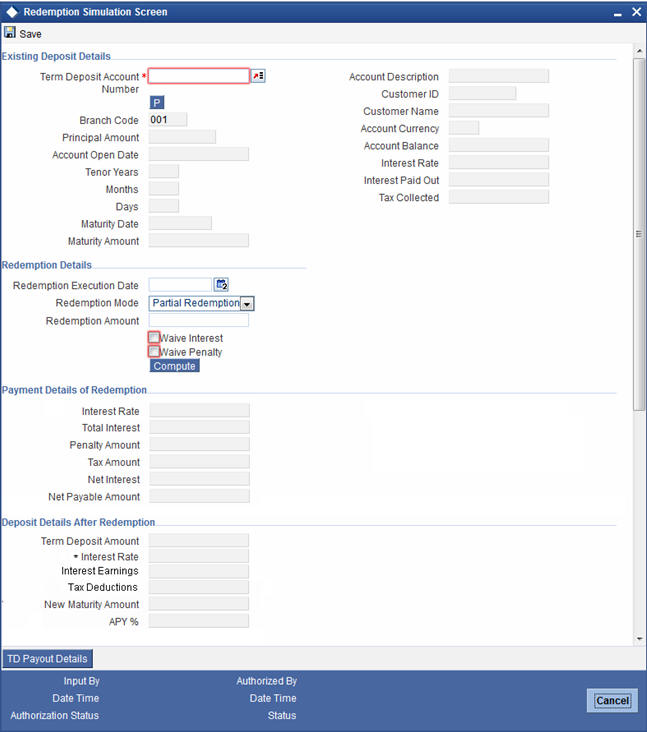

You can simulate the partial redemption as well as full redemption for the existing TD accounts using ‘Redemption Simulation’ screen. To invoke this screen type ‘ICDRDSIM’ in the field at the top right corner of the Application tool bar and click the adjoining arrow button.
Account Number
Specify the term deposit account number. The adjoining option list displays the existing TD account numbers. Select the appropriate one.
Account Branch
Account Description
Account Currency
Customer Number
System displays the customer number based on the account number.
Customer Name
Account Open Date
Principal Balance
Account Balance
Interest Rate
Maturity Date
System calculates and defaults the maturity date if the tenor details are maintained.
Maturity Amount
Interest Paid Out
System displays the amount of interest liquidated till date from the liquidated interest.
Tax Collected
The system displays the amount of tax collected till date.
Years
Months
Days
Redemption Mode
Select the mode of redemption from the adjoining drop-down list. Select one of the following:
Redemption Execution Date
Specify the date on which redemption will be executed. This date cannot be the past date. If the past date is specified, then the system displays an error message as “Back Dated Redemption is not Allowed”.
Redemption Amount
Specify the amount to be redeemed. Depending on the redemption mode selected,
Note
For a TD account that is booked back dated and is due for ILIQ,
Click ‘Compute’ button. The system displays the following details:
Interest Rate
The system displays the interest rate of the term deposit.
Total Interest
The system displays the total interest amount payable for the current redemption.
Penalty Amount
The system displays the penalty amount for the current redemption.
Tax Amount
The system displays the amount of tax applicable for the current redemption.
Net Interest
The system displays the net interest payable after deducting tax and penalty for the current redemption.
Net Payable Amount
The system displays the net redemption amount that will be paid to the customer.
In case of partial redemption, the system displays the following details:
Term Deposit Amount
The system displays the term deposit amount.
Interest Rate
The system displays the revised interest rate after redemption for the term deposit.
Interest Earnings
The system displays the total interest that will be earned from the redemption date to the maturity date of the deposit.
Tax Deductions
New Maturity Amount
The system displays the recalculated maturity amount after redemption.
Click ‘Redeem Deposit’ button to redeem the term deposit.
System enables the fields related to deposit redemption. System defaults the fields maintained in the ‘Redemption Simulation’ screen. You can modify the following details:
You cannot navigate to the Redemption Simulation screen once you click on the ‘Redeem Deposit’ button.
Note

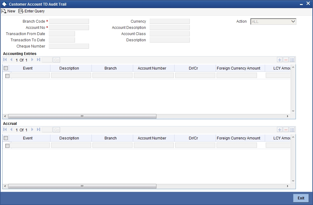

The following audit trail Inquiry will be provided to query the Audit Trail details of TD and RD Accounts. When TD account is manually rolled over using add funds, an event MROL is generated. This event will be listed in search results when such TDs are queried.
You can query the audit trail details of a TD and RD accounts using ‘Customer Account TD Audit Trail’ screen. To invoke this screen type ‘ACDAUDTR’ in the field at the top right corner of the Application tool bar and click the adjoining arrow button.
Branch Code
Specify the branch code of the account.
Account No
Specify the TD/RD Account numbers of the branch. The adjoining option list displays the list of all the valid TD/RD account numbers maintained in the system. You can choose the appropriate one.
Trn From Date
Specify the transaction from date.
Trn To Date
Specify the transaction to date.
Cheque Number
Specify the cheque number issued for the transaction.
Currency
The system displays the account currency of the account being queried.
Action
Select the event of the account for the action. This drop down will have
Account Description
The system displays the description of the account being queried.
Account Class
The system displays the account class of the account being queried.
Description
The system displays the description of the account class of the account being queried.
You can view the accounting entries details:
Event
The system displays the event of transaction of the account being queried.
Description
The system displays the description of the transaction i.e. the description of the transaction code.
Branch
The system displays the account branch of transaction of the account being queried.
Account Number
The system displays the account number being queried.
Dr/Cr
Either Dr/Cr leg is displayed based on the accounting entry posted to the TD account..
Fcy AmountThe system displays the foreign currency am
ount of transaction of the account being queried.
Lcy Amount
The system displays the local currency amount of transaction of the account being queried.
Transaction Date
The system displays the transaction date of transaction of the account being queried.
Value Date
The system displays the value date of the transaction.
Trn Int Dt
The system displays the transaction Initiation date of transaction of the account being queried.
Related Account
The system displays the related account of transaction of the account being queried.
Auth Stat
The system displays the authorization status of transaction of the account being queried.
User ID
The system displays the user Id of transaction of the account being queried.
You can view the accrual details:
Event
Description
Branch
Account Number
Dr/Cr
The system displays the Dr/Cr Indicator of transaction of the account being queried.
Fcy Amount
The system displays the foreign currency amount of transaction of the account being queried.
Lcy Amount
Transaction Date
Value Date
Trn Int Dt
Related Account
Auth Stat
User ID
