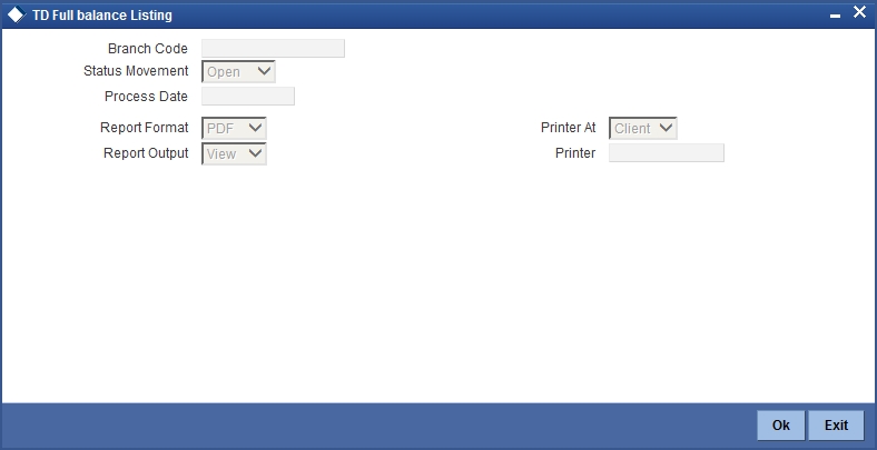

This report gives a complete listing of time deposit accounts opened till the run day. This report gives account class wise grouping of accounts with totals. You have an option to print and view the report in pdf or excel format.
You can invoke ‘TD Full Listing Reports’ screen by typing ‘TDRFULBL’ in the field at the top right corner of the Application tool bar and clicking on the adjoining arrow button.
Specify the following details here:
Branch Code
Select the branch code for which the report needs to be generated, from the adjoining option-list. The list displays all valid branch codes. You have an option to select all the branches or a single branch. If the branch code is not specified, then the TD accounts of all the branches are shown in the report.
Status
Select the account status from the drop-down list. The options available in the drop-down list are as follows:
Click ‘OK’ button to generate the report. For the selected branch, currency-wise deposit amount and number of deposits for the previous month and current month will be displayed along with the cost %.
Process Date
Select the date for processing the report from the adjoining calendar button. The open or close TD accounts till the process date is displayed. If the process date is not specified, then the open or closed TD accounts till current system date are shown.
Click ‘Exit’ to return to the Reports Browser.
The parameters specified while generating the report are printed at the beginning of the report. The contents of the report are discussed under the following heads:
Header of the report
The header of the report contains the following information:
| Field Name | Field Description | ||
| Branch | Current Branch Code and branch Name | ||
| Branch Date | Current Branch Date | ||
| Run Date & Time | Current Run Date and Time | ||
| User ID | Operator generating the Report | ||
| Module | Module of the Report | ||
| Page No | Page No. of the Report |
Body of the report
The following detail block elements are displayed in the report:
| Account Class | This indicates the account class code | ||
| Class Name | This indicates the class name | ||
| Currency | This indicates the currency of transaction | ||
| Status | This indicates the status of the TD account | ||
| Account Number | This indicates the TD account number | ||
| Customer ID | This indicates the unique id of the customer | ||
| Customer Name | This indicates the name of the customer | ||
| Open Date | This indicates the date on which the account was opened | ||
| Maturity Date | This indicates the maturity date of the deposit account | ||
| Deposit Tenor | This indicates the deposit tenor, in days, months, and years. | ||
| Interest Rate | This displays the interest rate applicable to TD account | ||
| Interest rate based on cumulative amount | This indicates Y/N, based on whether the interest rate is based on cumulative rate or not. | ||
| Maturity Amount | This displays the maturity amount of the TD | ||
| Principal Amount | This indicates the total Principal Amount of the deposit account | ||
| Accrued Interest | This indicates the interest accrued for the deposit account |

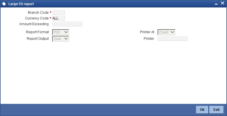

This report provides customer-wise details of large time deposits beyond the given amount criteria. You have an option to print and view the report in pdf or excel format.
You can invoke ‘Large FD Report’ screen by typing ‘TDRFDREP’ in the field at the top right corner of the Application tool bar and clicking on the adjoining arrow button.
Branch Code
Select the branch code for which the report needs to be generated from the adjoining option-list. The list displays all valid branch code s. You have an option to select all the branches or a single branch.
Currency
Select the currency code from the adjoining option-list. The list displays all valid currency codes maintained in the system. By default the value ‘ALL’ will be displayed.
Amount Exceeding
Specify the deposit amount here. The report generated will include only those accounts which exceed the deposit amount specified here.
Click ‘OK’ button to generate the report. Click ‘Exit’ to return to the Reports Browser.
Body of the report
The generated report will have the following information:
| Customer with deposit amount total exceeds | This indicates the TD accounts of the customer with deposit amount exceeding specified amount. | ||
| Branch Code | Indicates the branch for which report is generated | ||
| Branch Name | Indicates the name of the branch | ||
| Customer ID | This indicated the unique id of the customer whose TD accounts exceeds specified amount | ||
| Customer Short Name | This indicates the short name of the customer | ||
| Account Currency | This indicates the currency of the TD account | ||
| Account Number | Indicates the TD account of the customer whose current available balance exceeds the specified limit | ||
| Interest rate | This displays the interest rate of the account | ||
| Maturity Amount | This displays the maturity amount based on the display at the TD level | ||
| Deposit amount | This indicates the deposit amount | ||
| Interest Rate Based on Cumulative Amount | This indicates whether the interest rate for the deposit is arrived using cumulative amount or not. |

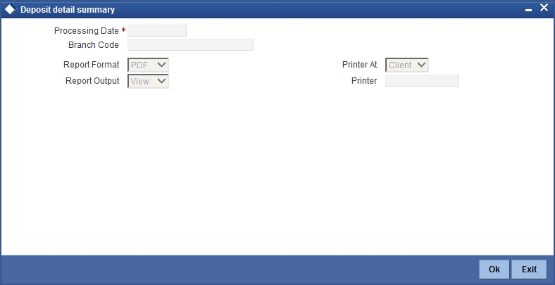

This report provides a summary of currency-wise deposit details. You have an option to print and view the report in pdf or excel format.
You can invoke ‘Deposit Detail Summary by Total Amount’ screen by typing ‘TDRDDSUM’ in the field at the top right corner of the Application tool bar and clicking on the adjoining arrow button.
Processing Date
Select the date on which the report has to be processed, from the adjoining calendar button.
Branch Code
For the selected branch, currency-wise the deposit amount and number of deposits for previous month and current month are displayed along with the cost %.
Body of the report
| Field Name | Field Description | |||
| Currency | This indicates the interest booking account currency | |||
| No. of Deposits | Displays the currency-wise number of deposits for a branch for the previous month | |||
| Previous month Deposits | This indicates the previous month deposits | |||
| Cost (% per.annum) | This indicates the cost percentage per annum | Cost percentage per annum for previous month = (Previous month deposit amount x 100) / (Sum of Deposit Amount) for a specific currency for a branch with start date from first day of the current financial year till date). | ||
| No of deposits | This indicates the currency-wise no. of deposits for a branch for the current month | |||
| Current month Deposits | This indicates the current month deposits | |||
| Cost (% per.annum) | This indicates the cost percentage per annum | Cost percentage per annum for current month = (Current month deposit amount x 100) / (Sum of Deposit Amount) for a specific currency for a branch with start date from first day of the current financial year till date). |

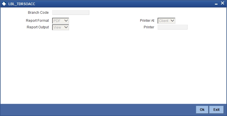

This is a report all financial transactions that are customer initiated along with the interest payout and tax deduction if any that has taken place in a time deposit account. There are multiple financial transactions like deposits, interest pay out etc. that takes place in a time deposit account. Some of these will be customer initiated while others may be done by the system for auto renewal, sweep transactions, etc. The customer needs to get a list of such transactions that have taken place in his/her account along with key transaction details like date transacted, description, maturity date of the deposit etc. This report is generated monthly at EOFI.
You can invoke ‘TD Statement of Accounts Report’ screen by typing ‘TDRSOACC’ in the field at the top right corner of the Application tool bar and clicking on the adjoining arrow button.
Branch Code
Specify the branch code. The system will generate the interest paid report for the branch code that you have selected. On failure to specify the branch code the system generates the report for the accounts of all branches.

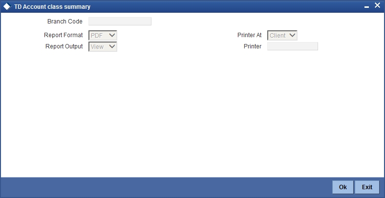

This summary report provides MIS information like principal amount, interest amount etc. with respect to term deposit accounts of the bank. This is a GL-wise, currency wise Account class summary report for all the branches. This report provides information about Account class Code, Account class Name, Total Accounts, Principal Balance, Interest Accrued. The totals are also provided.
You can invoke ‘TD Account class Summary ‘screen by typing ‘TDRPRSUM’ in the field at the top right corner of the Application tool bar and clicking on the adjoining arrow button.
Branch Code
Specify the branch code. The system will generate the TD account class summary report for the branch code that you have selected.

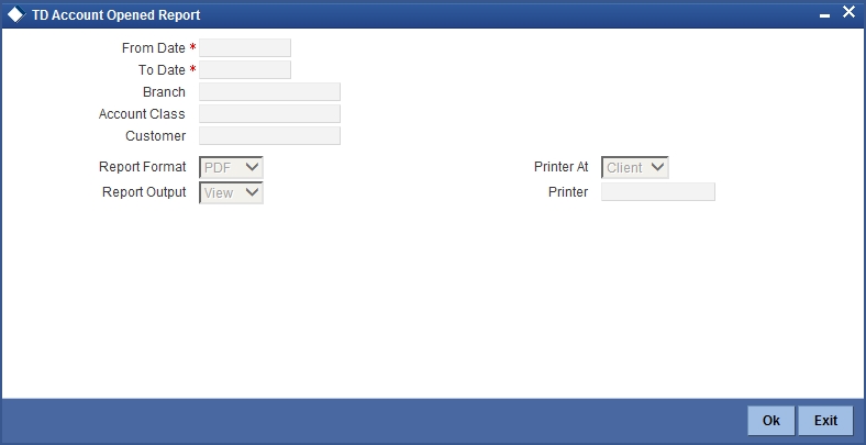

This report list the term deposit accounts which are opened for the given period, and that are currently on open status.
You can generate this report using ‘TD Account Opened Report’ screen by typing ‘TDROPEN’ in the field at the top right corner of the Application tool bar and clicking on the adjoining arrow button.
From Date
Enter the TD accounts which are opened from this date. However by default the system displays the current application date.
To Date
Enter the TD accounts which are opened till this date. However by default the system displays the current application date.
Branch
Specify the branch code of the TD account. The adjoining option list displays the list of all the valid TD/RD branch codes maintained in the system. You can choose the appropriate one.
Account Class
Specify the account class of TD account. The adjoining option list displays the list of all the valid TD/RD account classes maintained in the system. You can choose the appropriate one.
Customer
Specify the customer number of the customer. The adjoining option list displays the list of all the valid customer numbers maintained in the system. You can choose the appropriate one.

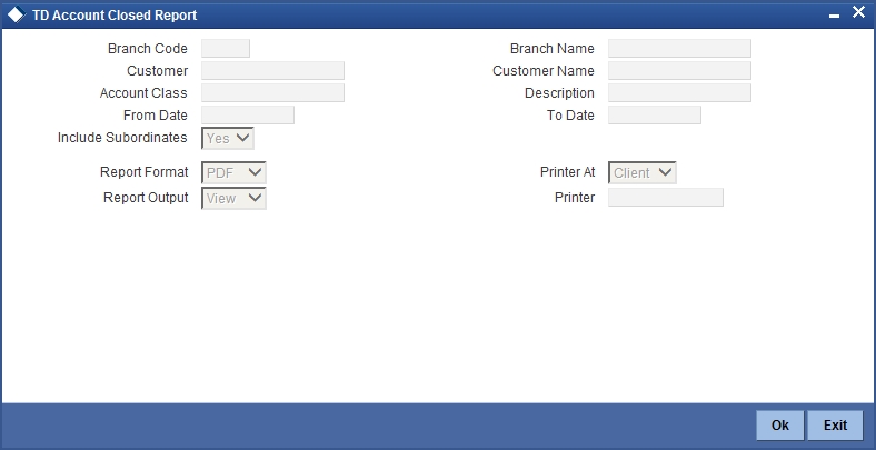

This report list the term deposit accounts which are closed for the given period, and that are currently on open status.
You can generate this report using ‘TD Account Closed Report’ screen by typing ‘TDRCLOSE’ in the field at the top right corner of the Application tool bar and clicking on the adjoining arrow button.
Branch Code
Based on the branch code, the system displays the branch name.
Customer
Based on the customer code, the system displays the name of the customer.
Account Class
The system displays the description of the account class.
From Date
Enter the TD accounts which are closed from this date. However by default the system displays the current application date.
To Date
Enter the TD accounts which are closed till this date. However by default the system displays the current application date.
Include Subordinates
The relationship managers can generate the reports for the customers who are associated with their subordinate RMs. Choose one of the following options:
Choose the appropriate one.
Body of the report
| Account No./Deposit No. | This indicates the TD account Number | |||
| Customer Name | This indicates the Name of the TD account holder | |||
| Closure Date | This indicates the TD account closed date | |||
| Amount of deposit | This indicates the Deposit Amount | |||
| Maturity Date | This indicates the Maturity date of the TD account | |||
| Proceeds credit to | This will show the Payment Mode of the TD account | |||
| Interest Rate | This displays the interest rate of the account | |||
| Goal Reference Number | This indicates the identification number of the goal received from external channels. | |||
| Interest Amount | This indicates the Interest Amount, accrued and liquidated for the closed TD account | (This will show the actual interest amount which has been paid to the customer) | ||
| Maturity Amount | This displays the maturity amount as per new calculation | |||
| Branch | This indicates the Branch Name | |||
| Product Code | This indicates the Account Class code of the TD account | |||
| Deposit Currency | This indicates the deposit currency | |||
| Stock Catalogue Code | This displays Stock Catalog Code for the TD certificate number | |||
| Certificate Number | This indicates the certificate number | |||
| Duplicate Issue | This indicates duplicate issue |

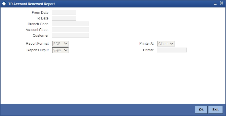

This report lists the term deposit accounts which are renewed for the given period. You can generate this report using ‘TD Account Renewed Report’ screen by typing ‘TDRRENEW’ in the field at the top right corner of the Application tool bar and clicking on the adjoining arrow button.
From Date
Enter the TD accounts which are renewed from this date. However by default the system displays the current application date.
To Date
Enter the TD accounts which are renewed till this date. However by default the system displays the current application date.
Branch Code
Account Class
Customer

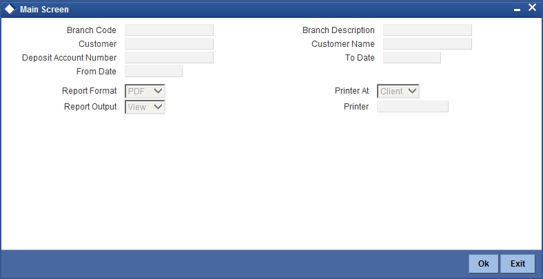

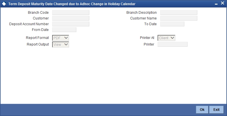

You can generate the TD account maturity date change report for term deposits that have the maturity date adjusted due to adhoc holiday change. You can generate this report using the ‘Term Deposit Maturity Date Changed Due to Change in Holiday Calendar’ screen.
You can invoke this screen by typing ‘TDRMDCHG’ in the field at the top-right corner of the Application tool bar and clicking the adjoining arrow button.
From Date
Specify the date from which the report for TD account maturity date change should be generated. By default, system displays the current Application date.
To Date
Specify the date till which the report for TD account maturity date change should be generated. By default, system displays the current Application date.
Branch Code
Specify the branch code of the TD account. The adjoining option list displays all valid TD branch codes maintained in the system. You can choose the appropriate one.
Deposit Account Number
Specify the account number of the term deposit. The adjoining option list displays tall valid deposit account numbers maintained in the system. You can choose the appropriate one.
Customer
Specify the customer number here. The adjoining option list displays all the valid customer numbers maintained in the system. You can choose the appropriate one.
Report Format
Select the format in which you want to report to be generated from the options provided in the drop-down list. This list displays the following values:
Report Output
Select the output for the report from the adjoining drop-down list. This list displays the following values:
Printer At
Select the location where you want the report to be generated from the options provided in the adjoining drop-down list. This list displays the following values:
Printer
Specify the name of the printer or select it from the option list provided. The adjoining option list displays all the configured printers.
This is applicable only if you have specified the output as 'Print'.
Click the ‘Ok’ button to generate the report. Click ‘Exit’ to return to the Reports Browser.
The header of the generated report will have the following information:
| Report From Date | Date from which the report is generated | ||
| Report To Date | Date till which the report is generated |
Body of the report
| Customer ID | This indicates the customer ID | ||
| Customer Name | This indicates the customer name | ||
| Deposit Account Number | This indicates the deposit account number | ||
| Account Description | This indicates the account description | ||
| Account Branch | This indicates the account branch | ||
| Account Currency | This indicates the account currency | ||
| Deposit Amount | This indicates the deposit amount | ||
| Deposit Tenor | This indicates the deposit tenor | ||
| Deposit Maturity Date | This indicates the deposit maturity date | ||
| Maturity Date Adjusted Due to Holiday | This indicates the maturity date adjusted due to a holiday | ||
| Account Open Date | This indicates the account opening date | ||
| Account Class | This indicates the account class |

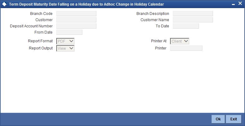

You can generate this report using the ‘Term Deposit Maturity Date Falling on a Holiday due to an Adhoc change in Holiday Calendar’ screen.
This report displays the list of Term deposit for which the maturity date falls on a holiday due to Adhoc holiday change.
You can invoke this screen by typing ‘TDRMDFOH’ in the field at the top-right corner of the Application tool bar and clicking the adjoining arrow button.
From Date
To Date
Branch Code
Customer
Report Format
Report Output
Printer At
Printer

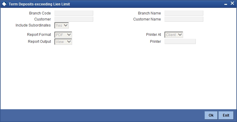

You can generate a report of term deposits exceeding the lien reports using ‘Term Deposits Exceeding Lien Limit’ screen. To invoke the screen, type ‘STRLELMT’ in the field at the top right corner of the application toolbar and click the adjoining arrow button.
Specify the following details:
Branch Code
Specify the branch code for which you are generating the report. The option list displays all valid branch codes available in the system. Choose the appropriate one.
Based on the branch code selected, the system displays the name of the branch.
Customer
Specify the CIF of the customer for whom the report is being generated. The option list displays all valid customer numbers that are applicable. Choose the appropriate one.
Based on the customer number, the system displays the name of the customer.
Once you have specified the details, click ‘OK’. The system generates the report based on the parameters specified.

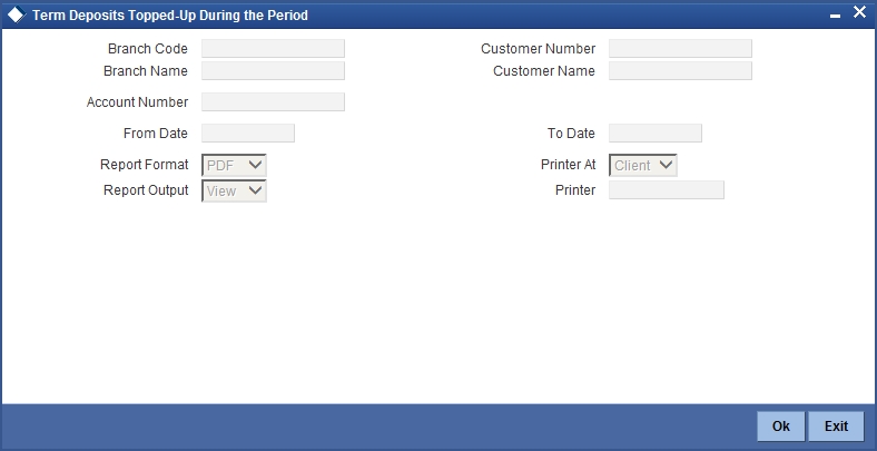

You can generate the Term Deposit Top-up report for TD accounts for which the top-up is made. This report can be generated for all branches or for specific branch for account.To invoke the screen, type ‘TDRTOPUP’ in the field at the top right corner of the application toolbar and click the adjoining arrow button.
Specify the following:
Branch Code
Select the current branch code from the adjoining option list.
Branch Name
The branch name of the selected branch code is displayed here.
Account Number
Select the account number from the adjoining option list.
Customer Number
Select the customer number from the adjoining option list.
Customer Name
The customer name of the selected customer is displayed here.
From Date
Specify the date from which the report for topped-up TD account should be generated.
To Date
Specify the date till which the report for topped-up TD account should be generated.
Report Format
Report Output
Printer At
Printer
The parameters specified while generating the report are printed at the beginning of the report. The report contains the following details:
Header
The following details are displayed in the header section:
| Customer Number | Customer for whom the TD is opened | ||
| Branch Code | Current Branch Code | ||
| Account Number | TD Account number for which top-up is made | ||
| Report from Date | The start date for generating the Report | ||
| Report to Date | The end date for generating the Report |
Body of the Report
The following details are displayed as body of the generated report:
| Deposit Account Number | Indicates the TD Deposit account number | ||
| Account Description | Indicates the description of the TD Deposit account | ||
| Customer Number | Indicates the customer number | ||
| Account Open Date | Indicates the account opening date | ||
| Top-up Date | Indicates the top-up date of the account | ||
| Top-up Value Date | Indicates the value date of the TD top-up | ||
| Top-up Amount | Indicates the account opening date | ||
| Total Deposit Amount | Indicates the total deposit amount | ||
| Interest Rate | Indicates the rate of interest | ||
| Maturity Date | Indicates the date of TD maturity | ||
| Maturity Amount | Indicates the TD amount on deposit maturity |

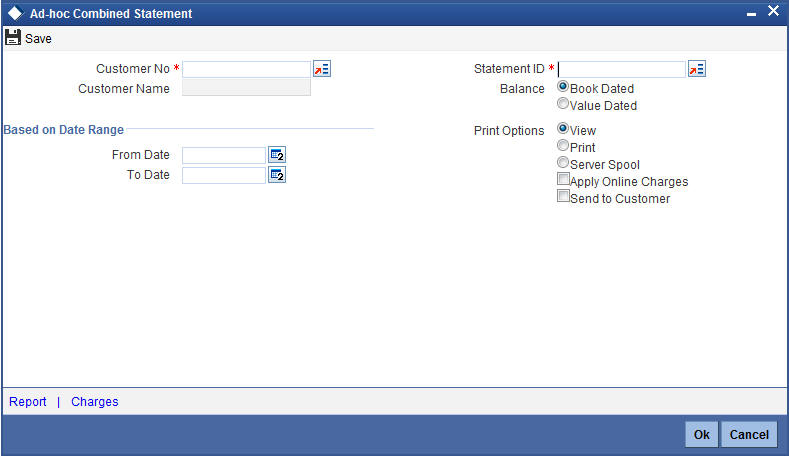

You can generate ad-hoc combined statement through ‘Ad-Hoc Combined Statement’ screen.You can invoke this screen by typing ‘STDCDSMT’ in the field at the top right corner of the Application tool bar and clicking on the adjoining arrow button.
Customer No
Customer Name
The system displays the customer name.
Statement ID
Select the statement ID from the adjoining option list.
Balance
You can select the balance to view based on the book date or value date.
From Date
Specify the from date for the combined statement generation.
To Date
Specify the to date for combined statement generation.
Print Options
You can print, view or spool the statement.
Apply Online Charges
Check this box to indicate that the charges needs to be applied to generate the ad-hoc account statement.
Send to Customer
Check this box to send the statement to the customer.

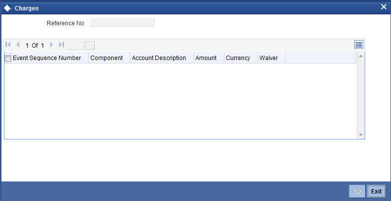

You can process the ad-hoc combined statement by doing the following:
You can view, waive or modify the online charges computed for the generation of the combined statement through the Charges screen. You can invoke this screen by typing ‘CSCONLEVT’ in the field at the top right corner of the Application tool bar and clicking on the adjoining arrow button or click ‘Charges’ on the ‘Ad-Hoc Combined Statement’ screen.
The system displays the following details in the charges screen:
Note
The following maintenances are necessary for the online charge calculation:

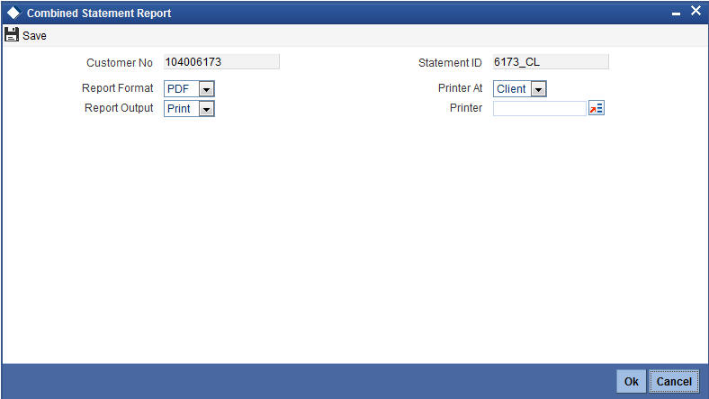

You can generate Combined Statement Report using ‘Combined Statement Report’ screen. You can invoke this screen by typing ‘RPRCNDLG’ in the field at the top right corner of the Application tool bar and clicking on the adjoining arrow button.
Customer No
The system displays the customer number.
Statement ID
The system displays the statement ID.
The parameters specified while generating the report are printed at the beginning of the report. Other content displayed in the report is as follows:
