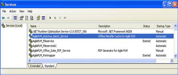

The Offline Metafile Cache service uses the same mechanism as the Java Daemon to install, remove, start, and stop the service.
The configuration of the Windows service registration can be found in the vuelink_wrapper.conf file which is located in the axalant/batch sub-directory of the installation.
#******************************************************************** # Wrapper NT Service Properties #******************************************************************** # WARNING - Do not modify any of these properties when an application # using this configuration file has been installed as a service. # Please uninstall the service before modifying this section. The # service can then be reinstalled. # Name of the service wrapper.ntservice.displayname=AgilePLM_AutoVue_Batch_Service # Display name of the service wrapper.ntservice.displayname=AgilePLM_AutoVue_Batch_Service # Description of the service wrapper.ntservice.description=Offline Metafile Cache for Agile PLM # Service dependencies. Add dependencies as needed starting from wrapper.ntservice.dependency.1= # Mode in which the service is installed. AUTO_START or DEMAND_START wrapper.ntservice.starttype=AUTO_START # Allow the service to interact with the desktop. wrapper.ntservice.interactive=false wrapper.ntservice.account=.\axalantrt wrapper.ntservice.password=********
To install the Offline Metafile Cache service as a Windows service use the vuelink_batch.bat command script located in the axalant\cmd sub directory of the installation.
vuelink_batch.bat -i

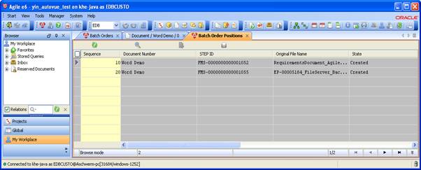

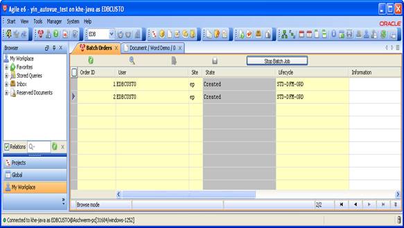

The Offline Metafile Cache feature uses an order queue to send the native files and the checked-in metafile (if available) to the AutoVue server (System->AutoVue->Batch Orders).
An order has one or more order elements, or order positions, which contain the necessary document and file data.
The state shows the current working state of the order.
The order positions are assigned to the order and specify which files should be cached on the AutoVue server.
It is only necessary to add the base file of a 3D assembly. The batch job caches all related native files on the AutoVue server to pre-cache the assembly.
The state shows the current working state of the order position.

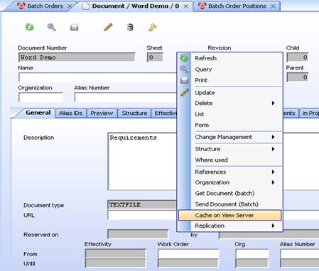

The system provides two userexits to add documents and files to the Offline Metafile Cache:
xpvm_bat_doc
Creates a new order and adds all assigned files which are viewable with AutoVue to an order position.
This userexit is used for document masks.

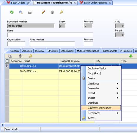

xpvm_bat_fil
Creates a new order and adds the specified file to an order position.
This userexit is used for Document - File relation masks.
Note: Both userexits are select-menu userexits. |
It is also possible to create orders and elements via LogiView by creating records in the order and order position masks.
In the standard installation, the userexit xpvm_bat_doc is available on the document master form.
In the standard installation, the userexit xpvm_bat_fil is available on the document file sub list.
