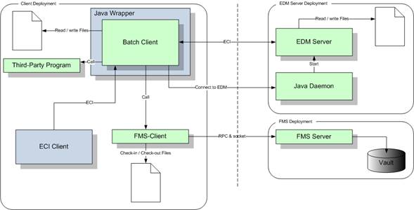

The Agile e6.2.0.0 Batch Client can be used as an ECI Server which tunnels the ECI calls of an ECI client to the EDM Server. Additionally to that tunnel functionality, the Agile e6.2.0.0 Batch Client provides some callables to start external programs or to interact with the FMS Client for file operations.
So a "simple" ECI client can be enabled to check in or check out files from the file vault without an interactive Java Client.
The following picture shows an overview of an Agile e6.2.0.0 Batch Client in ECI server mode.
The Agile e6.2.0.0 Batch Client in ECI Server mode uses the Java Wrapper to enable the service features, as it does in the Scenario mode.
The external ECI client can be, for example, a CAD integration which normally uses a Java Client to gain access to the file within a vault.
The Agile e6.2.0.0 Batch Client allows multi connections from several ECI clients.
