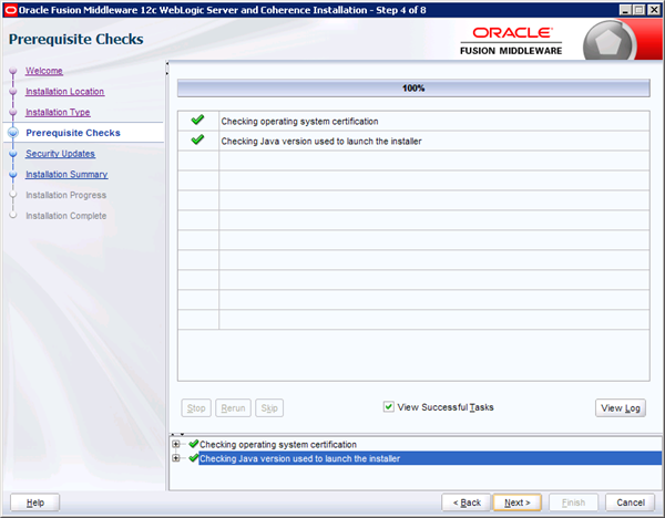

    The Prerequisite Checks screen is opened.
    Surrounding text describes weblogic-5.png.
  5. If issues are listed, they need to be resolved first before continuing with the next step.
  6. Click Next.

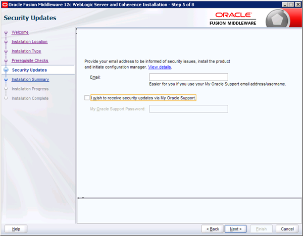

    The Specify Security Updates screen appears.
    Surrounding text describes weblogic-6.png.
    Here you can enter your My Oracle Support account information to receive the latest product information and security updates via your My Oracle Support account.
  7. If you do not wish to register for security updates, or if you do not have a My Oracle Support account, then leave all the fields on this screen empty and click Next.

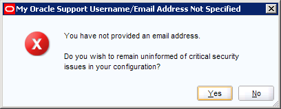

    The following warning screen can be shown.
    Surrounding text describes weblogic-7.png.
  8. To confirm click Yes.
