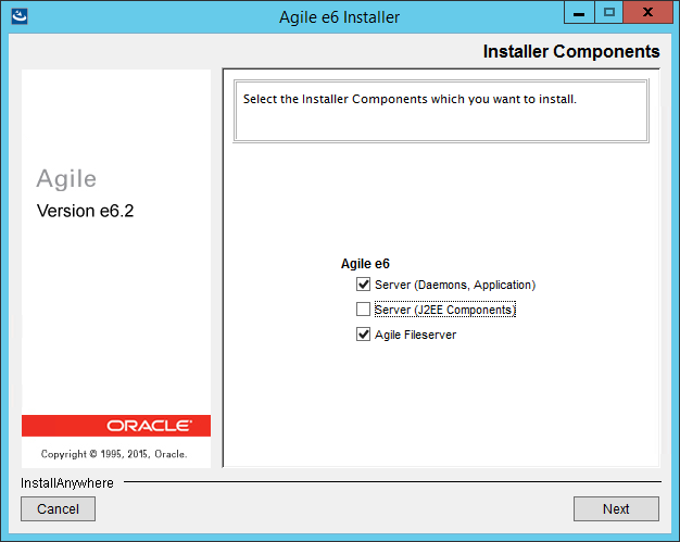

The Installer Component screen is opened.
Deselect Server (J2EE Components).
This will prevent the setup of the Agile e6 J2EE Components.
If you do not want the Agile File Server to be installed, deselect it too.
Click Next.

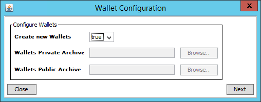

The Wallet Configuration screen is opened.
Note: By default, the Create new Wallets field is set to true. That means that the Wallet's Private Archive and Wallet's Public Archive will be created and cannot be selected.Path on Windows: %ALLUSERSPROFILE%\agile\installer\6.2.0\wallets\installation\<Installation_Name> Path on UNIX: ${HOME}/.agile/installer/6.2.0/wallets/installation/<Installation_Name> |
Note: If only installing the "Agile Fileserver" on a Windows server, you can either create a new set of wallets or use the existing wallets from another server. A wallet is only used once to create the runtime user or to configure the Windows service to use an existing runtime user. The wallets are not needed to install only the "Agile Fileserver" on an UNIX OS. |
Note: The "Server (J2EE Component)" only installation requires to use the same wallets from the "Server (Daemons, Application)" installation. |
Click Next.

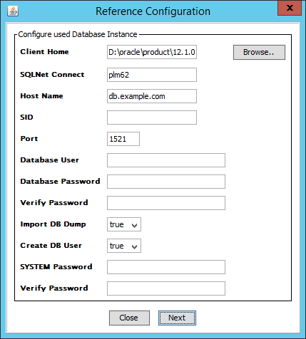

The Reference Configuration screen is opened.
The following values must be identical for the native and the J2EE installation.
| Setting | Description |
| Database User | The database user you want to use for the application. |
| Database Password | The password of the database user. |
When the reference configuration options are defined, click Next.

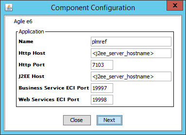

Adapt the values in the Component Configuration mask.
| Name | The name of the default application you want to create. |
The J2EE Components are not installed at this point. You have to use the values marked in red later to setup the Agile e6 J2EE components.
Following values must match the values of your J2EE installation. These are references to these values.
| Http Host | The host where the Web Client can be reached over HTTP (the WebLogic server hostname). |
| Http Port | The port where the Web Client can be reached over HTTP (the HTTP port of WebLogic server). |
| J2EE Host | The host where WebLogic is running (the WebLogic server host name). |
| Business Service ECI Port | The port where the Business Service will be configured to "wait" for requests. |
| Web Services ECI Port | The port where the Web Services will be configured to "wait" for requests. |

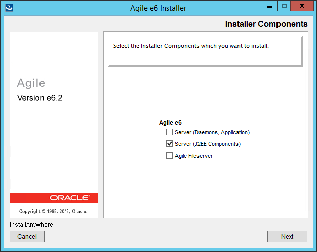

The "Installer Component" screen is opened. By default, all options are selected.
Deselect Server (Daemons, Application) and Agile Fileserver.
This will prevent the setup of the "Agile e6 Native Components".
Click Next

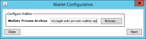

On the J2EE server, select the path to the archive of the private Wallet, which was generated on the Agile EDM Server.
Click Next.

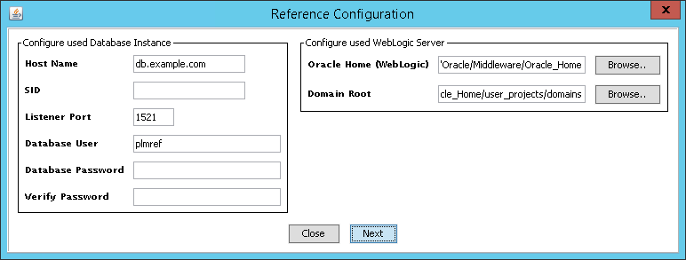

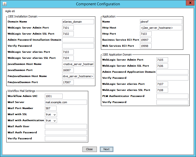

The Component Configuration screen is opened.
The following value must be identical for the native, and the J2EE installation.
| Name | The name of the default application you want to create |
Apply the values of your native installation as given in fields.
Following values must match the values of your native installation. These are references to these values.
| Java Daemon Host Name | The hostname where the Agile e6 Java Daemon is/will be running. |
| Java Daemon Port | The Java Daemon port. |
| FmsJava Daemon Host Name | The hostname where the Agile e6 FMS Java Daemon is/will be running. |
| FmsJava Daemon Port | The FMS Java Daemon port. |
