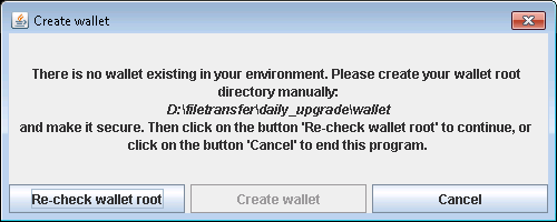

The Create Wallet screen is opened. It is mandatory to create a wallet root.
Manually create the wallet root directory under <UPG_TOOL_ROOT>/wallet and make it secure.
Click Re-check wallet root.
If wallet root is accepted, you can create the wallet.
Click Create wallet.
After the wallet is created, Upgrade Tool UI will be started.
Note: Because the wallet is newly created, the passwords, which you have saved in the configuration file <UPG_TOOL_ROOT>/conf/ApplicationParameter.xml, cannot be decrypted.You can set it again in Upgrade Tool UI. |

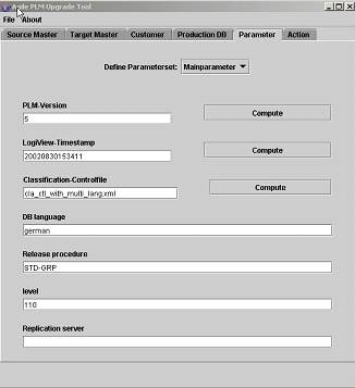

Review and correct the entries if necessary and check the following table for valid entries.
The correct values can be determined with the Compute button. Always check the computed values.
Note: To save changes in the form, press enter after every change in a field. The color then changes from red to black. Otherwise, the changes will be lost. |
| PLM-Version | The customer dump version (before Agile e6 upgrade process). Following values are valid:
08 = e6.0.1 09 = e6.0.2 10 = e6.0.3 11 = e6.0.4 20 = e6.1.0.0 20 = e6.1.0.0004 21 = e6.1.1 22 = e6.1.2.0 2 23 = e6.1.2.2 24 = e6.1.3.0 25 = e6.2.0.0 |
| LogiView Timestamp | All LogiView items with a change date after this time point will be deleted. You can adapt this value manually. Following values are possible:
Note: When using the Upgrade Tool GUI to compute the timestamp, the value stored for EDB-VERSION in table T_DEFAULT in Agile e6 will be used to generate the timestamp. axalant2000 SP1 20001109140557 axalant2000 SP2 20010723102350 axalant2000 SP3 20011113092600axa2000 SP3 PA1 20020808110309Eigner PLM 5.0.1 20020830153411Agile e6.0 LA¼ 20050414160530Agile e6.0 GA² 20050615170000Agile e6.0.1 20051111135800Agile e6.0.2 LA¼ 20060630200000Agile e6.0.2 GA² 20060731220000Agile e6.0.3 20070213080000Agile e6.0.4 20070704180000Agile e6.1.0.0 20080929210000Agile e6.1.0.0004 20081107210000Agile e6.1.1 20090812210000Agile e6.1.2.0 20101105210000Agile e6.1.2.2 20120116210000Agile e6.1.3.0 20131118210000 ¼: Limited Availability ²: General Availability |
| Classification -Control file | A file name of the classification control file for the customer dump. Valid entries are:
cla_ctl.xml cla_ctl_with_multi_lang.xml cla_ctl_with_multi_lang_repl.xml cla_ctl_with_repl.xml |
| Database Language | Language for the database dump. This influences the migration of the classification date. Values: German, English Default: German |
| Level | Status that is set during classification upgrade for records in the tables T_CLA_DAT (pool attributes), T_GROUP_DAT (classes) |
| Replication server | The valid name of the database server, in case of an implemented database replication to the environment, should be migrated. |
