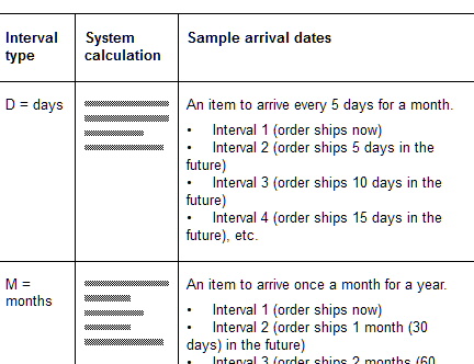

The interval number is used to determine when this item/SKU should be shipped. The first shipment is interval 1, the second shipment is interval 2, etc. Future arrival date: The future arrival date is calculated by subtracting 1 from the interval number and then either multiplying it by the number of months or days (depending on the interval type defined for the item/SKU). Based on the Interval type, the system performs the following future arrival date calculations: |
You can also default a future ship arrival date to a continuity item by entering its status code in the Future Orders Item Status (E52) system control value. The future arrival date that defaults for the item is taken from the date defined in the Default Future Orders Arrival Date (E53) system control value. You may wish to use these system control values to set a starting future arrival date for the continuity item; the system uses this starting date to calculate the future arrival dates for each continuity item. Example: A continuity item contains 2 items: 1 item that ships in the first interval and another item that ships in the second interval. When you add the continuity item to the order, the system defaults the date defined in the Default Future Orders Arrival Date (E53) system control value to the future arrival date for the item that ships in the first interval. The system uses this date to calculate the future arrival date for the item that ships in the second interval. Each component item/SKU defined constitutes a shipment. Numeric, 5 positions; required. |
