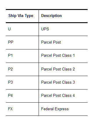

Use Working with Ship Via Codes (WVIA) to set the ship via Type for each ship via used to fulfill Amazon orders. |
order fulfillment feed |

VIA Type |
alphanumeric, 2 positions |
A code to indicate the type of carrier; derived from the ship via Type field as follows:
