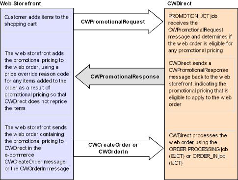

E-Commerce Promotional Pricing Flow
1. On the web storefront, a customer browses and places items in the shopping cart.
2. Before the check out process occurs on the web storefront, the web storefront sends a Promotional Pricing Request Message (CWPromotionalRequest) to the inbound queue defined for the PROMOTION job in the Working with Integration Layer Processes (IJCT) menu option to determine if the customer is eligible for any promotional pricing.
3. CWDirect determines if the data in the CWPromotionalRequest message is valid. The system validates that the message contains a source code or offer code, an item/SKU and quantity.
Determining the item/SKU: The system uses the following hierarchy to determine the item/SKU in the CWPromotionalRequest message:
• If an item_id and sku are not defined, use the short_sku_number.
• If an item_id and sku and short_sku_number are not defined, use the alias_item.
Possible errors: If the CWPromotionalRequest message contains an error, the system sends the Promotional Pricing Response Message (CWPromotionalResponse) back to the web storefront with the errors field set to Y and the nbr_eligible_ field set to 0, indicating an error occurred. Note: The CWPromotionalResponse message does not indicate the specific error that occurred. The following errors may occur:
• Promo pricing (Promotional pricing) field for the source_code in the CWPromotionalRequest message is set to N.
• The external_reference_nbr in the CWPromotionalRequest message is blank.
• The company_code in the CWPromotionalRequest message is blank or is not a valid CWDirect company code.
• The source_code in the CWPromotionalRequest message is not a valid CWDirect source code.
• The offer_id in the CWPromotionalRequest message is not a valid CWDirect offer code.
• Both the source_code and offer_id in the CWPromotionalRequest message are either blank or invalid; a valid source code or offer must be defined.
• The item_id in the CWPromotionalRequest message is not a valid CWDirect item.
• The sku in the CWPromotionalRequest message is not a valid CWDirect SKU code for the specified item.
• The short_sku_number in the CWPromotionalRequest message is not a valid short SKU number for a CWDirect item. Note: The system only looks at the short_sku_number if an item_id is not included in the message.
• The alias_item in the CWPromotionalRequest message contains a value, but the line_offer_id and offer_id in the message are both blank or invalid. Note: The system only looks at the alias_item if the item_id and short_sku_number are not included in the message.
• The alias_item in the CWPromotionalRequest message is not a valid alias for an item in the offer specified in the line_offer_id or offer_id. Note: The system only looks at the alias_item if the item_id and short_sku_number are not included in the message.
• The order_quantity in the CWPromotionalRequest message is blank, 0 or a negative number.
4. CWDirect uses the following information in the Promotional Pricing Request Message (CWPromotionalRequest) to determine if any promotional pricing, as defined in Work with Promotional Pricing (WPRP), is eligible for the order:
• source_code or offer_id
• item_id and sku, or short_sku_number, or line_offer_id and alias_item
CWDirect uses the same processing as in interactive order entry to determine if a web order qualifies for promotional pricing, except the system does not evaluate the Upsell windows field for the order type on the web order. A web order qualifies for promotional pricing when:
• A promotion has been defined for the source_code or offer_id in the CWPromotionalRequest message, and
• The Promo pricing (Promotional pricing) field for the source_code in the CWPromotionalRequest message contains a Y, and
• The web order is eligible for promotional pricing, based on the information in the Promotional Pricing Request Message (CWPromotionalRequest):
• An item in the CWPromotionalRequest message meets the required quantity of the item in a promotion, or
• The merchandise total in the CWPromotionalRequest message meets the dollars required for a promotion, or
• The items in the CWPromotionalRequest message meet the required quantity for a promotion pricing group defined for a promotion.
4. CWDirect sends a Promotional Pricing Response Message (CWPromotionalResponse) back to the web storefront, defining the promotional pricing that is eligible for the web order. The system uses either the external_reference_nbr in the request or the associated MQ message ID to correlate the message request to the message response.
• If the web order qualifies for promotional pricing, the CWPromotionalResponse message contains all of the promotional pricing that is eligible to apply to the web order, in the sequence in which the promotions would be applied to the order in interactive order entry. You must configure your web storefront if you want to include any logic in determining which promotions are applied to a web order; otherwise, the system applies all eligible promotions to the web order. Note: When you add the promotional pricing items to the web order, the items should be added to the web order with a price override reason code so that CWDirect does not attempt to reprice the items that were offered as part of promotional pricing.
• If the web order does not qualify for promotional pricing, the nbr_eligible_promotions tag in the CWPromotionalResponse message is 0.
• If the CWPromotionalRequest message contained an error, the errors tag in the CWPromotionalResponse message is Y and the nbr_eligible_promotions tag is 0.
E-Commerce Promotional Pricing Illustration:

13. The customer decides to purchase promotional item PRM2 for 36.00. The web storefront adds the item to the customer’s shopping cart for a price of 36.00 and a price override reason code.
14. The customer’s shopping cart contains the following items, based on the promotional pricing applied to the web order.

Promotional Pricing Example -- Requesting Promotional Pricing Prior to Checkout
Purpose: In this example the web storefront sends a CWPromotionalRequest message after the customer has added all items to the shopping cart and is ready to check out, but before the web storefront sends the CWCreateOrder or CWOrderIn message to CWDirect.

2. The web storefront sends a CWPromotionalRequest message to CWDirect:

3. CWDirect receives the CWPromotionalRequest message and determines that the web order qualifies for the following promotions:
• promotion A: Buy any two different items from group 100, and receive 10% off an item from group 200
• promotion B: Buy item 206IT1 and receive another 206IT1 for a penny
CWDirect sends the CWPromotionalResponse message back to the web storefront indicating the web order qualifies for promotions A and B.

4. The customer decides to purchase item 206IT1 for a penny and item PRM2 for 36.00. The web storefront adds the promotional items to the customer’s shopping cart for a price of 36.01 and a price override reason code.
The customer’s shopping cart contains the following items, based on the promotional pricing applied to the web order:
