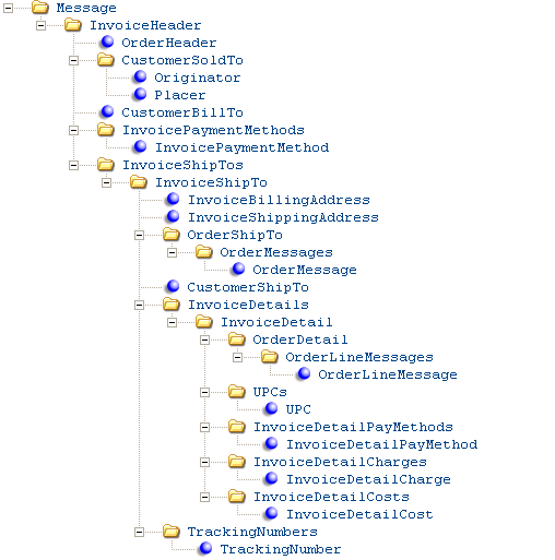

Invoice Outbound XML Inclusion
For each invoice download trigger, the Invoice Outbound message builder determines which elements to include in the Invoice Download XML Message (CWINVOICEOUT), based on XML inclusion rules.
You can define Invoice Outbound XML inclusion rules at the Outbound Interface XML Inclusion Screen.
XML inclusion defines which elements to include in the Invoice Download XML Message (CWINVOICEOUT).
• If the element is included, that element and its parents are included in the generated invoice download message.
• If the element is excluded, that element and its children are excluded from the generated invoice download message.
This table indicates which elements in the invoice download message are included, based on which elements you flag to include or exclude.
Include element in XML message? |
Element |
Y = Include InvoiceHeader N = Exclude InvoiceHeader and all of its children, OrderHeader, CustomerSoldTo, CustomerBillTo, InvoicePaymentMethod, and InvoiceShipTo; the system sends a message with only the Message element and its attributes |
InvoiceHeader |
Y = Include OrderHeader and its parent, InvoiceHeader N = Exclude OrderHeader |
OrderHeader |
Y = Include CustomerSoldTo and its parent, InvoiceHeader N = Exclude CustomerSoldTo and its children, Originator and Placer |
CustomerSoldTo |
Y = Include Originator and its parents, CustomerSoldTo and InvoiceHeader N = Exclude Originator |
Originator |
Y = Include Placer and its parents, CustomerSoldTo and InvoiceHeader N = Exclude Placer |
Placer |
Y = Include CustomerBillTo and its parent, InvoiceHeader N = Exclude CustomerBillTo |
CustomerBillTo |
Y = Include InvoicePaymentMethod and its parent, InvoiceHeader N = Exclude InvoicePaymentMethod |
Y = Include InvoiceShipTo and its parent, InvoiceHeader N = Exclude InvoiceShipTo and its children, OrderShipTo, CustomerShipTo, and InvoiceDetail |
InvoiceShipTo |
Y = Include OrderShipTo and its parents, InvoiceShipTo and InvoiceHeader N = Exclude OrderShipTo and its child OrderMessage |
OrderShipTo |
Y = Include OrderMessage and its parents, OrderShipTo, InvoiceShipTo, and InvoiceHeader. N = Exclude OrderMessage |
OrderMessage |
Y = Include CustomerShipTo and its parents, InvoiceShipTo and InvoiceHeader N = Exclude CustomerShipTo |
CustomerShipTo |
Y = Include InvoiceDetail and its parents, InvoiceShipTo and InvoiceHeader N = Exclude InvoiceDetail and its children, OrderDetail, UPC, InvoiceDetailPayMethod, InvoiceDetailCharge, and InvoiceDetailCost |
InvoiceDetail |
Y = Include OrderDetail and its parents, InvoiceDetail, InvoiceShipTo, and InvoiceHeader N = Exclude OrderDetail and its child, OrderLineMessage |
OrderDetail |
Y = Include OrderLineMessage and its parents, OrderDetail, InvoiceDetail, InvoiceShipTo, and InvoiceHeader N = Exclude OrderLineMessage |
OrderLineMessage |
Y = Include UPC and its parents, InvoiceDetail, InvoiceShipTo, and InvoiceHeader N = Exclude UPC |
UPC |
Y = Include InvoiceDetailPayMethod and its parents, InvoiceDetail, InvoiceShipTo, and InvoiceHeader N = Exclude InvoiceDetailPayMethod |
Y = Include InvoiceDetailCharge and its parents, InvoiceDetail, InvoiceShipTo, and InvoiceHeader N = Exclude InvoiceDetailCharge |
Y = Include InvoiceDetailCost and its parents, InvoiceDetail, InvoiceShipTo, and InvoiceHeader N = Exclude InvoiceDetailCost |
InvoiceDetailCost |
Y = Include InvoiceBillingAddress and its parents, InvoiceShipTo and InvoiceHeader N = Exclude InvoiceBillingAddress |
Y = Include InvoiceShippingAddress and its parents, InvoiceShipTo and InvoiceHeader N = Exclude InvoiceShippingAddress |
Y = Include TrackingNumber and its parents, InvoiceShipTo and InvoiceHeader N = Exclude TrackingNumber |
TrackingNumber |
The invoice download message contains invoice information to send from CWDirect to another system, such as a retail store or financial system.
Message formatting specific to invoice download:
• A separate message is generated for each debit or credit invoice you create.
• Decimals in numeric fields are included.
• All dates are in YYYY-MM-DD format.
• All times are in HH:MM:SS format.
• If you exclude the element InvoiceHeader and all of its children (using the Invoice Outbound XML Inclusion rules), the system sends an invoice download message including only the Message element and its attributes.
For more information: See:
• XML Messages for a table that provides links to the DTD, schema, and a sample XML layout for each XML message.
• Generic Download Message Formatting for more information on how the system formats all download messages.
• Invoice Download Message: Sample XML for a sample message

Each invoice download message can contain one CustomerBillTo element, indicating the bill to customer, if any, associated with the sold to customer on the order. The name and address provided in the message are the current information from the time the message is generated, but are not necessarily identical to the name and address when the invoice itself was generated. See the InvoiceBillingAddress for more information. |

The InvoicePaymentMethod element and its attributes repeat for each payment method associated with the invoice. |

The InvoiceShipTo element and its attributes repeat for each ship to customer associated with the invoice. The name and address provided in the message are the current information from the time the message is generated, but are not necessarily identical to the name and address when the invoice itself was generated. See the InvoiceShippingAddress for more information. |

The name and address provided in the message are the current information from the time the message is generated, but are not necessarily identical to the name and address when the invoice itself was generated. See the InvoiceBillingAddress and the InvoiceShippingAddress for more information. |
ost_ship_via_code |
numeric |
2 |
A code indicating the shipper used to deliver the merchandise to the ship to customer. From the Ship via field in the Order Ship To file. |
ost_ship_via_ description |
alpha |
30 |
A description of the shipper. From the VIA shipper name field in the Ship Via file. |
ost_status |
alpha |
1 |
The status of the ship to order. blank = Open. A = Archived. C = Cancelled. H = Held. S = Suspended. X = Closed. From the OST order status field in the Order Ship To file. |
ost_tax_code |
alpha |
2 |
The tax status of the ship to customer. E (Exempt) = The customer is not required to pay tax on purchases. G (GST only) = The customer is a Canadian customer and subject to the Goods and Services Tax on purchases only; not PST. N (Non-taxable) = The customer will not be taxed on purchases. P (PST only) = The customer is a Canadian customer and subject to the Provincial Services Tax only; not GST. R (Resale) = The customer is a reseller and not subject to tax. T (Taxable) = The customer is subject to all taxes. Canadian customers are subject to both GST and PST tax. From the Tax code field in the Order Ship To file. |
ost_contact_name |
alpha |
30 |
The name of the person who should receive the order at the shipping destination. From the OST contact name field in the Order Ship To file. |
ost_fedex_nbr |
alpha |
10 |
The number of the customer’s account with Federal Express. From the OST federal express # field in the Order Ship To file. |
ost_gift_flag |
alpha |
1 |
Indicates if the ship to order is a gift order. Y = The ship to order is a gift order. N = The ship to order is not a gift order. From the OST gift order field in the Order Ship To file. |
ost_resale_ exempt_nbr |
alpha |
15 |
A number that identifies the customer as exempt from taxes on purchases. From the OST resale/exempt # field in the Order Ship To file. |
ost_line_of_ business |
alpha |
3 |
A code used to identify the line of business, or business unit, assigned to the order ship to. From the OST line of business field in the Order Ship To file. |
ost_line_of_ business_desc |
alpha |
40 |
A description of the line of business. From the LOB description field in the Line Of Business file. |
ost_geographic_ zone |
alpha |
3 |
A code used to identify the geographic zone where the ship to destination is located. From the OST GZF geographic zone field in the Order Ship To file. |
ost_geographic_ zone_desc |
alpha |
30 |
A description of the geographic zone. From the GZF description field in the Geographic Zone file. |
ost_nbr_of_ shipments |
numeric |
3.0 |
The number of shipments made to each ship to address. Included only if items on the order have been picked and billed; not included for express billed orders. From the OST # of shipments field in the Order Ship To file. |
ost_nbr_of_picks_ out |
numeric |
3.0 |
The number of pick slips that have been printed for the order ship to, but have not yet shipped. From the OST # of picks outstand field in the Order Ship To file. |
ost_additional_ charge |
numeric |
7.2 |
The total additional charges for the order ship to. From the OST add’l charges field in the Order Ship To file. |
ost_additional_ charge_balance |
numeric |
7.2 |
The unpaid portion of additional charges. From the OST add’l chg balance field in the Order Ship To file. |
ost_arrival_date |
numeric |
7.0 |
The date the customer expects to receive the order. From the OST arrival date field in the Order Ship To file. |
ost_cancel_bo |
alpha |
1 |
Indicates whether items that are unavailable (backordered) should be cancelled automatically with the first shipment on the order. Y = Cancel backordered items with the first shipment. N = Do not cancel backordered items. From the OST cancel BO field in the Order Ship To file. |
ost_cancel_date |
numeric |
7.0 |
The date the customer wants the order cancelled if it has not been shipped. From the OST cancel date field in the Order Ship To file. |
ost_estimated_freight |
numeric |
7.2 |
The estimated charge for shipping the order. From the OST estimated freight field in the Order Ship To file. |
ost_freight |
numeric |
7.2 |
The actual charge for shipping the order. From the OST freight field in the Order Ship To file. |
ost_freight_ override |
alpha |
1 |
Indicates if the freight charges on the order were overridden in order entry or order maintenance. Y = The freight charge was overridden. N = The freight charge was not overridden. From the OST freight override field in the Order Ship To file. |
ost_freight_balance |
numeric |
7.2 |
The unpaid portion of the freight. From the OST freight balance field in the Order Ship To file. |
ost_handling |
numeric |
7.2 |
The cost of any special handling on the order, including any duty charge. From the OST handling field in the Order Ship To file. |
ost_handling_balance |
numeric |
7.2 |
The unpaid portion of the handling charge and/or duty charge. From the OST handling balance field in the Order Ship To file. |
ost_last_pick_ print_date |
numeric |
7.0 |
The most recent date when a pick slip was printed for the order ship to, in YYYY-MM-DD format. From the OST last pick print date field in the Order Ship To file. |
ost_last_ reservation_date |
numeric |
7.0 |
The most recent reservation date for the order ship to, in YYYY-MM-DD format. From the OST last reservation date field in the Order Ship To file. |
ost_merchandise |
numeric |
9.2 |
The total dollar value of merchandise for the order ship to. From the OST merch field in the Order Ship To file. |
ost_merchandise_ balance |
numeric |
9.2 |
The unpaid portion of the merchandise total. From the OST merch balance field in the Order Ship To file. |
ost_ship_complete |
alpha |
1 |
Indicates if all items on the order must ship together. Y = Ship all items on the order in one shipment. N = Items on the order ship as soon as they are reserved. From the OST ship complete field in the Order Ship To file. |
ost_tax |
numeric |
7.2 |
The total sales tax that applies to the order for the order ship to. This total does not include any hidden tax. From the OST tax field in the Order Ship To file. |
ost_tax_balance |
numeric |
7.2 |
The unpaid portion of the taxes. From the OST tax balance field in the Order Ship To file. |
ost_gst |
numeric |
7.2 |
The Canadian Federal Goods and Services tax that applies to the order ship to. From the OST GST field in the Order Ship To file. |
ost_gst_balance |
numeric |
7.2 |
The unpaid portion of the Canadian Federal Goods and Services tax. From the OST GST balance field in the Order Ship To file. |
ost_pst |
numeric |
7.2 |
The Canadian Provincial Services tax that applies to the order ship to. From the OST PST field in the Order Ship To file. |
ost_pst_balance |
numeric |
7.2 |
The unpaid portion of the Canadian Provincial Services tax. From the OST PST balance field in the Order Ship To file. |
ost_priority |
numeric |
1.0 |
The priority for order fulfillment on a backordered item for the order ship to. Priority codes range from 0 - 9, where 0 is the lowest priority and 9 is the highest priority. From the OST priority field in the Order Ship To file. |
ost_purchase_ order_nbr |
alpha |
15 |
The purchase order number under which the order was placed. From the Purchase order # field in the Order Ship To file. |
ost_number_of_ lines |
numeric |
3 |
The number of order lines for the order ship to. From the # of lines field in the Order Ship To file. |
ost_additional_ freight |
numeric |
7.2 |
The total dollar amount for freight charges exceeding the base freight charge. From the Add’l freight field in the Order Ship To file. |
ost_additional_ freight_balance |
numeric |
7.2 |
The unpaid portion of additional freight charges. From the Add’l frt bal field in the Order Ship To file. |
ost_discount_pct |
numeric |
5.2 |
A flat discount percentage applied to discountable merchandise only for the order ship to. From the Disc % field in the Order Ship To file. |
ost_calculate_freight |
alpha |
1 |
Indicates whether the system calculates and adds freight charges, service charges by ship via, and C.O.D. charges to the order ship to. Y = The system calculates freight based on the freight method defined for the source code. N = The system does not calculate freight. From the Calculate freight field in the Order Ship To file. |
ost_order_ combination_type |
alpha |
10 |
The long SKU class code assigned to the items on the order. The system updates this field if the Order Combination Pick Selection Type (G47) system control value is set to L/S CLASS. If the order includes items assigned to different long SKU classes, this field is 9999. From the OST future use code 1 field in the Order Ship To file. |
ost_cst_customer_ nbr |
numeric |
9.0 |
The sold to customer number associated with the order ship to. From the OST CST customer # field in the Order Ship To file. |
ost_csh_ship_to_ nbr |
numeric |
3.0 |
The ship to customer number associated with the order ship to. From the OST CSH ship to # field in the Order Ship To file. |
ost_ohr_hold_ reason |
alpha |
2 |
The order hold reason code assigned to the order ship to. From the OST OHR hold reason field in the Order Ship To file. |
ost_whs_warehouse |
numeric |
3.0 |
A code for the warehouse from where the merchandise on the order will ship. From the Whs field in the Order Ship To file. |
ost_warehouse_ name |
alpha |
30 |
The name of the warehouse. From the Name field in the Warehouse file. |
ost_broker_delivery_ type |
alpha |
1 |
Set to R if this is a retail pickup order, and set to D if this is a delivery order. Included only for retail pickup or delivery orders fulfilled through the integration with the Order Broker module in Locate 5.1 or higher. See Fulfilling Retail Pickup and Delivery Orders in CWDirect for more information. Available in XML version: 4.0 in release 18.0 of CWDirect. |
The OrderMessage element and its attributes repeat for each order message defined on the order header. |
order_msg_seq_ nbr |
numeric |
3 |
The sequence number assigned to the order line message. From the OMS seq # field in the Order Message file. |
order_message_text |
alpha |
60 |
The order line message. From the OMS message field in the Order Message file. |
order_message_ |
alpha |
1 |
Indicates whether, and where, the message prints. P = Print the message on the pick slip. I = Print the message on the invoice. B = Print the message on the pick slip and invoice. From the OMS print? field in the Order Message file. |
order_message_ date |
numeric |
7 |
The date the message was entered, in YYYY-MM-DD format. From the OMS date field in the Order Message file. |
order_message_ user |
alpha |
10 |
The user ID of the person who entered the message. From the User field in the Order Message file. |
The CustomerShipTo element and its attributes are included if the recipient is someone other than the sold to customer. You can send a shipment to: • a permanent ship to customer assigned to the sold to customer. The permanent ship to address values are from the Customer Ship To file. Each attribute for the CustomerShipTo element is prefixed with ship. For example, Ship_to_prefix. • a recipient sold to customer. The recipient ship to address values are from the Customer Sold To file. Each attribute for the CustomerShipTo element is prefixed with ship. For example, Ship_to_prefix. • an order ship to address. The order ship to address values are from the Order Ship To Address file. Each attribute for the CustomerShipTo element is prefixed with order. For example, Order_ship_to_prefix. The name and address provided in the message are the current information from the time the message is generated, but are not necessarily identical to the name and address when the invoice itself was generated. See the InvoiceShippingAddress for more information. |
ship_to_customer_ nbr |
numeric |
9 |
The number assigned to the ship to customer on the order. Included only if you are shipping to a permanent ship to customer or recipient sold to customer. From the OST CST customer # field in the Order Ship To file. |
permanent_ship_ to_nbr |
numeric |
3 |
The number assigned to the permanent ship to customer on the order. Included only if you are shipping to a permanent ship to customer for the sold to customer on the order. If you are shipping to a permanent ship to customer, the Ship_to_customer_nbr field is the associated sold to customer number. From the CSH ship to # field in the Customer Ship To file. |
ship_to_prefix |
alpha |
3 |
The ship to customer’s prefix. From the: • Permanent ship to: NAM prefix field in the Customer Ship To file. • Recipient sold to customer: NAM prefix field in the Customer Sold To file. |
ship_to_fname |
alpha |
15 |
The ship to customer’s first name. From the: • Permanent ship to: NAM first name field in the Customer Ship To file. • Recipient sold to: NAM first name field in the Customer Sold To file. |
ship_to_initial |
alpha |
1 |
The ship to customer’s middle initial. From the: • Permanent ship to: NAM initial field in the Customer Ship To file. • Recipient sold to: NAM initial field in the Customer Sold To file. |
ship_to_lname |
alpha |
25 |
The ship to customer’s last name. From the: • Permanent ship to: NAM last name field in the Customer Ship To file. • Recipient sold to: NAM last name field in the Customer Sold To file. |
ship_to_suffix |
alpha |
3 |
The ship to customer’s suffix. From the: • Permanent ship to: NAM suffix field in the Customer Ship To file. • Recipient sold to: NAM suffix field in the Customer Sold To file. |
ship_to_company |
alpha |
30 |
The ship to customer’s company. From the: • Permanent ship to: NAM company name field in the Customer Ship To file. • Recipient sold to: NAM company name field in the Customer Sold To file. |
ship_to_apt |
alpha |
10 |
The ship to customer’s apartment. From the: • Permanent ship to: NAM apartment field in the Customer Ship To file. • Recipient sold to: NAM apartment field in the Customer Sold To file. |
ship_to_address1 |
alpha |
32 |
The ship to customer’s street address. From the: • Permanent ship to: NAM street address field in the Customer Ship To file. • Recipient sold to: NAM street address field in the Customer Sold To file. |
ship_to_address2 |
alpha |
32 |
The second address line defined on the ship to customer’s address. From the: • Permanent ship to: NAM address line 2 field in the Customer Ship To file. • Recipient sold to: NAM address line 2 field in the Customer Sold To file. |
ship_to_address3 |
alpha |
32 |
The third address line defined on the ship to customer’s address. From the: • Permanent ship to: Address line 3 field in the Customer Ship To Extended file. • Recipient sold to: Address line 3 field in the Customer Sold To Extended file. |
ship_to_address4 |
alpha |
32 |
The fourth address line defined on the ship to customer’s address. From the: • Permanent ship to: Address line 4 field in the Customer Ship To Extended file. • Recipient sold to: Address line 4 field in the Customer Sold To Extended file. |
ship_to_city |
alpha |
25 |
The city defined on the ship to customer’s address. From the: • Permanent ship to: NAM city field in the Customer Ship To file. • Recipient sold to: NAM city field in the Customer Sold To file. |
ship_to_country |
alpha |
3 |
The country defined on the ship to customer’s address. From the: • Permanent ship to: RPR country field in the Customer Ship To file. • Recipient sold to: RPR country field in the Customer Sold To file. |
ship_to_country_ name |
alpha |
30 |
The name of the country. From the Description field in the Country file. |
ship_to_state |
alpha |
2 |
The state defined on the ship to customer’s address. From the: • Permanent ship to: NAM state field in the Customer Ship To file. • Recipient sold to: NAM state field in the Customer Sold To file. |
ship_to_state_name |
alpha |
25 |
The name of the state. From the Description field in the State file. |
ship_to_zip |
alpha |
10 |
The postal code defined on the ship to customer’s address. From the: • Permanent ship to: NAM zip field in the Customer Ship To file. • Recipient sold to: NAM zip field in the Customer Sold To file. |
ship_to_delivery_ code |
alpha |
1 |
Identifies the address as a business or residential address. B = Business address. R = Residential address. N = No distinction between business and residence. From the: • Permanent ship to: NAM delivery code field in the Customer Ship To file. • Recipient sold to: NAM delivery code field in the Customer Sold To file. |
ship_to_po_box |
alpha |
1 |
Identifies the customer’s delivery address as a post office box. Y = The address is a post office box. N = The address is not a post office box. From the: • Permanent ship to: NAM PO box? field in the Customer Ship To file. • Recipient sold to: NAM PO box? field in the Customer Sold To file. |
ship_to_email_ address |
alpha |
50 |
The ship to customer’s email address. From the: • Permanent ship to: Email address field in the Customer Ship To file. • Recipient sold to: Email address field in the Customer Sold To file. |
ship_to_day_phone |
alpha |
14 |
The ship to customer’s day phone number. From the: • Permanent ship to: Phone field in the Customer Ship To Phone # file for phone type D. • Recipient sold to: Email address field in the Customer Sold to Phone # file for phone type D. |
ship_to_day_ext |
alpha |
4 |
The day phone number extension. From the: • Permanent ship to: CT# extension field in the Customer Ship To Phone # file. • Recipient sold to: CT# extension field in the Customer Sold to Phone # file. |
ship_to_eve_phone |
alpha |
14 |
The ship to customer’s evening phone number. From the: • Permanent ship to: Phone field in the Customer Ship To Phone # file for phone type E. • Recipient sold to: Phone field in the Customer Sold to Phone # file for phone type E. |
ship_to_eve_ext |
alpha |
4 |
The evening phone number extension. From the: • Permanent ship to: CT# extension field in the Customer Ship To Phone # file. • Recipient sold to: CT# extension field in the Customer Sold to Phone # file. |
ship_to_fax_phone |
alpha |
14 |
The ship to customer’s third (fax or mobile) phone number. From the: • Permanent ship to: Phone field in the Customer Ship To Phone # file for phone type F. • Recipient sold to: Phone field in the Customer Sold to Phone # file for phone type F. |
ship_to_fax_ext |
alpha |
4 |
The third phone number extension. From the: • Permanent ship to: CT# extension field in the Customer Ship To Phone # file. • Recipient sold to: CT# extension field in the Customer Sold to Phone # file. |
ship_to_rent_name |
alpha |
1 |
Indicates whether to include the ship to customer’s name on a mailing list that you rent. Y = Rent the customer’s name. N = Do not rent the customer’s name. From the: • Permanent ship to: Rent name? field in the Customer Ship To file. • Recipient sold to: Rent name? field in the Customer Sold To file. |
ship_to_mail_code |
alpha |
3 |
A code used to identify when, and under what conditions, you send mail to the customer. From the: • Permanent ship to: Mail code field in the Customer Ship To file. • Recipient sold to: Mail code field in the Customer Sold To file. |
ship_to_mail_ code_desc |
alpha |
40 |
A description of the mail code. From the MCC mail code description field in the Mail/Call Code file. |
ship_to_call_code |
alpha |
3 |
A code that identifies when, and under what conditions, you call the customer. From the: • Permanent ship to: Call code field in the Customer Ship To file. • Recipient sold to: Call code field in the Customer Sold To file. |
ship_to_call_ code_desc |
alpha |
40 |
A description of the call code. From the MCC mail code description field in the Mail/Call Code file. |
ship_to_language_ code |
alpha |
3 |
A code that identifies the language used by the ship to customer. From the: • Permanent ship to: Language code field in the Customer Ship To file. • Recipient sold to: Language code field in the Customer Sold To file. |
ship_to_language_ desc |
alpha |
30 |
A description of the language. From the Description field in the Language file. |
ship_to_match_code |
alpha |
15 |
A code made up of selected characters from the permanent ship-to customer’s name and address, used to eliminate duplicate customer records. From the Match code field in the Customer Ship To file. Available in XML version: 3.0 in CWDirect 10.5 or later. |
ship_to_record_ extended |
alpha |
1 |
Indicates if there is an associated record in the Customer Ship To Extended file. The information in the Customer Ship To Extended file consists of additional address lines (lines 3 and 4). Valid values are: Y = There is a Customer Ship To Extended record for the ship-to customer. N = There is not a Customer Ship To Extended record for the ship-to customer. Available in XML version: 3.0 in CWDirect 10.5 or later. |
ship_to_postal_code_scan |
alpha |
10 |
The first few (typically 5) positions of the ship-to customer’s postal code, used for scanning purposes. See Postal Code Scan Length (F61) for a discussion. From the Postal Code Scan field in the Customer Ship To file. Available in XML version: 3.0 in CWDirect 10.5 or later. |
ship_to_job_title |
alpha |
25 |
The sold to customer’s job title. Not included for an order ship to address or permanent ship to address. Recipient sold to: From the Job title field in the Customer Sold To file. |
ship_to_mail_name |
alpha |
1 |
Indicates whether the customer receives future catalogs. Y = Mail catalogs to the customer. N = Do not mail catalogs to the customer. Not included for an order ship to address or permanent ship to address. Recipient sold to: From the Mail name? field in the Customer Sold To file. |

The InvoiceDetail element and its attributes repeat for each item associated with the invoice. |

The OrderLineMessages element and its attributes repeat for each order line message defined for the item on the order line. |

The UPC element and its attributes repeat for each UPC code defined for the item on the invoice line. |

The InvoiceDetailPayMethod element and its attributes repeat for each pay type assigned to the invoice. |

The InvoiceDetailCharges element and its attributes repeat for each additional charge assigned to the item on the invoice line. |

The InvoiceDetailCost element and its attributes are included once per item on an invoice line. |

The TrackingNumber element and its attributes are included for each separate shipment for which you have packing tracking information. The Consolidated Invoice (B49) system control value controls whether multiple shipments that occur on the same date are included in a single invoice. The information in these attributes is derived from the Manifest Upload Audit file (FLMUAU). Available in XML version: 3.0 (version 10.0 of CWDirect). |
A sample of the Invoice Download XML Message (CWINVOICEOUT) is presented below.
<Message source="CWDirect" target="CWIntegrate" type="CWINVOICEOUT" date_created="2004-10-18" time_created="10:20:01">
<InvoiceHeader ihd_transaction_type="A" ihd_company="5" ihd_order_nbr="4035" ihd_invoice_nbr="1367" ihd_invoice_type="I" ihd_sj_print_date="2004-10-18">
<OrderHeader ohd_reference_order_nbr="4035" ohd_order_status="X" ohd_nbr_of_recipients="1" ohd_order_date="2004-10-18" ohd_enter_date="2004-10-18" ohd_enter_time="09:16:40" ohd_restock_order="Y" ohd_order_type="R" ohd_order_type_description="STORE REPLENISHMENT ORDERS" ohd_invoice_source_code="2004" ohd_invoice_source_description="2004 SOURCE" ohd_invoice_division_code="01" ohd_invoice_division_description="DIV 01" ohd_invoice_entity_nbr="100" ohd_invoice_entity_description="ENTITY 100" ohd_order_entry_wrkstn="QPADEV000F" ohd_freight_override="N" ohd_cbt_account_nbr="142" ohd_cst_customer_nbr="711" ohd_entered_by_user="KBOTTGER" />
<CustomerSoldTo sold_to_nbr="711" sold_to_fname="RETAIL" sold_to_lname="STORE WHS 444" sold_to_address1="24 PRIME PARK WAY" sold_to_city="NATICK" sold_to_country="USA" sold_to_country_name="UNITED STATES" sold_to_state="MA" sold_to_state_name="MASSACHUSSETS" sold_to_zip="01760-1528" sold_to_delivery_code="R" sold_to_po_box="N" sold_to_rent_name="N" sold_to_mail_name="N" sold_to_email_status="O1" sold_to_mail_code="N" sold_to_mail_code_desc="BASIC MAIL CODE" sold_to_tax_status="T" sold_to_associate="N" sold_to_warehouse="444" sold_to_warehouse_name="CWSTORE WHS LOCATION 444" />
<CustomerBillTo bill_to_nbr="142" bill_to_fname="RETAIL" bill_to_lname="STORE WHS 444" bill_to_address1="24 PRIME PARK WAY" bill_to_address2="ADDRESS LINE 2" bill_to_address3="ADDRESS LINE 3" bill_to_address4="ADDRESS LINE 4" bill_to_city="NATICK" bill_to_country="USA" bill_to_country_name="UNITED STATES" bill_to_state="MA" bill_to_state_name="MASSACHUSSETS" bill_to_zip="01760-1528" bill_to_deliver_code="R" bill_to_po_box="N" bill_to_print_statement="Y" bill_to_email_status="O1" bill_to_terms_code="30" bill_to_terms_desc="NET 30 DAYS" />
<InvoicePaymentMethods>
<InvoicePaymentMethod ipm_seq_nbr="1" ipm_pay_category="1" ipm_pay_type="1" ipm_pay_type_desc="CASH, CHECKS" ipm_merchandise_amt="19.16" ipm_merchandise_balance_amt="19.16" ipm_invoice_date="2004-10-18" ipm_deposit_release_date="2004-10-18" ipm_deposit_amount="19.16" />
</InvoicePaymentMethods>
<InvoiceShipTos>
<InvoiceShipTo ins_ship_to_nbr="1" ins_invoice_date="2004-10-18" ins_merchandise_amt="19.16" ins_cost_amt="12.35" ins_discount_amt="-6.66">
<OrderShipTo ost_ship_via_code="12" ost_ship_via_description="PRIORITY MAIL" ost_status="X" ost_tax_code="T" ost_gift_flag="N" ost_nbr_of_shipments="1" ost_arrival_date="2004-10-18" ost_cancel_bo="N" ost_freight_override="N" ost_last_pick_print_date="2004-10-18" ost_merchandise="19.16" ost_ship_complete="N" ost_number_of_lines="2" ost_calculate_freight="Y" ost_cst_customer_nbr="610">
<OrderMessages>
<OrderMessage order_msg_seq_nbr="1" order_message_text="order message code blank" order_message_print="N" order_message_date="2004-10-18" order_message_user="KBOTTGER" />
</OrderMessages>
</OrderShipTo>
<CustomerShipTo ship_to_customer_nbr="610" ship_to_prefix="MRS" ship_to_fname="SALLY" ship_to_lname="ACME" ship_to_company="ACME ENTERPRISES" ship_to_address1="24 PRIME PARK WAY" ship_to_address2="ADDRESS LINE 2" ship_to_address3="12345678901234567890123456789012" ship_to_address4="ADDRESS LINE 4" ship_to_city="NATICK" ship_to_country="USA" ship_to_country_name="UNITED STATES" ship_to_state="MA" ship_to_state_name="MASSACHUSSETS" ship_to_zip="01760-1528" ship_to_delivery_code="R" ship_to_po_box="N" ship_to_email_address="ekaplan@commercialware.com" ship_to_rent_name="N" ship_to_mail_name="N" ship_to_email_status="O1" ship_to_mail_code="N" ship_to_mail_code_desc="BASIC MAIL CODE" ship_to_tax_status="N" ship_to_associate="N" ship_to_inactive="N" ship_to_commercial="N" ship_to_alternate_id="341" ship_to_day_phone="5082222222" ship_to_eve_phone="5081111111" ship_to_fax_phone="5084444444" />
<InvoiceDetails>
<InvoiceDetail idt_seq_nbr="1" idt_line_nbr="2" idt_control_nbr="2527" idt_ship_date="2004-10-18" idt_shipped_qty="5" idt_actual_price="2.50">
<OrderDetail odt_ordered_qty="5" odt_shipped_qty="5" odt_line_status="X" odt_item="O2SKU" odt_sku="LRG BLUE" odt_short_sku="26" odt_offer="204" odt_warranty_item="N" odt_source_code="2004" odt_source_description="2004 SOURCE" odt_division_code="01" odt_division_description="DIV 01" odt_entity_nbr="100" odt_entity_description="ENTITY 100" odt_affect_inventory="Y" odt_arrival_date="2004-10-18" odt_date_printed="2004-10-18" odt_date_reserved="2004-10-18" odt_future_order="N" odt_original_price="2.50" odt_price="2.50" odt_bypass_reservation="N" odt_time_reserved="09:17:23" odt_gift_wrap="N" odt_entered_date="2004-10-18" odt_entered_time="09:16:39" odt_freight_override="N" odt_offer_price="2.50" odt_price_method="7" odt_allow_repricing="N" odt_set_main_item="N" odt_coupon="N" odt_pre_discount="2.50">
<OrderLineMessages>
<OrderLineMessage line_msg_seq_nbr="1" line_message_text="order line message code blank" line_message_date="2004-10-18" line_message_user="KBOTTGER" />
</OrderLineMessages>
</OrderDetail>
<InvoiceDetailPayMethods>
<InvoiceDetailPayMethod idp_opm_seq_nbr="1" idp_merchandise_amt="12.50" idp_merchandise_balance_amt="12.50" />
</InvoiceDetailPayMethods>
<InvoiceDetailCosts>
<InvoiceDetailCost ivc_fifo_seq_nbr="1" ivc_fifo_date="2004-10-18" ivc_quantity="5" ivc_unit_balance="5" />
</InvoiceDetailCosts>
</InvoiceDetail>
<InvoiceDetail idt_seq_nbr="2" idt_line_nbr="1" idt_control_nbr="2527" idt_ship_date="2004-10-18" idt_shipped_qty="2" idt_actual_price="3.33" idt_discount_amt="-6.66" idt_cost_amt="12.3500">
<OrderDetail odt_ordered_qty="2" odt_shipped_qty="2" odt_line_status="X" odt_item="O2" odt_short_sku="25" odt_offer="204" odt_warranty_item="N" odt_source_code="2004" odt_source_description="2004 SOURCE" odt_division_code="01" odt_division_description="DIV 01" odt_entity_nbr="100" odt_entity_description="ENTITY 100" odt_affect_inventory="Y" odt_arrival_date="2004-10-18" odt_date_printed="2004-10-18" odt_date_reserved="2004-10-18" odt_future_order="N" odt_original_price="3.33" odt_price="3.33" odt_bypass_reservation="N" odt_time_reserved="09:18:03" odt_gift_wrap="N" odt_entered_date="2004-10-18" odt_entered_time="09:16:39" odt_freight_override="N" odt_price_method="R" odt_allow_repricing="N" odt_set_main_item="N" odt_coupon="N" odt_pre_discount="3.33" odt_price_override_code="S" />
<InvoiceDetailPayMethod idp_opm_seq_nbr="1" idp_merchandise_amt="6.66" idp_merchandise_balance_amt="6.66" />
<InvoiceDetailCost ivc_fifo_seq_nbr="2" ivc_fifo_date="2004-10-14" ivc_fifo_cost="6.1750" ivc_quantity="2" ivc_unit_balance="2" />
</InvoiceDetail>
</InvoiceDetails>
<TrackingNumbers>
<TrackingNumber pick_nbr="3460316" pick_label_nbr="1" tracking_nbr="TRK#12135A" />
<TrackingNumber pick_nbr="3460317" pick_label_nbr="1" tracking_nbr="TRK#12135B" />
</TrackingNumbers>
</InvoiceShipTo>
</InvoiceShipTos>
</InvoiceHeader>
</Message>
