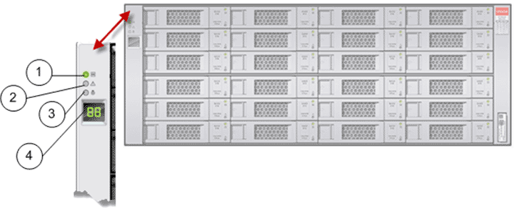

The LED indicators on the operator panel of the Drive Enclosures provide system status. The LED display identifies the Drive Enclosure by its numeric identifier.
Figure 1: Operator panel LEDs (DE2-24P Drive Enclosure)
| 1 System power indicator | 3 Locate indicator and logical fault indicator |
| 2 Module fault indicator | 4 Chassis ID |
Figure 2: Operator panel LEDs (DE2-24C Drive Enclosure)
LED |
LED color |
Status |
Green |
The status is normal. |
Amber |
A module fault is present. |
Locate indicator |
White |
The DE is located. |
LED display |
Green number between 01 and 30 |
The numeric identifier of a DE is displayed. |
