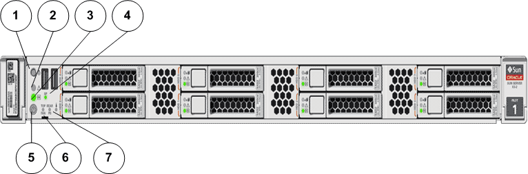

The Pilot LEDs are on the front panel of the Pilot. Use these diagnostic LEDs to determine if a component has failed in the Pilot.
The following figure shows the LEDs at the front of the Pilot:
Figure 1: LEDs at the front of the Pilot
Legend
1 Locator LED / Locator button: white 5 Power button
2 Service Action Required LED or Caution or Fault LED: Amber 6 Fan fault LED: amber
3 OK LED: green 7 Power supply fault LED: amber
4 Service processor LED: green

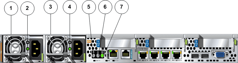

The following figure shows the LEDs at the back of the Pilot:
Figure 2: LEDs at the back of the Pilot
Legend
1 Poser supply 0 (PS0) 5 Locator LED: white
2 Power supply LEDs: Service Required LED (amber) and AC OK LED (green) 6 Service Required LED: amber
3 Power supply 1 (PS1) 7 Power or OK LED: green
4 Power supply LEDs: Service Required LED (amber) and AC OK LED (green)
There are six, system-level status indicators (LEDs), that are on the Pilot front panel and the Pilot back panel. The following table provides status information on these Pilot LEDs:
Table 1 Pilot LED status and description
LED Icon LED color Status
Locator LED button
 alternate image text
White
  • OFF – Pilot is operating normally
  • FAST BLINK – To locate a particular system quickly and easily.
  • Pressing the Locate button toggles the LED fast blink on or off.
Amber
  • OFF – Normal operation
  • STEADY ON – Fault present on the Pilot. This LED lights whenever a fault indicator lights for a Pilot replaceable component.
Note: When this indicator lights up, there is a system console message that includes a recommended service action.
Power or OK LED
Green
Indicates the operational state of the chassis. This indicator can be in the following states:
  • OFF – AC power is not present.
  • STEADY BLINK – Standby power is on, but the chassis power is off.
  • SLOW BLINK – Startup sequence has been initiated on the host. This pattern begins soon after you power on the Pilot. This status indicates either: (1) POST code checkpoint tests are running on the Pilot host system, or (2) the host is transitioning from the powered-on state to the standby state on shutdown.
  • STEADY ON – The Pilot is powered on, and all host POST code checkpoint tests are complete. The Pilot is in one of the following states:
    • 1) The Pilot host is booting the operating system (OS).
    • 2) The Pilot host is running the OS.
Service Processor LED
Green
  • OFF – Service processor (SP) is not running.
  • SLOW BLINK – SP is booting.
  • STEADY ON – SP is fully operational.
Top Fan, Processor, Memory Failure LED
Amber
Indicates that one or more of the internal fan modules, processors, or memory DIMMs have failed.
  • OFF – Indicates steady state; no service is required.
  • STEADY ON – Indicates service required; service the fan modules, processors, or memory DIMMs.
Rear Power Supply Failure LED
Amber
Indicates that one of the Pilot power supplies has failed.
  • STEADY ON – Indicates service required; service the power supply.
Over Temperature Warning LED
Amber
  • OFF – Normal operation; no service is required.
  • STEADY ON – The system is experiencing an over-temperature warning condition.
Note: This is a warning indication, not a fatal over temperature. Might result in the system overheating and shutting down unexpectedly.
