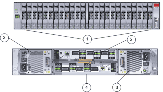

Figure 1: DE2-24P Drive Enclosure CRUs
 | 1 Drives | 4 I/O module 0 |
| 2 Power cooling module 0 | 5 I/O module 1 |
| 3 Power cooling module 1 |

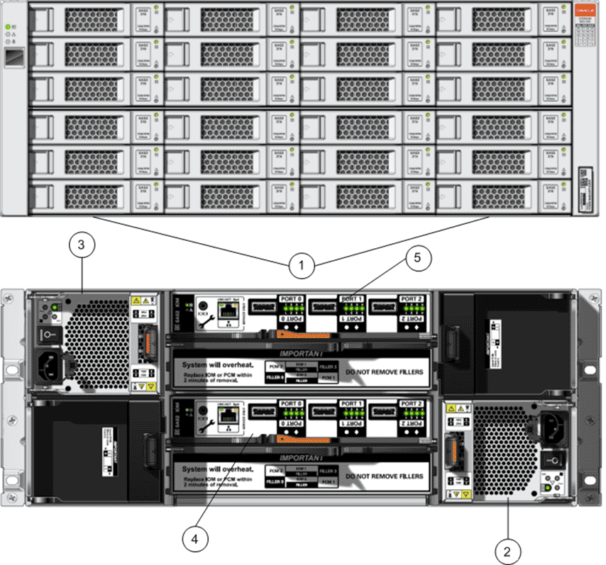

Figure 2: DE2-24C Drive Enclosure CRUs
| 2 Power cooling module 1 | 5 I/O module 1 |
| 3 Power cooling module 2 |
