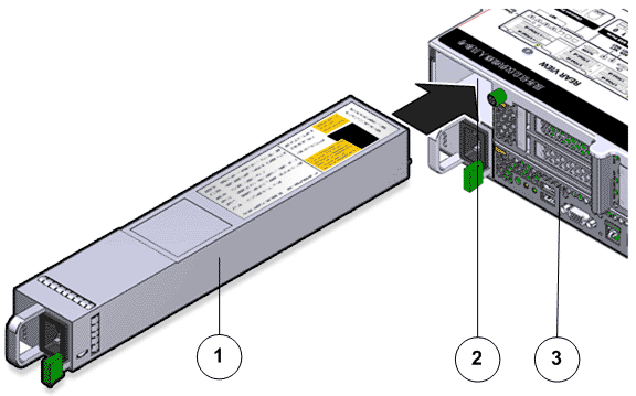

Insert a Power Supply
  1. Slide the replacement power supply into the power supply compartment at the back of the Controller until it is fully seated.
    Figure 1: Insert power supply
     Insert power supply
    Legend
    1 Power supply
    2 Power supply compartment
    3 Controller chassis
  2. Listen for an audible click or feel the power supply engage to confirm that the power supply is properly seated.
    Note: Repeat for each power supply. Also, replace the power supplies only into the slots from which they had been removed.
