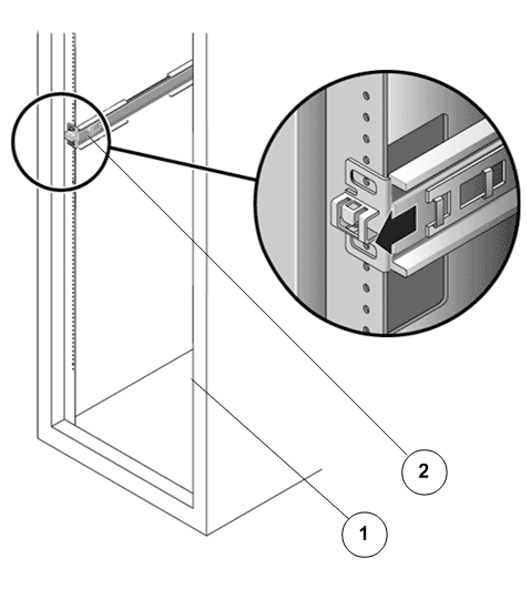

- Position the front of the left rail behind the left front rack rail.
Figure 1: Controller rack mount location
 - Legend
| 1 Rack mount holes |
| 2 Left rail |

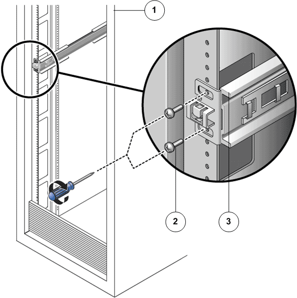

- Use a Phillips Number 2 screwdriver to insert and tighten two 8-32 panhead screws to secure the left rail to the front of the rack.
Note: Each Controller requires two standard mounting units (2U) of vertical space in the rack. Each standard mounting unit (U) has three mounting holes in the left and right rack rails.
Note: Insert the screws into the lowest holes in the top two mounting units of the 2U slot in which the chassis is to be mounted.  These screws pass through the rack rail holes and screw into threaded holes in the left rail.
Figure 2: Left rail secured to the front of the rack
 - Legend
| 1 Rack |
| 2 8–32 screws to secure left rail to rack |
| 3 Left rail |

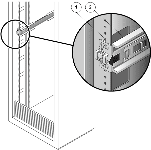

- At the back of the rack, adjust the length of the left rail as needed to fit the rack, and position the rail flange over the face of the rack rail.
Figure 3: Left rail adjusted at the back of the rack
 - Legend
| 1 Back of the rack |
| 2 Left rail |
- Align the rail flange so that the mounting holes correspond to those at the front of the rack.
