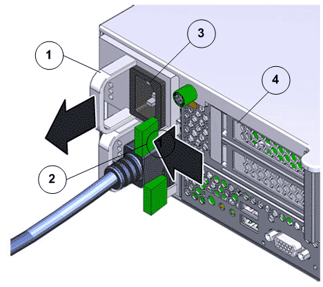

  1. Remove the power supply by grasping the power supply handle and pushing the power supply latch to the left.
    Figure 1: Controller power supply latch
    Legend
    1 Power supply handle 3 Power supply
    2 Power supply latch 4 Controller back

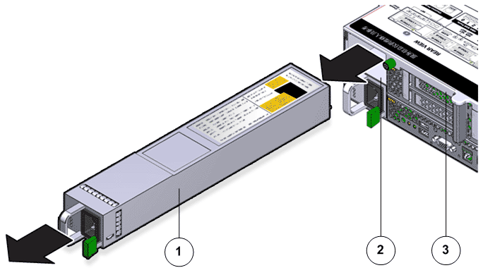

    Figure 2: Remove power supply
     Remove power supply
    Legend
    1 Power supply
    2 Power supply compartment
    3 Controller
  2. If both power supplies must be removed, label the power supplies with the slot numbers from which they are removed.
    Note: Removing both power supplies will result in the immediate powering off of the Controller. Do not pull both power supplies from an active and running Controller.
    Note: The power supplies must be reinstalled into the same slots from which they were removed.
  3. Pull the power supply out of the chassis and place it on an antistatic mat.
