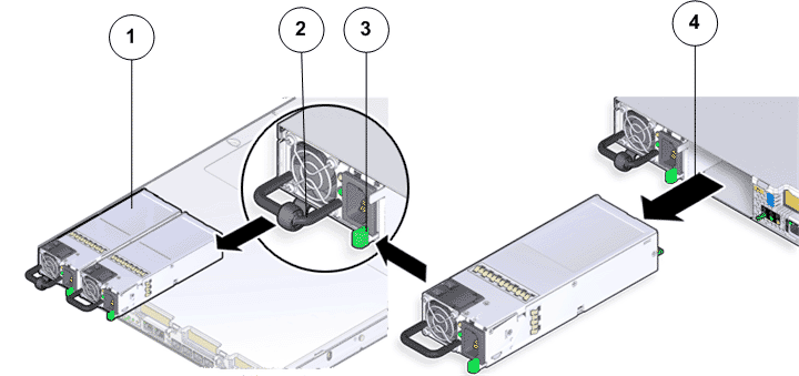

Caution
Do not remove both power cords if it is not necessary. Removing both power cords might crash the
Pilot.
Note: You might need to swing the cable management arm (CMA) out of the way to access the power supplies. If the CMA is still in the way, extend the Pilot approximately 20 cm (8 inches) out of the front of the rack.
Note: The fans of a failed power supply may still be spinning when the system is powered on. You can remove a power supply while the fans are still spinning.
