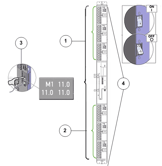

Figure: 1 Single phase PDU outlet groups
 | 1 AC inlet circuit P1 supplies groups 0,1, and 2 |
| 2 AC inlet circuit P2 supplies groups 3,4, and 5 |
| 3 Current is monitored across both AC inlet circuits |
| 4 Group of seven outlets has its own 20 A circuit breaker that can be re-set |
