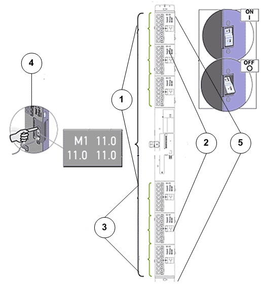

Figure: 1 Three-phase PDU outlet groups
 | 1 AC inlet circuit P1 supplies groups 0 and 3 |
| 2 AC inlet circuit P2 supplies groups 1 and 4 |
| 3 AC inlet circuit P3 supplies groups 3 and 5 |
| 4 Amps are monitored across both AC inputs |
| 5 Group of seven outlets has its own 20 A circuit breaker that can be re-set |
