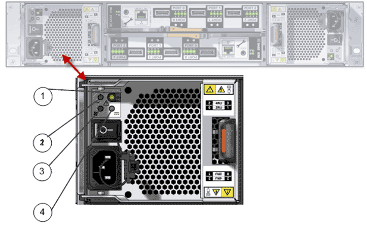

The LED indicators on the power cooling modules provide power activity status, fan and temperature fault conditions, and firmware upgrade status.
Figure: 1 Power cooling module LEDs
 | 1 Status indicator | 3 Fan fail indicator |
| 2 AC fail indicator | 4 DC output fail indicator |
| Status | Status indicator (green) | Fan fail indicator (amber) | AC fail indicator (amber) | DC fail indicator (amber) |
| AC power is not available on either power cooling module. | Off | Off | Off | Off |
| AC power is not available on this power cooling module. | Off | Off | On | On |
| AC power is present, and the status of the power cooling module is normal. | On | Off | Off | Off |
| The power cooling module fan is outside of acceptable limits. | Off | On | Off | Off |
| The power cooling module fan failed. | Off | On | Off | Off |
| A fault is present (over temperature, over volts, over current). | Off | On | On | On |
| The power cooling module is in standby mode. | Flashing | Off | Off | Off |
| The power cooling module is downloading firmware. | Off | Flashing | Flashing | Flashing |
