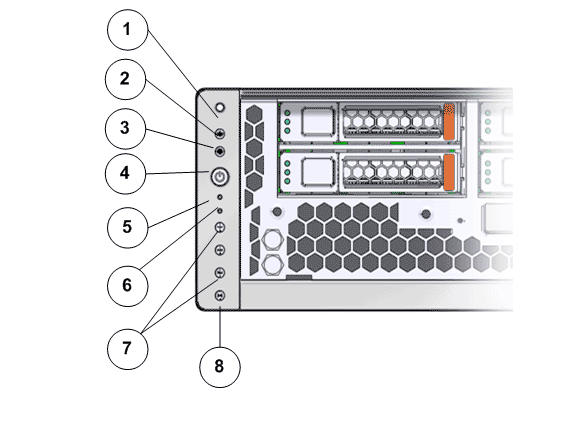

The LED alarm assembly is a high-level status indicator of the Controller and Controller components. Use these diagnostic LEDs to determine if a component has failed in the Controller. The LED alarm assembly also includes a power button to power on the Controller. Besides, the LED alarm assembly there is the Controller Identification Display (CID) that identifies the Controller by its numeric identifier.
Figure: 1 LED alarm assembly front display
 | 1 Chassis identification LED or Locator LED | 5 Service processor LEDs |
| 2 Service Action Required LED or Caution or Fault LED | 6 Back power supply LED |
| 3 Motherboard or Power or OK LED | 7 Fault or Alarm LEDs (Critical, Major, Minor) |
| 4 Power switch | 8 User Alarm LED |
| No. | LED | LED color | Status |
| 1 | Chassis identification LEDor Locator LED button | White | The Locator LED can be turned on to identify a particular system. When on, the LED blinks rapidly. Pressing and holding the Locator button for 5 seconds initiates a test of all LEDs in the LED assembly. |
| 2 | Service Action Required LED | Amber | Indicates that service is required. Under some fault conditions, individual component fault LEDs are turned on in addition to the Service Required LED. |
| 3 | Power or OK LED | Green | Indicates these conditions:
| 5 | Service processor LED | Green | Indicates the state of the service processor:
| 6 | Back power supply LED | Amber | Indicates the state of the power supplies:
| 7 | Fault or Alarm LEDs (Critical, Major, Minor) |
 | Note: The alarm indicators appear on the front panel of the Controller but are not applicable for the Oracle FS System. |
| 8 | User Alarm LED | Amber | Indicates a user alarm condition. Note: The alarm indicators appear on the front panel of the Controller but are not applicable for the Oracle FS System. |

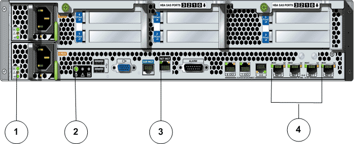

Figure: 2 Controller back LEDs
| 1 Power supply status LEDs |
| 2 Chassis Status LEDs |
| 3 Network management LED |
| 4 Net0 to Net3 status LEDs |
| 1 | Power supply status LEDs: |
| 2 | Chassis Status LEDs |
| 3 | Network management LED |
| 4 | Net0 to Net3 status LEDs |
